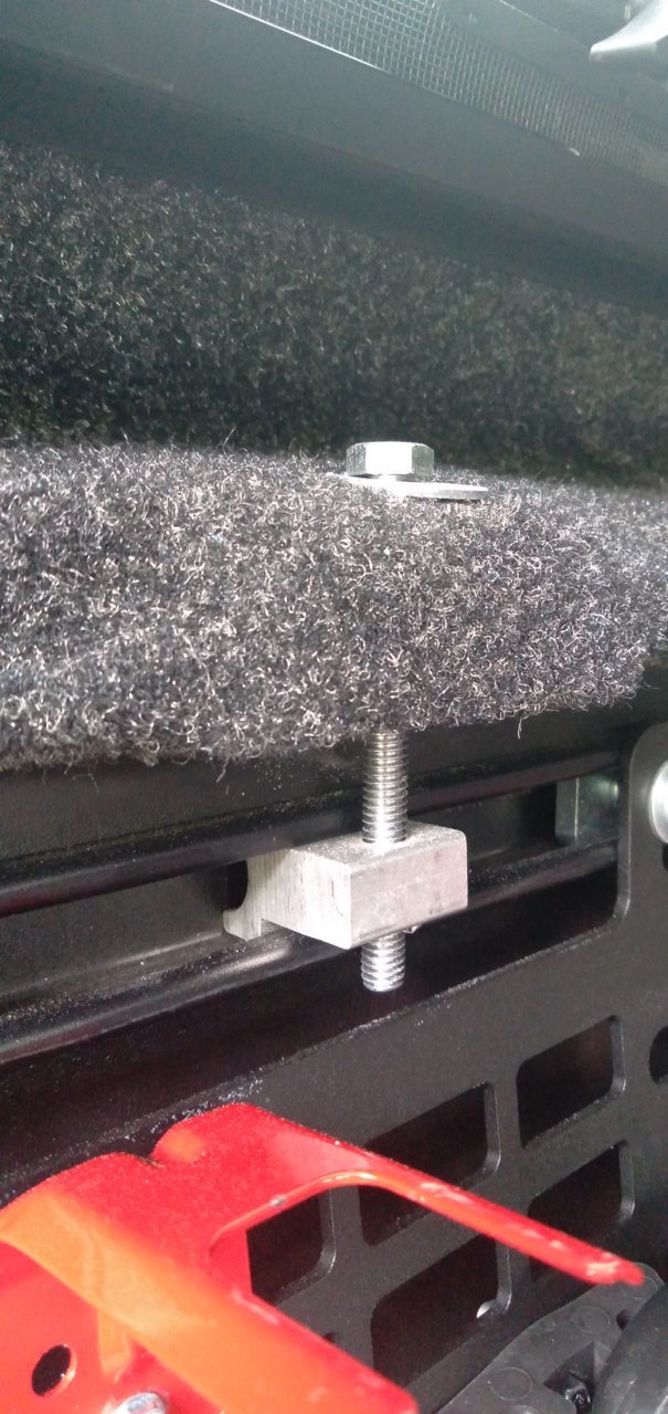

    I also have a 100XQ and there's only 4 bolts holding it down. They're drilled through the cap into some kind of extended T-nut in the rail. It seems fine to me but I don't do any crazy driving. Do yours look like this or do you have clamps?
    You should be checking them periodically. I had to retighten one bolt a few months after the install was done. They've been fine ever since. I've been meaning to add locking hardware but haven't gotten around to it.

    yes, mine look exactly like that. What sort of locking hardware were you thinking? There’s not enough clearance between the end of the bolts and the bottom of the bed rails to get a nylock nut to fit, and the bolt heads on top don’t sit flush with the washers (as you can see in your photo) to where some sort of lock washer might otherwise work. The entire connection just seems shitty to me.

    Well those would have been my two ideas. Guess the only other option would be loctite if you think it's necessary. I agree it's not the best system, but like I said it seems to work fine.
