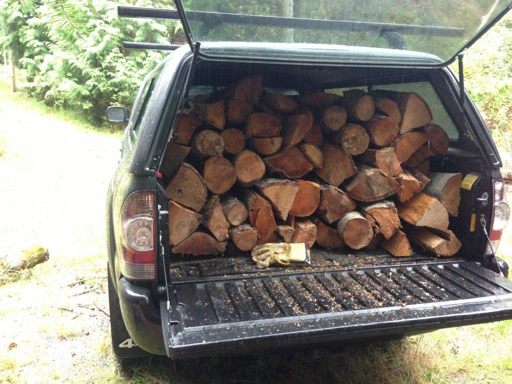

    My '16 Leer 100XR definitely opens to above the roof line:
    Original, unmodified struts.
