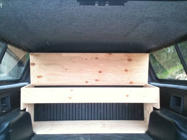

    So I test fit the mock up again inside the canopy this time , and the box fit nicely .
    Unfortunatley the lid contacted the sides , I am going to a fine tune my sizes and I will be
    good to go

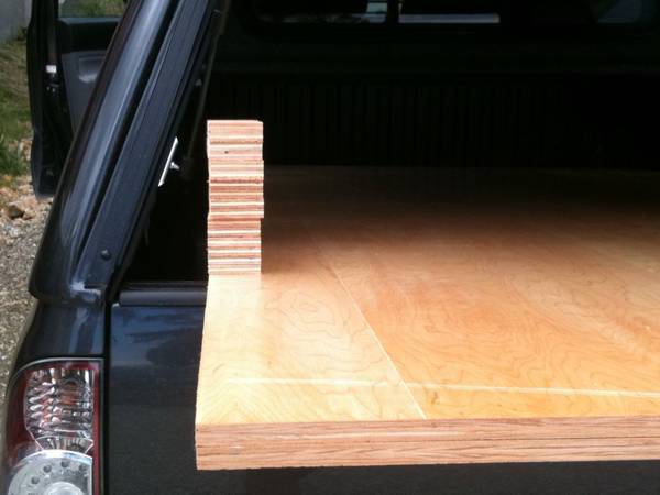

    This is something interesting I hadn't considered , I had to grab a couple sheets of plywood today and noticed that the rear door struts cant inward decreasing the width available as you stack up plywood , I did this test and figure I can get about 9 or 10 sheets of 3/4" plywood in there before I contact the struts .

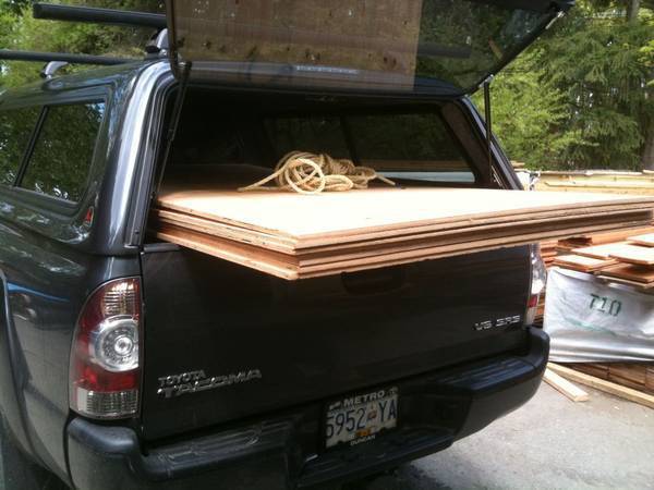

    So today I loaded some plywood with the toolbox mock up in place , the height of the toolbox makes a level platform for sheet goods with the tailgate , I like this feature because the sheets lay flat .

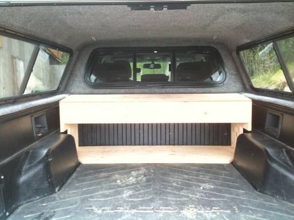

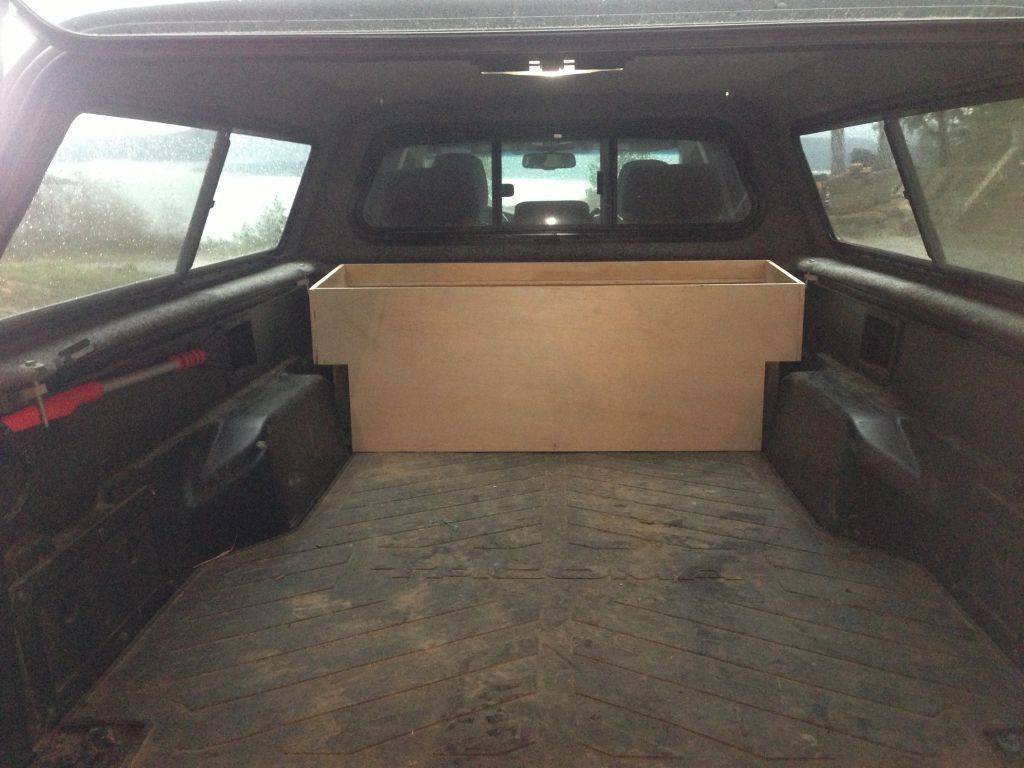

    Sizes work now , time to get it fabricated

    its going to be built of of aluminum correct
