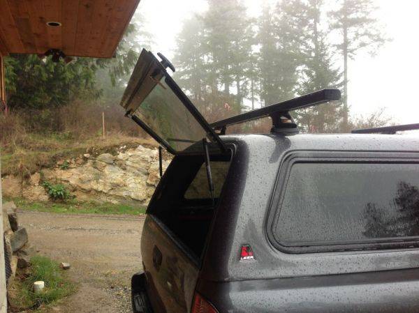

    Also here are a few pics:

    I find it interesting that the cap side of your struts mount so high , mine mount at the bottom
