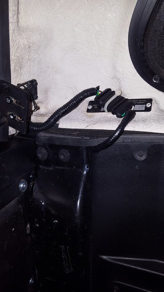

    My wiring harness got pulled out / destroyed recently while removing my Leer cap. The wiring harness was unplugged but got caught on something. I got another standard 4 prong wiring harness and installed it today. I took some pics that I figured someone will find useful someday.
    On my 2010:
    Red & white connects to green & black. (the red/white wire has the light blue connector)
    Red connects to green.
    Black connects to black & white.
    (I wrapped it all in electrical tape after taking this pic)

    Dielectric grease if your friend with splice taps and trailer connectors. The tape will shrink... The glue fail.. sometimes the tape gets nasty after time

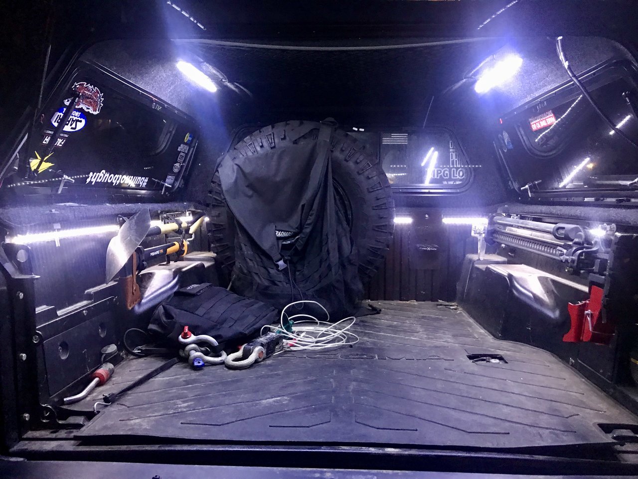

    I just made my own harness to a switch by the driver's seat
    Markcal, ready6delta and tacoburrito like this.

    Do you have a picture of your reverse and brake lights spliced in behind your tail light?
  20. Jan 28, 2018 at 11:23 AM
    #20
    geekhouse23
    geekhouse23 The "Liftman" - @DrFunker
    Jul 14, 2013
    #108251
    15,684
    2GMGMDCSB4WDTRDFTMFW!! TL;DR
    mostly stock, grocery gettin' Prius
    For those cap lights I installed? They're not spliced into anything.
