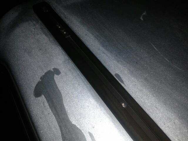

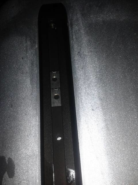

    Can you take a pic of the rails? When I had a leer shell on my old truck the tracks were for Thule, not Yakima. If it's Thule I can probably help you.

    d58572d280b46a760eb0bf5badfd81af_4311a27a589ae7a20925ad5be82cd7472b10c7ef.jpg7972d520f2d7f59a6d565fe0e0648cd0_21b770d197667c68dc7f32366463b59ff07d0e66.jpg
    Thank you

    I'm pretty sure those are the Thule Tracker II rails that I had. But you may want to look up pics of those rails online and compare to be sure.
    If they are, you need 2 things in order to get to the load bars- Thule Tracker II feet, and the TK1 kit which go on the bottom of the feet and attach to the Thule tracks that I assume are in your Leer shell. Then just pick up any square Thule load bars and you're set.
    Here's one of many places selling what you need: http://www.backcountryracks.com/thule-tracker-tk-kit.html

    Thule and Yakima have an agreement to make their stuff cross compatible. So it shouldn't matter and you can find a product from wither manufacturer to fit those tracks.
    What you need are called "towers" or "feet".
    I agree with the powerful and great OZ-T, you should contact Leer and ask them what the rails are designed for. And if they give you some crap about them only working with Leer roof attachments.. well then you're screwed.

    OK I just checked the Leer website and mbroughton02 is correct. Looks like the Thule Tracker II Roof Rack System.

    Just bought a Leer cap with the tracks installed. Leer factory installs Thule and ARE installs Yakima. The feet for the track are interchangeable.

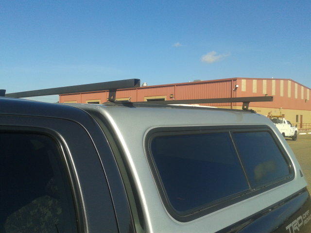

    My yaki-mex rack :cool: just ordered some end cap plugs

    You'll never get ground effects with that spoiler unless you tilt it 3 degrees. ;)
