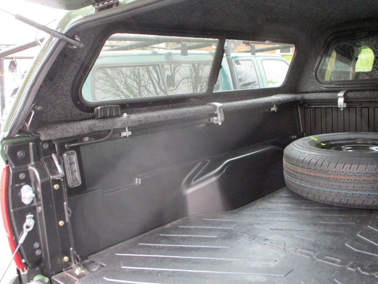

Leer shell broke at rear bolt location - Weaken rack load capacity?

    That attachment method is inherently weak. I added 4 additional clamps, 2 at the middle of the sides and 2 at the front. I would replace your bolt at the broken location with a clamping type. Plus add a few more.

    Great solution.
    Thanks for the reply!
