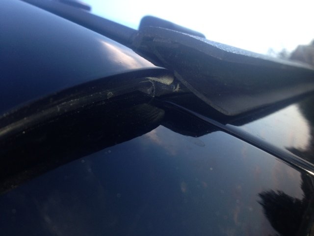

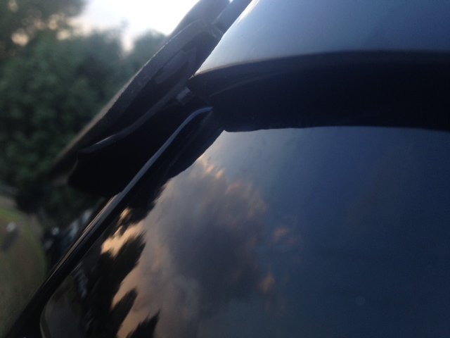

    Just got my new shell installed today. There's some leakage around the sides facing the cab. I assume I can seal that with some flex-seal or spray foam insulation?
    Here's some pics (they don't do it justice)

    Front cab end corners ?

    That's a difficult place to seal because the front of the bed steps down compared to the sides , the installer should have used a double thickness of tape or a thicker tape in that section

    I used one thickness of cap tape that bridges across the top of the front bed rail and onto the front of the bed itself , then another layer that was about 1/2 on the first layer and towards the cab , this has the leading edge sloping down slightly outside of the bed , been working great all through last fall / winter / spring

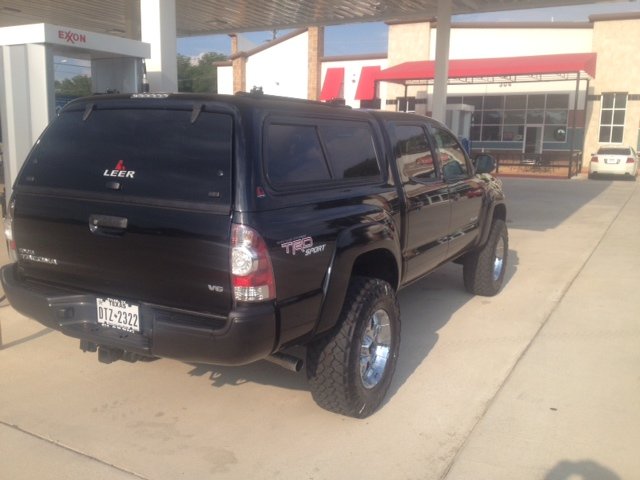

    Here's a visual..

    Looks like it could move forward a bit , is there a gap between the cap door and the tailgate ?

    Yes..
    LEFT SIDE
    RIGHT SIDE

    That looks about the same as my LEER installation. As mentioned, there is a step where the bedside and the bedfront meet, that's where they usually leak. At least unless you're like my 2006 was, it leaked where the seem was on the bed and I clear siliconed it.

    It that with the door latched ?

    Yea door latched

    That's weird , that looks like it should come back a bit
    The door should be flush when it's shut , at least mine is

    I think it's an optical illusion .... The glass of the door is flush with the frame of the shell

    Oh , well that's right then
