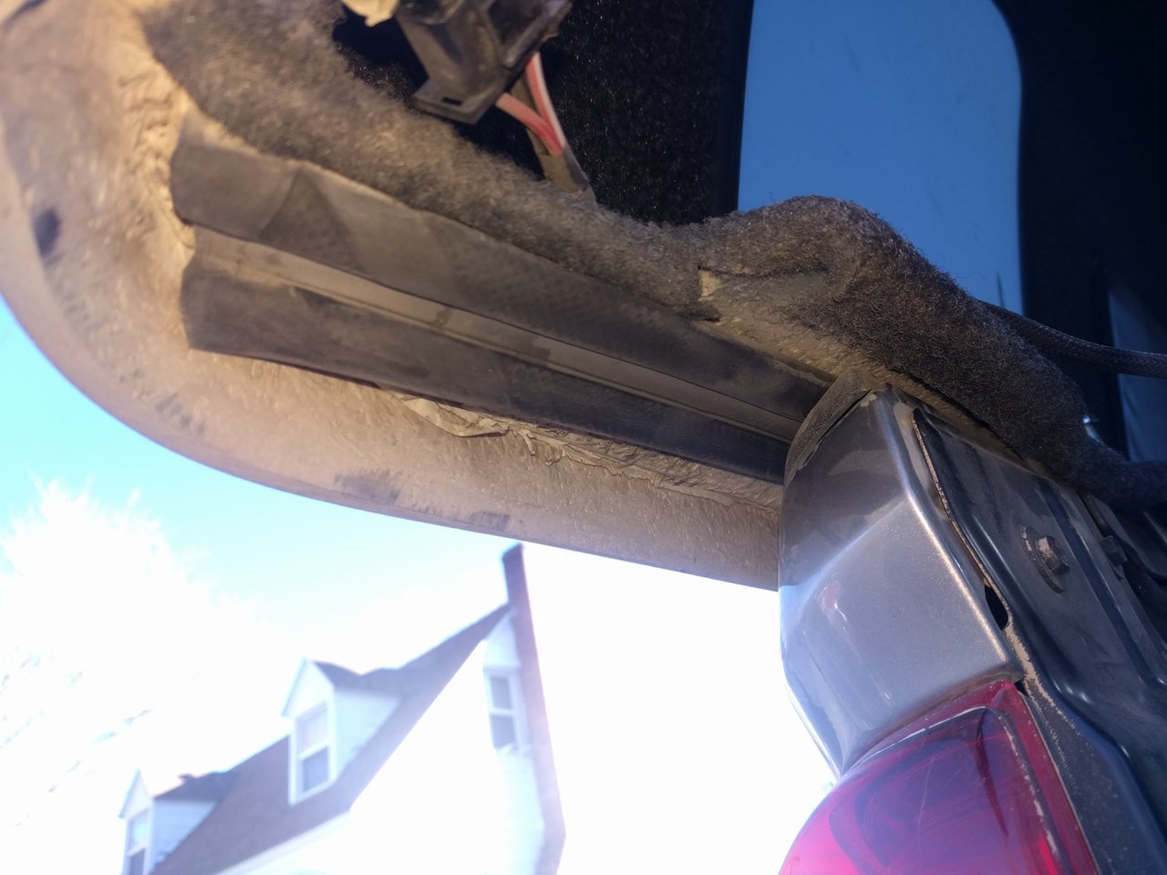

    Do you have just the fiberglass of the cap sitting on the plastic bedrails?
    I have had 1" wide x 1/4" thick foam padding attached to the underside of the cap. This makes it not slide very well on the plastic bed rails. I installed them for water proofing, but noticed when trying to install the cap that it was hard to slide it on the bed.

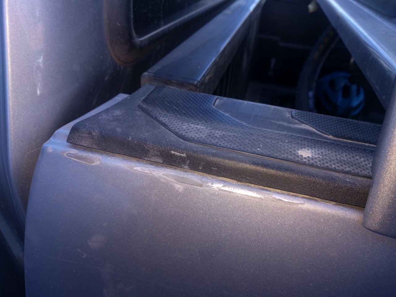

  16. Dec 12, 2020 at 10:33 PM
    #16
    Buttermilker
    Buttermilker [OP] Well-Known Member
    Sep 22, 2020
    #341595
    77
    Danny
    Bishop, CA
    '16 ACOR
    Sierra pinstriping Eibach stage 1, 3 leaf AAL
    Looks like it's sitting on a type of weather stripping. Also attached pic of paint damage. I ended up cleaning damage, painting with paint pen, and putting a couple layers of 3m vinyl over where it was rubbing. Maybe more of a bandaid fix than actually fixing the issue. Might line the whole edge of the shell with weather rtripping or foam or something and just make sure the bolts are snug once a month. And maybe stop bombing down washboard roads..
