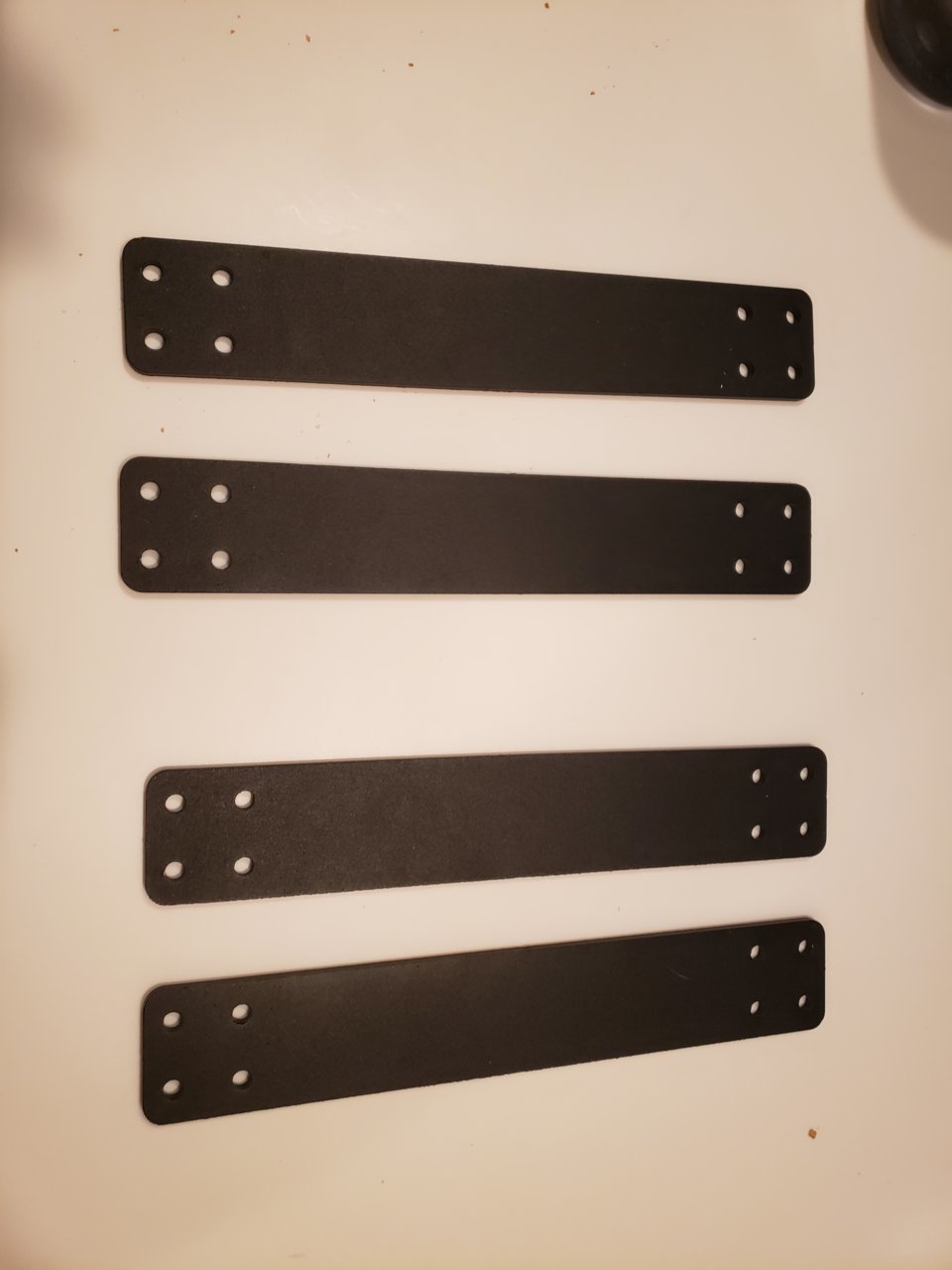

    Follmer,
    See you have the flat metal bands mounted next to the mounts. Any body know what purpose they are supposed to serve?
  4. Dec 6, 2020 at 3:57 PM
    #44
    follmer
    follmer [OP] Well-Known Member
    Dec 4, 2019
    #312502
    48
    Colorado
    2020 TRD Offroad
    Kings, Ray 10s, KO2s (295/75r16)
    According to the installation guide, they are "stiffener braces". It doesn't say anything besides that, but I assume they're provided in case you have really heavy things on your rack. They just attach between two of the cross bars.
    My rack is actually the first time I've seen them anywhere, no install videos that I checked out prior had them, so it must be something new.
  5. Dec 6, 2020 at 4:14 PM
    #45
    Tyrone in Omaha
    Tyrone in Omaha Member
    Oct 3, 2020
    #342695
    13
    2019 Tacoma Sport 6 Manual
    Steel skid plates, prinsu racks, leer top
    "Installation Guide"......you lucky duck!
    No guide came with mine, and like you did not see a vid with these being installed. Kinda had a feeling, now need to take it apart to do the install, egads!
    Thanks.
  6. Dec 6, 2020 at 4:17 PM
    #46
    follmer
    Dec 4, 2019
    #312502
    48
    Colorado
    2020 TRD Offroad
    We'll really they just sent a business card with a QR code on it that takes you to this part of their website for the installation guide ;)
    https://prinsudesignstudio.com/install-guides/
    But yeah I've never seen anyone use them. Also I'm not sure how worth it it is if you ever move your crossbars. It's a lot of tedious work putting the stiffeners on, and I only did so since I never plan on moving the cross bars, so be sure you want them first.
  7. Dec 6, 2020 at 5:41 PM
    #47
    Tyrone in Omaha
    Oct 3, 2020
    #342695
    13
    Probably go ahed and do the install. Like the idea of added braces.
    Once again, thanks for starting this thread. Some very good answers, that provided peace of mind that the install is correct and safe!
    follmer[OP] likes this.
