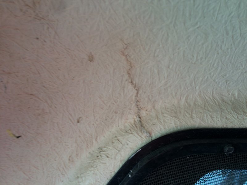

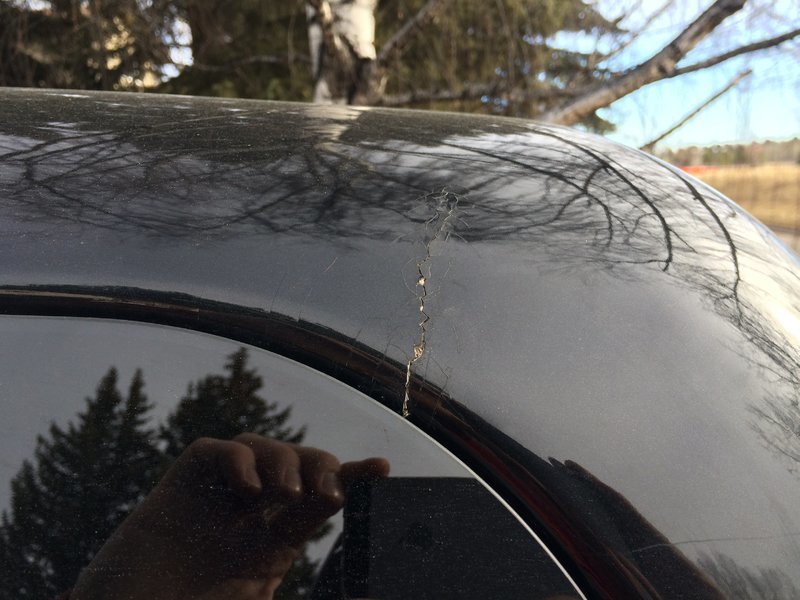

    I am thinking of buying this used Leer XL Canopy but it has this crack on both corners of one side from falling in his garage he said.. how big of an issue would you say these cracks are? any input would be appreciated! thanks.

    Hard to tell exactly from your pic, but does not appear to be awful. Years ago I had a cracked topper (bad encounter with cinder block) and repaired it with a fiberglass canoe patch kit. The crack was about 8 inches long and I took some time to sand it smooth and repaint so it looked "ok". The repair lasted for the next 4 years I had the truck and the guy I sold it to did not seem to have an issue with it. As long as the crack does not impact an area around where the top attaches to the bed, or near the pivot point for the rear window I suspect a fiberglass repair will work fine

    Walk away, $1000 to fix it right, re- glass cracked area, complete re -paint. Unless you are real handy and looking for a project.

    If the price is right I'd patch it from the inside and touch up the paint on outside.

    At the same time, fiberglass repair is super easy and shouldn't give you problems ever again if done right. On the outside, sand the cracked areas to bare Fiberglass, prime, then duplicolor spray paint the sanded area plus about 8-12 inches outside. Light coats and sand between with some 3000 grit wet. When it looks great, clear coat and profit! Easily done in a weekend and well worth it if you can get the topper for cheap.
