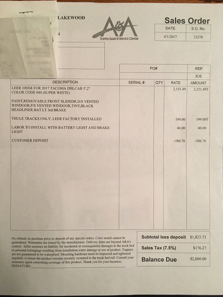

    Invoice for 100 XR with all the goodies $2587 OTD
    I specifically remember the removable front sliding door as a $100 up charge and i want to say vented windoors were $150 per side
