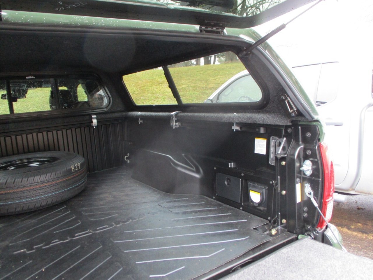

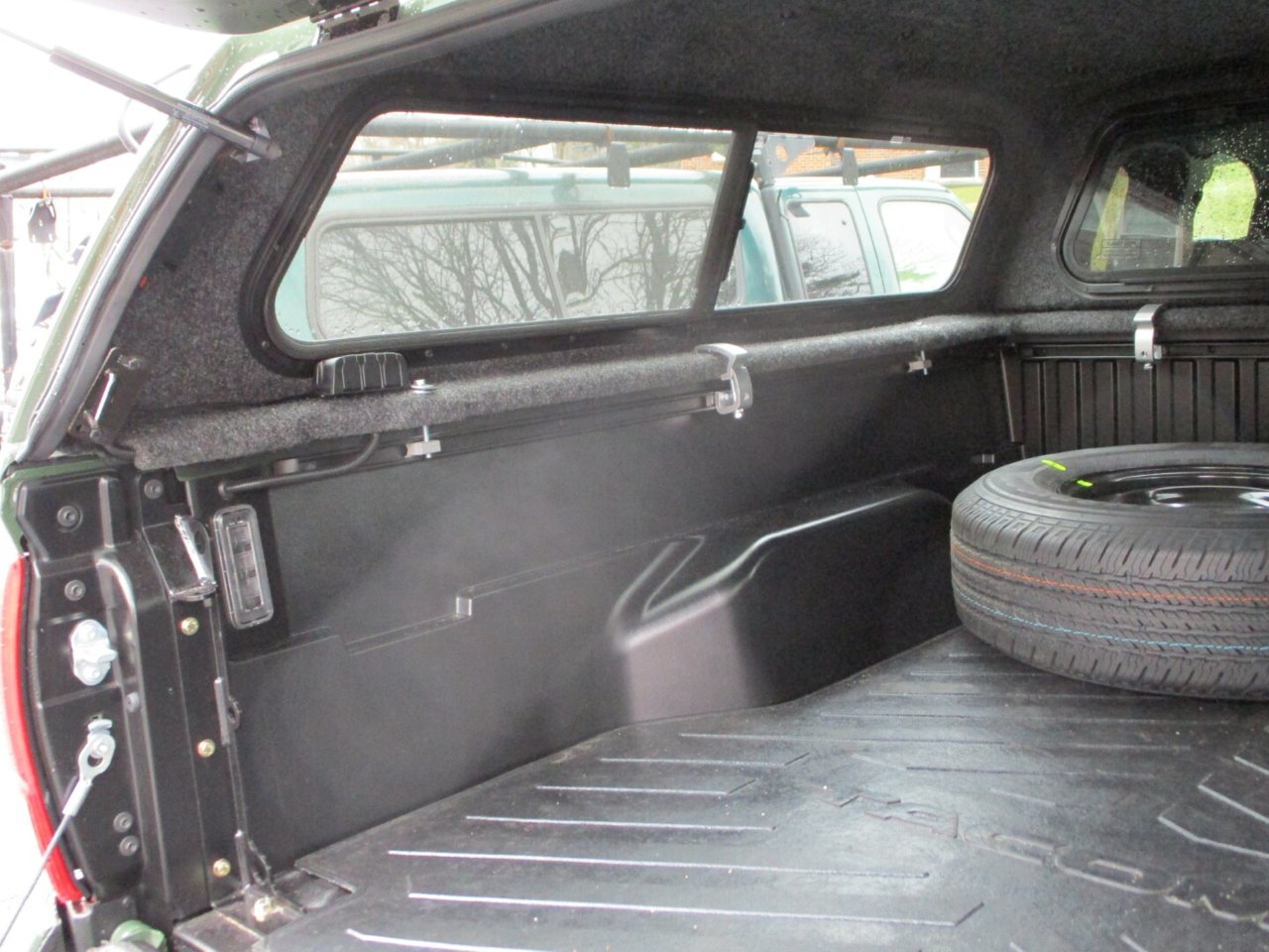

    Here's what I did regarding the clamps and bed stiffeners on mine:

    Oo i like those front clamps

    Only that specific design (of clamp) will work on the front. I had the Leer dealer / installer give up when I requested front clamps. I had to find them on my own -- ended up paying $35 for the set of 4 from Amazon.
