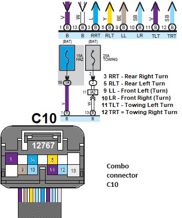

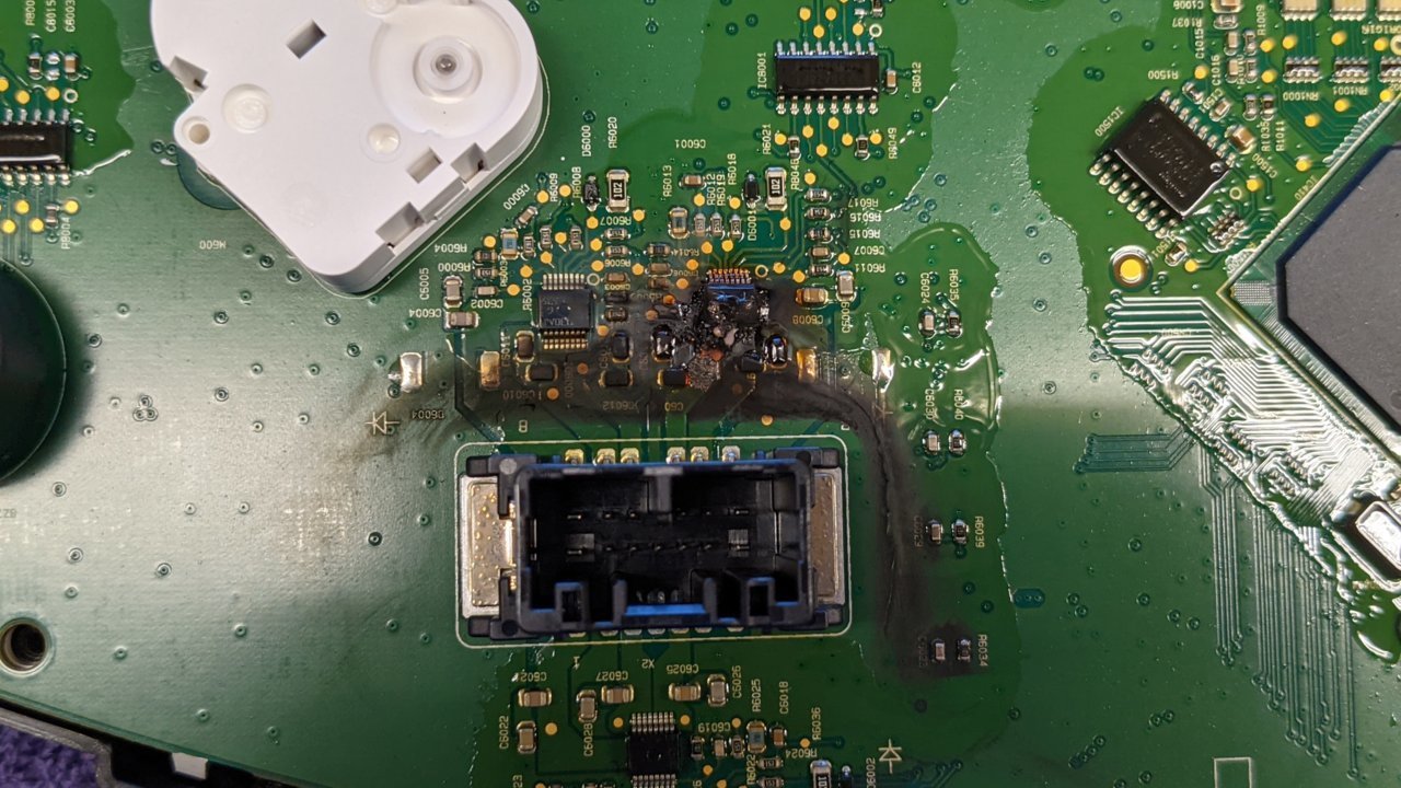

    How about just remove the Combination Meter (pull surrounding facia, 4 bolts and to connectors) then remove the rear cover and inspect the pcb very carefully.
    You might discover this:
    or not...
    Dm93 likes this.

    Ooof someone let the magic smoke out:bananadead:
    Wonder why Toyota chose to use the Combination Meter to control/power the turn signals on 3rd gens instead of the Body ECU anyway?

    21
    I did pull look at it it wasn't looking like that, it looked all fine

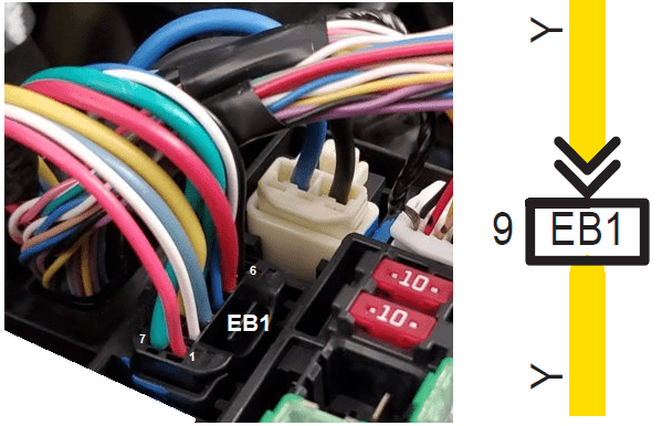

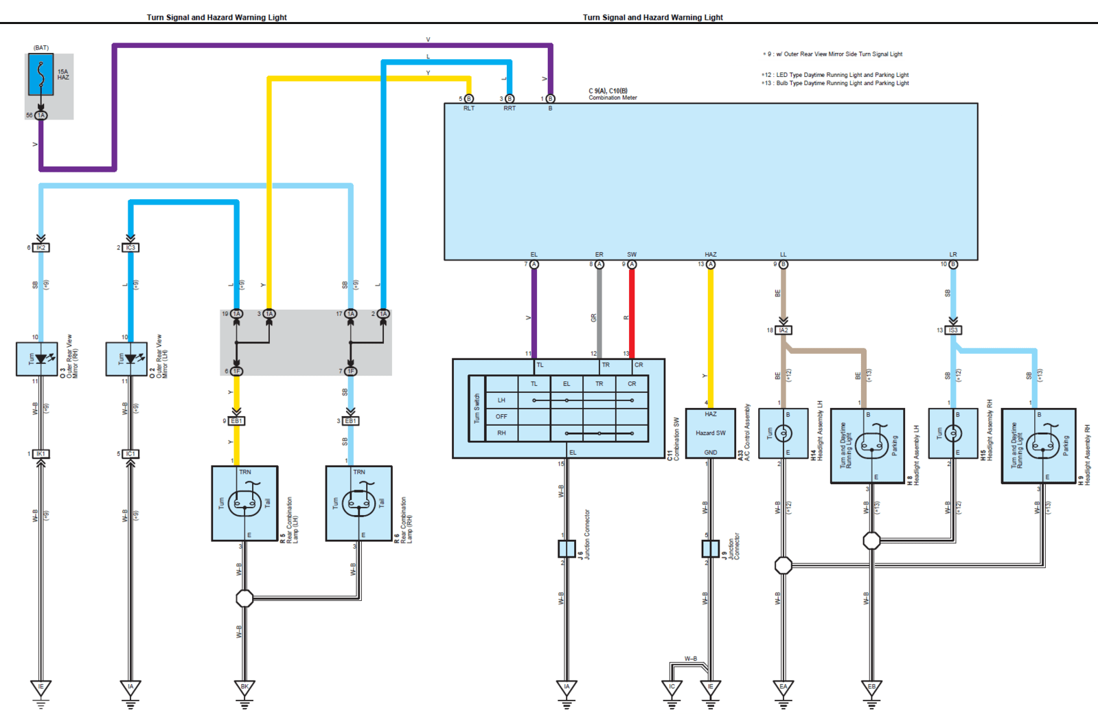

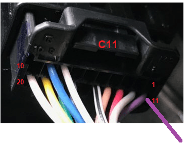

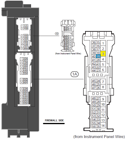

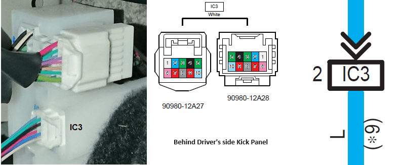

    So, might be light stalk, since it's what selects the ground to activate the feature. Jump the wire to ground at the light stalk connector.
    11 to chases ground.

    Indeed so, but process of elimination...

    Just the left details...
