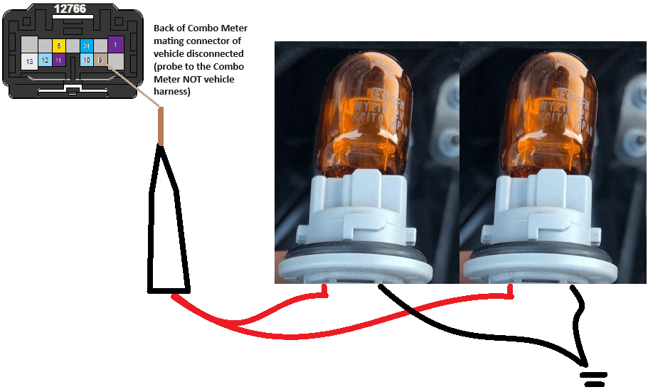

    If you have an electrical probe that uses a halogen (nor LED) bulb, you could jump to ground and verify flashing bypassing the vehicle lamp(s). If it hyperflashes while doing this then you 'll know it's a bad ground on the vehicle lamp(s).
    Best probe location would be at connector C10, behind the Combination Meter, at connector output, no connector attached.

    Remove the lamps with holders from left side light assemblies (front & back). Use them for test. Using lamps provides correct load to circuit and isolates from vehicle harness.
