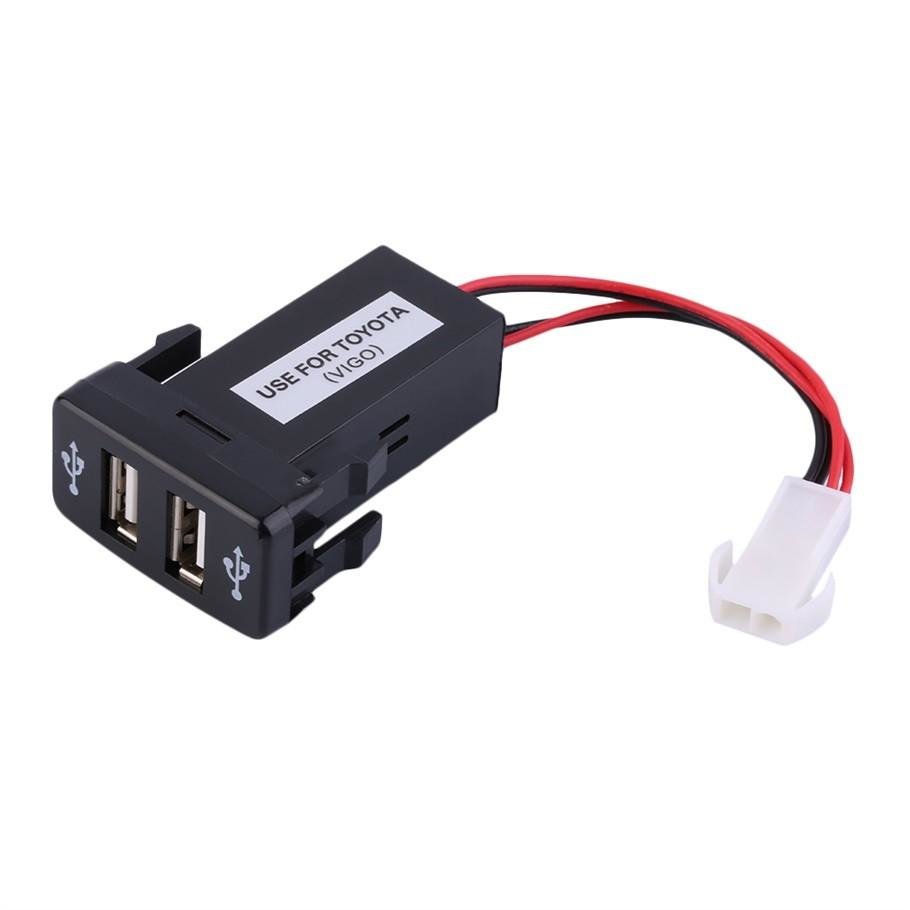

    Nobody uses a CLA anymore for its original intended purpose. And most people just plug in a USB adapter anyway. With the last slot changed to a switch hole, you can have a nice matching dual USB with something like this upload_2018-11-25_20-13-47.jpg

    Good point, that dual usb port looks like strictly charging.

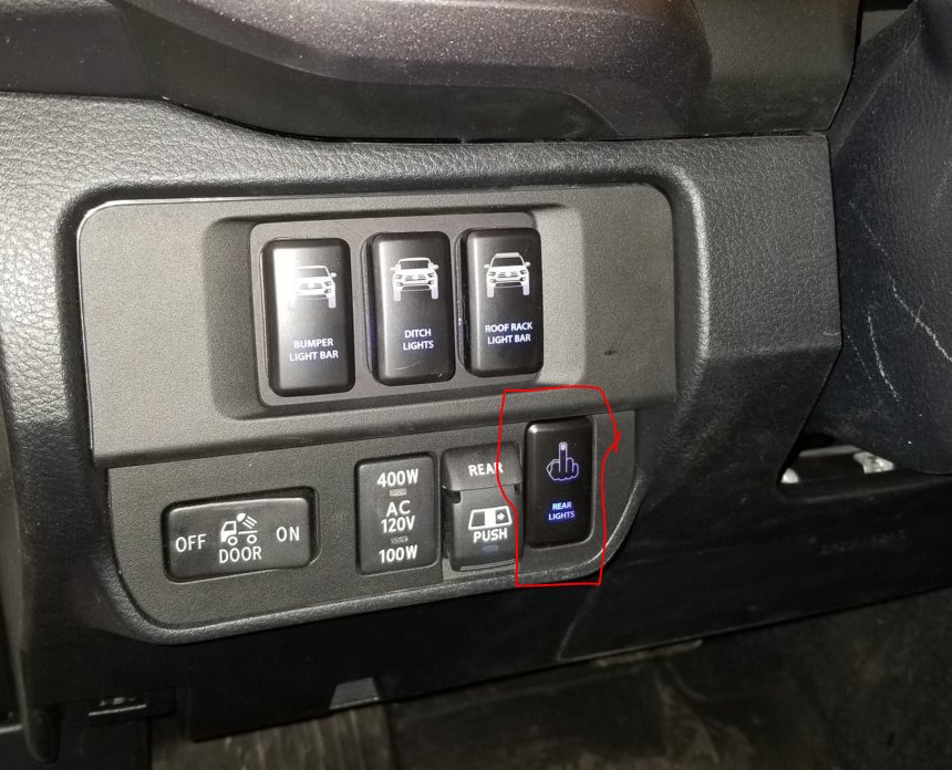

    What size hole is the cubby you have your rear light switch in? I've got an An AOB switch that says it will fit the OEM hole, however, that hole seems to be a different size that the switches in the center console. I think the switch I have may be the same as yours. If it is, also interested on how you wired it up since it has two separate light wires coming out of it.

    the switch plate bolts to the dash from the backside. The switches are CH 4x4 switches. here is the wiring diagram for everything I did:

    this switch just pops in in place of the blank with no mods though? @crabclaw

    yes, just pop out the plug and it snaps in
