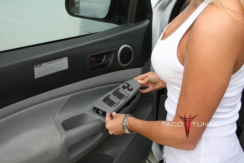

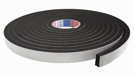

    jca1386 This sounds just like what I had... I thought my speaker was blown at first, but I noticed the sound was coming from under my switch panel.(song with bass squeese panel does the sound go away?) It was a simple fix, I got some 1/4" foam tape and put it around the underside edge.. No more rattle and clean sounding bass:cheers:

    Nice boob pic, btw. :thumbsup:

    haha... Yeah I did not notice she was holding the exact part I was referencing for a few min..The twins kept me occupied :hattip:
