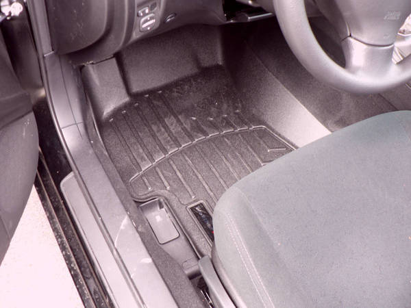

    Should anyone not having full use of their right leg, consider looking into a "Left Foot accelerator pedal". A very simple device that bolts to your vehicle floor and allows using your left foot to operate the existing factory right foot gas pedal. It is as simple as dirt, but it does what is supposed to. Most units "Flip" out of the way for other drivers use.
    Two/four bolts mount it to the floor. I have mine mounted to a 2X10X1/2 block of steel that is bolted to the floor.
    Hopefully I added the photo correctly here of a unit.

    Got a picture of the thing installed? Does it have its own return spring? The return springs inside the OEM pedal assy may not be strong enough to deal with the extra weight and friction.

    I have used my left foor pedal for over 30 years now, in over a dozen vehicles. I have not had a problem with it not returning to idle position when your foot is releashed. Keep it clean and lubed. Mine has a small hole for oiling the through shaft.
    I have found that bolting a 2X10X1/2 steel bar to the floor and then mounting the pedal to it allows me to straddle fuel and brake lines and position the pedal where I want it easier. I was able to utilize two existing holes by going through the front reinforcing rib. I bored 3/8" mounting holes for the plate then bored and tapped 1/4 holes for mounting the pedal to it. This also positioned the height better.
