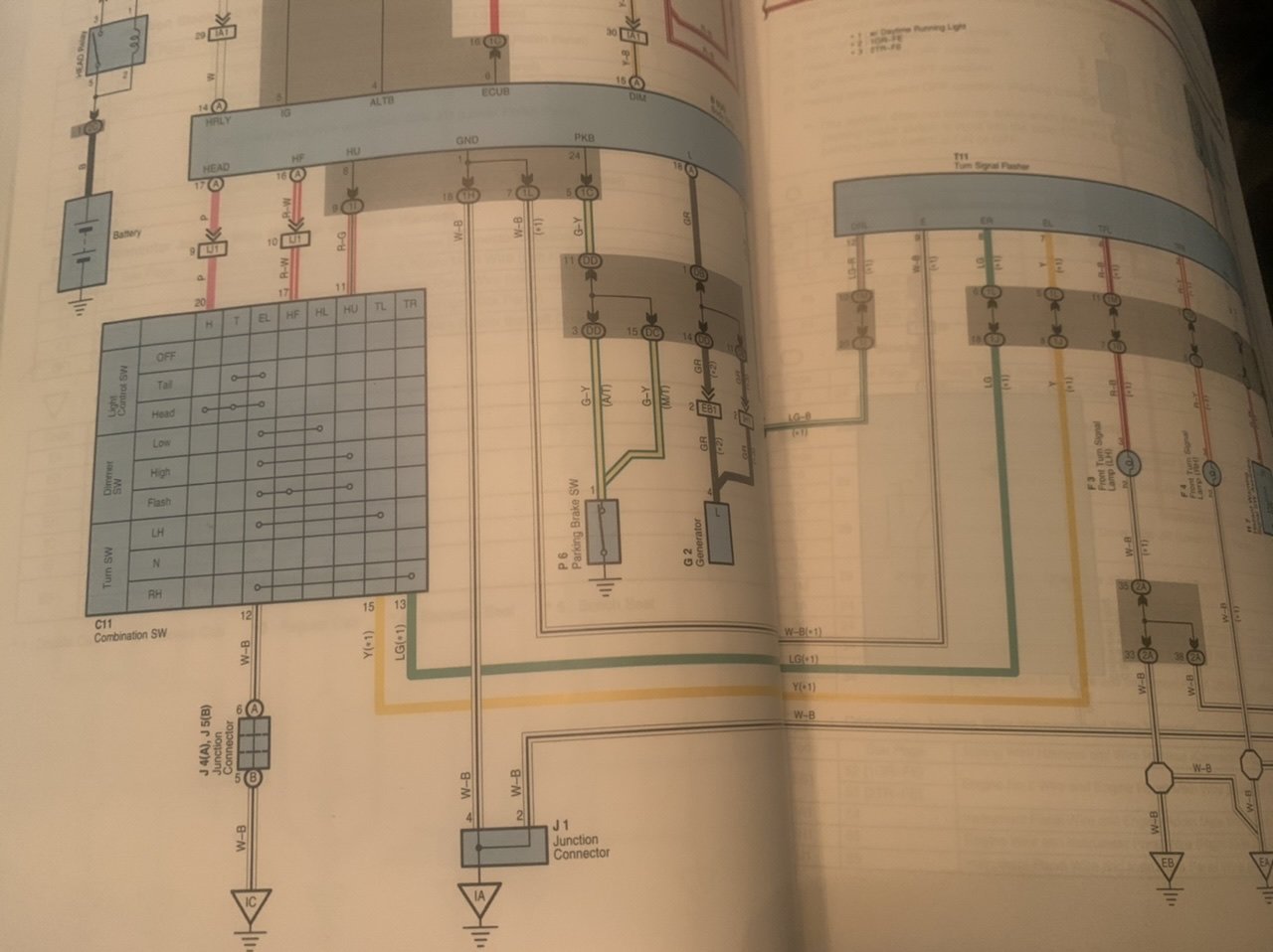

    I was driving home from a buddy house after a camp fire with food and beer and I had a cigar in my left and hand shifting (yes a manual) and steering with my right. Two lane road with periodic oncoming cards and turning the high beams on and off when it occurred to me why not put the high beam switch on my left foot? We grew up with VW's that had the left foot high beams. I'm guessing they went the way of the dodo bird with the onset of automatic transmissions and also cheaper to send up the wire to the steering wheel.
    Anyway, I've purchased the items below.
    https://www.amazon.com/gp/product/B000C9QXKA/ref=ppx_yo_dt_b_asin_title_o00_s00?ie=UTF8&psc=1
    https://www.amazon.com/gp/product/B005OUT8U4/ref=ppx_yo_dt_b_asin_title_o00_s00?ie=UTF8&psc=1
    Has anyone tried this? I could use some assistance with the wiring. I would like both switches to toggle the high beams. Worse case just the left foot to toggle the high beams.
    Yes I did my google searches and came up empty for a Tacoma. Plenty of much older cars with simpler wiring....

    Following. Id like to do this as well. Id suggest starting with getting a wiring diagram if you can find one.
    There's gotta be a toggle or a relay you could tap into that would make the switch work.

    1st, you need to figure out where you’re going to mount it so it’s not in your way when driving, yet easy to hit when you need it. After that, there’s at least 3 ways to do it based on the desired results. On low beam, the dimmer switch doesn’t do anything. Even though there’s contacts for low beam, they don’t connect to anything, so all you need to be concerned with is grounding the red/green wire for high beam.
    1. Disconnect the factory dimmer switch. Run the red/green wire to your new dimmer switch. Hook the common terminal on the new switch to ground. Now the floor switch will be the only 1 that works.
    2. Do as above but leave the factory dimmer switch connected. This will result in being able to turn on high beams from either switch, but you must use the same dimmer switch to go back to low beam.
    3. Wire the 2 switches like 2 switches in a house. This will allow switching from either switch, but sometimes the factory switch will be backwards, just like the switches in your house.

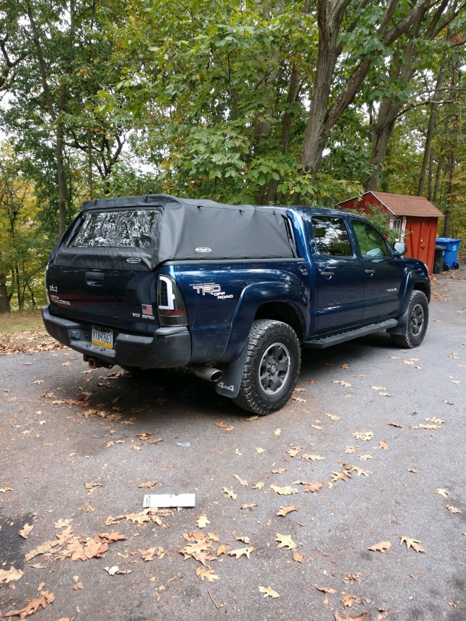

    Wow!! Thanks for the detailed instructions. I'll keep you posted on how this works. I figure in the next week or so I'll tackle this job. Just put a softtopper on my Tacoma this weekend. Getting ready to flat tow it to the south east for 6 weeks behind our RV. Escaping from PA where things are a bit to "tight" these days.

    I’ll be keeping an eye on this one myself as I have the same issues. How do you like that soft topper? I plan on getting a camper soon and i was thinking about one to help with storage and hopefully some aerodynamics as well by getting rid of that huge void between the cab and the camper.

    So far so good on the SoftTopper. Haven't driven it yet but the installation was easy and the quality of the top seems very good.
