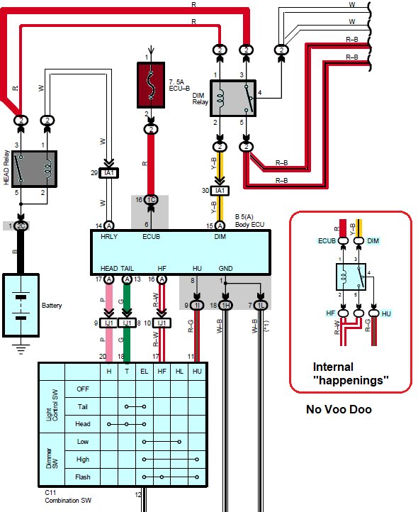

    Just a thought. How about keeping the factory wiring and lights as is. Mount a couple off-road lights and use the foot switch for that?
    I have used the foot switch for the horn in my single seat race car and have one in my motorhome for the off-road lights. It's fun walking into Autozone asking for the switch and they ask, "what year, model is this for?". I tell them, 1972 Ford Van.

    Although it's impressive that you have inside information to the internal workings of the body ECU, doing it your way will still have unexpected results. The most obvious problem is that the internal relay will remain energized indefinitely if you shut the truck off with the high beams on. Whether or not the high beams stay on is unknown since you didn't include the internal happenings of the head relay circuit when flash is engaged. I stand by my opinion that the proper way to do this is to use a switch that grounds the red/green wire, just as Toyota engineered the circuit to work, when you flip the lever to high beam.

    Your Voo Doo has crystal ball attributes, seeing the future for all who add the 1960's switch and leave it ON without perceiving the High Beams illumination. :burp:
    The ECU has a feature which I'm very certain you've seen in the tea leaves that the lights go off when you open the driver's door. But when all is off and you actuate any position on the stalk, it stays ON...
    It's difficult to anticipate ALL the variables; OEM Alarm, Aftermarket Alarm, Intelligent & perceptive DIY, etc. So I leave that to you.:thumbsup:

    I'm not going to argue any more on the possible adverse side effects of your way, but I am genuinely curious on the motive for your way.
    Please explain just 1 advantage to grounding the red/white wire instead of the red/green wire. Without trying it, nobody here knows what will happen if you duct tape the turn signal lever in the flash position and leave the truck for a few days.

    After careful verification, I have to agree the best High Beam selection wire is RED & GREEN. :anonymous:

    I finished this last night. I'm happy to confirm it works as described, and both locations still work.
    Red/Green wire from under the bottom steering column clamshell (right at the turn signal/headlight stalk connector) to the top post on the floor switch, and one of the bottom posts to ground. Easy-peasy.
