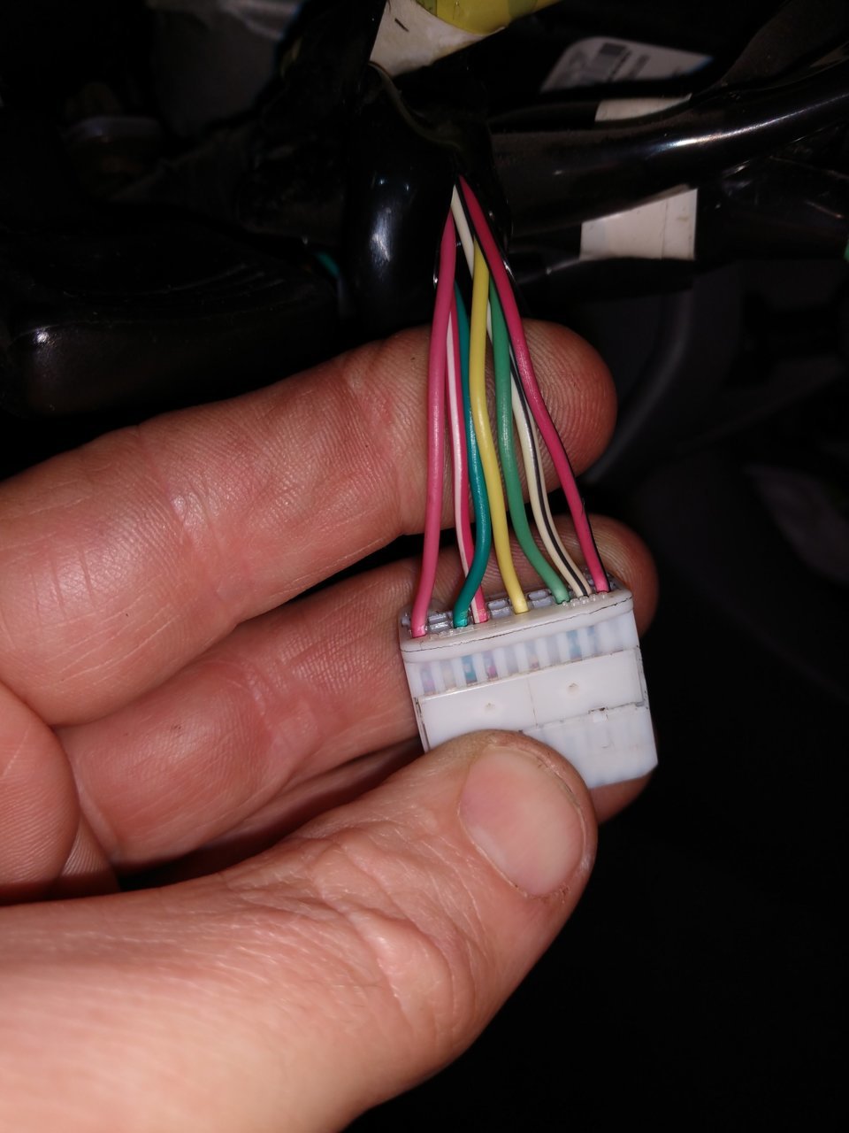

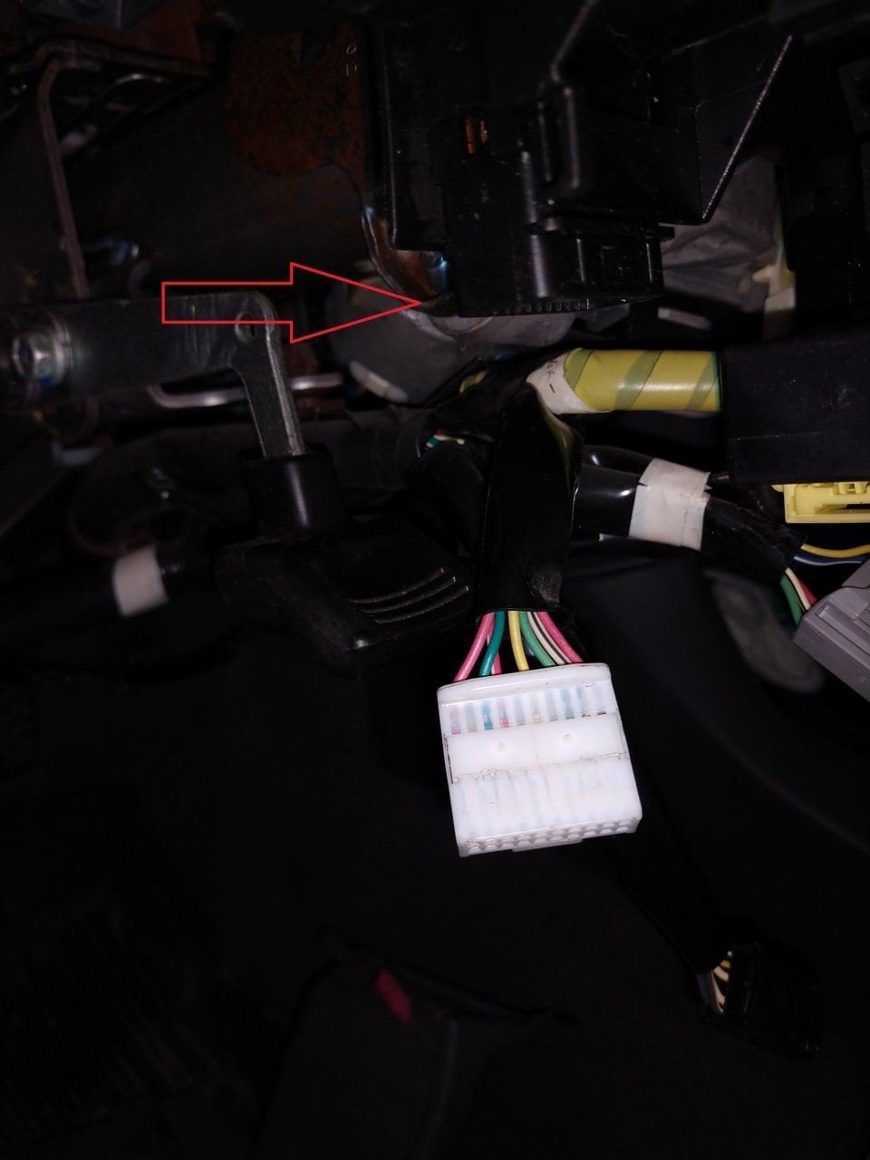

    So I have the dash torn apart (thanks for the tip about the steering wheel) and the connector just under the turn signal headlight stalk (below). But no red/green wire? What am I missing? The red arrow is where the connection plugs into under the stalk.

    Your pic is really dark, but on my 2011 it is in the white connector shown in middle of your pic. I had to carefully trim back the shiny black plastic sleeve around the wire bundle to make room for a wire tap.
    Is there a red-green there?

    No other wires besides what you see (below). Mine's a 2007.

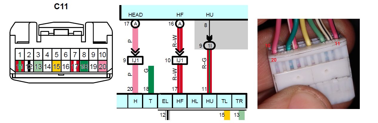

    So Pink/Blue it is? Correct?

    99.9% yes
    No idea why it's a different color for an '07. '15 info I have has same colors as '05.

    Success!!!

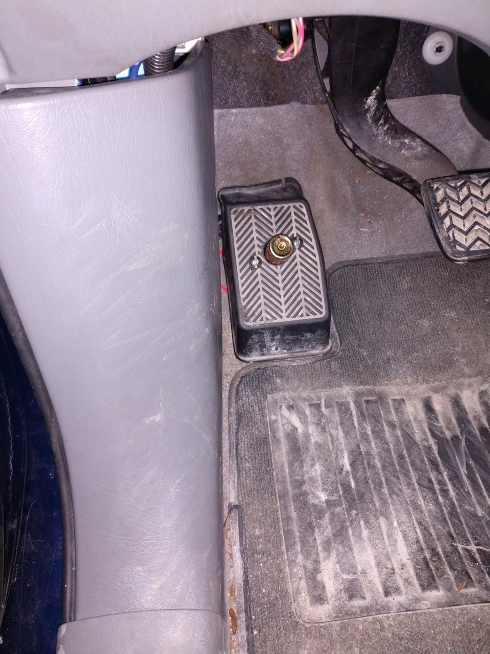

  12. Jan 18, 2021 at 6:31 AM
    #72
    mgord
    mgord [OP] Well-Known Member
    Jan 14, 2009
    #12563
    234
    Harrisburg, PA
    07 TRD
    K&N, Leaf Springs, Home Built Camper
    All finished.

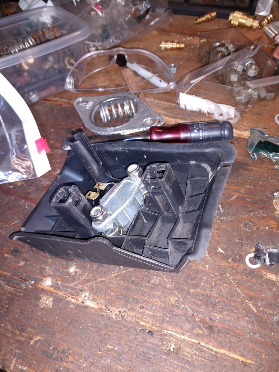

    Wiring soldered and wrapped:
    I dug out the plastic spines then offset the whole switch with some nuts. I didn't want it to stick out to far.

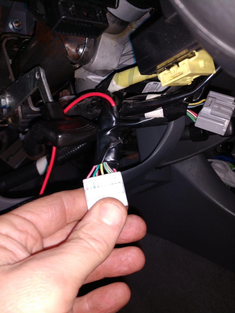

    Installed and working:
    Solid and clicks nice and easy with the left foot. My only worry is it is in the middle of the dead peddle. May have to move it up if the button gets to much in the way of my left foot. I tend to use that peddle to push off and "settle" myself into the seat. Driving I should be ok since my foot is angled slightly anyway on the dead peddle. Time will tell.
    Fun project!

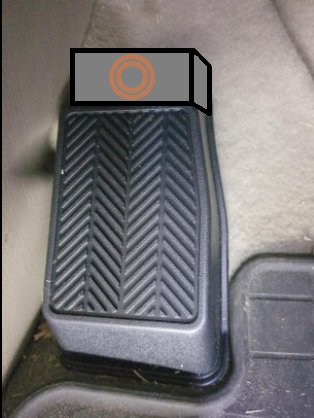

    If I were to install it...
    Small box ABOVE the foot rest...
    SilverBulletII and LC7 like this.

    May do that. Also thinking about getting another foot rest and "merging" them together. I have big feet so farther up will be required. Biggest issue is where to mount 2nd foot rest (either way) without drilling holes.

    Place board-like material on top of the original foot rest. measure and cut to length. Modify the second oem foot rest to match the new top length. One would secure it place, the other as "support'.
