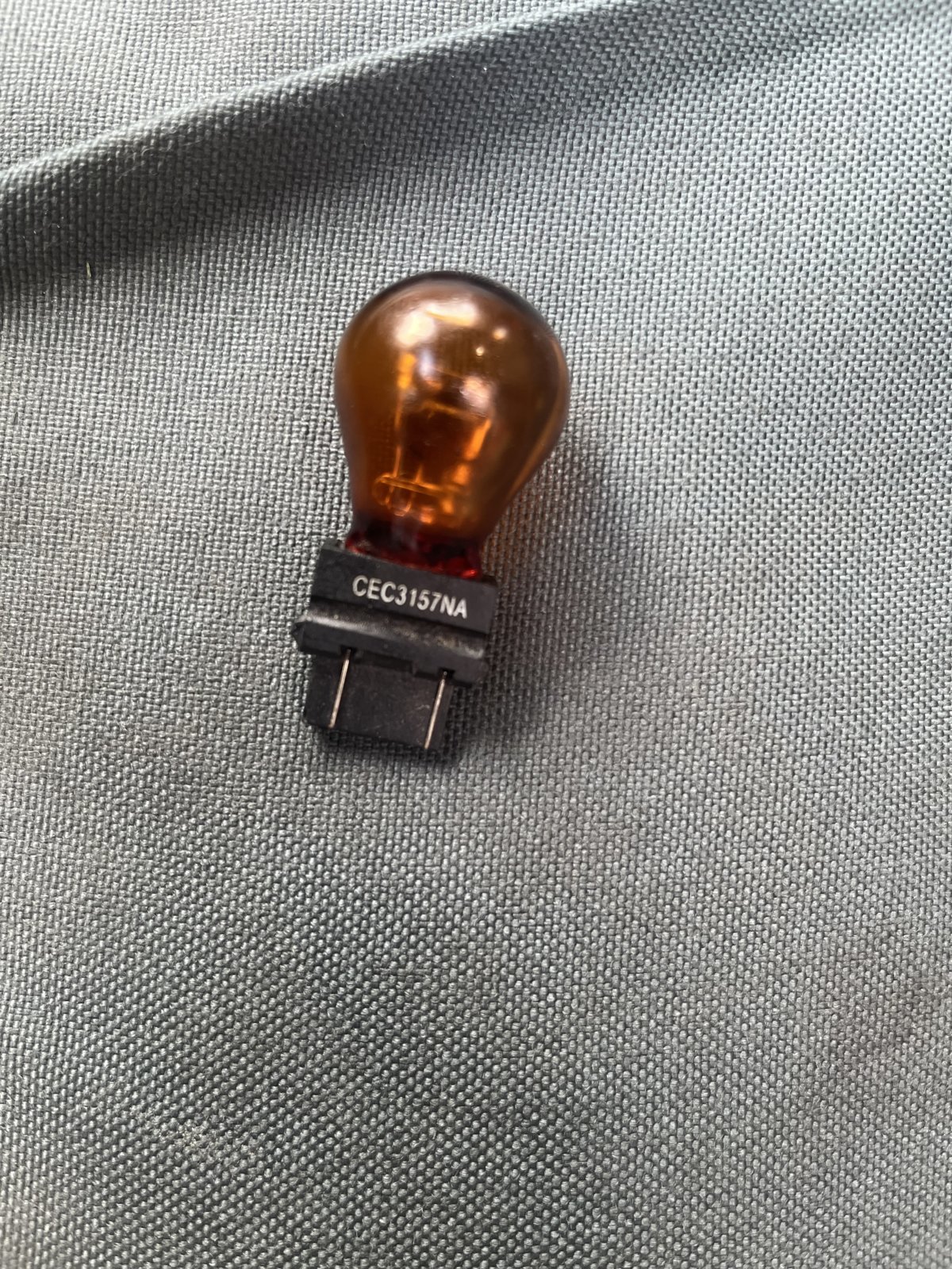

    Is this the correct bulb? It fits socket but slides not seem to click
    HondaGM likes this.

    Should be a 4157 but the only difference between 3157 and 4157 is the wattage, socket is the same.

    It really sounds like the issue is in the socket, the only difference between the NA and the NAK bulbs is the NAK bulbs supposedly stay cooler so as to not melt the housing being that they are the DRLs.
    I see alot of issues with bad connections in those type of sockets, sometimes you can take a diamond file and clean them up but if they are burnt/melted it's better to just replace the socket.
