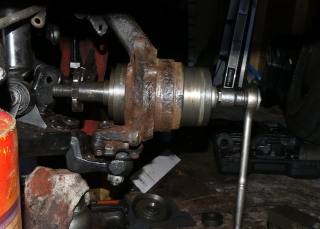

    Ok. I see. I was confused by "spindle". I was thinking axle. You were talkin' hub. I picked up the loaner press I used to do it the first time, so I can easily see if there is any wiggle room I missed.

    This is how I pressed in the bearing. The adapter sat perfectly on the outer race.

    no issue with the bearing, the c clip either fits or it doesn’t, the spindle or hub as you say that gets pressed into the bearing is where I think the issue resides. I use a 20 ton air over hydraulic press with PB blaster prelude and wheel bearing grease and even then sometimes have to re-attack after the first engagement to seat it properly inside the bearing. The cv nut won’t seat it and it will just continue to wobble around. This is why ADD crew can’t just pull a bad CV on the trail and go but the manual hub guys can.

    I believe I've seen this pic before and couldn't make sense of it.
    You changed an ADD hub bearing without taking the spindle (whole assembly) off the truck and pressing everything flat?
    I didn't think that was possible with the way the hub/bearing has to press back and forth.

    I was asked if I took pics when I did the right one. I had not. So this is the left. I also used Timmy’s vid as a guide & for tips, etc.
    https://www.tacomaworld.com/threads/front-wheel-bearing-replacement-diy-using-loaner-kit.716571/
