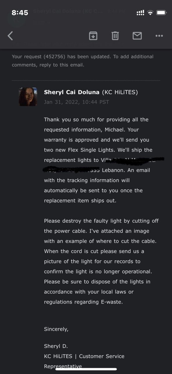

    Wow they are honoring my warranty and even sending me replacements all the way here to the Middle East. I love KC. Definitely will continue purchasing their products. They want me to destroy my old lights which seems fair.
