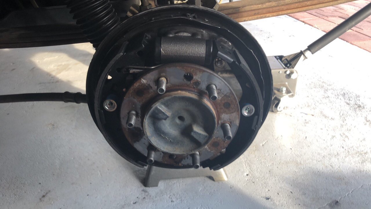

    Fellow 3rd genians, I urge you to check your rear drums ASAP. My left rear brake came apart inside the drum this morning on the interstate and a small fire ensued. No damage, fire was contained to the drum and extinguished almost as fast as it started.
    This is the absolute first problem I’ve ever had with this truck.
    Once I got the truck to Toyota, they told me it would be $1400 to repair since brakes are not covered under any warranty or extended warranty, as expected. I e-braked the truck 18 miles to the house with a quick stop at Autozone to pick up new shoes, hardware, and cylinders.
    When I got home and tried to get the drums off, they would not budge. After some beating and prying, I discovered that the shoes were not retained to the hub and were pressed against the drum and trying to come out with it. BFH time, finally beat them into submission to find that the hold down springs were missing and the pins that the springs go over were simply bent to stay in place. I looked and looked and couldn’t find the springs or retainer cap anywhere.
    After getting that side replaced and cleaned up, I checked the other side to find the same thing.
    I called Toyota and explained what I had found and they told me it still wouldn’t be covered under factory or extended warranty. Either way, I have it fixed and I urge you to check yours. I have 48k on the clock and never had an issue until now.
    Only pics I took.

    I couldn’t believe it when I got the drum off. I thought I was going crazy for a minute. I reassembled the shoes that were on the truck and everything but the hold down springs was there.

    Missing parts...

    Bought it new, first time the rear brakes have been cracked open.

    Please tell me you took pics of the brakes with missing retainers. I agree....NHTSA report time. Then tell Toyota about the report and keep on them.
