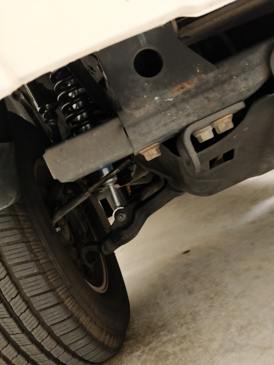

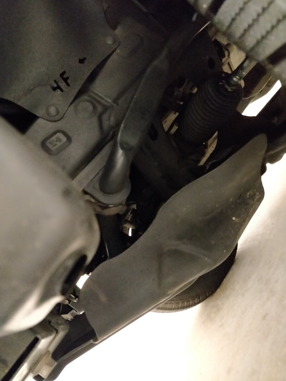

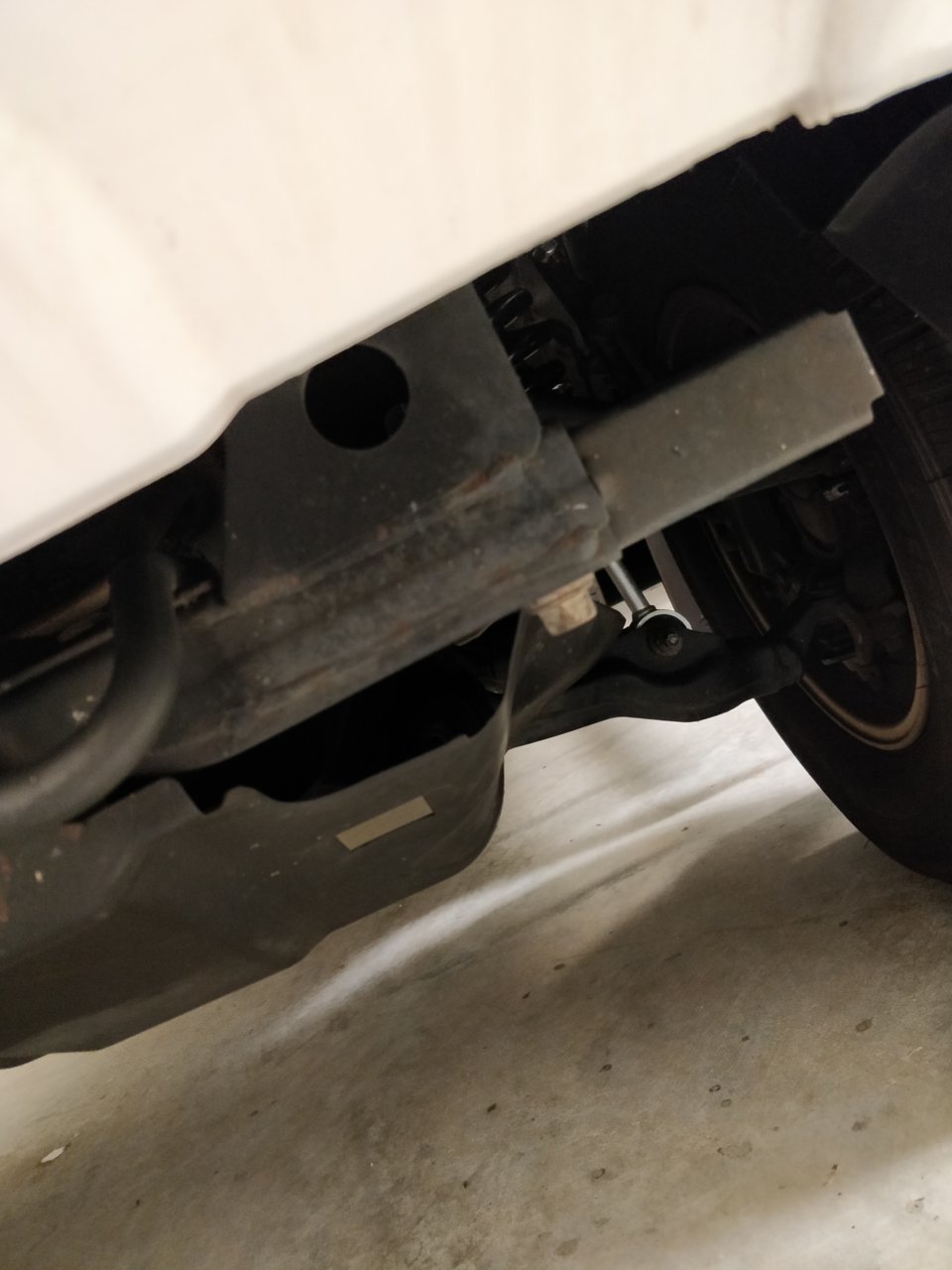

    Photos up.
    Yeah I have no idea how this happened

    So after messing around so more and doing some gentle driving over bumps in the truck court of my office I think the sway bar may be hitting the plate?
    Once I am home I will jack the front up and see if the sway bar touches the plate.

    its your steering stop on your knuckle / spindle where it meets the LCA. common thing, put a lil grease on it or just dont crank the wheel full lock (hit full lock then back off a smidge)

    thats not a skid plate, rather a 'splash pan' in Toyota speak. Just give it a push in with your hand on the side, it'll bend back over about as easy as tin foil.

    Yeah, if I can get a better photo I will. From the front of the truck, the right side sticks out like... 5-6 inches more than the left which is almost vertical.

    Wow yeah that's so much higher up than mine. Haha
    I'm still unsure how it came down far enough for the tire to hit it. :/
