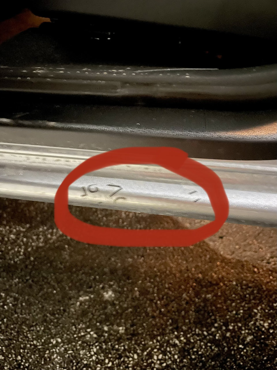

    Just came home with a 22 Tacoma OR and discovered this on the driver's side door. It appears to be some sort of sticker (?) and it clearly came from the factory or in the 24 hours that it sat at the dealer. Doesn't come off with a quick "thumbnail inspection." Any idea what it is? Any idea how to get rid of it? Should I whine to Toyota? Tacoma_DoorSillSticker1.jpg Tacoma_DoorSillSticker2.jpg

    If you have a buffer/polisher you could buff that area, looks like it'd come off without too much effort. Otherwise yeah just go back to the dealer and they should take care of it.

    It'a "clear" wrap to protect the paint during shipping.
    It says "dealer to remove" or something like that.

    Time to bust out the cleaner wax. Looks like leftover ink from some shipping sticker. Hardly ever said in the literal sense on TW but it WILL buff out.

    This is really helpful. Mystery solved along with a solution! Thank you, all! *grabs cleaner wax and buffer*

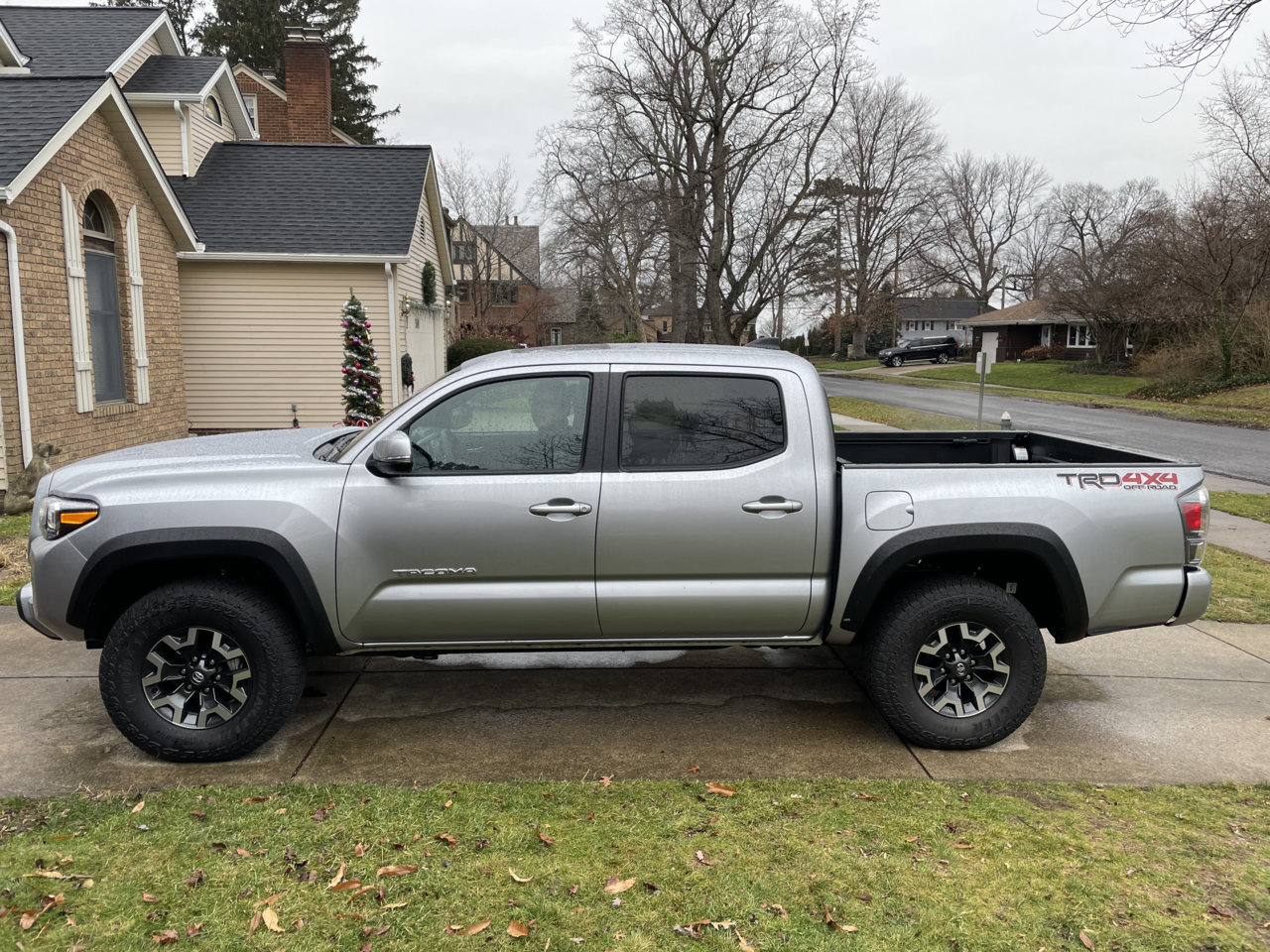

    :itllbuffout:<< seems appropriate here. :)
    Here she is. '22 OR just waiting to be de-badged and the princess of the parking lot!

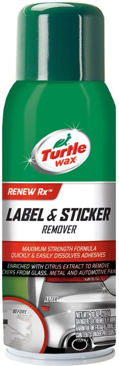

    Turtle wax makes a citrus sticker remover. Spray on, wait a few minutes and wipe it off. If that doesn’t work you can find plastic “razor blades” at ace or Home Depot to carefully take it off after spraying it again.

    This is the stuff I use.

    Looks like white gold , Beautiful!!!
