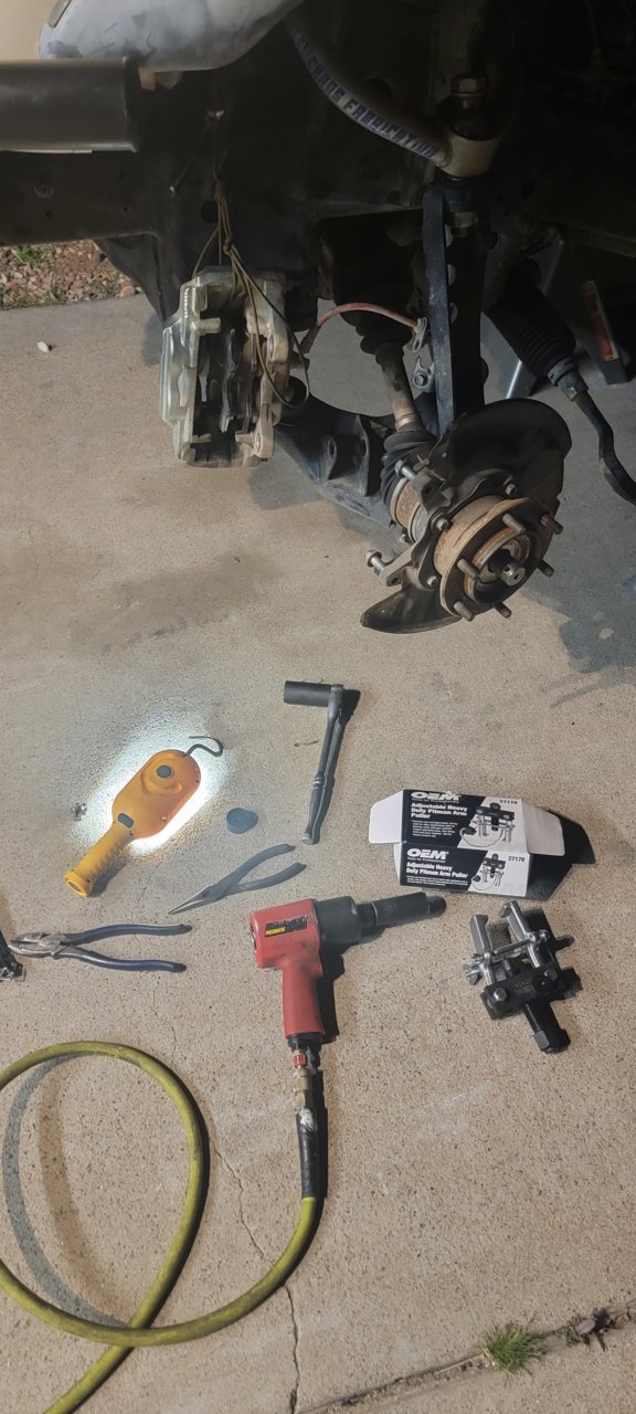

    Finally got some time off work and the motivation to do some work on the truck. Still need to order some parts but I have plenty to do in the meantime.
    Got to use a new tool on the lower ball joints. Made it so much easier to unseat them from the lower control arm. I rented it from autozone last time beacouse my other pullers kept spreading apart. This new puller is a little fiddley to start but seats nicely and dosent tear up the boot. A couple of turns with the ratchet and POW!! Easy peasy!.
    OEMTOOLS 27170 Heavy Duty Pitman... https://www.amazon.com/dp/B004FEPE80?ref=ppx_pop_mob_ap_share
    The air impact made quick work of taking off the cv axle nut. Didn't have to try and wedge a bar between the wheel studs or have to put everything back together. Just a Zipp!! And there off. So next is to pull the axles and lower control arms off. I'm gonna change out the bushings in the steering rack too. Iv trying to get the shocks sent out for a rebuild and the fittings changed so I can get the resies mounted.

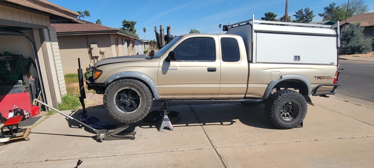

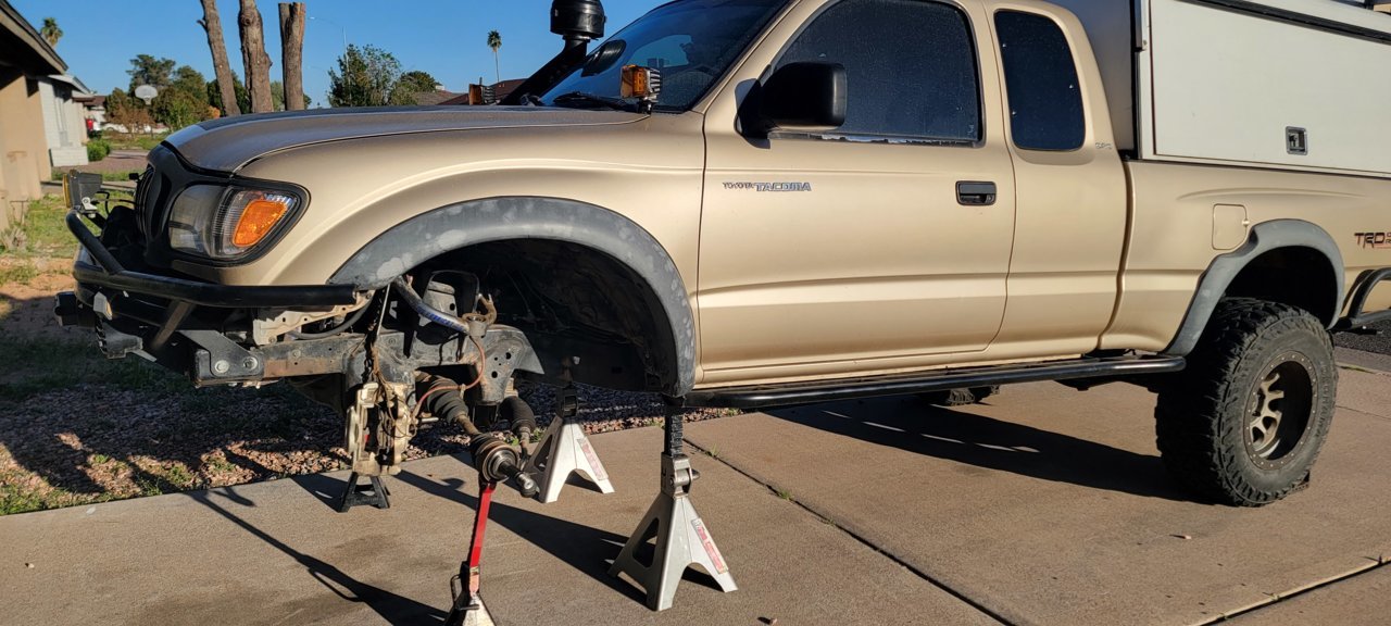

    So the front is in hovercraft mode, which seems to be a theme at my house. Finished getting the lower control arm off and new bushings installed on the power steering rack. The rubber bushings on the rebuild rack sure allowed for a lot of play .I should have just replaced them when I got it. Lessons learned I guess.
    The new control arms are ready to go now I just need to see if there supposed to have washes or just run them without. Should be cool to see the difference between the polyurethane and the white line bushings which allowed for a lot of play.
    Definitely need to order new parts for the upper control arms.
    New durobumps. I've put a whooping on them.
    My lower ball joints have a lot of play in them so I'm debating on which to get.

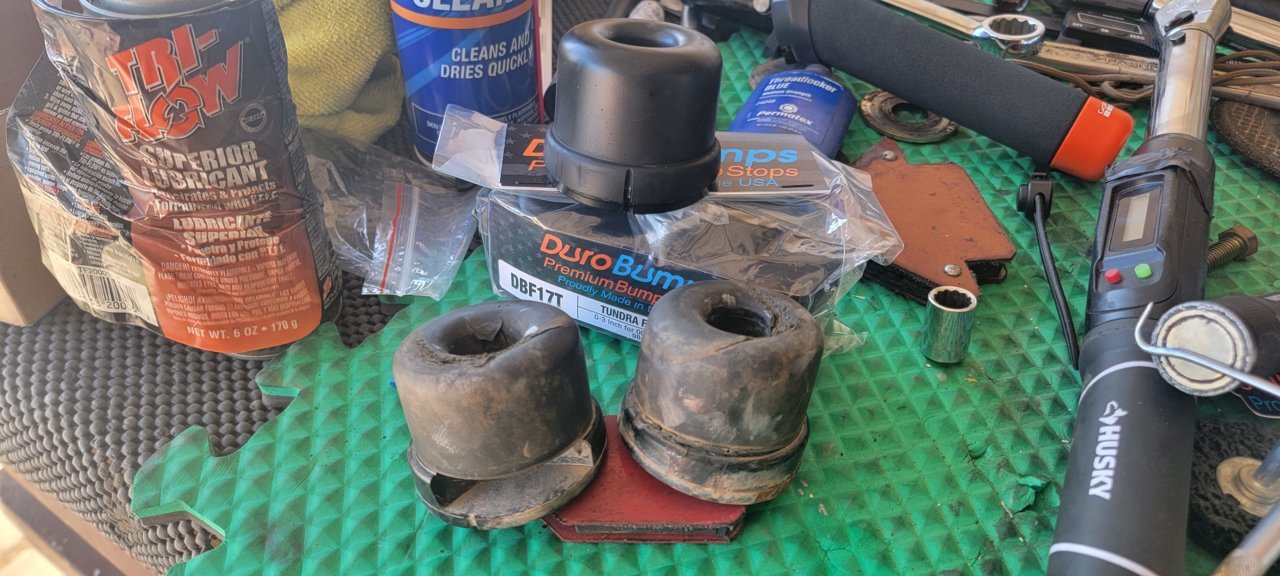

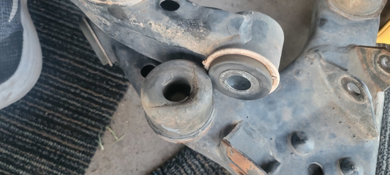

    Apparently I've put the durobumps through there paces.they work great but there durability is definitely suspect.

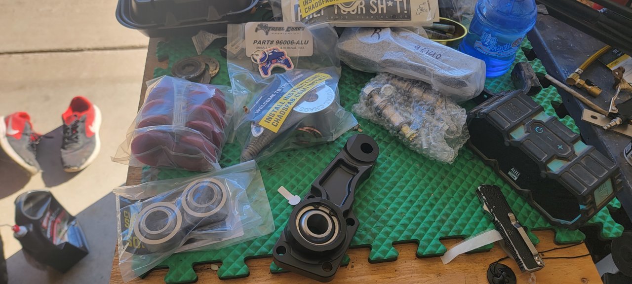

    Brown Santa delivers!!
    I didn't sleep for shit yesterday because I had to sign for the delivery, but I'm super excited!!

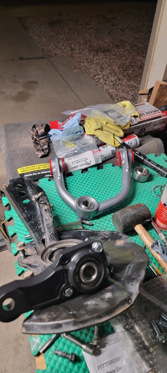

    So these are the parts to rebuild my upper control arms , new bushings, uniballs and the installation tool.
    Oh and the new lower control arms uniball jt. Hopefully it plays well with the solo power control arms.
    Hopefully I can get it done relatively quickly. The shocks are at the relbuilders tell sometime next week.
    Also I reached out to durobumps well see if they warranty them. The bumps have been awsome, the new arms have strik pads. May be time for some cans.

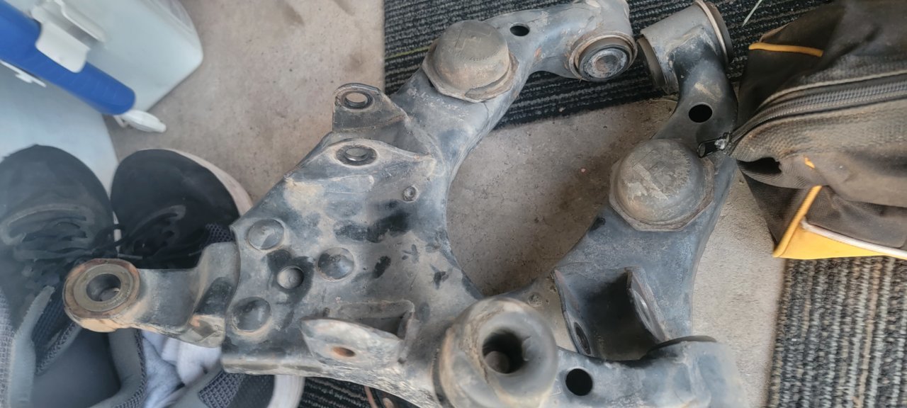

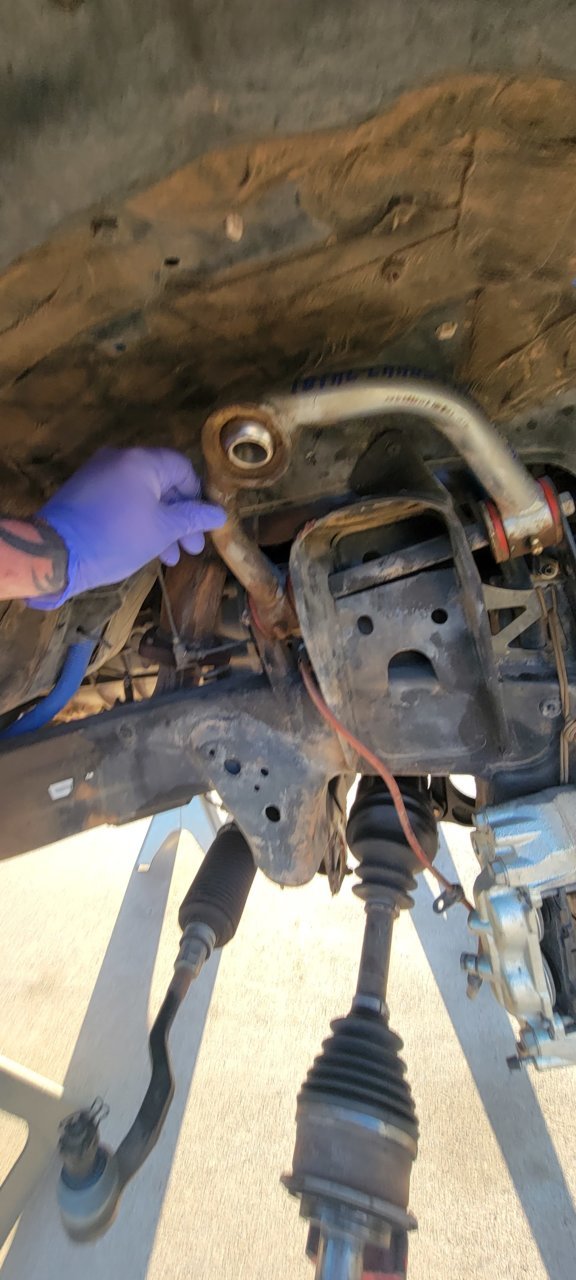

    Well I haven't been as productive as I'd hoped battling some gastritis. But the upper control arms are off . They were super dirty .so I decided to give em a good scrubbing and then turned to the frame .it's looking kinda ruff with some surface rust , so it got a good cleaning and decreasing in prep for some paint.
    This was the less dirty arm.
    Coffee was definitely kicking in on the second pic.
    These uppers have been on my truck for about 6 or 7 years now. And actually looking somewhat ok. I haven't dailyed my truck in about 4 and a half years so they probably only have like 45k on them.
    Sixthelement likes this.

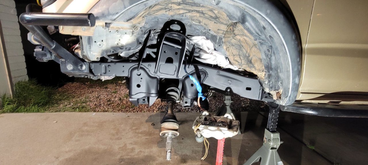

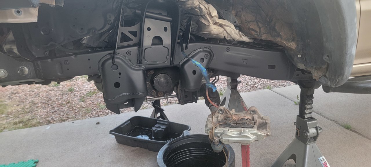

    Got everything cleaned and a initial coat of paint on the frame.
    Before
    After
    Had to call it for the night ended up clearing off my work area so that I can start rebuilding the arms and getting everything together.

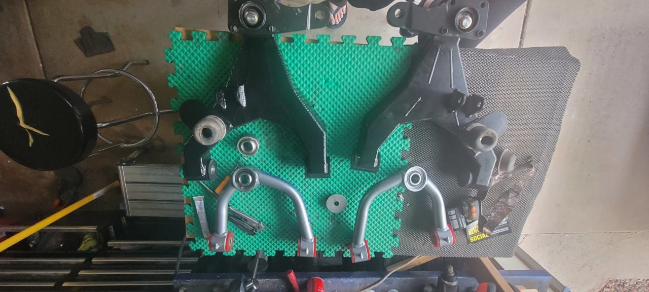

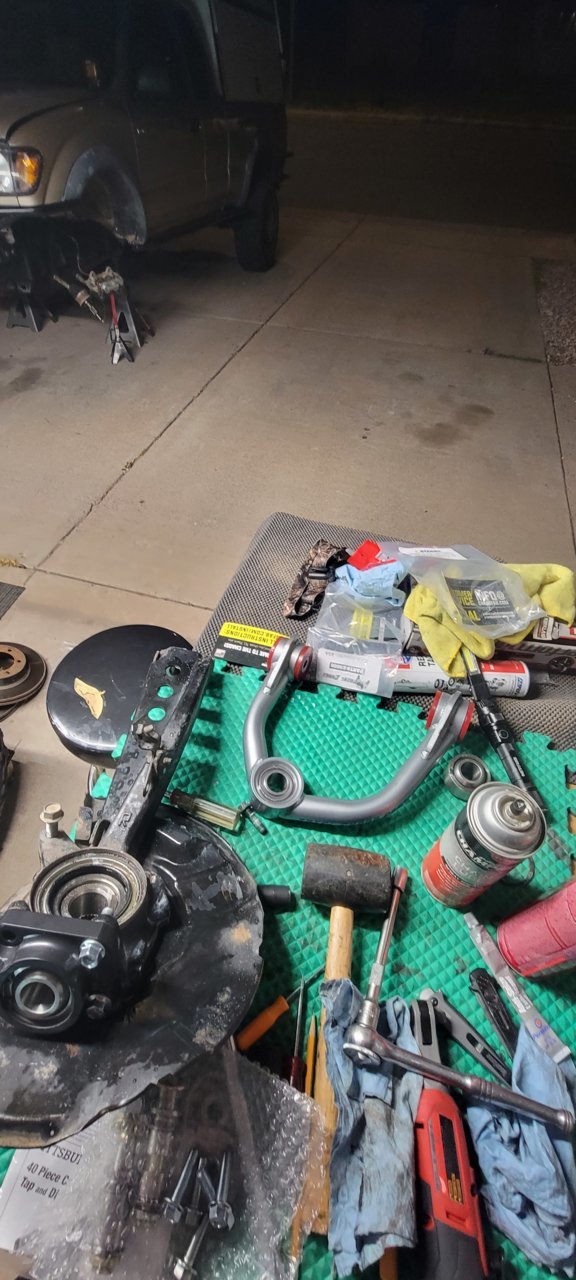

    Figured 1am was late enough to stop harassing my neighbors before getting a noise complaint, although my neighborhood was once referred to as having culture. So probably not lol. Anyways,..

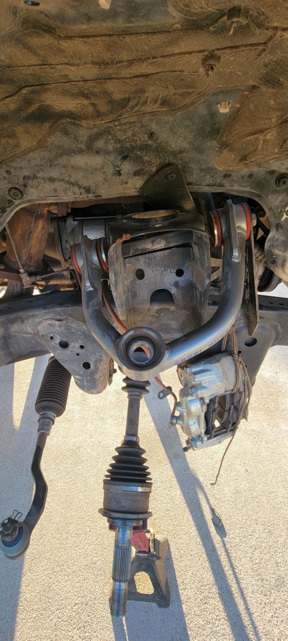

    Got the control arms taken apart ,cleaned and put back together again with new bushings and new uniballs. I picked up the installation tool because it will work with the new lowers too. The old uniballs came out so easy I probably could have done it with a c-clamp and a couple of sockets. But having the right tool makes it easy too. The bushings were a little tuffer and had to go in the vice to get the center sleeve in.
    Taking one of the lower ball joints off while the knuckle was on the table, was a bit of a challenge when you can't run the air tools. Got it done and the threads a bit chased out too . Which is difficult too because the break sheild is in the way. And there's not a socket that fits the tap ... and I just realized I need to try a wrench..... test fitted the new joint.:rasta:

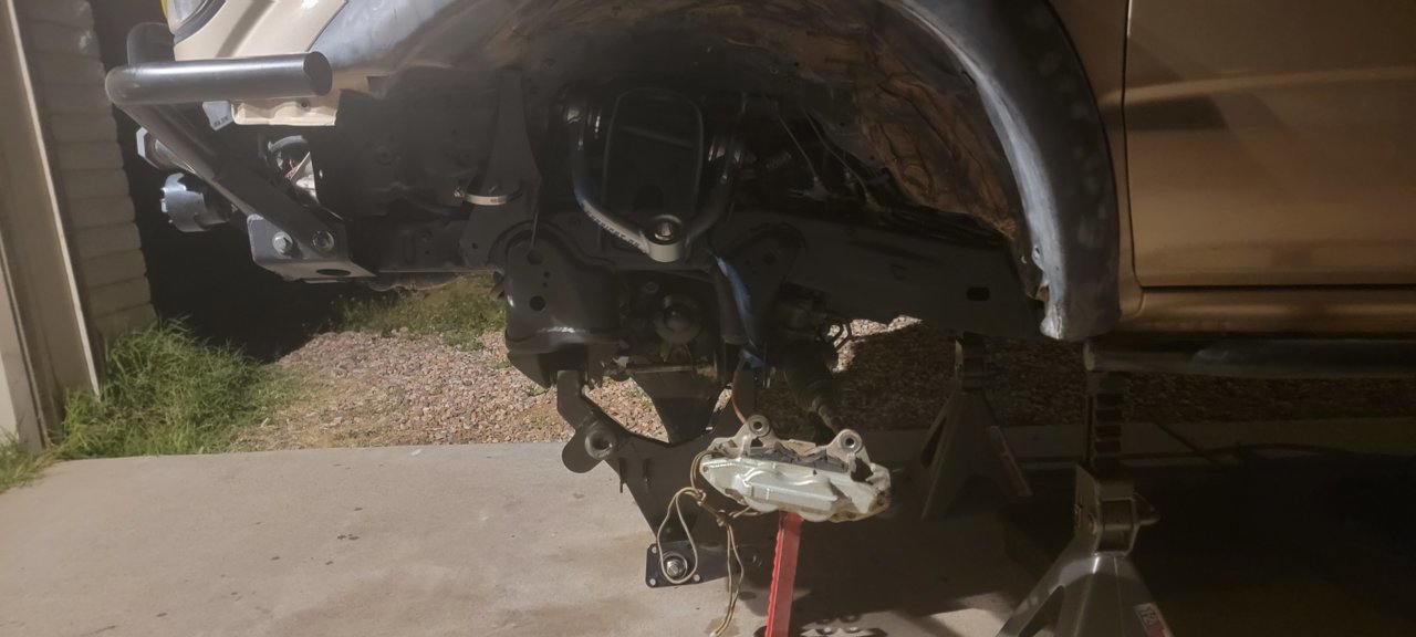

    Well Zippy, my newly named air impact made short work of taking off the other lbj with the knuckle on the table. Managed to get the treads cleaned out . Had to use a crescent wrench to turn the tap.
    Snugged up the new joint on the new arms after having to move them twice. I thought I was being smart by torquing the down then realized there was now way they were gonna move buy hand to get lined up.
    Got the CV's out and realized that the passenger side seal was leaking. So I'm going to fix that today as well as picking up the rebuild shocks.
    Also got in contact with durobumps, said that there sending me a new updated set. Nice!!

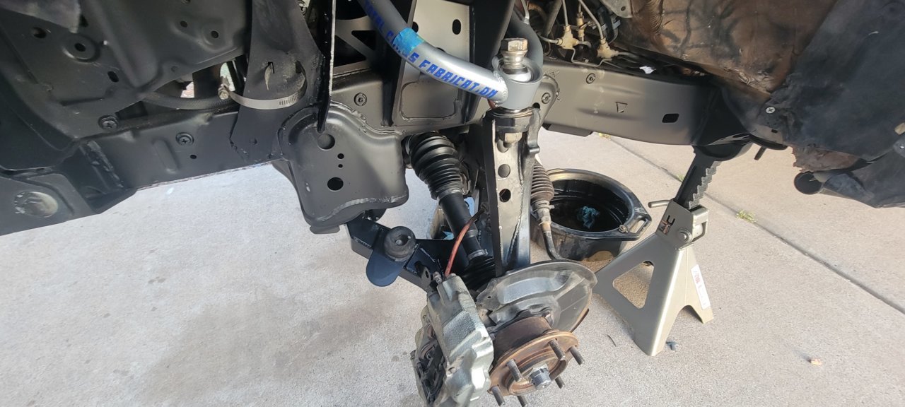

    So my day things were gonna just happen on there own time. Was able to pick up 1 pair of shocks, my front diff seal and had lunch, at an old stomping ground and took in the sights.
    Finally got home after a nap got to work on the truck.
    The seal looks to be the wrong size ,so that sucked.
    Burned in the resivor mounts ,Installed the upper and lower arms .then changed the ball joints ,again! For whatever reason I thought the passenger side was the left. So now everything is on the correct side. So the seal well I guess I'm gonna rock it and see what happens. I wonder if the other CV's weren't sealed right.
    So this is where she sits.. had to call it an early night since my daughter just flew into town and needed a ride.

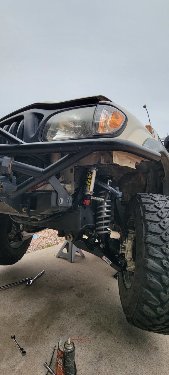

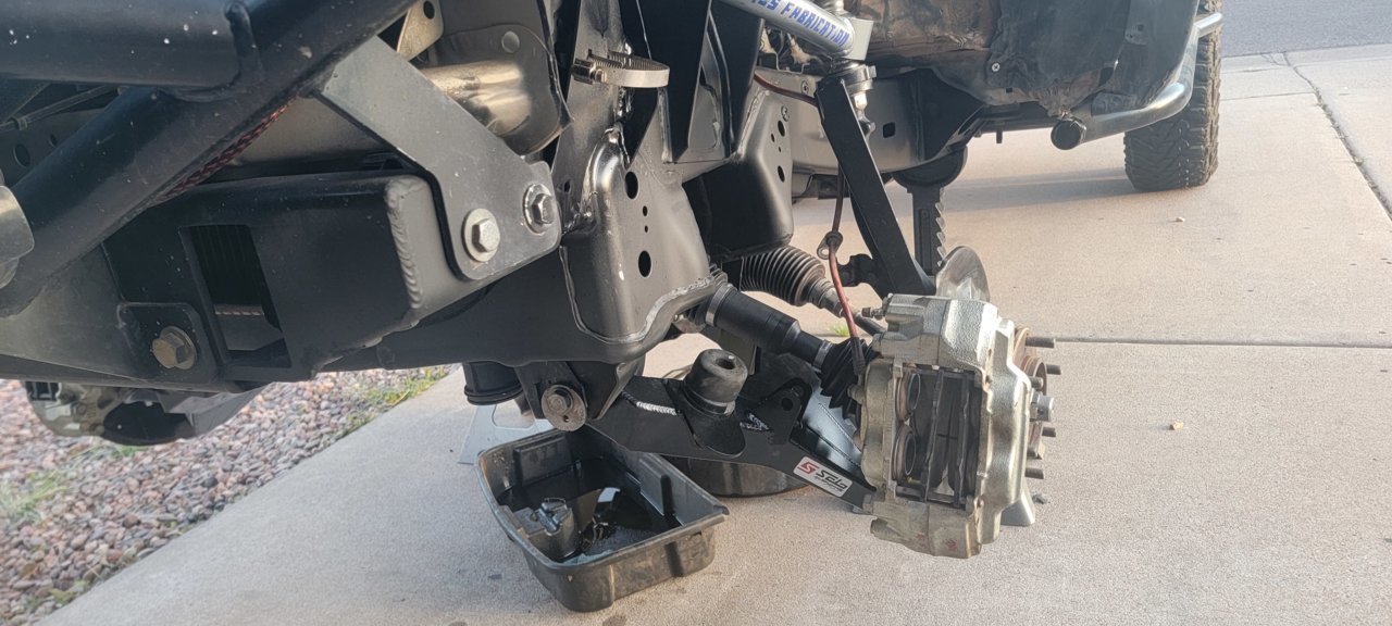

    Was able to get some more work done on the truck.

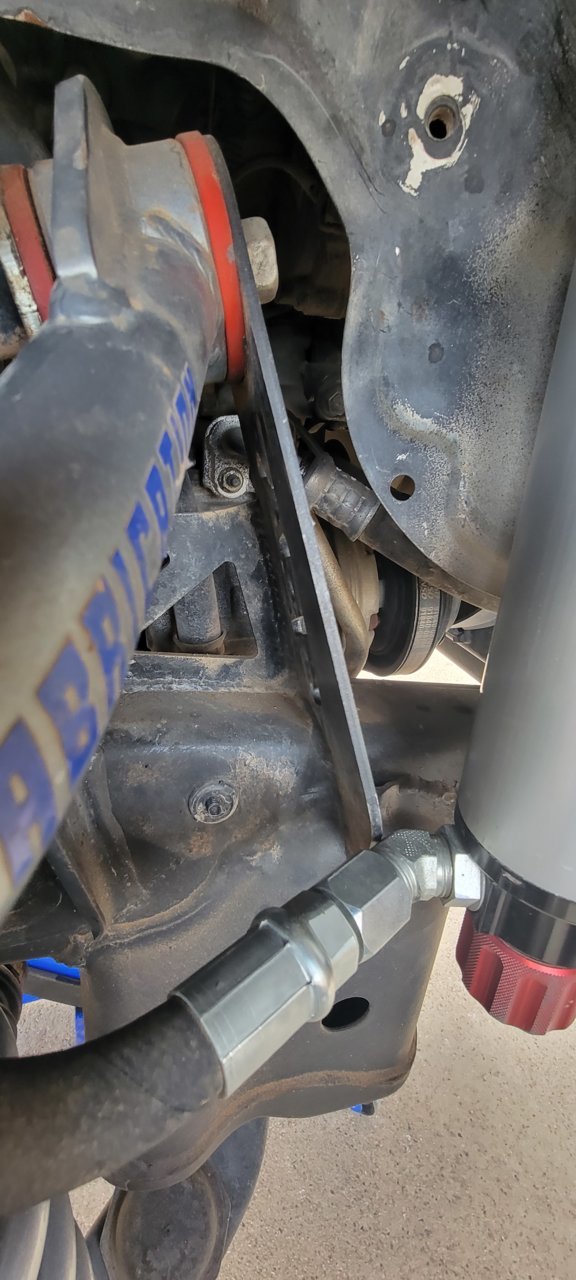

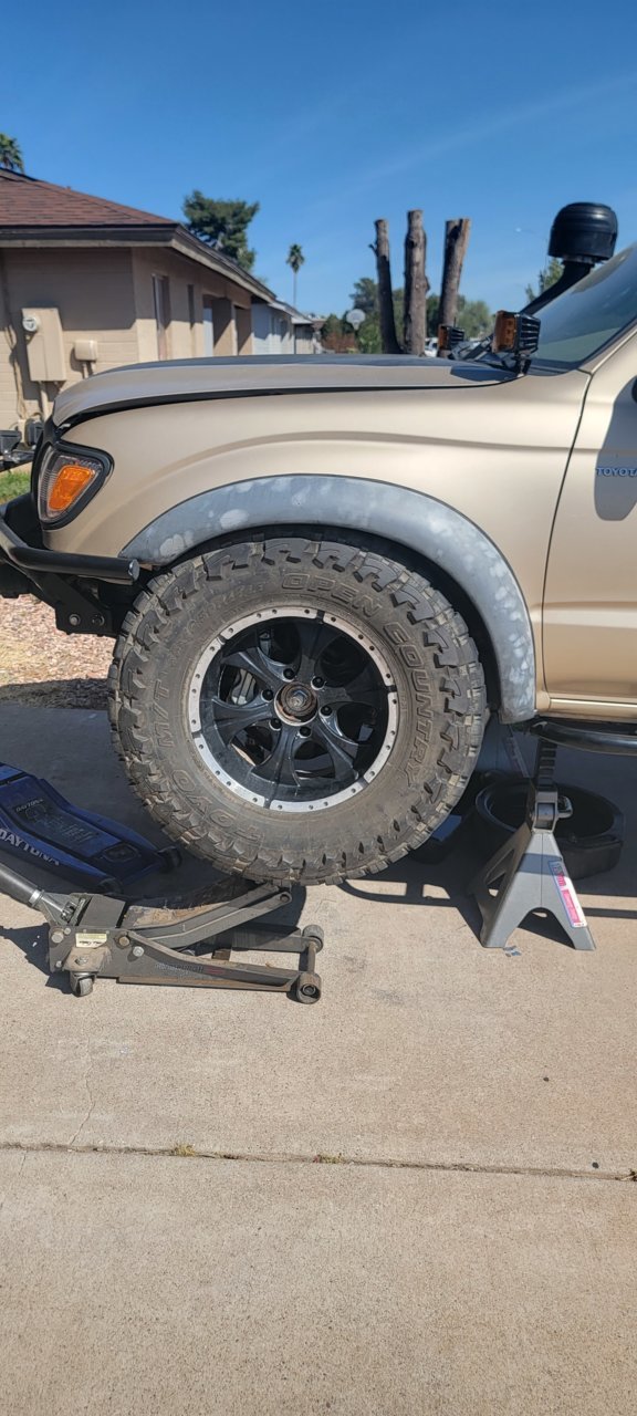

    Cycled the suspension. My tierods are binding on the last inch or so of trave.,and my knuckle brace is hitting the coil bucket. Otherwise it cycles about 9" of trave without the shocks..
    Through a slightly bald 35 on to see if it clears .
    It dose tuck, but hits the inner part of the upper flair and it rubs just a tiny bit on the firewall section of the flar. I'll see how it looks after an aliment. The plan is to goto a 285/75/17. So I think I'll be good without having to tub.

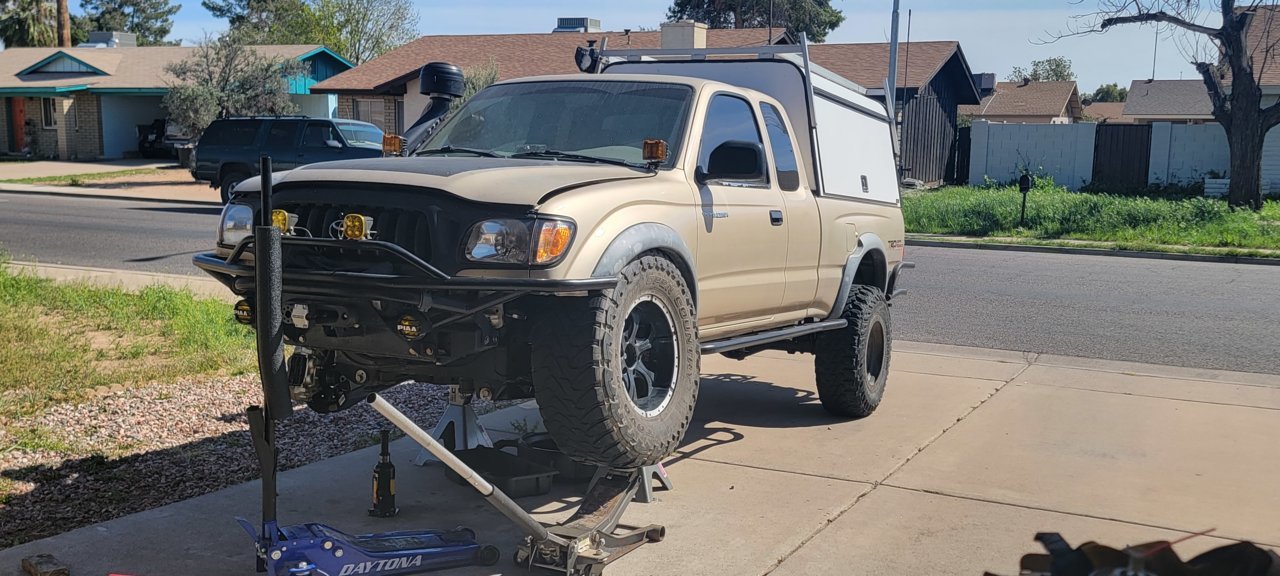

    New durobumps are in and the tires are on it. All that's left is to set the aliment cams where they were before and then set it down and finish torquing everything with the weight on it.

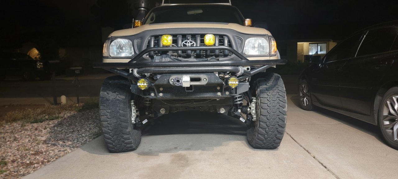

    This is how it's currently sitting. Ready for flight.

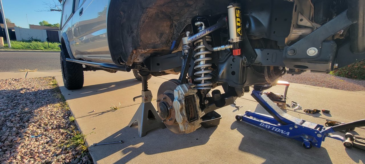

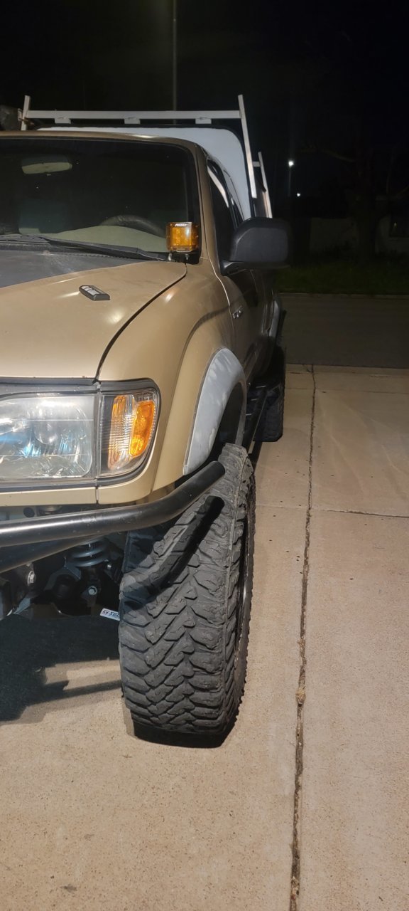

    Welp she's all back together,
    The aliment was a bit off. I drove it around the block to see if the springs would settle a bit.it sounded like something roasting there tires especially when hitting the brakes.
    So I did the best I could to straighten it out. I got it the best I could. I probably should have reread the DIY home aliment but I didn't.
    I have an appointment for next Wednesday to have a shop make it right. At least now I can drive it there without scrubbing the tires off.
    20230323_013048.jpg 20230323_013110.jpg 20230323_013138.jpg 20230323_013155.jpg
    It looks like the ADS has 650lbs springs so the truck is sitting a bit taller but the valving is definitely softer then the icons. I can now feel how stiff the back is compared to the front. I'll probably crank the damper up a bit .
