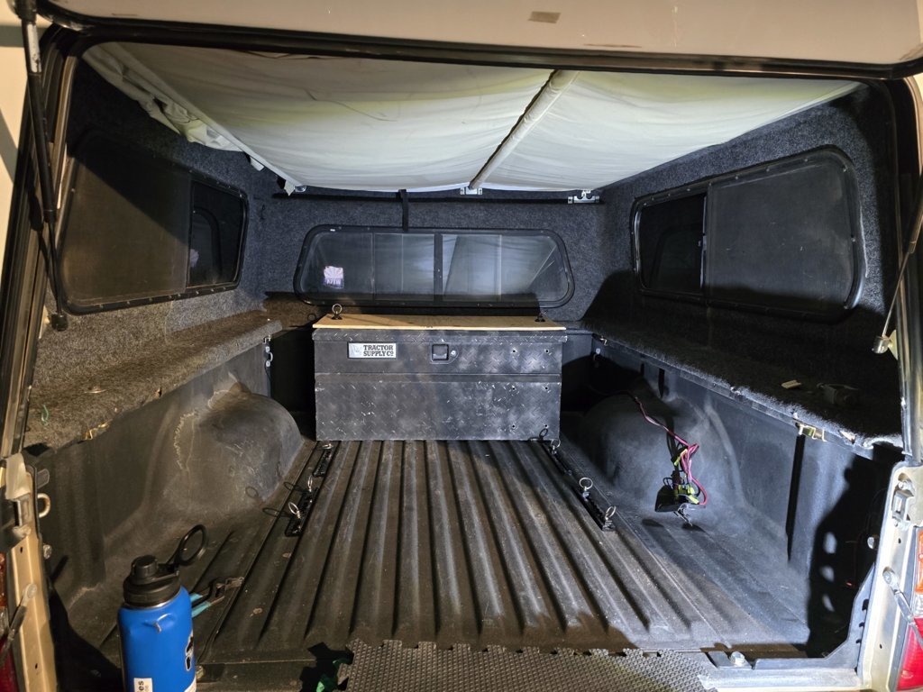

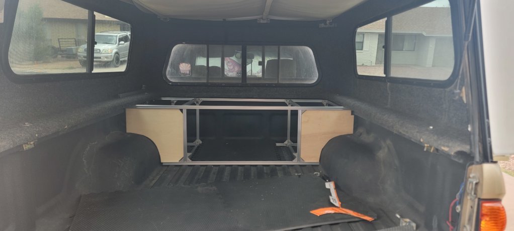

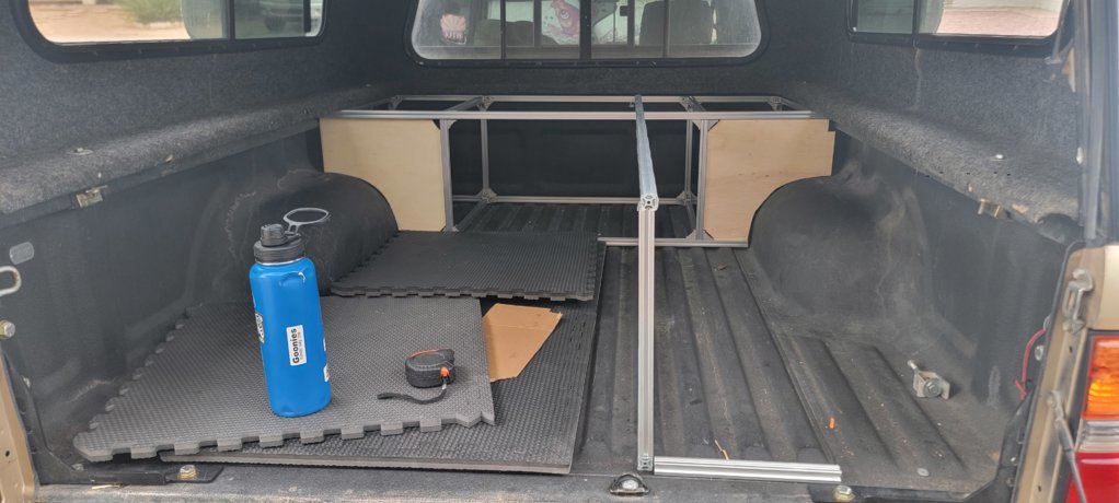

    Got some more work done on the shell interior. This is turning out to be a bit harder to do than I thought. The assembly is easy enough. It's all of the planning of how things should go and how things wires will be routed and were suports should be ect. Also the flip-pac's has a huge overhang on the inside which is causing me to have to put it together in place instead of outside where it's easier to reach,poor planing on my part.

    Nice work Chris!
    I hear you on the planning part. I spent loads of time just standing at the camper and thinking.
    It'll all be worth it once it's done.

    hey Chris,,, awesome buy on the Flippac, i'll have to watch your build.
    before you go to far with the 80/20 build you might think about some bracing of your front bed corners, mine have both torn. it seems the flip bolted to the bed sides lets enough movement happen separate from the bulkhead. an 1/8th" flat bar spacer on just the bulkead top would put weight on it maybe, but i built a cross brace from the cargo tie downs to the bedsides where the flip bolts on in the front, seems to have solved the problem. hope that makes sense.
    front runner makes a couple great water solutions, i have two, one sits on the rear seat footwells and really just makes a great flat space for all my tools and spares to nest into, the other is a flat tank that stands up against the front bulkhead and spans the bed width with cutouts for the wheelwells, i dont even know either one is there.

    I remember you mentioning that it was splitting your bed . I'm definitely going to look into bracing my bed is definitely spreading. I was musing of possibly using the 8020 to help make a brace.
    I saw the front runner and Ironman has a similar tank for the rear bulkhead. I unfortunately don't have the second footwells like you. That is a awesome spot for water.

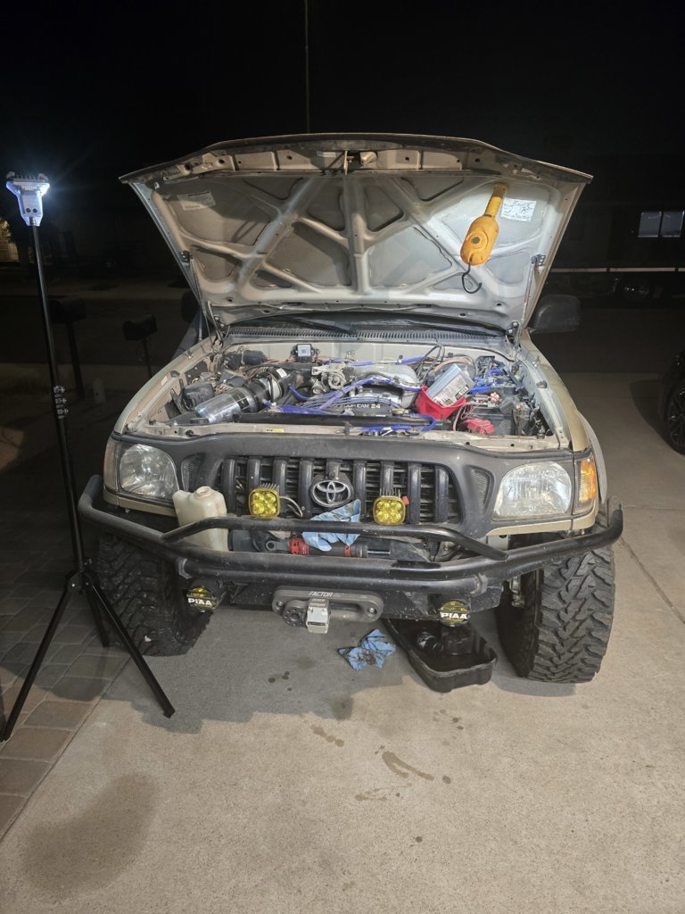

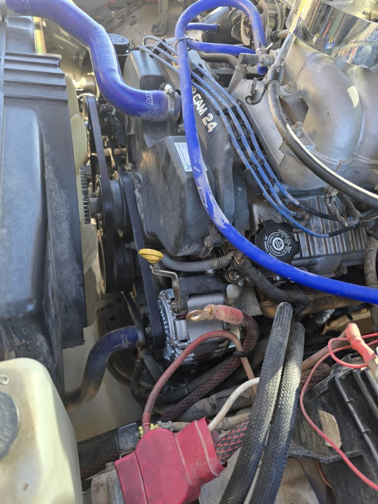

    I'll try and do some catch up here.
    So i had a trip coming up ,I was working a ton of OT and I had a bunch of maintenance to do. So I ended up doing a pivot on the rear build out. I had 4 days before my trip to get everything done.
    @Milota95 was awesome and helped me lift the flippac with his forklift and I was able to get a good gasket on there . I used a 3 bulb ESI Super Cap Seal XL 20 FT (2 1/8" Width x 1/2" Height x 20' Length) EPDM Rubber for Caps Over 200 lbs https://www.amazon.com/dp/B00NCCNUJQ and on the front bulkhead of the truck bed I used some foam for waterheater pipes to help fill the gap.

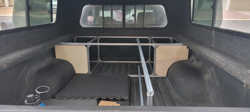

    So i pulled the 8020 out as I just wasn't going to have time to get it put together correctly and I wanted to see what was needed and how things were going to work with the new camper so I put in some L-track to help hold down my totes and I pulled out my old bed toolbox ,I added a pice of plywood to the top to help spread the load out. And while trimming is the plywood wood I manage to cut a nice long slice in the toolbox lid while I was at it..
    I removed the 12v plug as I have been having issues with it and added a bluesea fuse box that I had. I temporarily mounted it and a new 12v plug to the passenger side of the shell. This also allowed me to add a 12v pump too. I made a adapter for my septer water jug that I could hook upto the pump.
    Maintenance..
    Changed the oil.
    My powere steering pump has been growning for a bit and I was still on the stock alternator. I didn't want any issues on this trip so I decided it would be best to replace both and put on some new belts as mine were starting to look a little worse for the wear.
    I ordered a new power steering pump from Orillyes and a alternator for a grand vitadia. It was a remanufactered densoDenso First Time Fit Alternator -... https://www.amazon.com/dp/B000EQ94NO?ref=ppx_pop_mob_ap_share And 3 new gates belts.
    As always the pump fought me connecting the high pressure line. The new alternators power wire was in a different spot and my cable wouldn't reach so I made a new cable...later learning that apparently you can clock the back of the alternator. Thankfully I had extra cable and connectors.

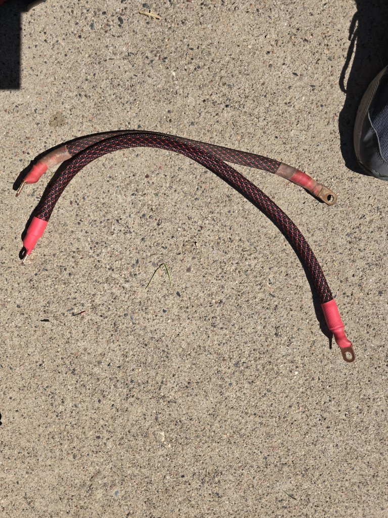

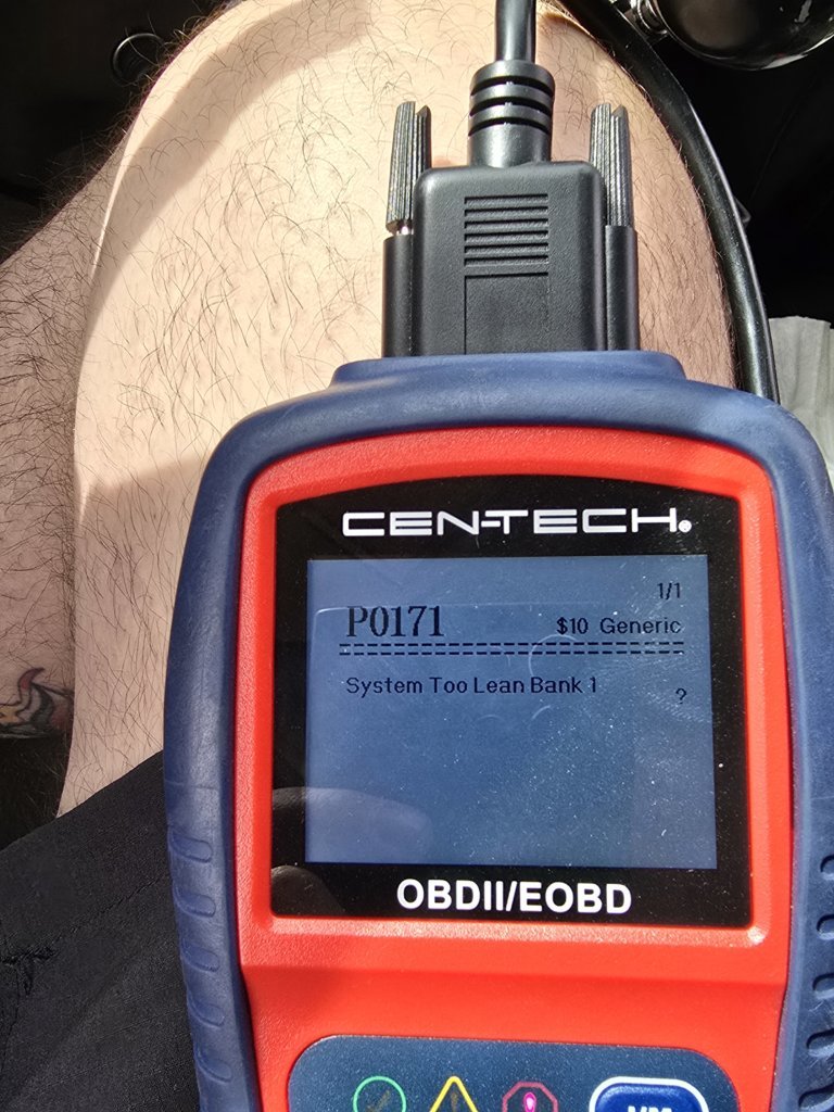

    1. So I may have over oiled my air filter. I kept getting a P0171 code. I cleared the code but it kept coming back.I cleaned the mas air sense a couple of times with break cleaner bit the code kept coming back and got worse. Eventually I had to spray down the filter with the break cleaner which helped with the codes for about a day and a half. It seemed to only come on when I was idling for a period of time .but highe rpm and speeds didn't seem to cause the code to show up.
    2.the new power steering pump would make a squeal in the morning but was fine the rest of the day but didn't seam happy.
    3. When I got off the freeway close to home the truck was smoking from the engine bay. Could have been some old oil but it had been smelling weird the whole trip and I couldn't figure out what it's from. I suspect the alternator.

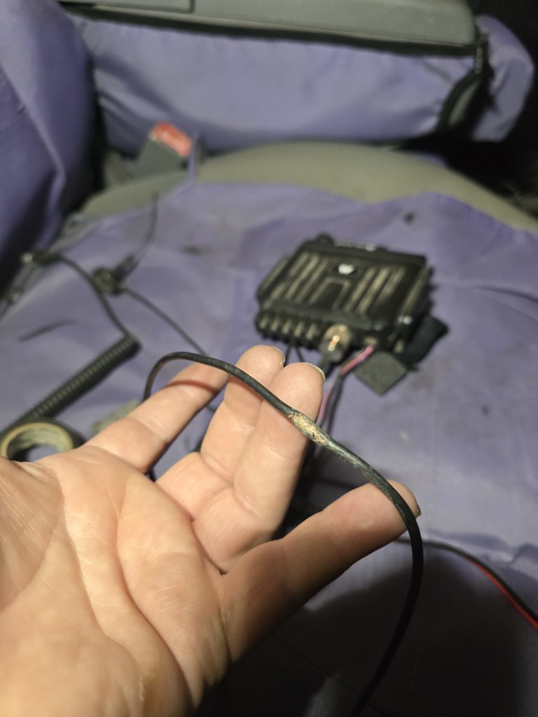

    Some other things that have come up.
    I went on a easy trail ride in the tundra, it was a group ride so I grabbed my grms out of the tacoma, it's just velcrod on the dash and uses a 12v adapter plug for a easytransfer, just for this reason. Well as I was pulling the antenna and cord, I may have found out why ive had poor reception. .. not really I just can't talk correctly into the mic. I digress, check your cabels occasionally.
    It still worked for th ride.
    Tundras getting new upper control arms and new cv Axels and the shocks put at a higher lift. These big trucks ride so nice off-road.

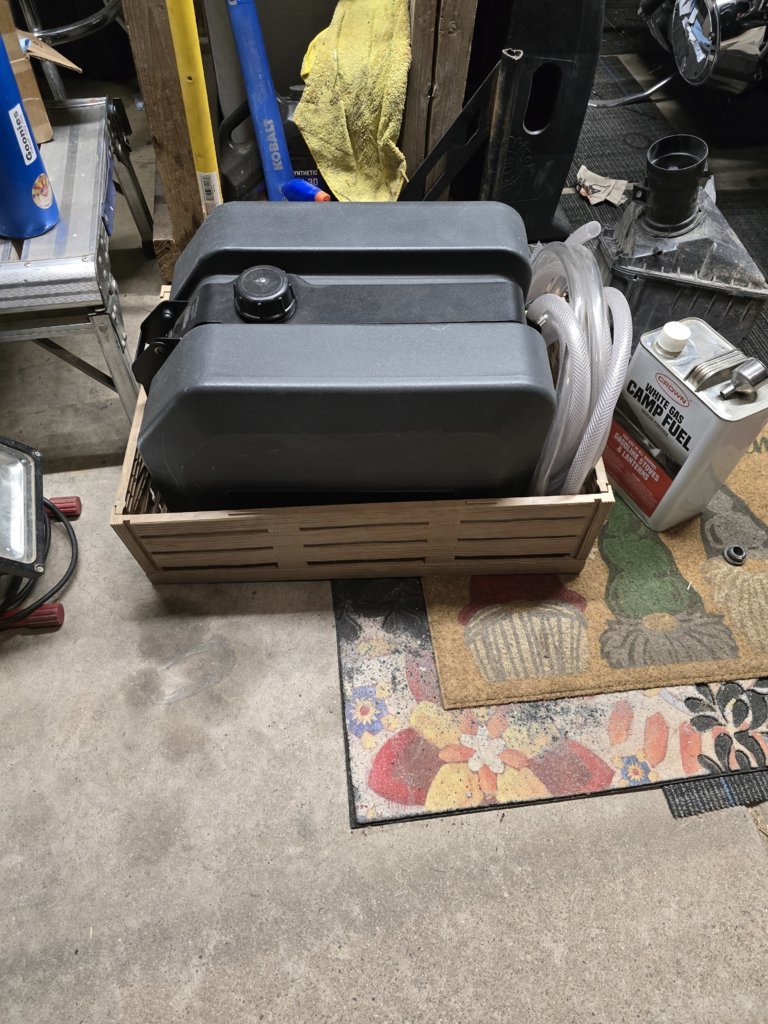

    So I've found a new water container to try out I'm not sure it's gonna be big enough but I can always carry extra and back fill it.
    And I have a new antenna coming for the grms . I would like to permanently mount one with a remote mic and speaker. But I think that'll wait tell I pull the interior for some other work.
