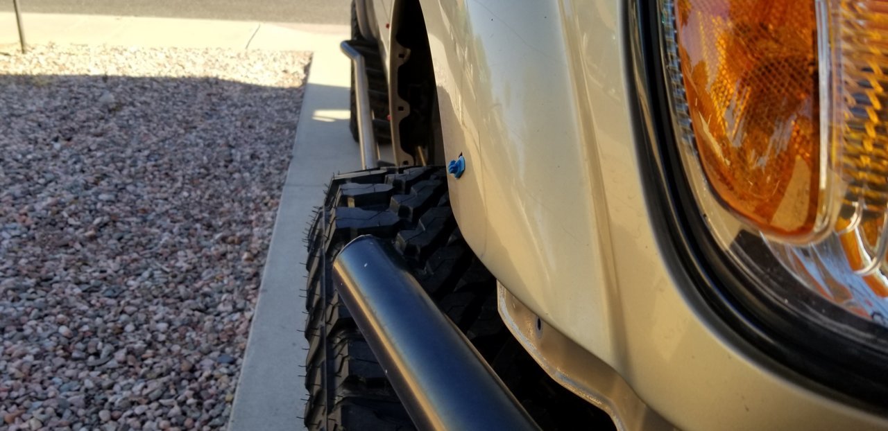

    Rubbing a little?

    Not sure but I'm guessing that they will. I didnt get a chance to mount them yet. Spending the rest of day with the misses

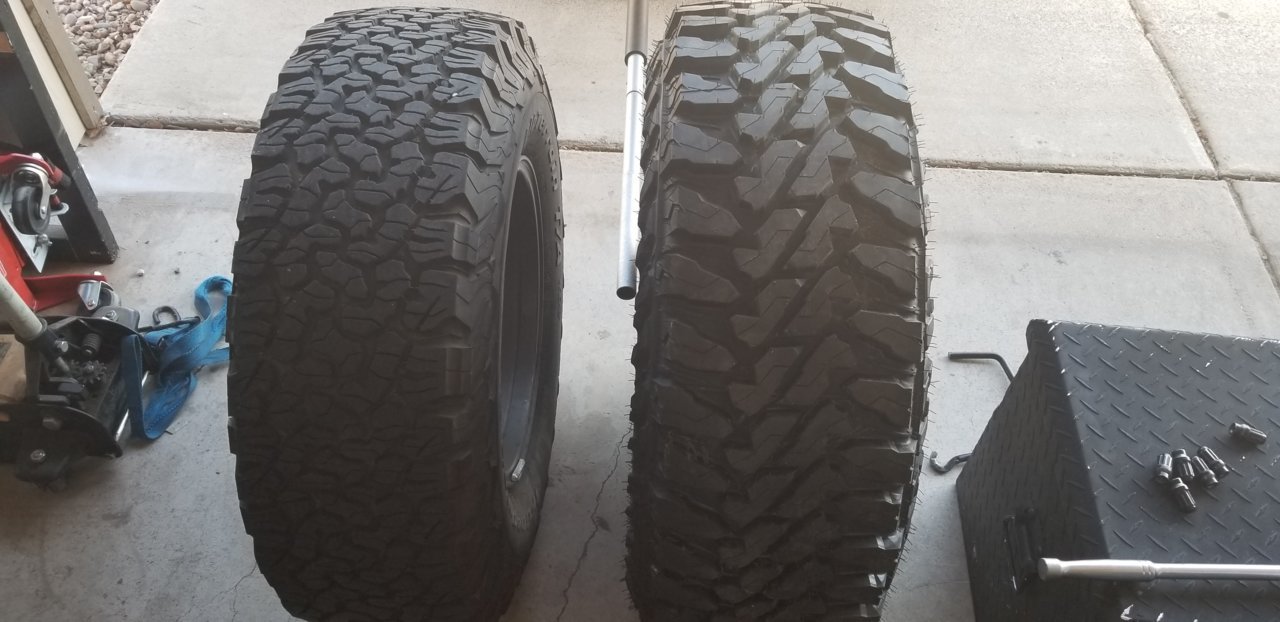

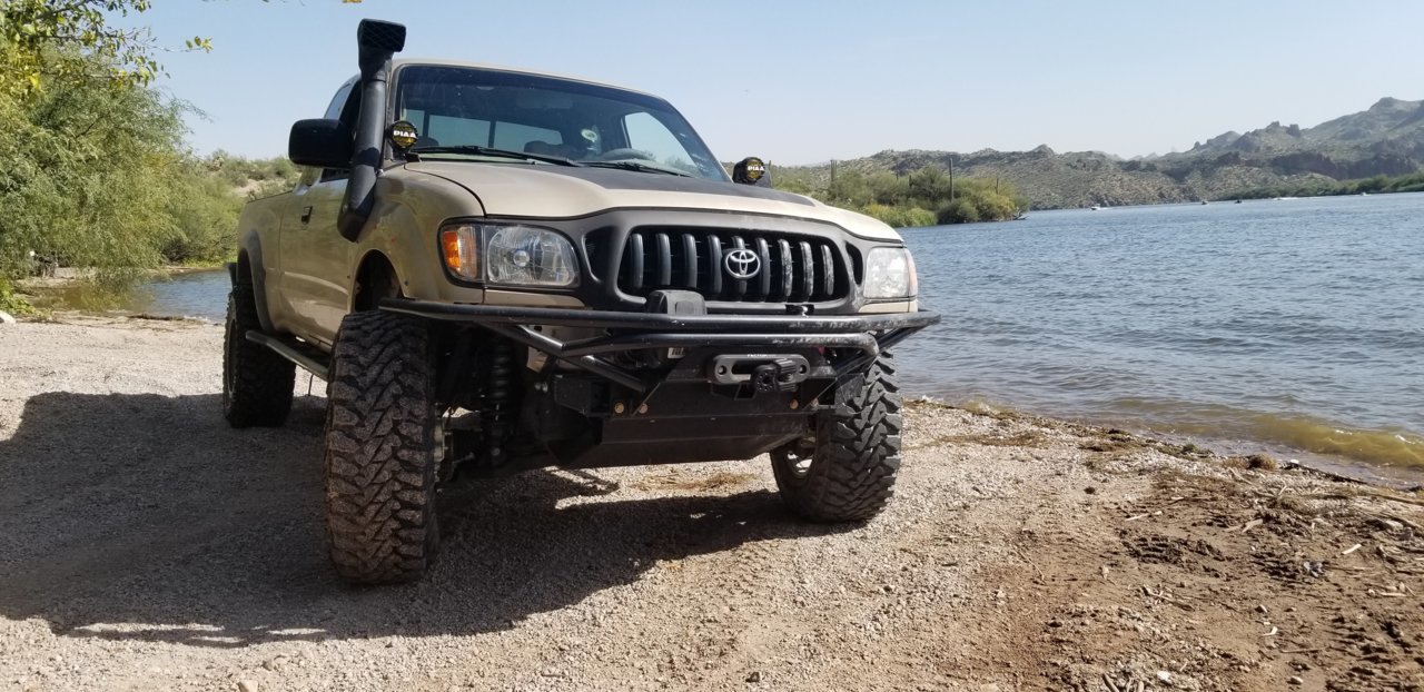

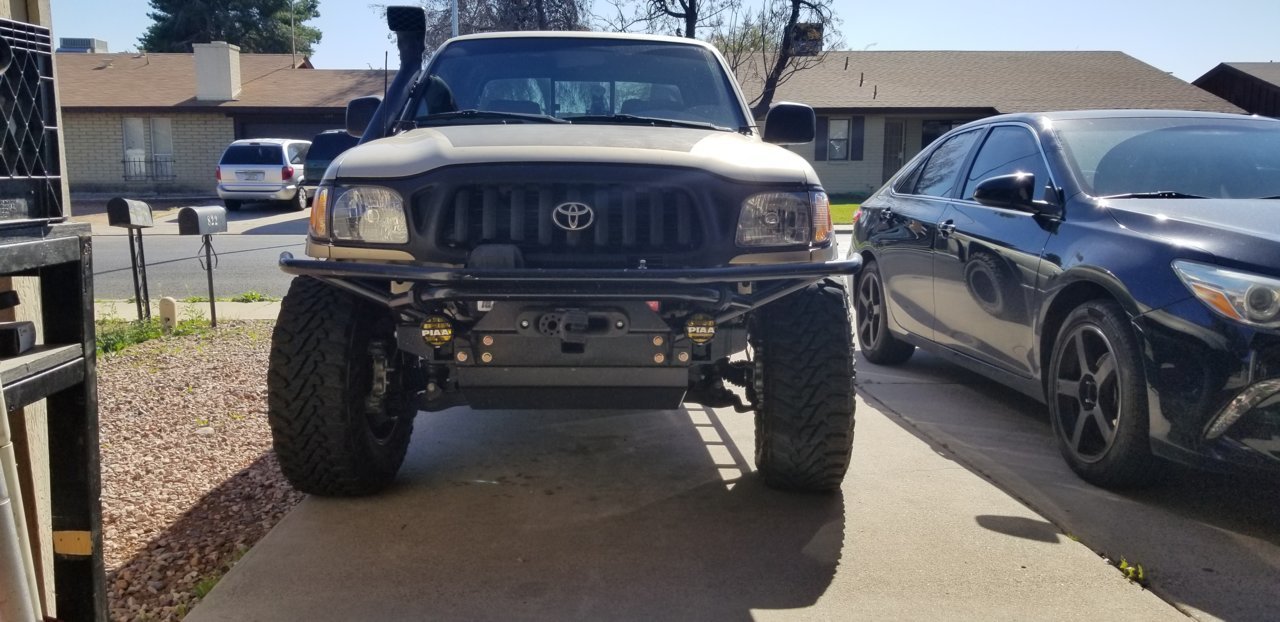

    So I was a slacker and slept most of the day away.

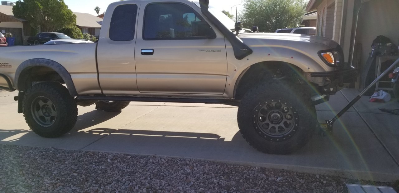

    Found out that my spare tire mount dosent seam to let the tire down as far as it use to. Umm it could be from the lift . But I seam to remember it going down further.
    And now I'm going to pic whore my new tires.
    Old vs new.
    And what it looks like mounted.
    From the front. It's a bad shot and the tires turned a little driver.
    From the back.

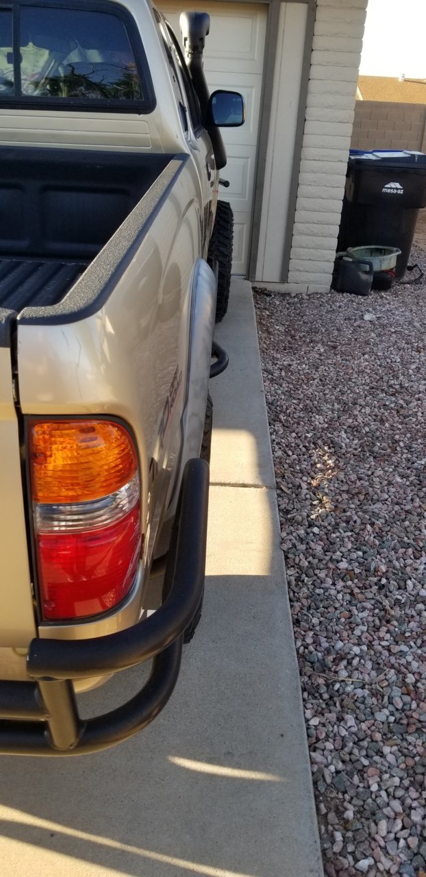

  4. Jun 3, 2019 at 5:16 AM

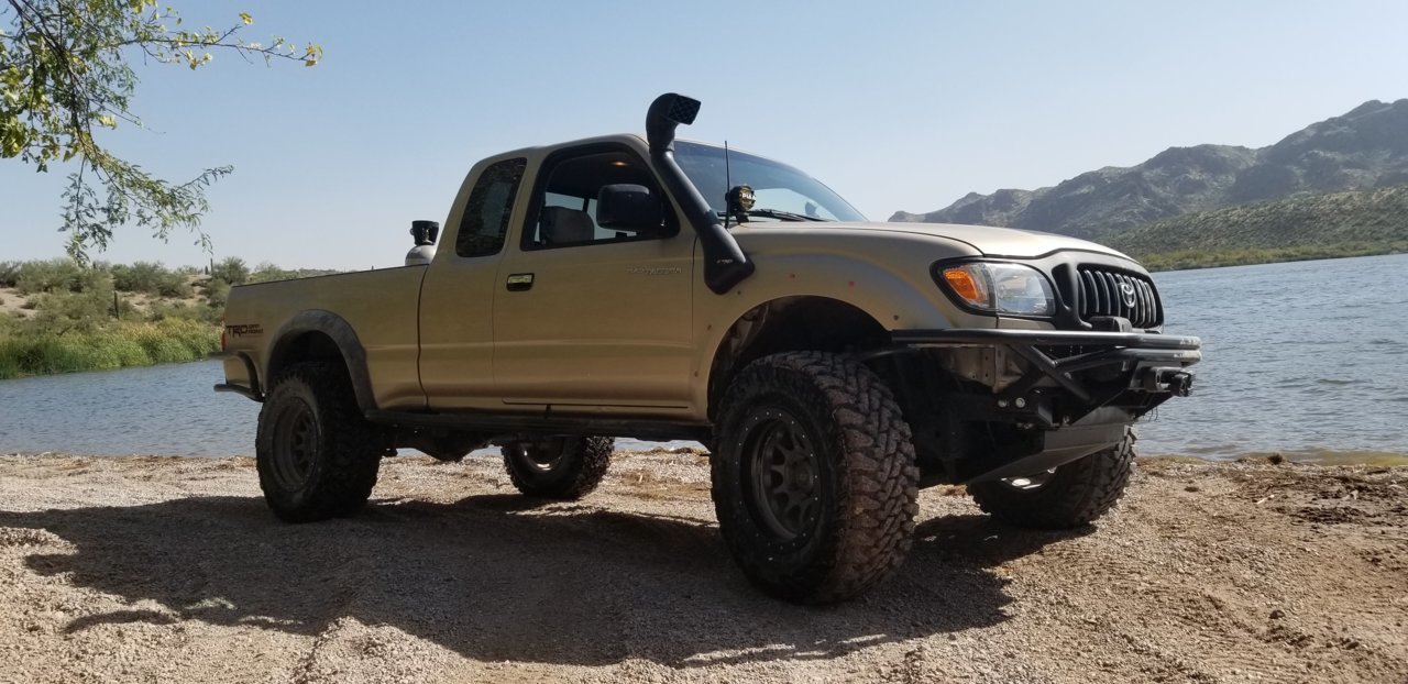

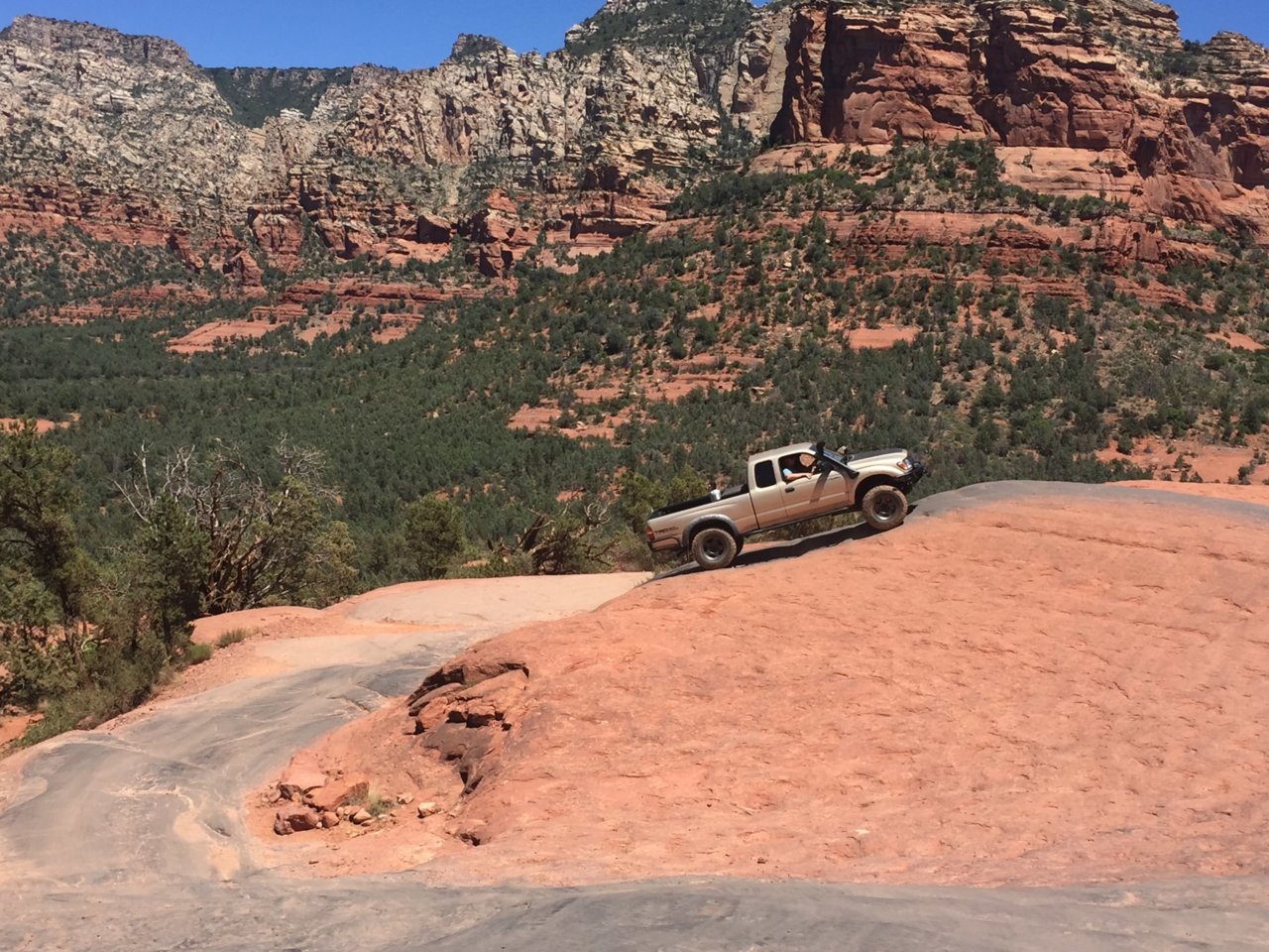

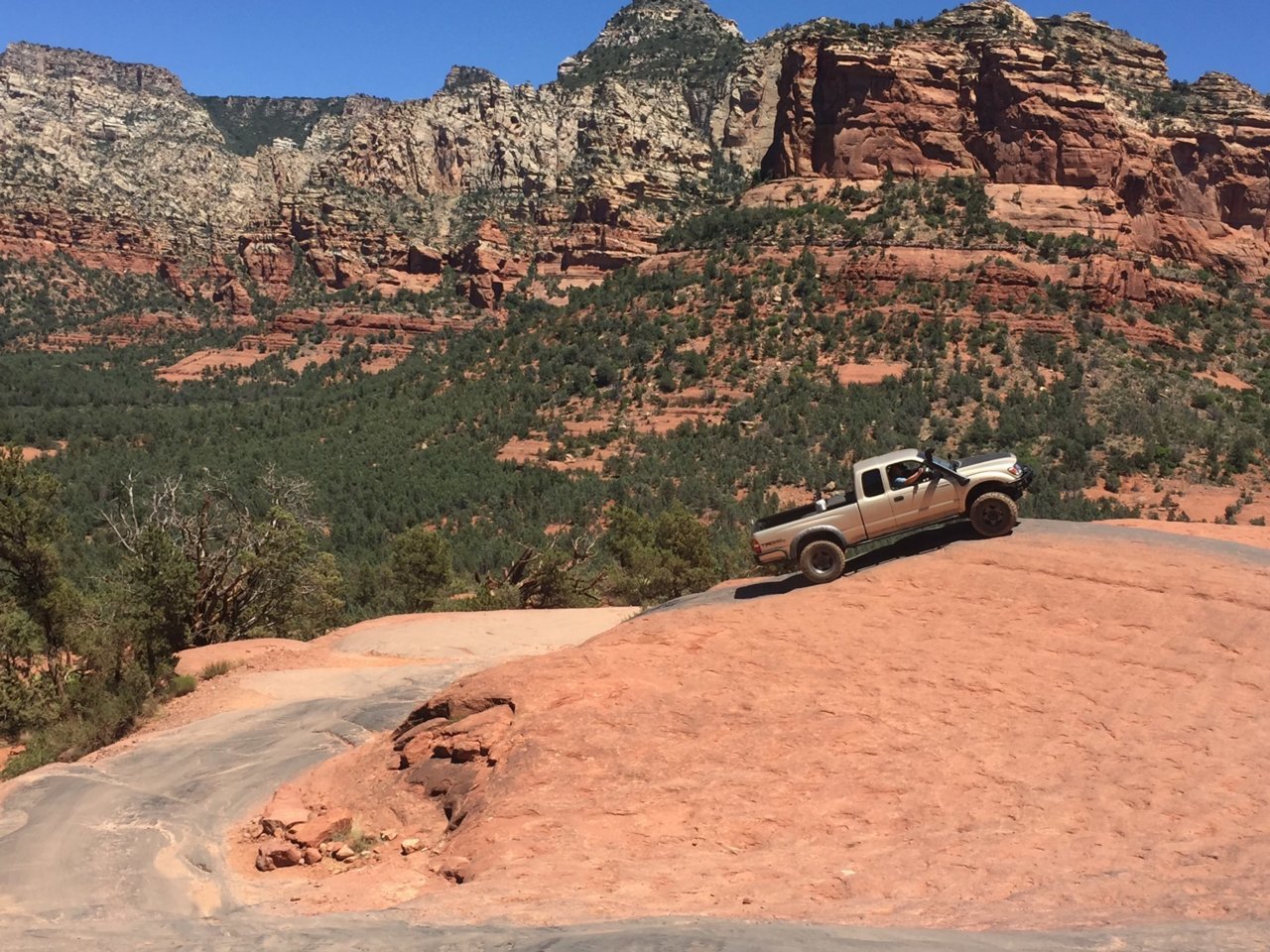

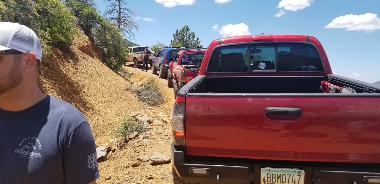

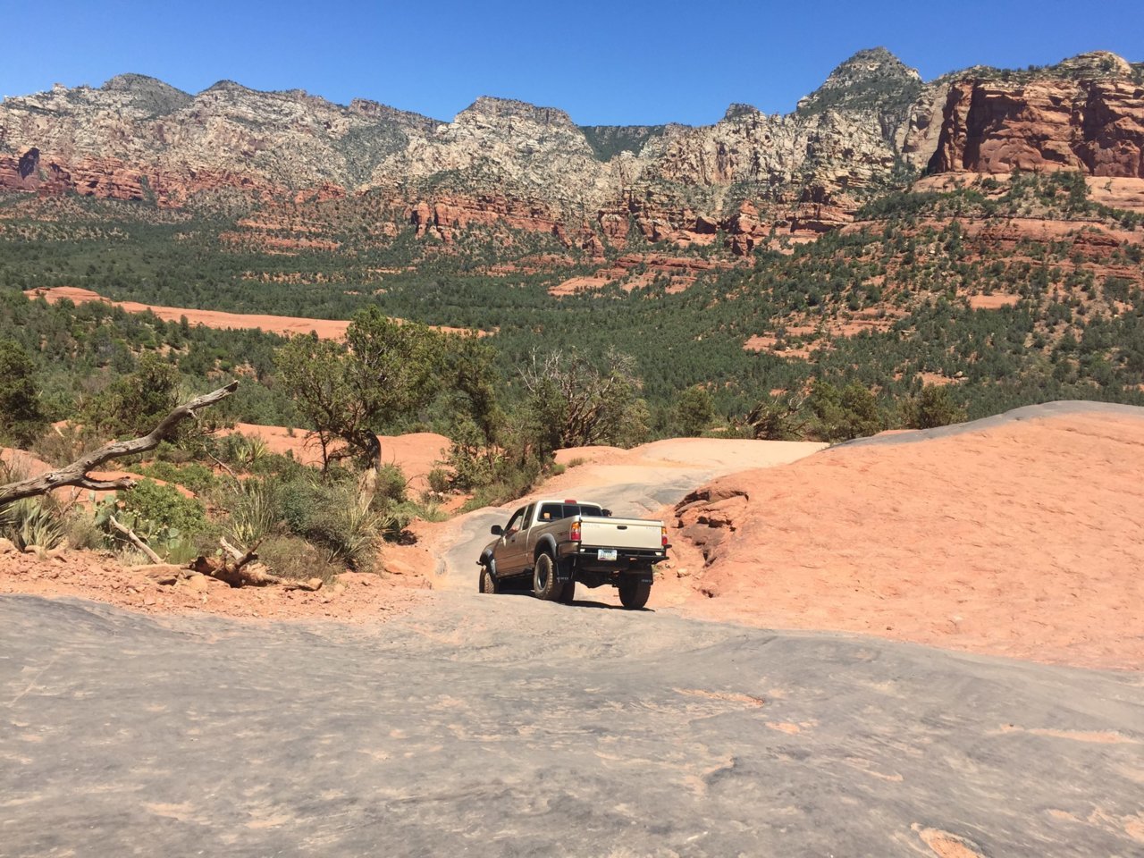

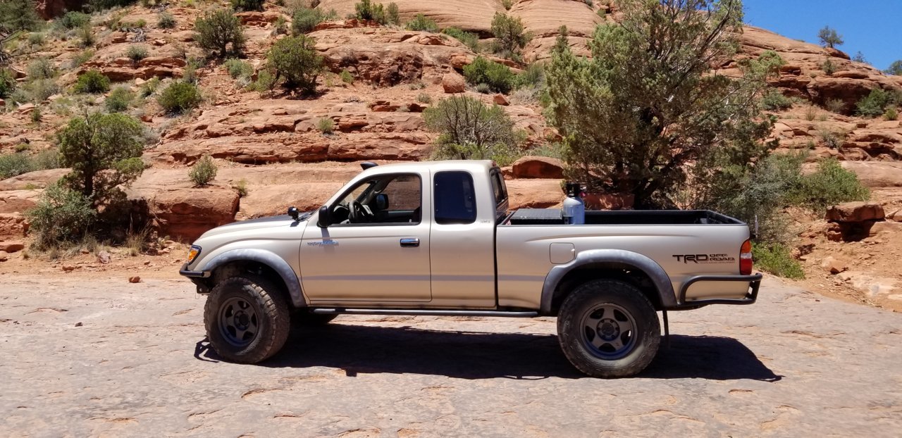

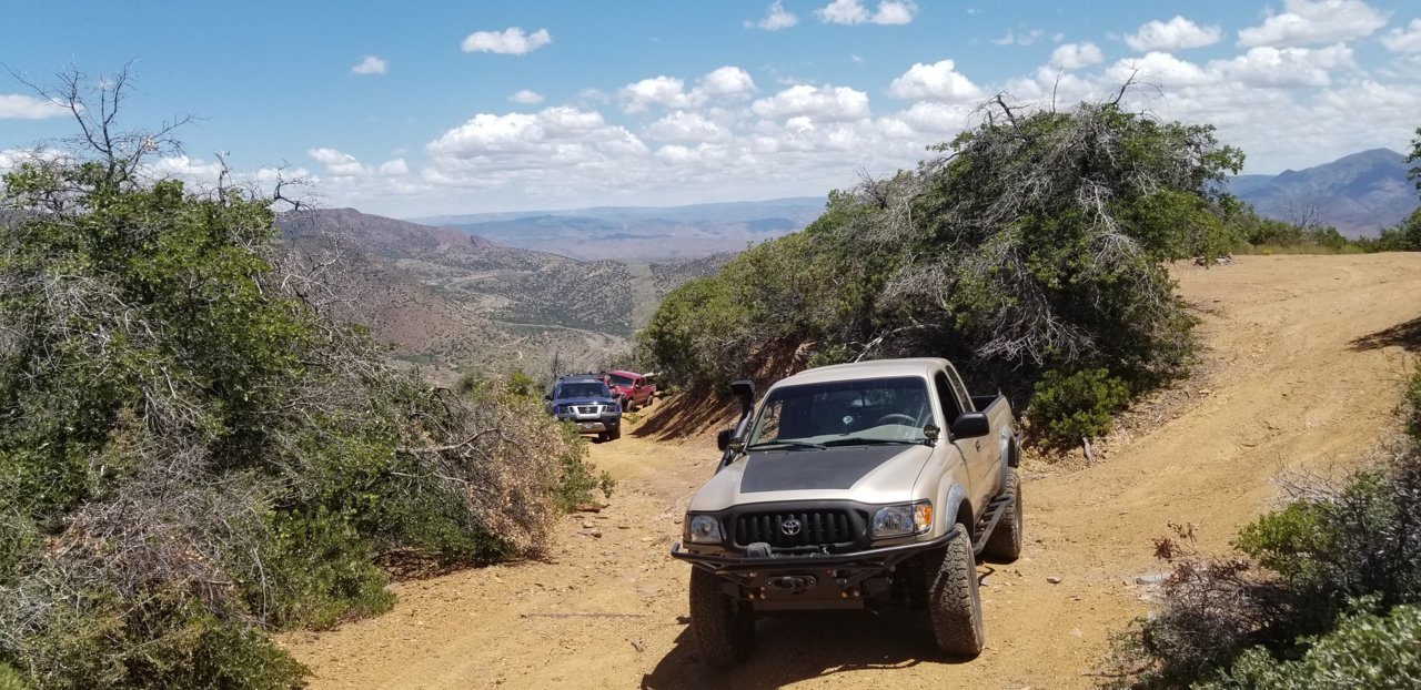

    So went wheeling the other day. This is my poor quality phone video. Theres no music. Sorry. I need to get some better cameras.
    https://youtu.be/gofcSyBx-Q0
    20190526_110330.jpg 20190526_113957.jpg 20190526_120624.jpg 20190526_120659.jpg 20190526_132714.jpg
    And I went and saw a dam the next day
    Phessor and TacoRated like this.

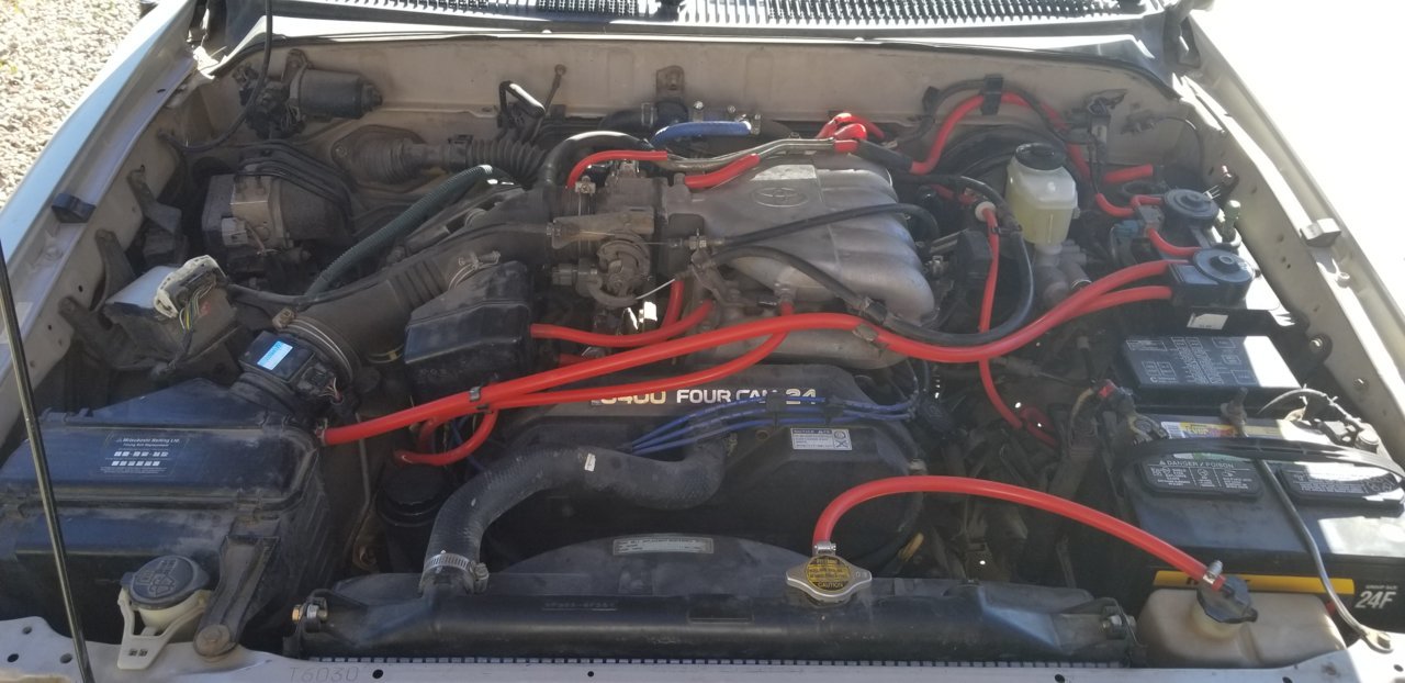

    I cleaned up the throttle body. And replaces my throttle position sensor. I kept getting the code . I believe that it was a high idle on start up.
    I used this guy.Plastic Party Favor Bags Assorted... https://www.amazon.com/dp/B00736D76S?ref=ppx_pop_mob_ap_share
    And I bought this to help with the job.Vessel Megadora 900 +2x100 JIS... https://www.amazon.com/dp/B000TG8OTY?ref=ppx_pop_mob_ap_share
    To use on the special screws. It kinda worked. I was able to get the throttle position sensor off ok but when I tryed to remove the iac. I ended up stripping the last bolt, so that didn't happen. So I cleaned it up as best I could put it all back together and that seemed to resolve my issues. Although my idle is a little higher. So this was all so that I could go wheeling without any issues. Except that my exterior door handle broke right as I was about to leave.

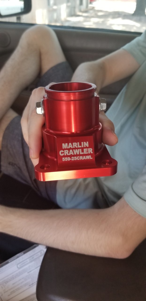

    Finally got a much anticipated part.
    It was a fun easyish project with my boy.

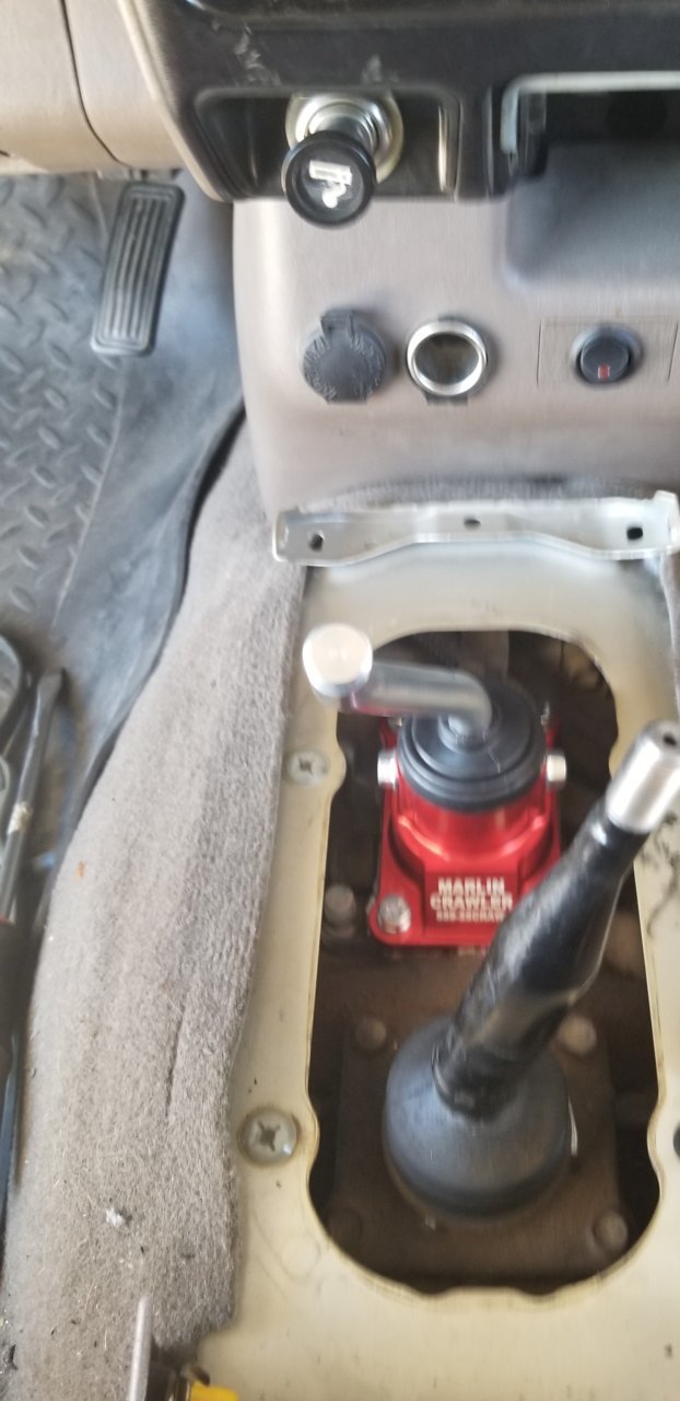

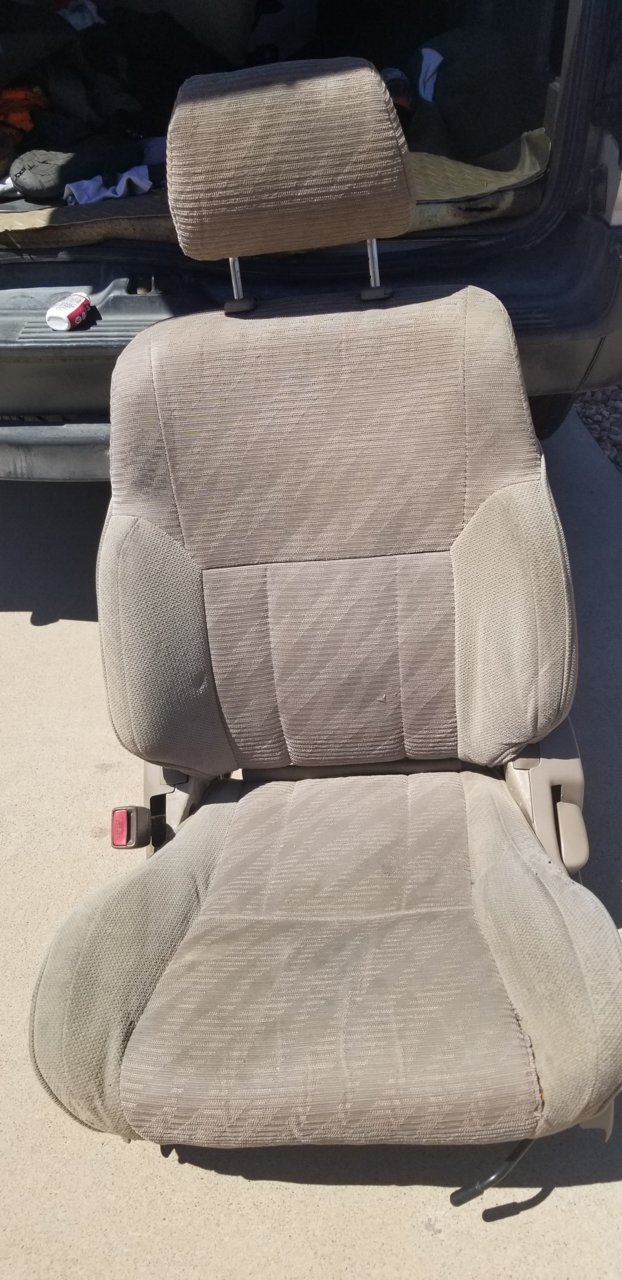

    Fixed my exterior door hande. Broke the Interior door handle in the process. Got a used one when I picked up some seats.
    20190819_142507.jpg not sure if I'm going to put them in the taco or this
    Got it for my son. It needs some work but it's a decent foundation and it should be a fun project.

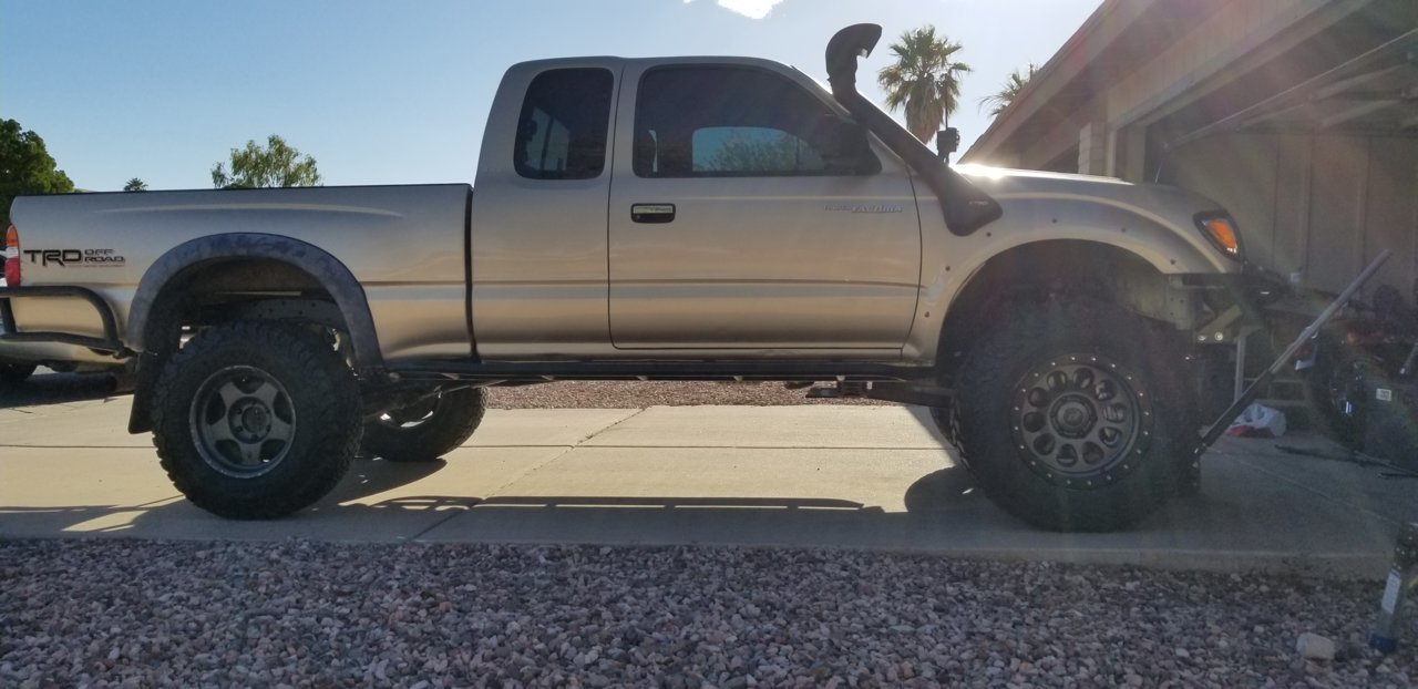

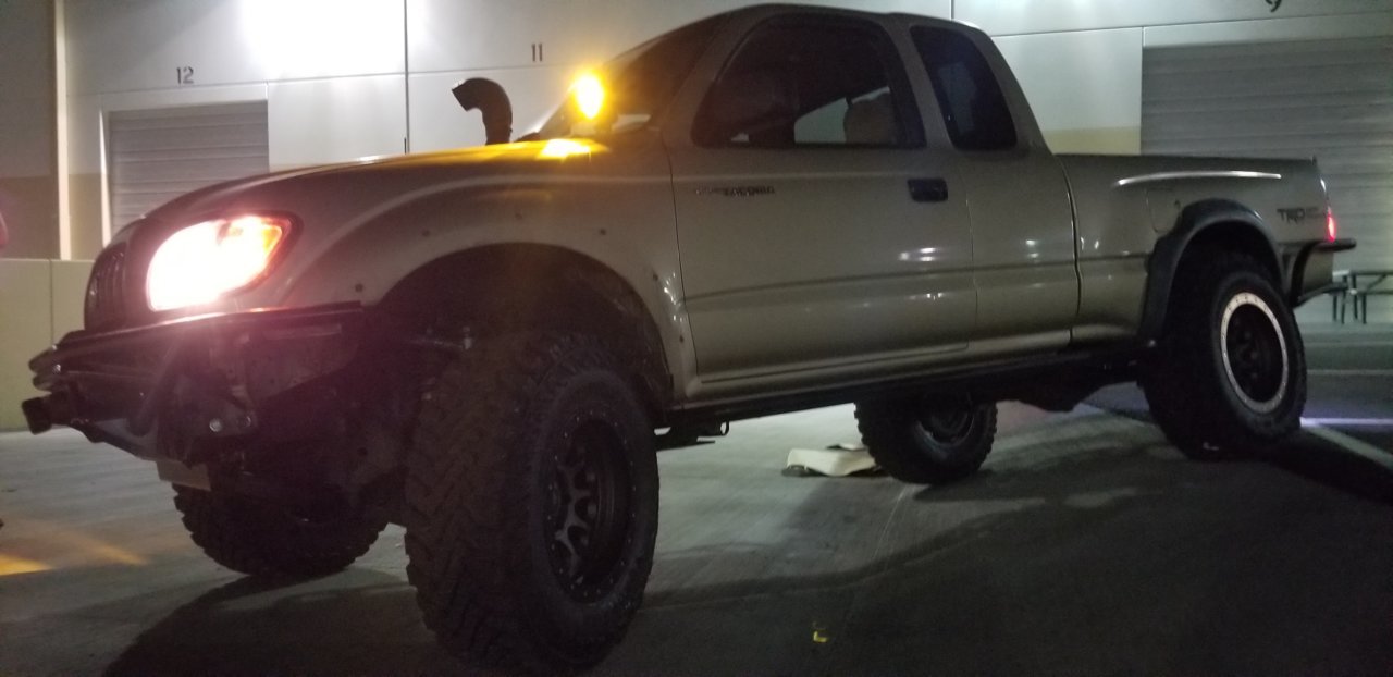

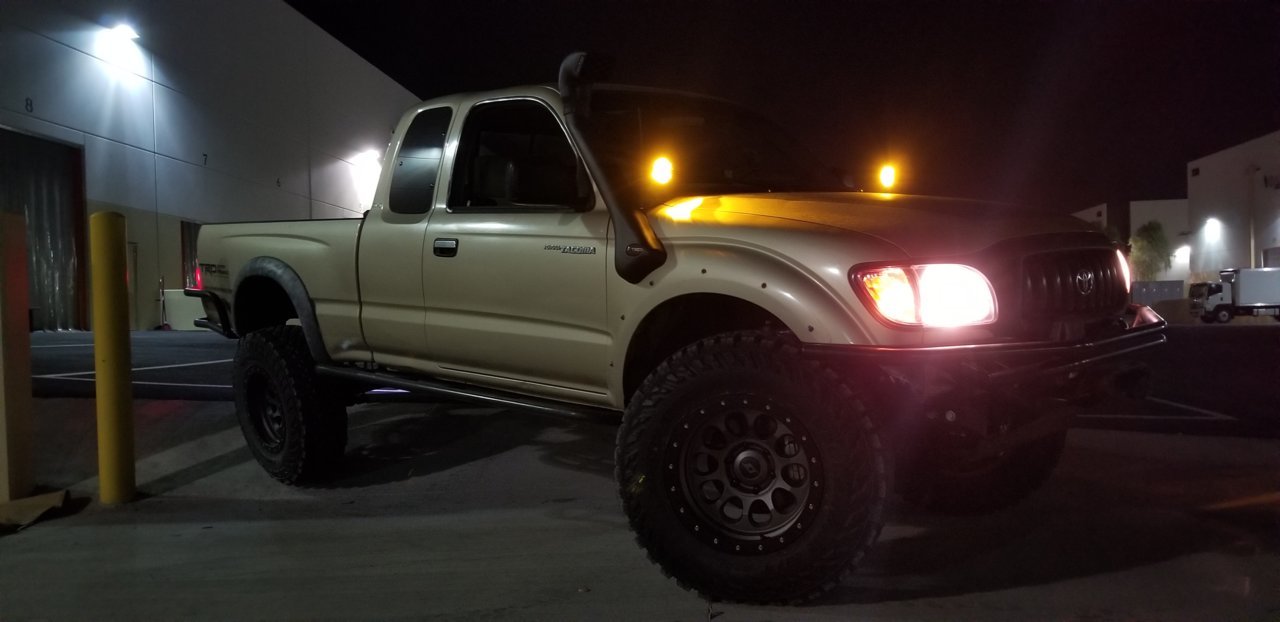

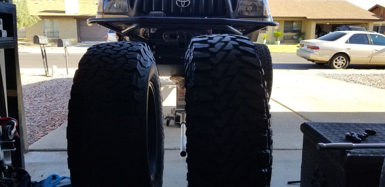

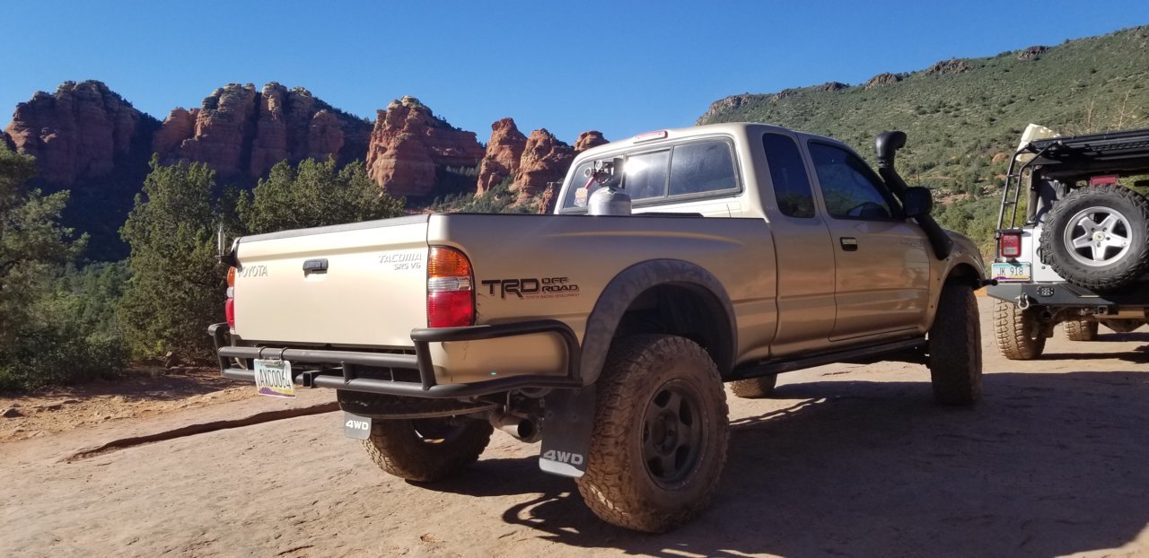

    Well after much beating/massaging with the sleg. I finally was able to get the tires mounted. My oldest boy came over and took turns hammering with me.it was a lot of beating,putting the tire back on and cycling the suspension and the beating some more. My dead pedal is now kinda misshapen. But they rid well and dont rub at full bump with the tires turned. I was worried about need a axle relocation kit for the back but there doesn't seem to be a issue.
    So the rims are 17" x 9 with a 3.5" -38mm offset ray 10's. On Yokohama my 285 70 17.

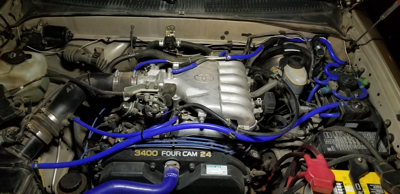

    And I made a decent dent on installing new silicon hoses. 20190917_194053.jpg

    Truck looks great on those wheels and tires man! What is the actual tire height{like how many inches from ground to top of tire}?
    I really like your vac lines. Makes everything easy to see. I’m gonna have to copy that too! I ordered the LED reverse lights you posted about installing. Great find!

    Thanks man. I can't really take credit for them I saw them on someone else's post but I don't rember who. The lines are pretty nice. I got the extra length of 8mm but I'm not sure if it was necessary. I'm gonna pull my throttle body and get the ones under it. It was pretty easy to do otherwise.

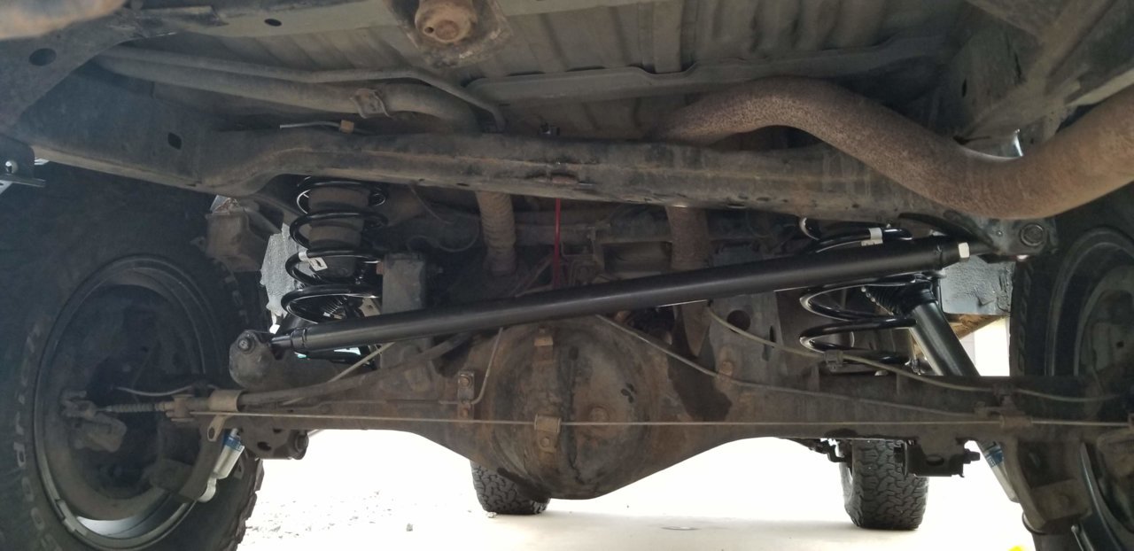

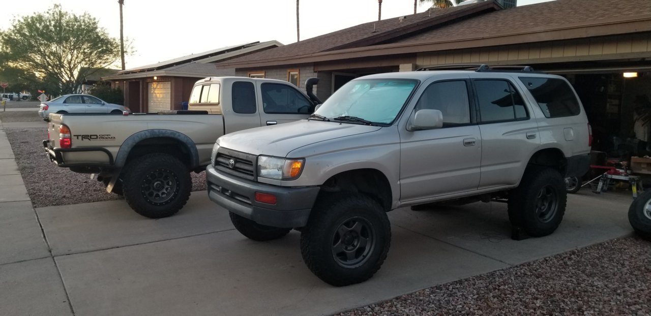

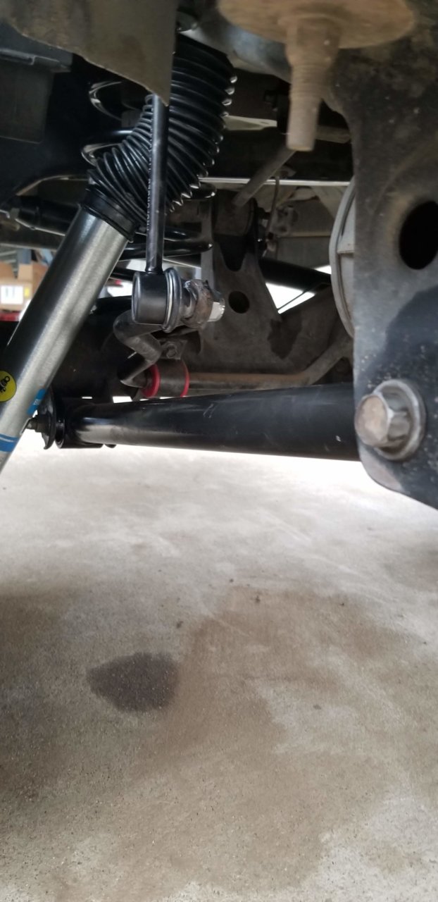

    So it's been a second. Finally down to 1 job. But I started up school. So I have a little bit more time available. Took about a month to catch up on sleep.

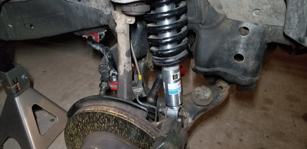

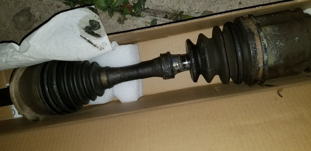

    Was busy working on the kids 4runner. Pretty much rebuild the whole suspension. Have a couple parts left to do but I'm tired for dumping money and time into it. Hopefully he doesn't wreck it. It's his first car and he's a new driver.
    OME coils front and rear. Bilistine shocks front and rear. Extend break lines. Dornan steel rear lower control arms and track bar.new/rebuild cv it's. Put in better condition front seats. And did the vacuum hoses.new inner and outer tierods. New swaybar bushings and links.20200204_182610.jpg

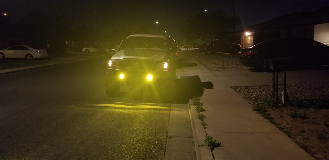

    Moved my fogs down on the bumper

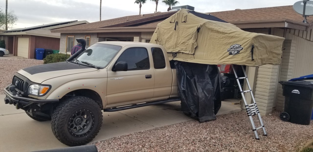

    Finally mounted the rack and tent.
    Ended up turning it so that the tent opens to the passenger side. I guess well see how it works out.

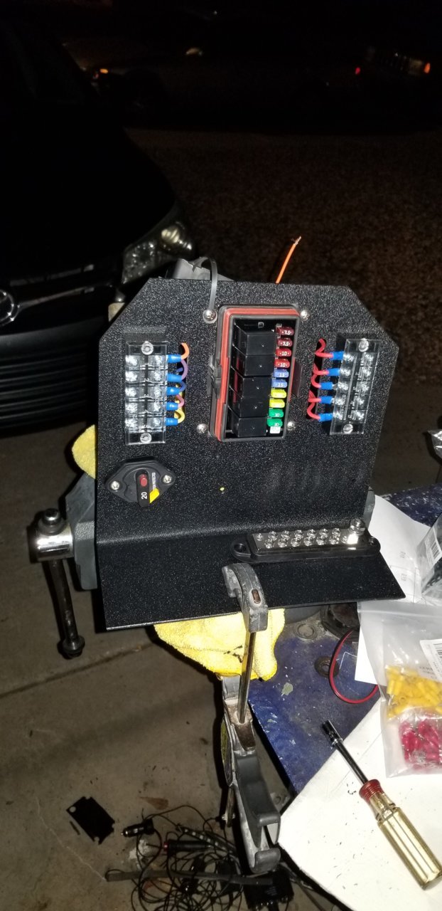

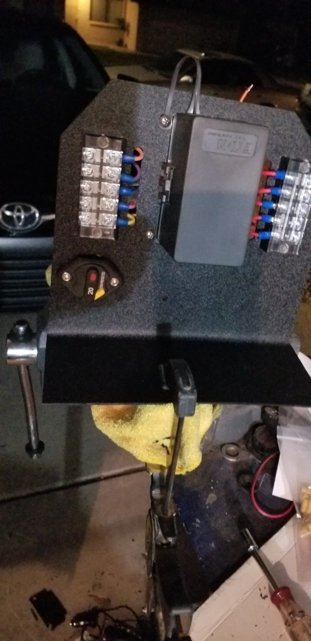

    Finally got to working on my wiring project.
