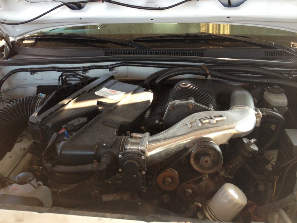

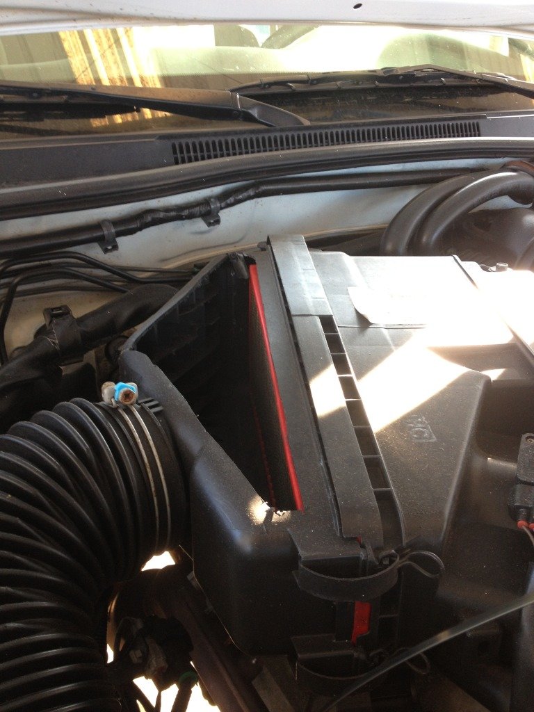

    You could always go this route

    4,181
    Oahu
    Is that on your truck?

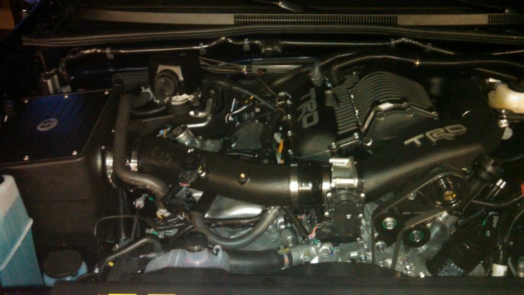

    Nope it was on a pile that came in today to work...hood screwed shut...hood scoop gutted too...
    This is mine...:D

    Nice setup.
    That other shit tho.....

    Dave Smith
    Blown 2013 NBM DCSB Sport
    AFE CAI TRD Exhaust TRD Supercharger 3" Cornfed Spacer 2" Toytec AAL
    Thanks...:D
