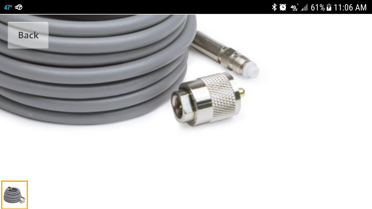

    Depends on what you decide to do, that's one of those cables.
    K40 K4018FME 18' Super Mini-8 CB Antenna Cable with Removable FME Connector https://www.amazon.com/dp/B001JT5SAS/ref=cm_sw_r_cp_apap_z4HDAz9ECga5W

    wtf is a....... K40 K4018FME 18' Super Mini-8 CB Antenna Cable with Removable FME Connector ???

    Removable 'screw on/off' PL-259 connector on one end.
    Allows you to drill a smaller size hole to pull the wire into the cab.
    Some cables have pre-installed big connectors, so you'd have to drill a hefty hole to run it into the cab.
    Some have a solder on connector, if you're into that kind of thing
    Edit: Like this one
    Firestik Fire-flex Cable Assembly W/low-profile Fire-ring and Stud https://www.amazon.com/dp/B00EARXF06/ref=cm_sw_r_cp_apa_o7H5zb9PG1MY8
