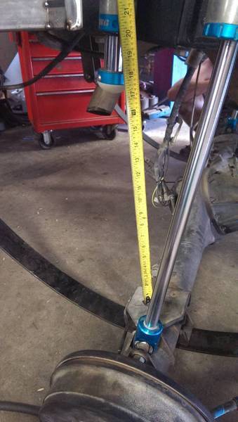

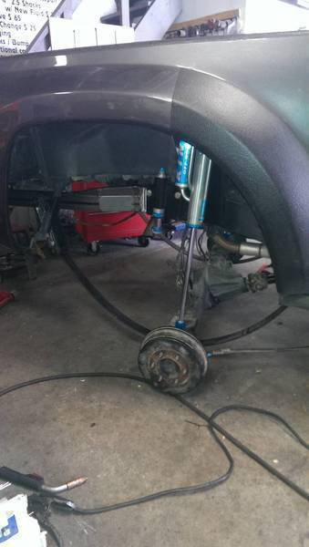

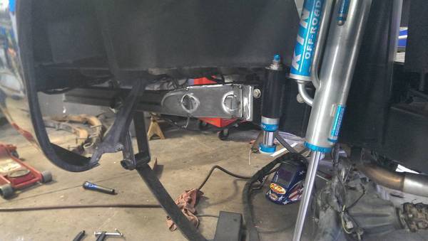

    Made some good process today, stopped in and lent a hand as the gopher today at the shop. Rear frame is getting wrapped, cross supports and bumper going on next. Rear is looking right at 19" of travel right now, will more than likely be strapped at 18". Should all be done early next week, pretty pumped!

    are you pulling 18" strapped with your 16" shocks? or getting longer shocks?

    Well I'm getting 19" now and we are really close to using 100% of the shock. That's without wheels or extra weight pulling it down more. To be safe they said they will probably strap it at 18" with the expected strap stretch.

    the way I understand it with your setup, with the axle all the way up, the shock swings backwards a bit, and at full droop, the shock swings forward, providing that extra travel. I was thinking it was a straight 1:1 ratio. very nice! your build is an inspiration to me. thinking I may follow suit once money is not an issue for me

    Another cross bracing, tying hitch into cross bracing, limit straps and new brake lines.
