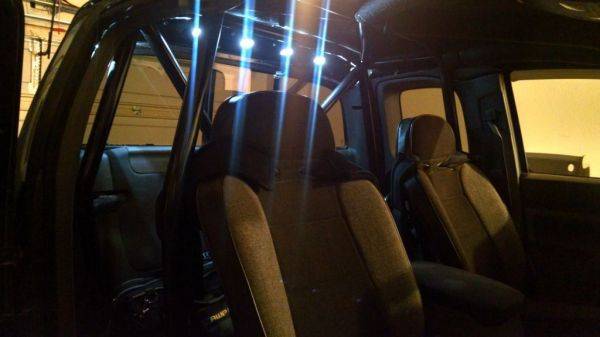

    Got my rear vanity plate/dome light back in. Plate ties into the cage and has large dimple die with translucent plexiglass behind them so the light glows through. Picture doesn't do it any justice looks really good in person.

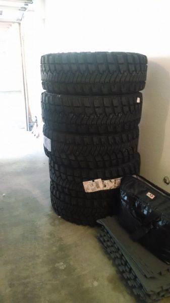

    New rubber showed up today, now just waiting on new alloy to wrap these around! 315/75-16 Goodyear MTR Kevlar's

    What rims you go with?
    Also, isnt your bumper Mild steel? Just curious after the other thread posts... lol

    SCS F-5's
    Yup mine is Mild, bumper needs to act like a bumper and have a crunch zone of sorts. DOM is just going to bend the frame mounts/frame. Better to replace a bumper than straightening the frame.
