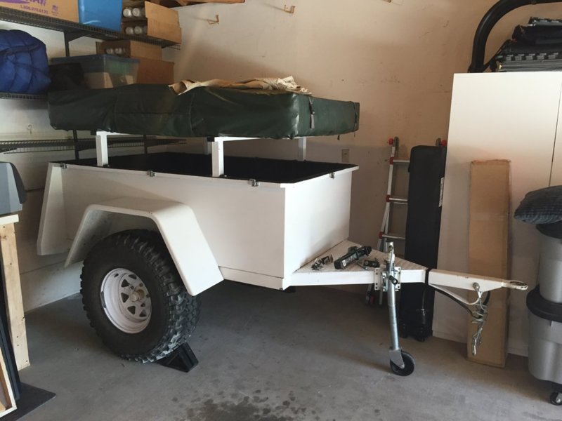

  4. Jul 25, 2015 at 6:40 PM
    #544
    lembowski
    lembowski [OP] Well-Known Member
    Jul 29, 2009
    #20347
    6,882
    Rolando, CA
    Jeeper Creeper
    Picked this little guy up off Craigslist for a steal. Very few things to do to it and it will be ready for camping. Need to get a RTT soon!
  5. Jul 25, 2015 at 7:41 PM
    #545
    Sefferston
    Sefferston I like Tacos.
    Aug 9, 2014
    #135733
    1,778
    Seth
    Germany
    ZOMG B-RED!
    I've got that one thing, and that other one thing, oh yeah and that other other one thing.
    Straight mount or is it on springs?
  6. Jul 25, 2015 at 7:43 PM
    #546
    jberry813
    Jan 21, 2011
    #49636
    28,476
    Jason
    Lake Tahoe
    2012 DCSB Sport
    ...too much shit to list.
    Huh? What is a strait mount?
  7. Jul 25, 2015 at 7:45 PM
    #547
    Sefferston
    Aug 9, 2014
    #135733
    1,778
    Seth
    Germany
    ZOMG B-RED!
    Like a basic trailer, didn't really know how else to describe it.
  8. Jul 25, 2015 at 7:47 PM
    #548
    jberry813
    Jan 21, 2011
    #49636
    28,476
    Jason
    Lake Tahoe
    2012 DCSB Sport
    Yeah I guess that's what I don't understand. The most basic of trailers uses leaf springs.
  9. Jul 25, 2015 at 7:49 PM
    #549
    Sefferston
    Aug 9, 2014
    #135733
    1,778
    Seth
    Germany
    ZOMG B-RED!
    I've seen a couple that solid mount the hubs to the frame. Kinda like a boat trailer I guess.
  10. Jul 25, 2015 at 7:51 PM
    #550
    Sefferston
    Aug 9, 2014
    #135733
    1,778
    Seth
    Germany
    ZOMG B-RED!
    It's 5 am and I'm tired. That's my story and I'm sticking to it.
  11. Jul 25, 2015 at 7:52 PM
    #551
    95 taco
    95 taco Battle Born
    May 3, 2012
    #78175
    17,533
    2003 4x4 TRD SR5 auto
    OME 883 front, OMD 3.5" rear, Relentless front bumper, smittybilt 9.5K winch
    :notsure:
    All of the boat trailers I've dealt with have had leaf springs.
  12. Jul 25, 2015 at 7:53 PM
    #552
    jberry813
    Jan 21, 2011
    #49636
    28,476
    Jason
    Lake Tahoe
    2012 DCSB Sport
    Wow. I've never seen that...ever. Damn retarded too. Gotta pic?
    All my boat trailers, jet ski trailers, utility, toy hauler, and otherwise all had either leaf spring or torsion. I've never heard of welding hubs strait to a frame.
    Regardless...Matt's has leaf springs. Just because I saw that trailer on CL :spy:
  13. Jul 25, 2015 at 7:56 PM
    #553
    Sefferston
    Aug 9, 2014
    #135733
    1,778
    Seth
    Germany
    ZOMG B-RED!
    :dunno:
    http://teof.us/Pictures/LG/trailer-bottom.jpg
    That's what I found on a quick google search. There might be a leaf spring tucked up there but the little trailer I had when I raced bikes didn't have leafs from what I can remember.
  14. Jul 25, 2015 at 8:07 PM
    #554
    jberry813
    Jan 21, 2011
    #49636
    28,476
    Jason
    Lake Tahoe
    2012 DCSB Sport
    There are more types of trailer suspension than just leafs. Regardless if that has springs or torsion or otherwise, that's a turf trailer. They don't go more than 10-15 miles an hour around a golf course.
    Every DOT trailer I have ever seen has some form of suspension.
    Sefferston[QUOTED] likes this.
  15. Jul 26, 2015 at 12:01 AM
    #555
    lembowski
    Jul 29, 2009
    #20347
    6,882
    Rolando, CA
    Jeeper Creeper
    Yup leafs on this pig. thanks Jason.
    Sefferston likes this.
  16. Jul 26, 2015 at 7:46 PM
    #556
    lembowski
    Jul 29, 2009
    #20347
    6,882
    Rolando, CA
    Jeeper Creeper
    Nah, I was going to have one built. To have one built was going to run me around $4500 plus, and found this and and made a $1500 offer and they accepted. Tested everything and its working perfect. Just had to rewire for a 7 pin instead of the 4 pin it had.

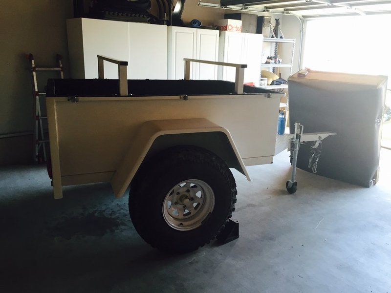

  17. Aug 4, 2015 at 9:57 AM
    #557
    lembowski
    Jul 29, 2009
    #20347
    6,882
    Rolando, CA
    Jeeper Creeper
    Picked up an Eezi-Awn Series 3 1800 off a local member to add to the trailer.
    List of things to do before the wife and I make a maiden voyage up the coast in a few months. Love to hear anyones suggestions!
    • Add 1 more cross support under the tent (180lbs tent with bedding)
    • Get rid of pintle hitch in favor of ball coupler and hitch
    • Replace existing axle (square tube) with a new 3500lbs axle with matching Toyota hubs and electric brakes.
    • 33" tires and wheels and a spare. Truck will go back to 33's next time.
    • Add brake controller and battery system
    • Add license plate light
    • Plan fresh water tank and tongue box
    • Add tailgate cable
    • Add snap on tonneau cover to the box
    • Spray some grey plastic dip on the trailer for a paint match
    Crom likes this.
