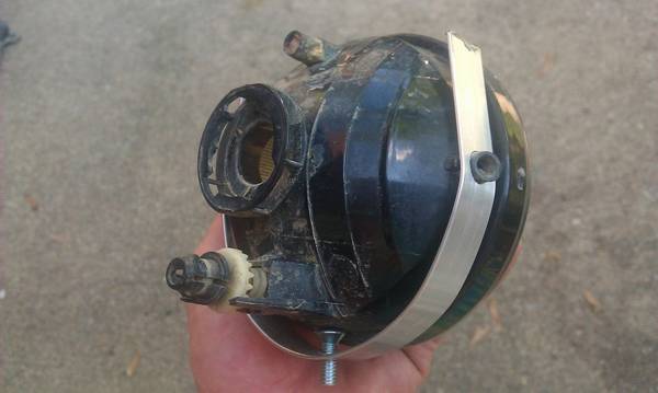

    I found that pic in here somewheres.....I just took the pic and ran with it.
    This one's mine...a lil different but same idea. Aluminum from lowes, bent by hand, drilled the holes for the side plugs, then tapped the bottom hole 1/4-20 and the screw presses against the light to hole it.

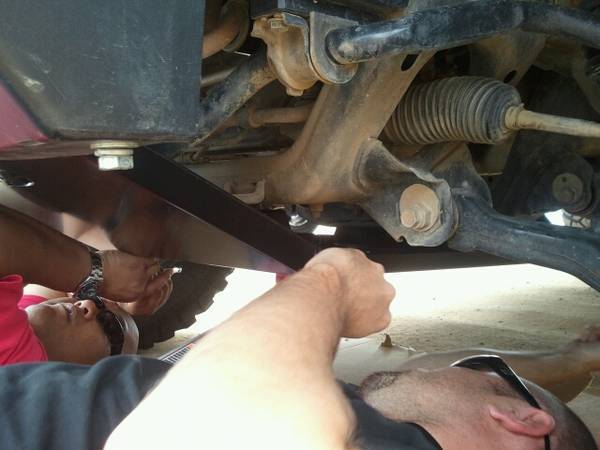

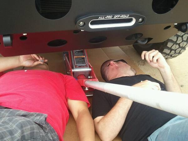

    Installing Matt's All Pro skidplate at Fiesta Island yesterday

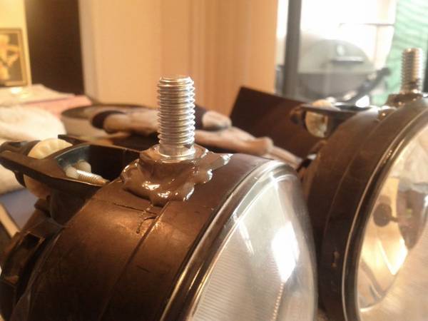

    So I went to Lowes and got some 1/16" thick aluminum and bent it to form and drilled holes to have the tabs fit. It looks like in the 1st pic they used 1/8", but I was unable to bend it by "hand". After that the light seemed a little loose sitting in the bracket.....I'm sure 1/8 would be perfect but whatever. So as I was looking at the fog and trying to figure out what to do. Out of the corner of my eye I saw my tubes of JB Weld in the garage, so I JB Welded the bolt to the fog and will install the light sans bracket. With a tensile strength of 3,960 psi I'm pretty sure that the bolt won't be moving/breaking off. Here is what the final look of the mounting looks like and I will install the lights tonight :)

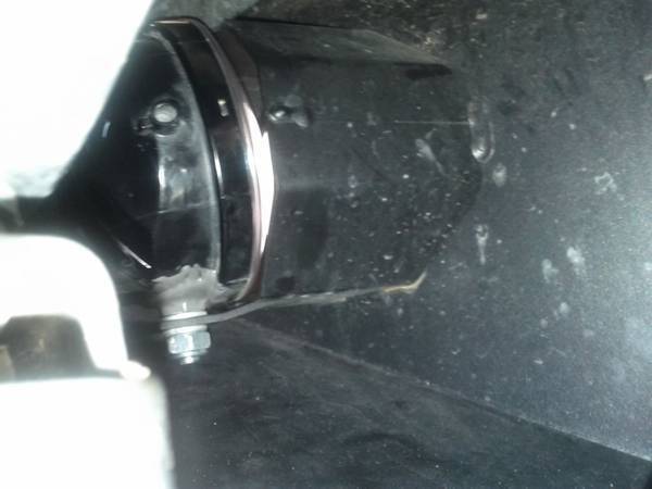

    Ok so I got the fog lights installed last night. Wish I would have done it with the bumper off as it was a tight fit for my arms and hands reaching into the back of the bumper. Had to go buy a stubby ratcheting wrench to get the job done. Much easier than making a bracket for the Allpro bumper. :D
