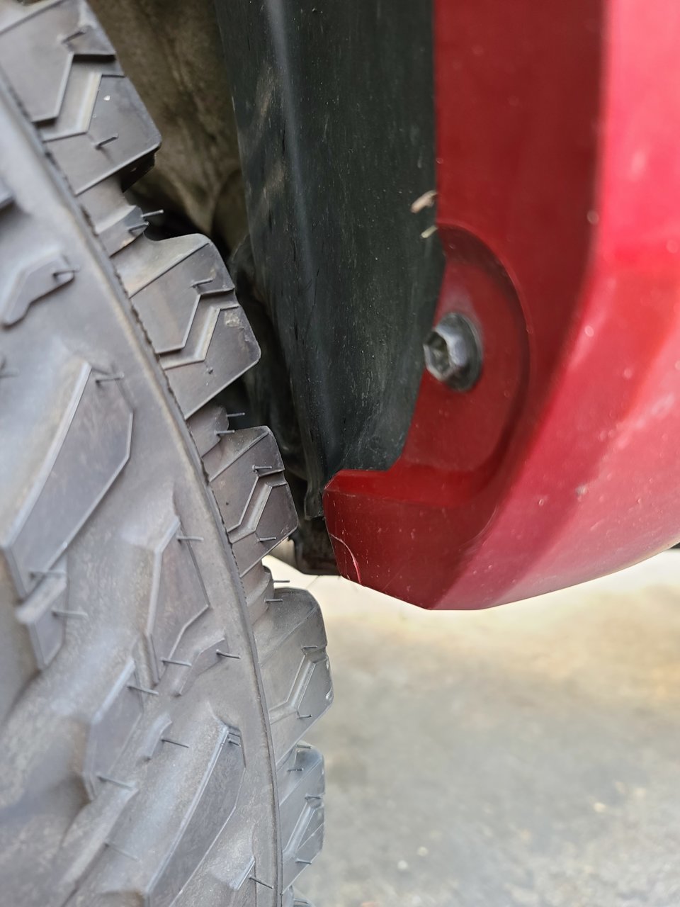

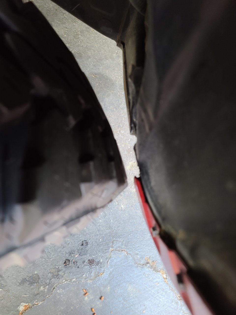

    I'm super closer to rubbing here towards the cab. Planning a cmc, and ucas, hopefully w the adjustability I can get the wheel moved forward. 20200529_185727.jpg 20200529_185722.jpg

  14. May 29, 2020 at 8:27 PM

    Nope. Still trying to get ahold of jim
  15. May 29, 2020 at 8:28 PM
    Jasonstacoma
    Jasonstacoma [OP] Well-Known Member
    Jul 13, 2019
    #299186
    1,378
    Jason
    2019 dcsb Barcelona red
    Stock
    But it's that fucking fender flare piece of plastic I'm worried about. I dont want to have to cut it all off
  16. May 29, 2020 at 9:14 PM
    #16
    Dirk Diggler
    Dirk Diggler Under the Stun Gun
    May 30, 2017
    #220314
    3,550
    Columbus, GA
    2017 MGM OR DCSB
    Heat gun and massage it back after the CMC
    JoeCOVA likes this.
  17. May 29, 2020 at 9:46 PM
    #17
    Jasonstacoma
    Jul 13, 2019
    #299186
    1,378
    Jason
    Stock
    I don't think I can massage that red part anywhere.
  18. May 30, 2020 at 8:46 AM
    #18
    mhshark
    mhshark Well-Known Member
    Aug 1, 2017
    #225632
    884
    Bend, Or
    If you just trim the inner edge and the very bottom it’s not really noticeable at all. Not a big deal really

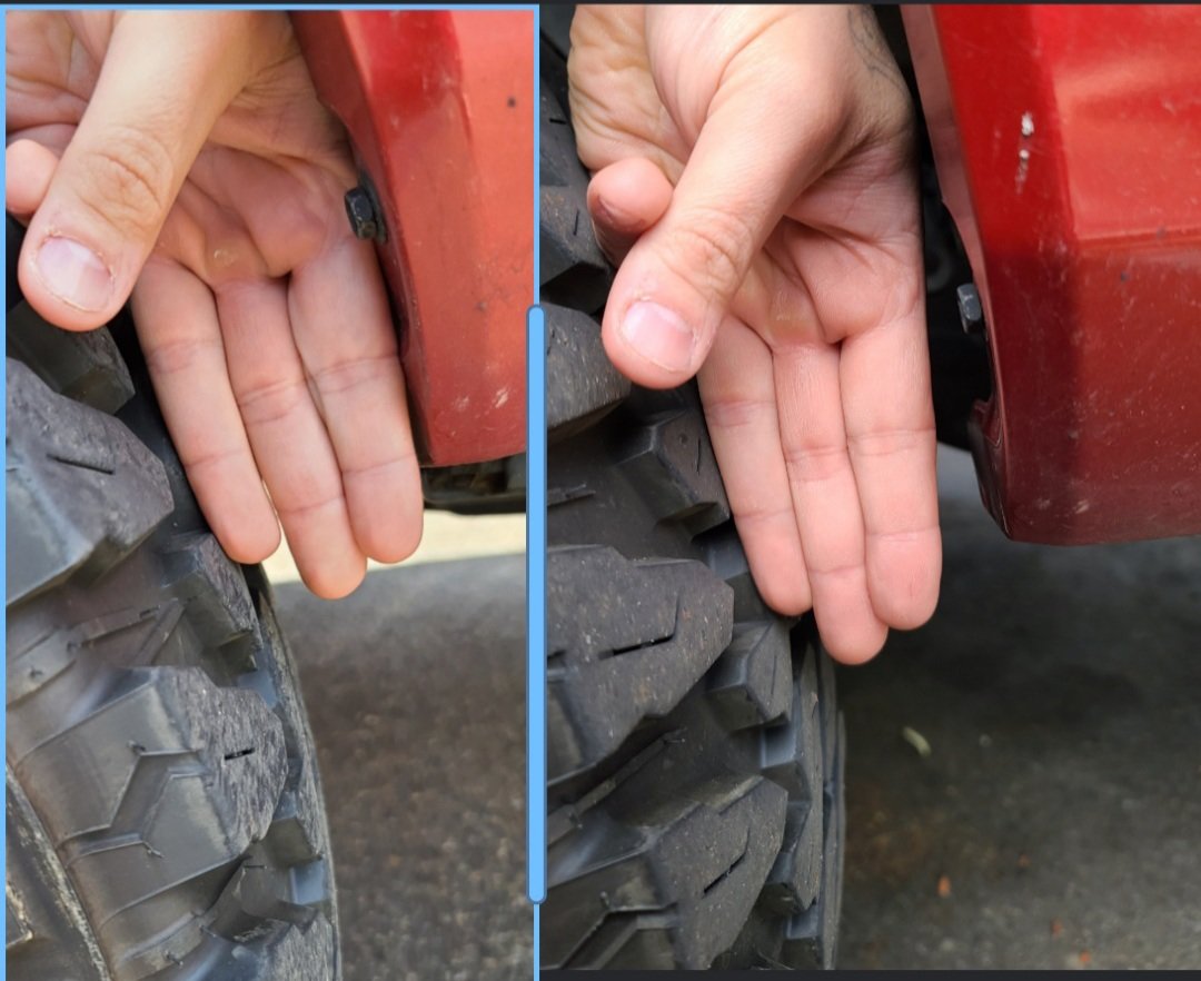

    Auburn offroad installed my spc ucas today and got it aligned. Told them to move the wheels are far forward as possible. Well they gained me atleast 3/4 of an inch I'd say, with my official measuring technique. Lol. After 33s and a lift now my alignment is spot in and it feels much better. Next, cmc, lol20200608_134325.jpg
