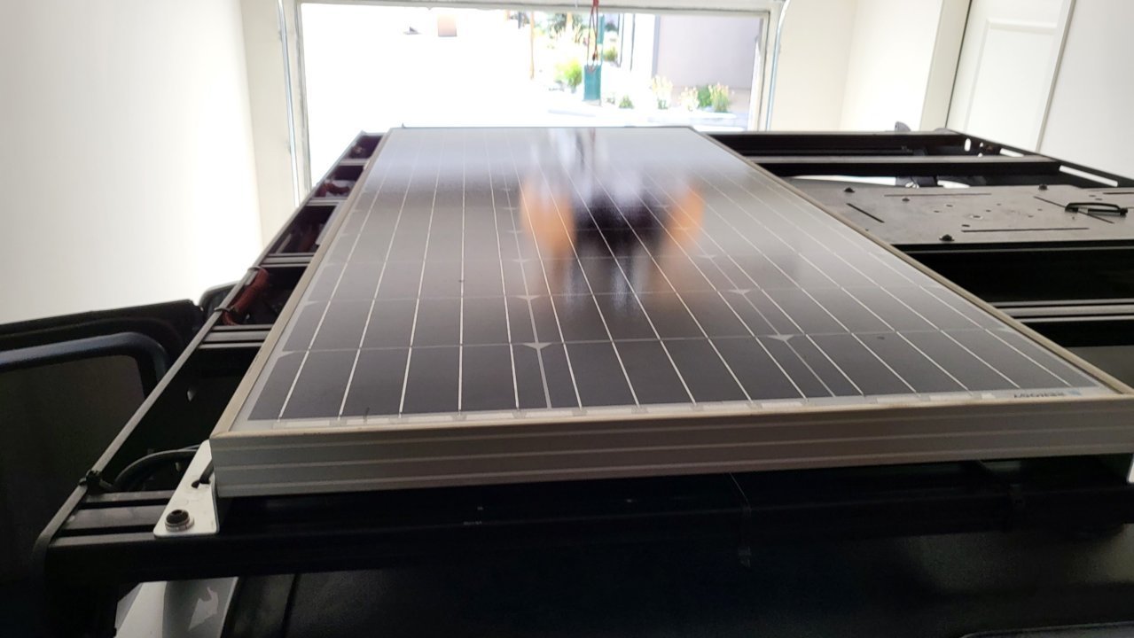

    Not much too it. I used roofing tape to tape down the edges of the solar panel and then routed the wiring down the passenger side of the bed rack. Just more roofing tape to secure it. Then I got a solar to 8mm adapter to plug into my Jackery. It's routed through the bed right under the cover at the front passenger side corner. I'm out of town otherwise I'd take some pics for you.
    iGreely Solar Panel to 8mm Adapter Cable DC 8mm Connector with DC 5.5x2.5mm Converter for Portable Backup Power Station GZ Yeti Jackery Solar Generator 14AWG 6ft https://www.amazon.com/dp/B07WSMJ7RC?_encoding=UTF8

    Best I can do til Friday/Saturday.
    Here's where I left the solar wiring hang when it's not hooked up.
    When it is hooked up, it's routed this way into the bed.

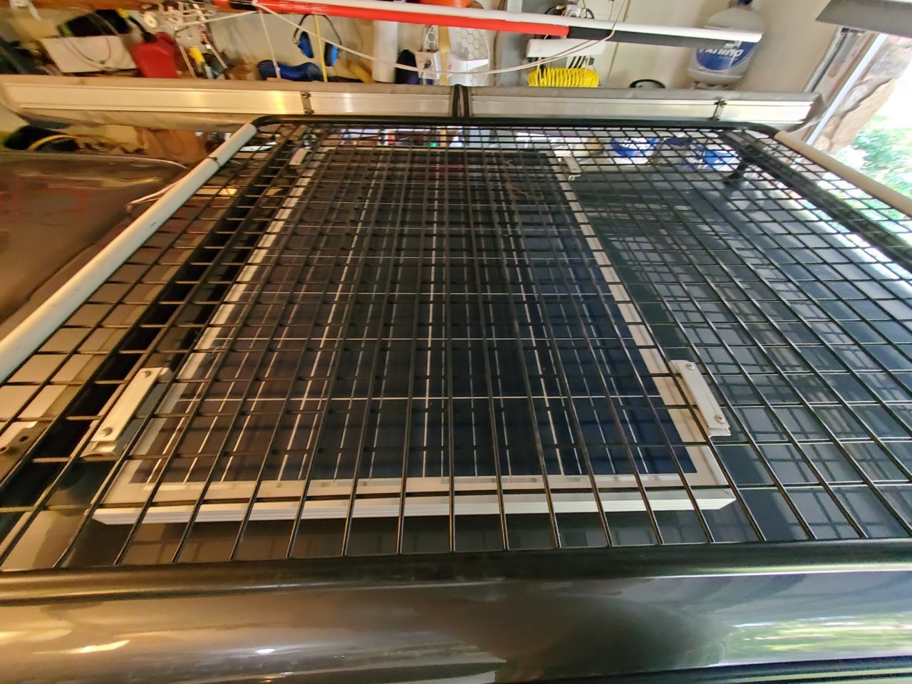

    there are some good solutions on many ways to go about and I was in your shoes when I wanted to do the same. I looked into cascadia 4x4, but again like everyone, taking advantage of a plug and play kit for dummies and a expensive one at that! What most dont realize is thiner/thin style solar panels have a high tendency to delaminate very quickly especially ones that are exposed to constant temps in the southwest, desert environments. I decided on a renogy 100 kit, which included a smart controller, for an extra 30 bucks I bought the BT controller/monitor and the temp sensor for the battery to monitor at all times. This cost me 100 bucks. The kit you can buy from Amazon is around 150 bucks last I checked. But it is more than enough to power everything you need. you will get max peak 80watts due to some loss (happens on all solar). Previously I had my panel on top of the CVT Mt. Hood. And when open put it right at 45 degrees for optimal performance , like so .
    I have since parted ways with most of that stuff and now run the same kit on top of my roof rack. https://www.amazon.com/Renogy-Monoc...=1&keywords=renogy+100&qid=1634742260&sr=8-13
    this is the exact same kit I have and its worth every penny. I am all about saving money, re-inventing the wheel with DIY stuff.
    Currently the leads going to the solar panel are ran down , left rear side of the truck, along the frame, and up in the engine bay. If anyone is curious/has questions, PM me, I can help with some advice on installs. I ran my scene lights at night for 9 hours, dometic cfx45 for 5 days without ever starting the truck.
    obviously being flat, isnt the most optimal place for a solar panel. I am making a DIY bracket that I can push to release the lock and have the panel fold up to around 45 degrees for the best performance. I hope my input helps OP or anyone else.

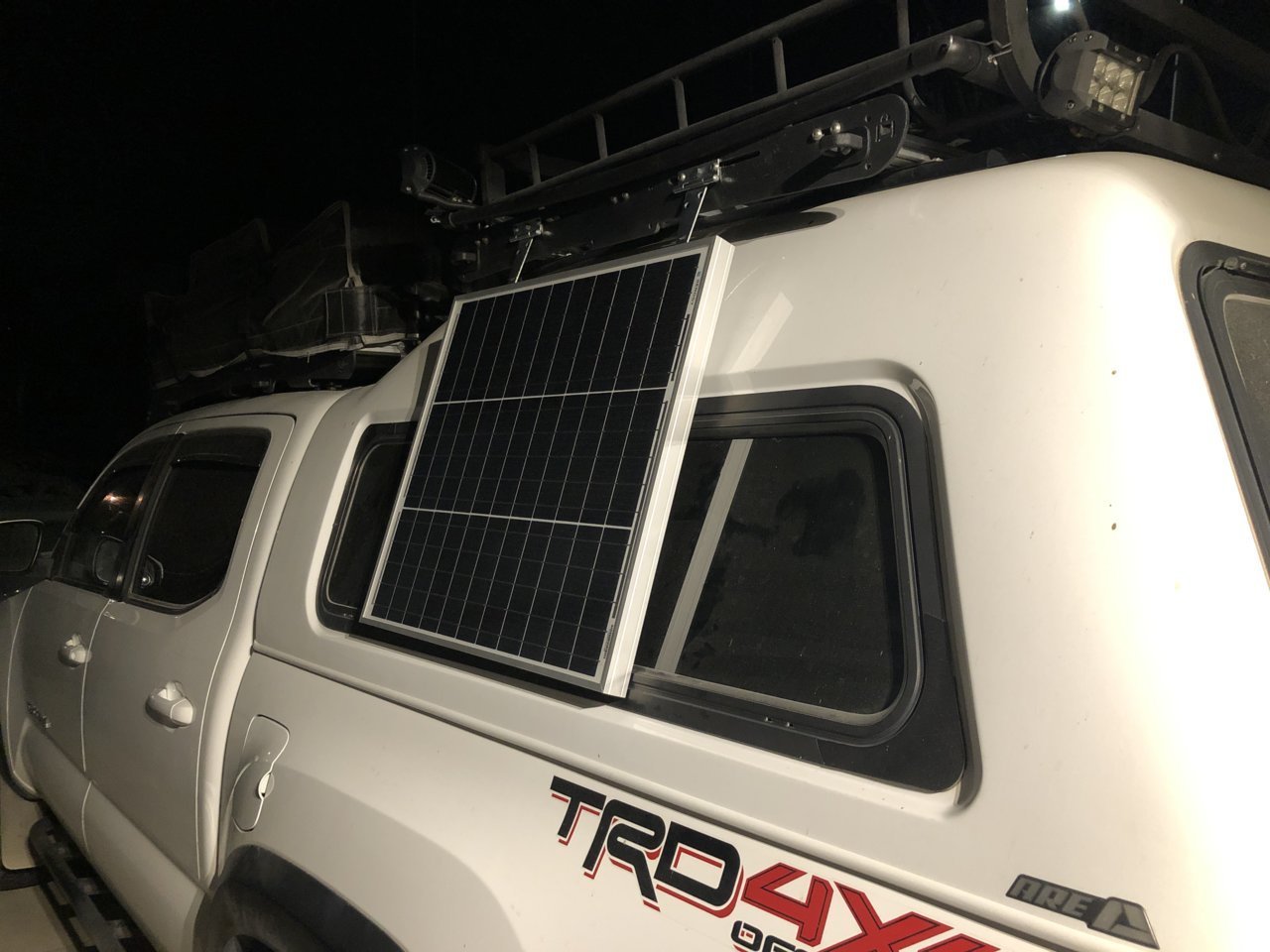

    FCB0B25F-A201-4555-8B8D-5E5FBE89F486.jpg I just did this- still goofing around with the mount... Making it lock down for security in the position shown, then when up it can face the sun directly from both sides of the truck when deployed in camp. My alternator will charge all the batteries while driving.
