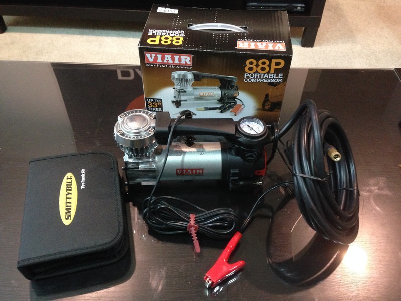

    I have 265/70/17's on my truck right now. I didn't buy a 5th tire and change out the spare when I bought them. Looking back I wish I did. I've considered still doing it but with my tires being about half worn out and wanting to upgrade to 33"s I am having a hard time justifying it. I do carry a really good tire plug/repair kit and compressor with me in the truck at all times. In the event of a flat I'll try and repair it before I resort to the spare. If I have to run the spare, I'll run it on the front and possibly have to swap some tires around to make that happen.

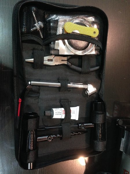

    Here is a photo of my repair kit and compressor when they were brand new.
    Viair 88P and Smittybilt Tire Repair Kit

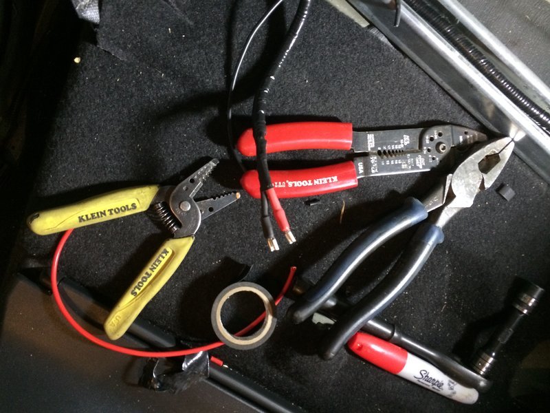

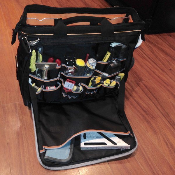

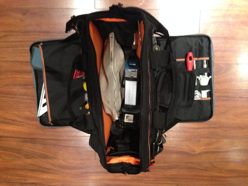

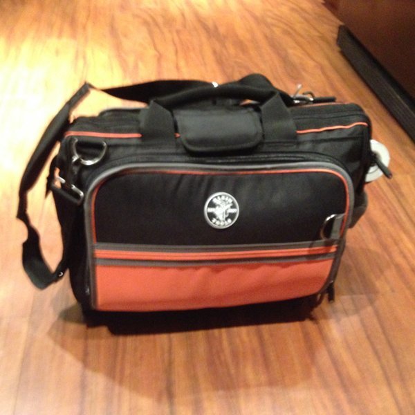

    Speaking of repairs and tools I received my new tool bag in the mail today from Amazon.
    It is a Klein Tradesman Pro Ulimate Electricians Bag. For those that don't know me that well I am a Red Seal Certified Journeyman Electrician. I take great pride in my work and I think the tools a tradesman carry with them says a lot about them and their work.
    Here's some pics of it fully loaded with some of my tools.
    While some these tools are meant just for the electrical trade there are a lot that can also be used for working on my truck and also repairing anything around camp. Before I head out on trips I will go through this bag and remove a few things and add a few different things from home meant more for working on my truck. I'm in love with this bag already. It is extremely heavy duty and well laid out to provide easy access and organization of all of my hand tools and room in the center section for cordless tools, meters, sockets and anything else oversized. When properly equipped with the right tools it will be a great addition to bring along with me in the truck.

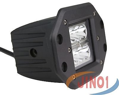

    I ordered a set of flush mount LED pods for the ARB front bumper.
    http://m.ebay.ca/itm/2PCS-24W-CREE-...-Flush-Mount-/351671380427?txnId=780983854022
    The damaged ARB bumper is the model without the fog light cutouts. I didn't want to lose having fog lights so I will have these cut into the ARB bumper and wire them up to my stock fog light harness. This will probably be a good time to also do the fog light anytime mod that I've been procrastinating about.
    I think the bumper may actually be easier to repair if a hole is cut into it as you may be able to rig something up to pull the dent out that way. For this reason I'll wait till these lights come in before I give this bumper and the lights to a metal fabricator to fix.

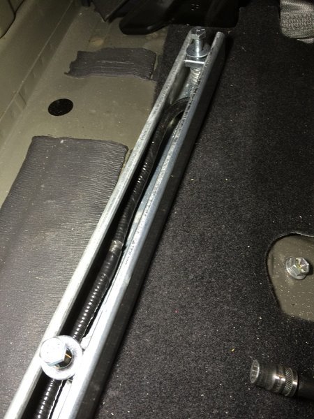

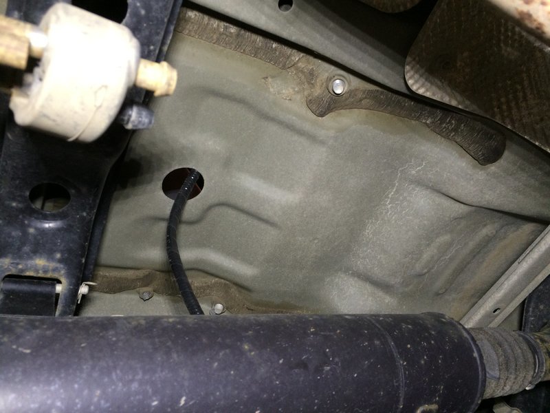

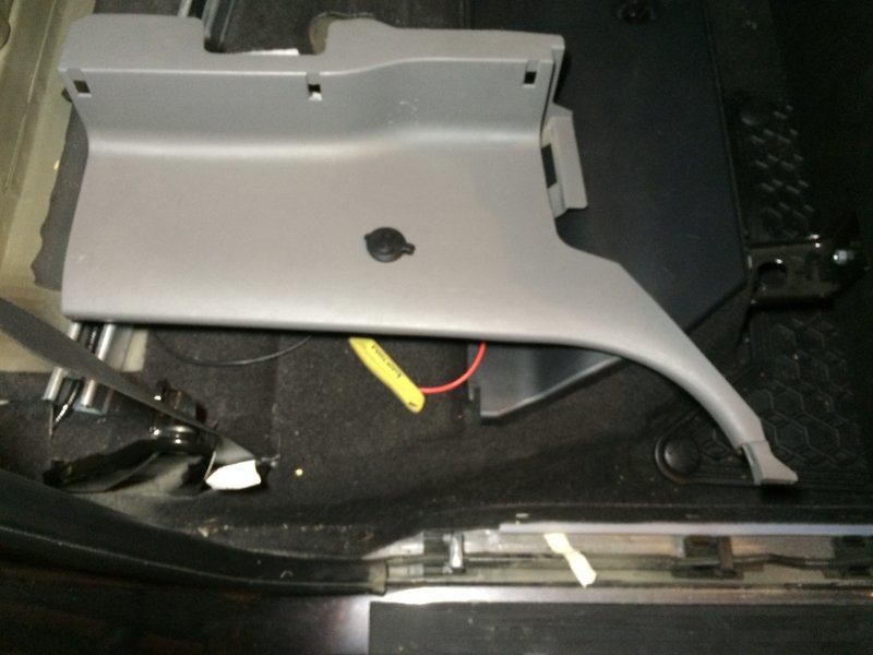

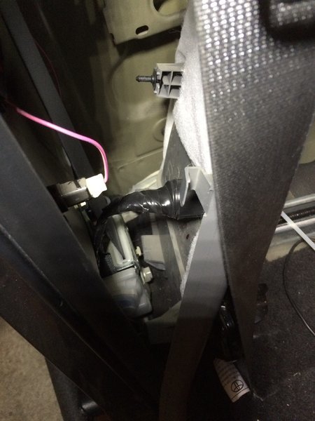

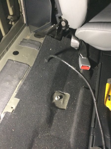

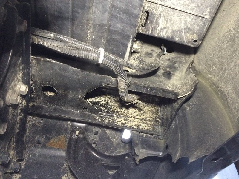

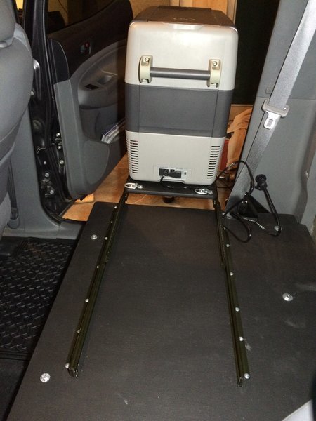

    Was able to get a little bit of work done on the truck today. I got the electrical ran for my fridge/freezer. I added a 12v socket near the rear passenger seatbelt spool. This was the most convient and out of the way location for the fridge plug and cord.
    All my materials and tools ready to go.
    I used the following:
    - Carchet flush mount 12v socket
    - # 12 AWG stranded wire (black and red
    - 1/4" split loom
    - Misc. crimp on connectors
    - red + black heat shrink
    - black electrical tape
    - zip ties

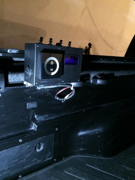

    The circuit will get fused at my blue sea fuse block mounted inside my control box mounted to my bedrail. My auxiliary battery is mounted underneath my sleeping platform. I don't have the platform or the battery in the truck right now so I have left this final connection undone untill I re-install my platform and battery gearing up for the upcoming camping season.

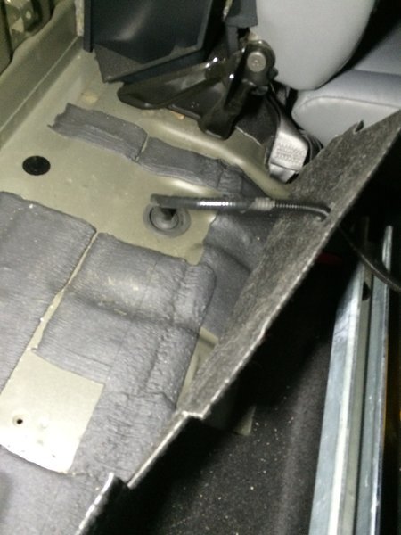

    I started work today by removing the piece of strut that I added to level out and hold down my slide platform. Because I used two factory bolts to hold this peice of strut down it is on an angle and unfortunately covers the factory grommet hole underneath the rear center seat. I simply drilled a 3/4" hole with some step bits and added a 3/4 grommet to the strut.
    I then inserted the wire into the split loom and taped it up with black electrical tape. Because this is a part of my auxiliary system and is ungrounded I needed to run both a positive and negative wire all the way back to my fuse block (Instead of just running the negative to a ground on the truck).

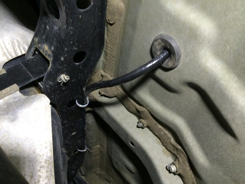

    Removed the grommet and starting running the wire.
    I ran the wiring with the stock wiring harness along the frame.
    Cut a small hole underneath my control box in the bed and fished up the wire.
    Once I had the wire in I zipped tied it with the stock harness along the frame.
    image.jpg punched a hole in the grommet, cut a slice in the carpet remounted the strut with the wire ran into it.image.jpgimage.jpg

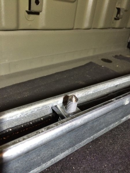

    I also added the spring bolts that I didn't have last weekend when I built the platform. I ran the wiring along the inside of the strut.

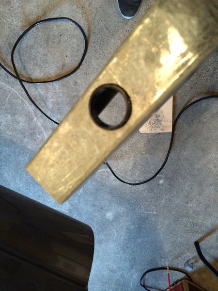

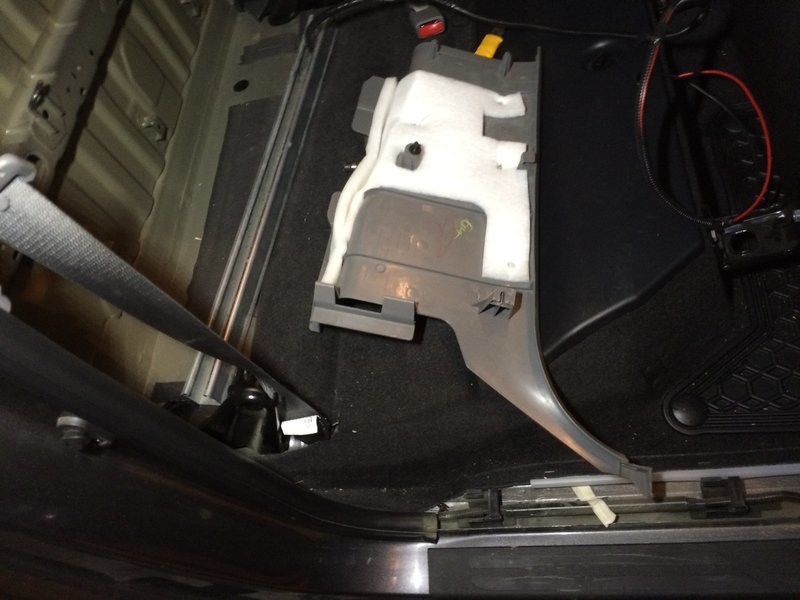

    Now I needed to begin mounting the 12v socket. I removed the plastic trim peice that covers the seatbelt spool. This is what I would be mounting the plug inside of. In order to remove this piece you also need to remove the door sill plastic.
    With the panel removed I ran the wires into the metal box out for the seat belt spoil and then added connectors and heat shrinked them.
    After some careful measuring, cut in the socket with a 3/4" stepbit.
    Because the socket is a very tight fit between the metal recession for the seatbelt spool and the seat belt itself I wrapped the entire connection in electrical tape to prevent any shorting. It clears without a problem but better safe than sorry.
    And here's everything snapped back into place.

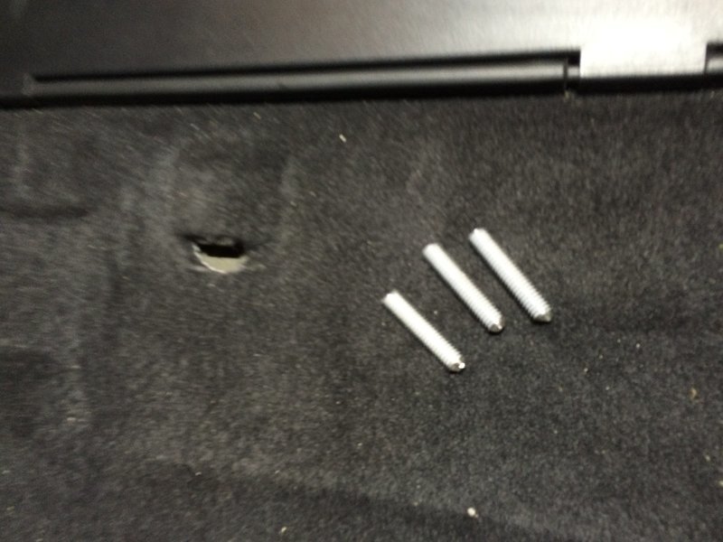

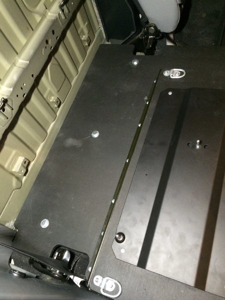

    I should also mention how I drilled the holes for the 3/8 bolts that go into the strut spring nuts to hold the platform down. Because it's ran on an angle measuring where to drill was sort of tricky. So I abandoned the tape measure and cut some pointed posts out of 3/8 rod.
    Screwed them into the spring nuts and then pressed the platform down onto these spikes and drilled out the marks/dents on the platform. Way easier than measuring!
    All bolted up
    Then I threw in the fridge to see how the cord worked out. I'm happy with it and the location of the plug.

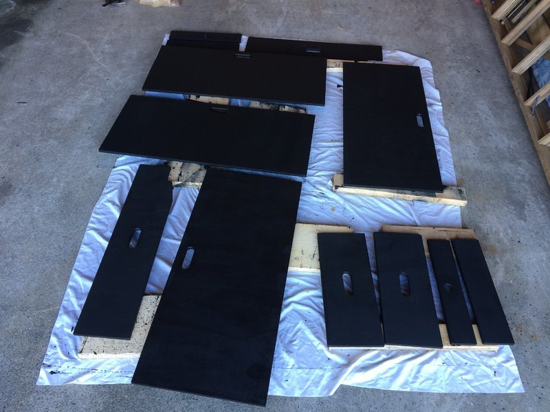

    Well after about 3 and a half hours and not nearly enough beer I managed to get the first coat of paint on the top peices of my sleeping platform. Took me way longer than I anticipated and this is still only the first coat!
    Before (only some of the peices are shown)
    After first coat (all top peices shown with hinges removed)

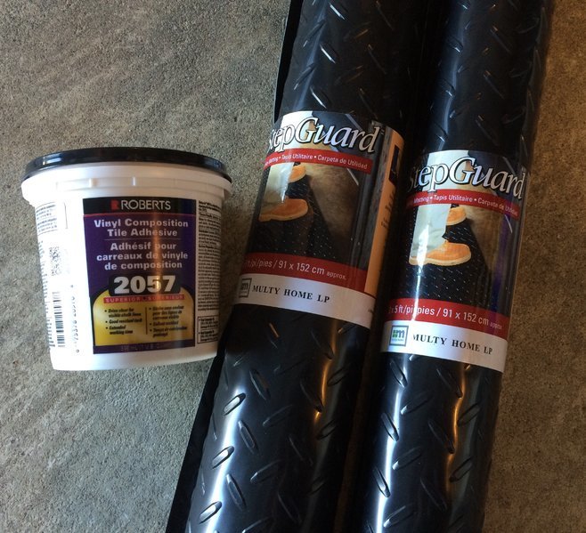

    For the bottom slide in section I have something a little different planned. Because I'm constantly sliding gear in and out from underneath the platform I don't think paint will hold up as well to the constant abuse. So I've picked up some "deck plate patterned" rubber/vinyl flooring.
    I'll use an adhesive to glue it to the bottom of the platform and paint the rest of it black. I considered adding this flooring to the top platform/hatches that I started painting today. I'll wait and see how the paint holds up before I add any more of this flooring to see if the extra weight of doing the entire top section is necessary.
    Each roll weighs around 5 pounds and I'd need around 3 rolls to do the entire top portion. For now, paint will do and I think it will really clean up the look of the platform while also protecting the wood from any water that somehow makes it way inside. Im having an issue right now whenever I park on a fairly steep angle pointing downwards water drips into my canopy from the back hatch. Still have to sort out where exactly this is coming from and if I can fix it.

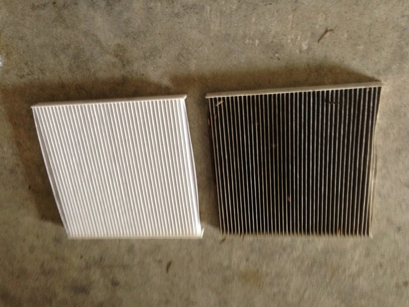

    Another thing I did today was change the cabin air filter. It was wayy overdue as you can tell from the photo.:anonymous:
    Freaking nasty!!
    Before and after
    Thank you @Crom for tiping me off on these cheap filters from TYC.
    TYC 800038P Toyota/Pontiac Replacement Cabin Air Filter
    They seem to be exactly the same quality as the OEM ones that Toyota wants a small fortune for. I ordered 4 of them and will be changing them out more regularily in the future.

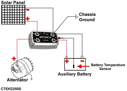

    And in other news, I just won a bid on eBay for a CTEK D250s Dual for $120US :bananadance:
    A little about the CTEK 250s Dual for those that don't know about the product.
    I've wanted one of these for about a year now ever since @Crom recommended it when I inquired about his solar setup before he started his own build page. I think this will really take my auxiliary battery system to the next level. I've been watching Amazon and eBay for a while now and I think I got it for a steal. Hopefully it arrives all good NIB (new in box) like the seller said.
    I've already started coming up with ideas on how I can mount my current solar panel over my shell before I get myself a cabrack. More to come on that in the future.

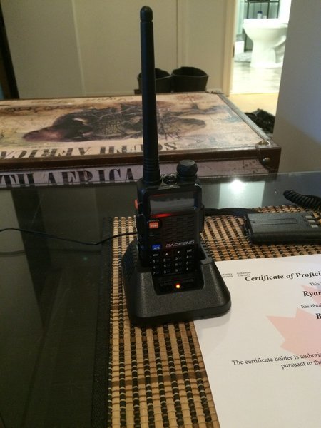

    Good news and bad news.
    The bad news is that package I talked about earlier didn't end up being the locking pin for my fridge slide.
    The good news is I won't be entirely without a radio this weekend. ;)
    My Baofeng BF-F8 + UHF/VHF handheld radio arrived from China. I wasn't expecting to receive this till at least April so I'm pleasantly surprised.
