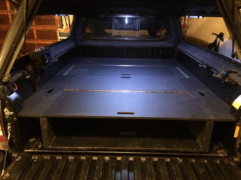

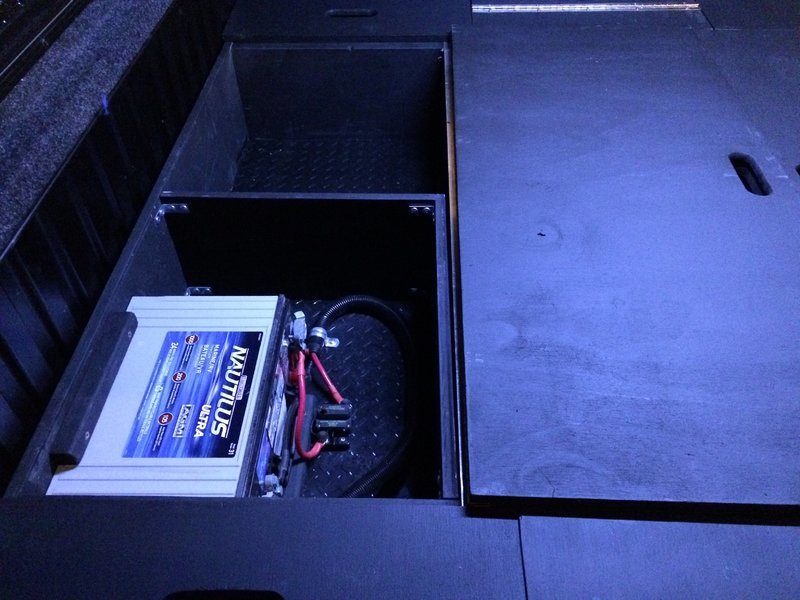

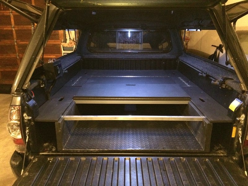

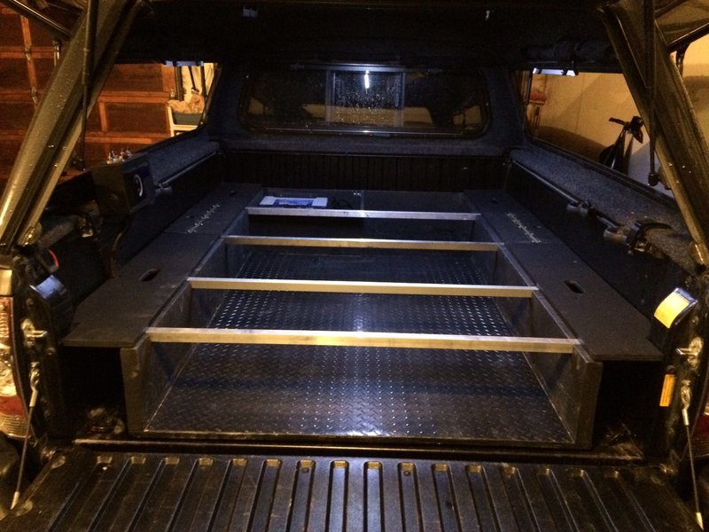

    Nothing quite like putting your truck together late into the night on the night before you are suppose to leave for a camping trip.
    Everything's back as it should be, with a few changes. It's far from perfect and still needs a bit of work but it'll get me through this weekend and that's all that matters!
    Just some pics for now, I'll do a better write up once I'm back in town as well as adding some pics from our trip.

    Very nice build. You have put a ton of planning and thought in to it. Also, putting the fridge in the cab like you did is one of the most unique and probably one of my most favorite mods I have ever seen someone do!

    Looking sharp Ryan! I like that battery install. Have a great weekend! :)

    That's a killer looking bed set up! Have a great trip!

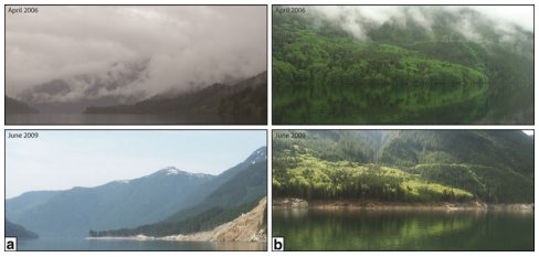

    A little history on Chehalis Lake.
    Source: Google Maps and Impacts of the 2007 Chehalis Lake Landslide
    The evidence of this slide are still evident today. There is tons of driftwood lining the beaches and you can clearly see where the Tsunami wave took out the shoreline. But it is still none the less a beautiful spot. The wave took out 3 campgrounds but luckily no one was killed or injured in the slide/tsunami as it happened in the off season. The only way to access the lake currently is through the north end via Mystery Creek FSR as the south side has been gated off and the slide debris took out the FSR along the lakeside that connected the North and South access.

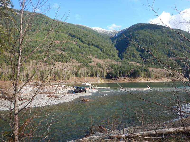

    Here is a photo of the lake that I took upon our arrival
    The weather was warm and sunny but we knew the nights were going to be cold. Check out the snowline!

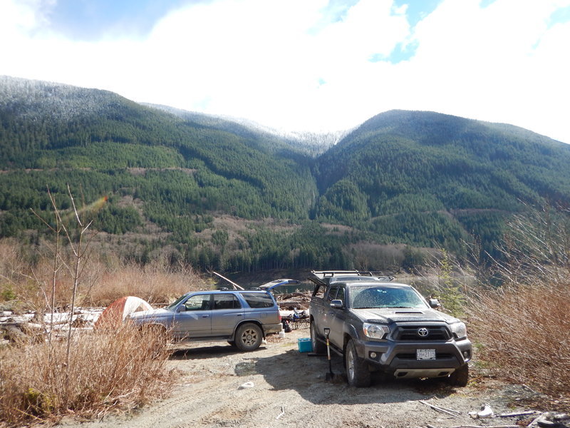

    We quickly set up camp to make claim to our new campsite.

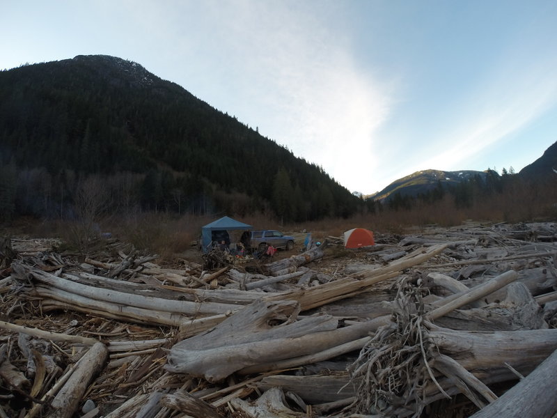

    This area is still really undeveloped. There are no outhouses or fire rings. There is also tons of driftwood along the beach that makes it difficult to gain access to the water. Not wanting to hurt ourselves tripping over driftwood we decided to clear a path down to the water.
    I wish I had taken a before photo of this, but you get the idea.

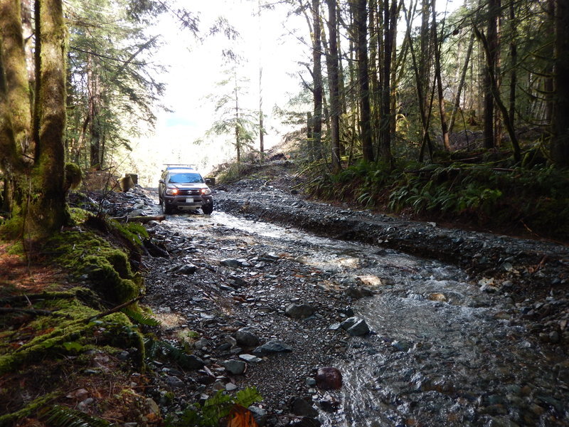

    One the way out, back through the washed out section. My buddy in his 4Runner.

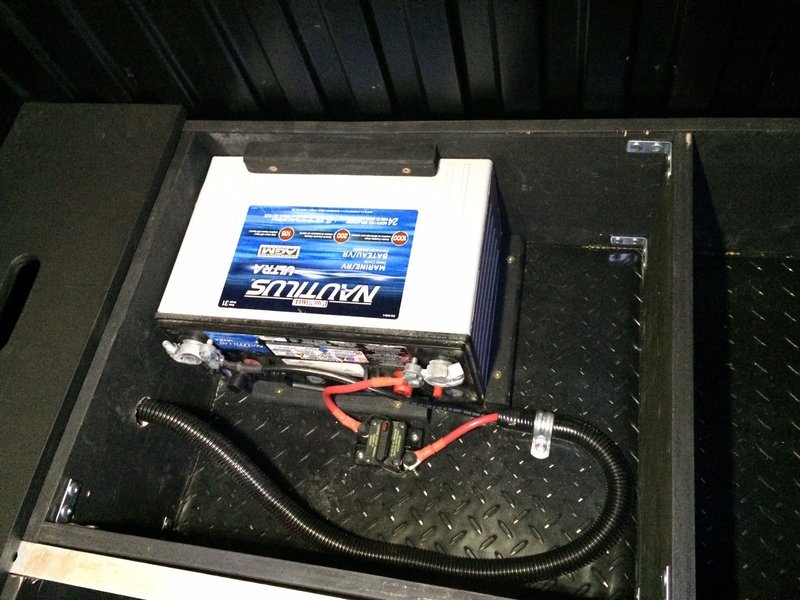

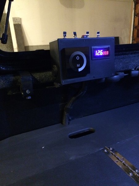

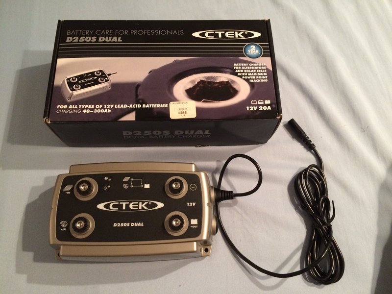

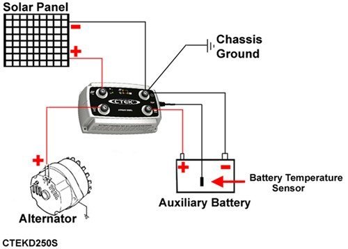

    CTEK D250s Dual
    Got my CTEK DC-DC Smart Charger and Solar Regulator installed and up and running today. This is a huge step forward in my build and my dual/auxiliary battery system. With this unit I now have a truly maintenance free auxiliary battery system. No longer do I need to worry about setting up solar for recharging or removing my heavy as fuck 105ah deep cycle AGM battery from the truck and putting it on my bench charger.
    For those that are unfamiliar with the product here are its features
    • Multi-step 20A DC-DC smart charger (hooked up to starting battery/alternator)
    • Battery separator that eliminates diodes, VSR's, and allows charging between two dissimilar battery types (wet cell starting battery and a AGM deep cycle auxiliary battery)
    • Two power source inputs (alternator and solar panel).
    • Solar panel regulator with Maximum Power Point Tracking, which can be hooked up for synchronised charging with the alternator input.
    • Maintenance charge of starter battery from solar panel once auxillary battery is fully charged.
    I plan on eventually hard mounting solar to my truck but until then this unit will make sure my battery is always fully charged once I reach my destination. This unit will also more efficiently charge my battery from my solar panel as it is a MPPT (Maximum Power Point Tracking) solar regulator versus the cheap PWM (Pulse Width Modulation) solar regulator that I was previously using.
    I've been watching eBay for a while now and I was able to score this unit for $120 USD. They normally retail in the $250-$300 USD range.

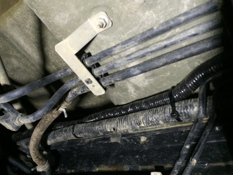

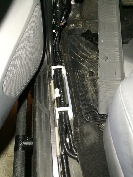

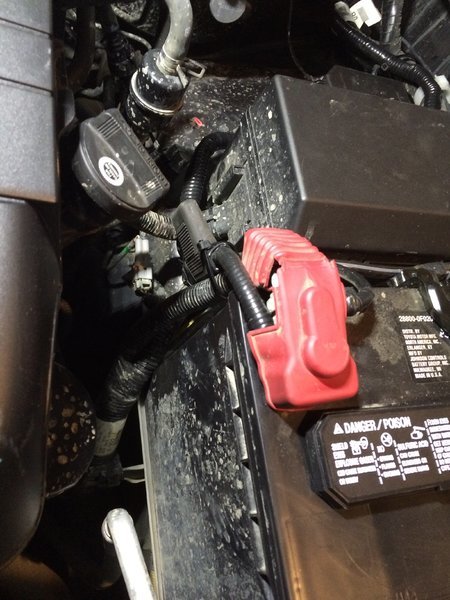

    The wiring instructions from CTEK can be a little confusing. There are also many different variations of wiring diagrams that can be found online. The install for my application is pretty straight forward. This is the wiring diagram the I went off for my install.
    CTEK recommends using a 30A inline fuse on the positive wire ran from the starting battery/alternator and using #10 AWG wire. I used a 30A fuse and bumped the wire size up to #8 AWG.
    While #10 wire would have been just fine I used #8 because I found it on sale at a local store for less than what they had #10 wire going for. I also needed some #8 wire for wiring my 900w inverter that requires a 40A fuse. I also prefer the non insulated cable lugs that are commonly available for #8 and larger wire compared to the cheap insulated lugs that you find everywhere that get used with #10 and smaller wiring. I realize they make non-insulated connectors and lugs smaller than #8 but I've yet to find a local store that sells any.

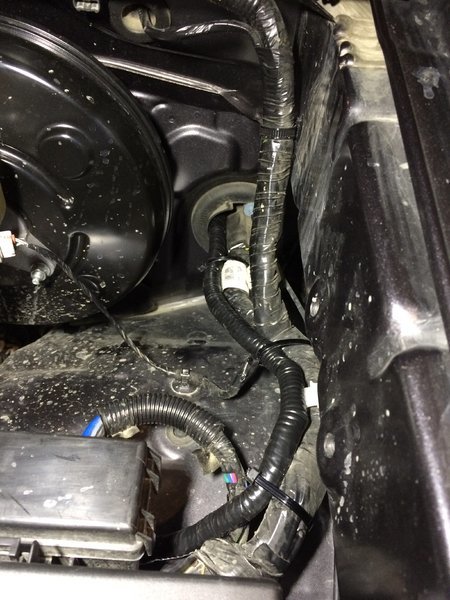

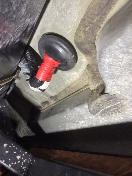

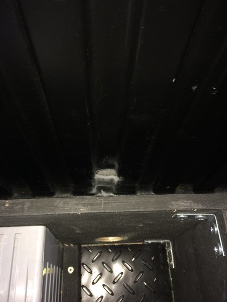

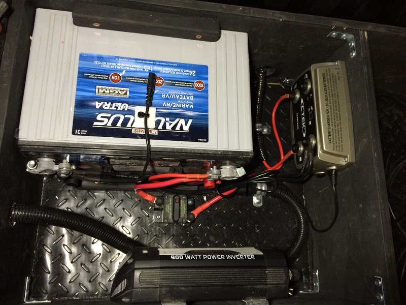

    I started my install by drilling a hole through my sleeping platform straight through into my box.
    I cried a little inside at this point because I hate drilling holes into my truck and try to use existing holes whenever possible but I did what needed to be done. I drilled a 1 1/2" hole and the hole in the box will get sealed with some "duct seal" which is a basically a moldable clay like putty that will seal the hole against water and dust. It's easy to remove and run more wires later. My solar wire cables will find there way through this hole eventually so that is why I went with such a large hole.
    After drilling the holes I ran the positive wire to the starter battery. This can be ran along the frame rail with the stock harness all the way up until underneath the drivers seat. Because of the front suspension, exhaust, motor, tranny, etc, the only way to get the wire up to the battery is to run it with the stock harness through tbe floor, into the door sill, under the dash and up and through the firewall.
    Here is some photos of that process.
    Starter battery w/ Inline waterproof 30A fuse installed.

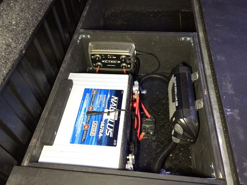

    I ran the ground wire from the CTEK in #8 as well. This was put underneath a threaded/taped bolt that screws into the frame that holds the parking brake cable. No photo of this, hard angle to get a good photo and I had about enough crawling around under my truck at this point.
    Once the ground and positive wires were ran, the install was pretty easy. Here's some pics of it complete, minus the solar leads.
    My 900w inverter has been mounted for now. I'll wire it later once I decide what I'm going to do with an outlet and a remote start button. I had this inverter previously mounted underneath the platform by the left drivers side cubby hole at the very back of the truck so that I could reach it with the tailgate down. I didn't like this location as it interfered with gear storage. This is why I built the battery/electrical box at the front left of the box to keep everything contained and out of the way.

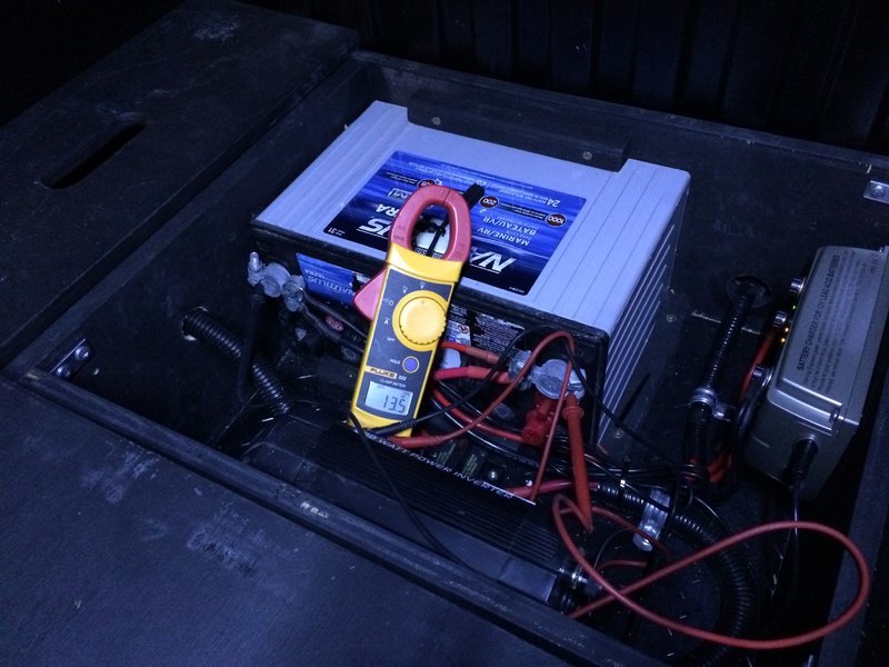

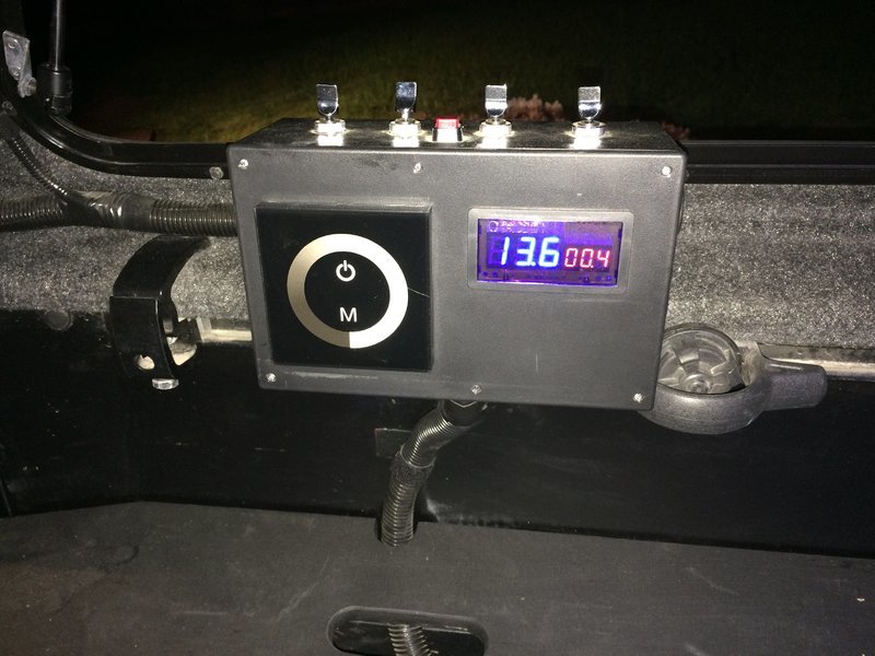

    After everything was hooked up I did a quick test with the truck running to confirm the Chargers working.
    13.5v, yup it's working!

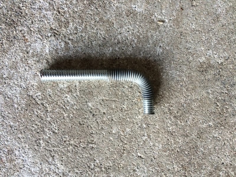

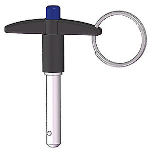

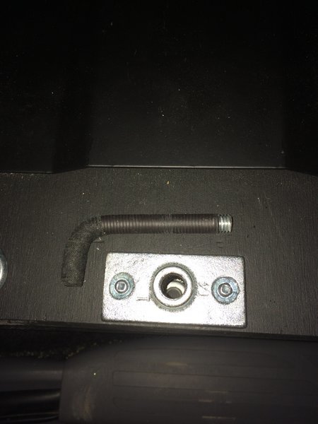

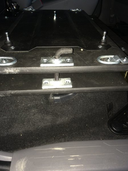

    Finally did something to lock my fridge slide in the closed position. I've just been throwing a rolled up towel next to the door to prevent it from sliding.
    I tried sourcing a locking t handle pin for it with receptacle. Something along the lines of this.
    After trying to source these parts locally and failing I tried ordering online through a US distributor. They refused to ship to Canada and even refused to ship to my US PO box. Dunno what they have against Canadian consumers but they can go fuck themselves.

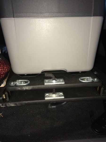

    So rather than spend more time trying to source these parts I just ended up DIY'ing it with some parts I already had at hand. I honestly should have just done this from the beginning.
    Total cost $0.00, simple and effective just the way I like it.

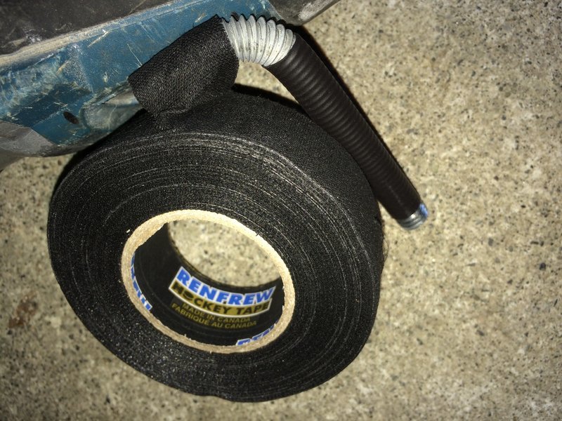

    Cut and bent a peice of 3/8 rod. Used a torch to heat it up before bending.
    Heat shrinked the lower portion and wrapped some good 'ole Canadian made hockey tape around the handle portion to be easy on the hands.
    Screwed on a 3/8" ceiling flange with the hole and threads reamed out. I didn't want the rod chewing up the wood so I used this plate as a guide for it. I also don't have to unscrew the entire portion just the bottom plate by doing this.
    And then screwed another plate with the thread intact at the bottom.
    Fridge in place, and slide officially secured :D
    @ChamYota you might find this useful for your DIY slide.

    Nice pictures of your camp and Chehalis Lake. Electrical and fridge slide lock looks good.
