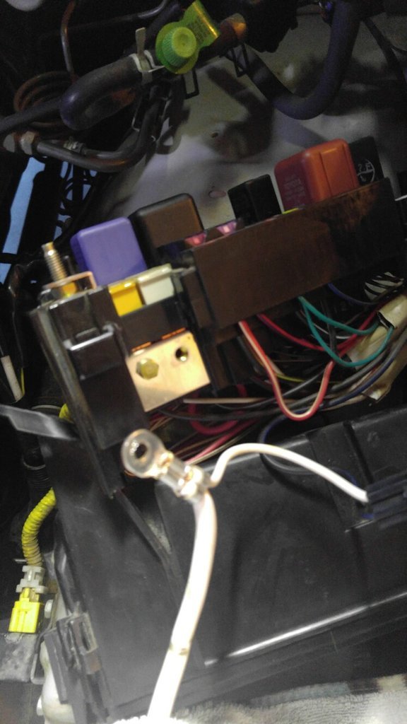

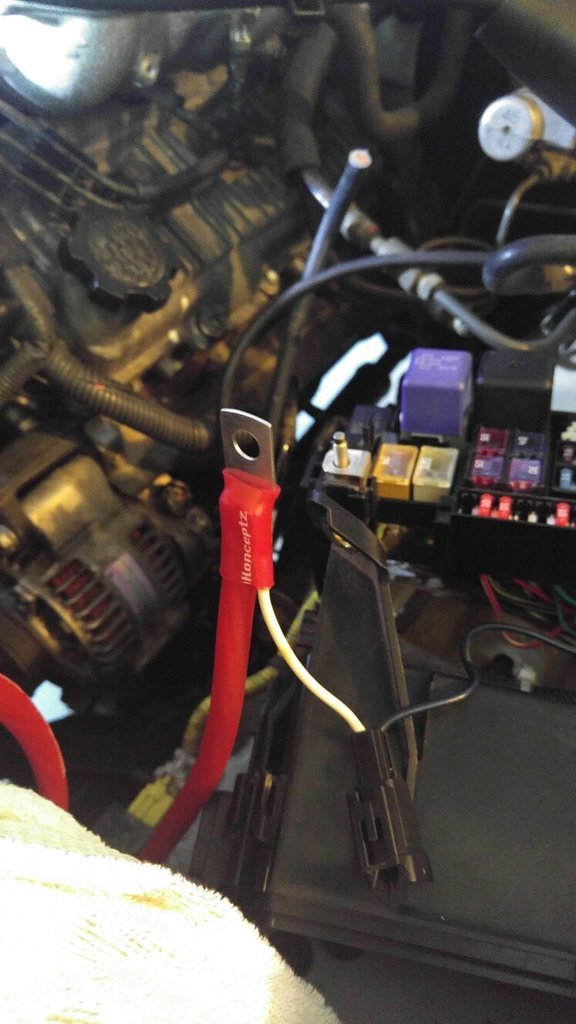

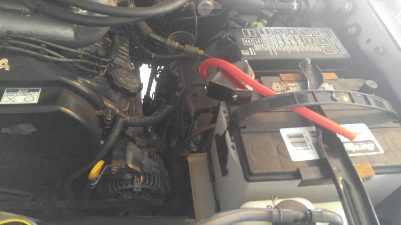

    So far, I have redone the engine and chassis ground, and also the alternator to fuse box and fuse box to battery with 4AWG wire and battery terminals from KnuConceptz. I took the time to completely remove the looms and replace all the wire rather than just zip tie them. I also wrapped them all in the correct Tesa tape for engine bays.

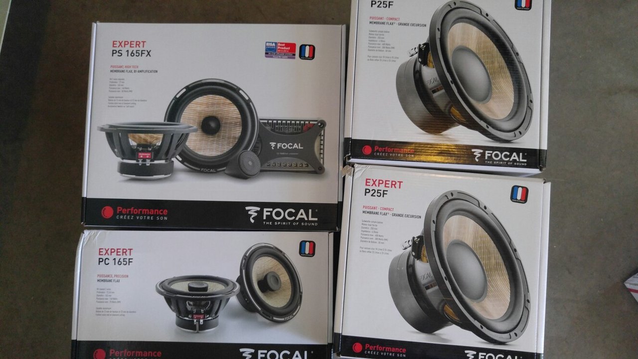

    JL Audio XD600/1v2 monoblock amp to run 2 x 10" Focal P25F flax subs
    JL Audio XD400/4v2 4 channel amp. Really wanted to go 6 channel here but didn't have room and switched some stuff up. Oh well.
    Rears are Focal PC165F 6.5" coaxial
    Fronts are Focal PC165FX 6.5" components (wanted the three way, but time/$)

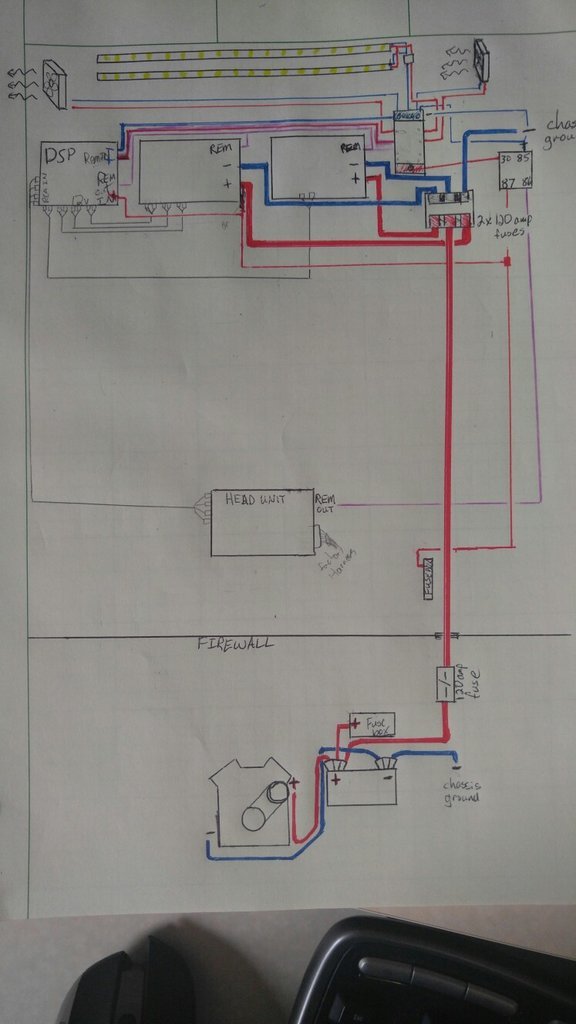

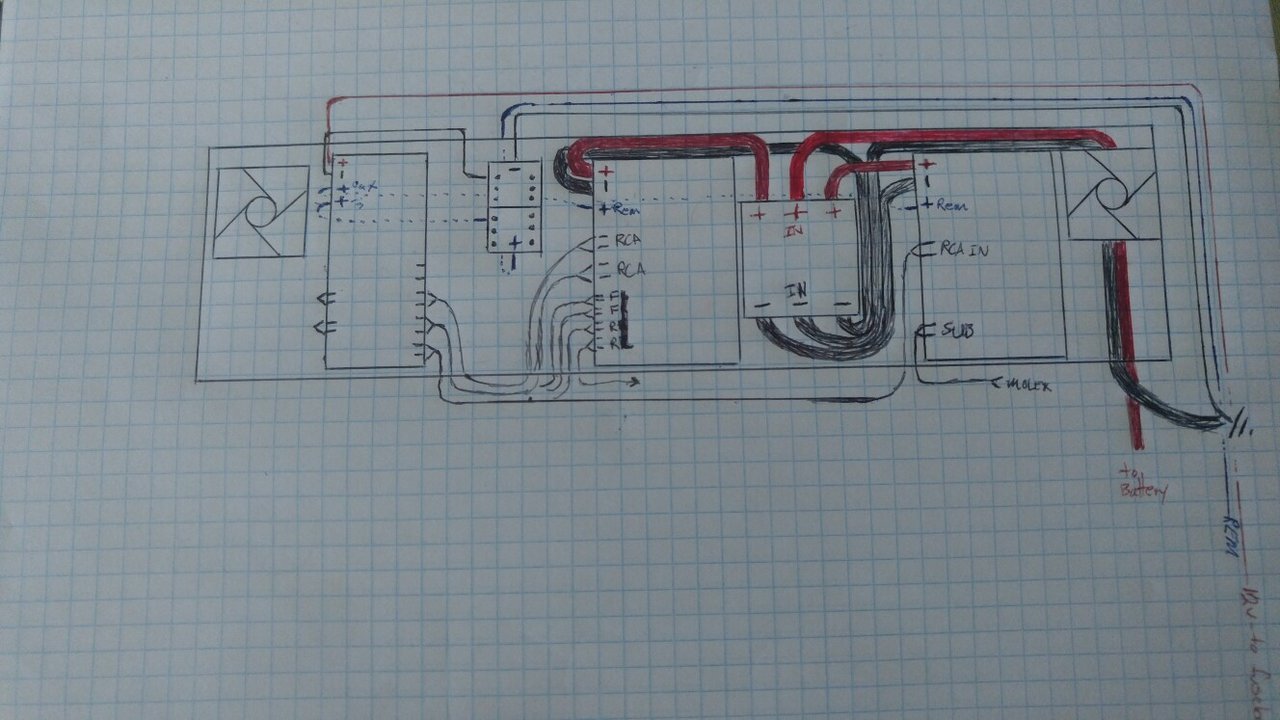

    This is my wiring diagram that I originally created

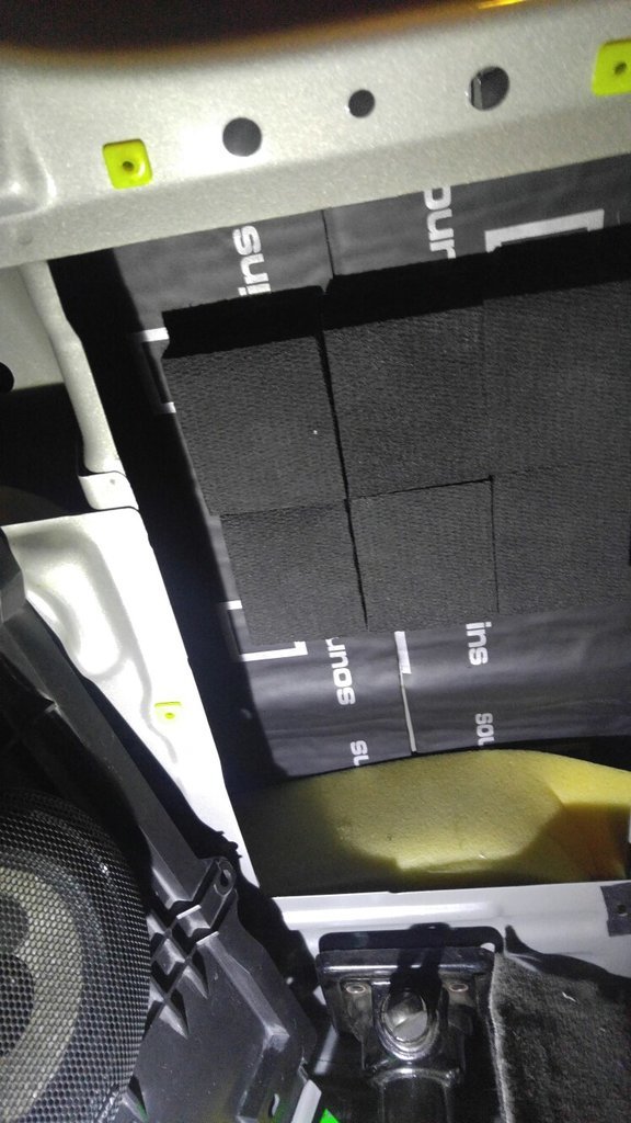

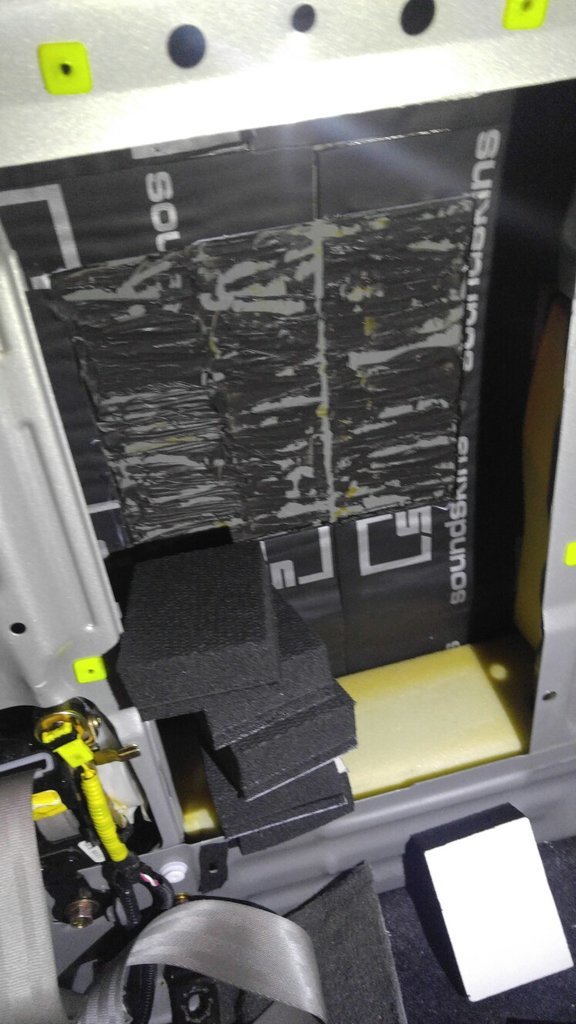

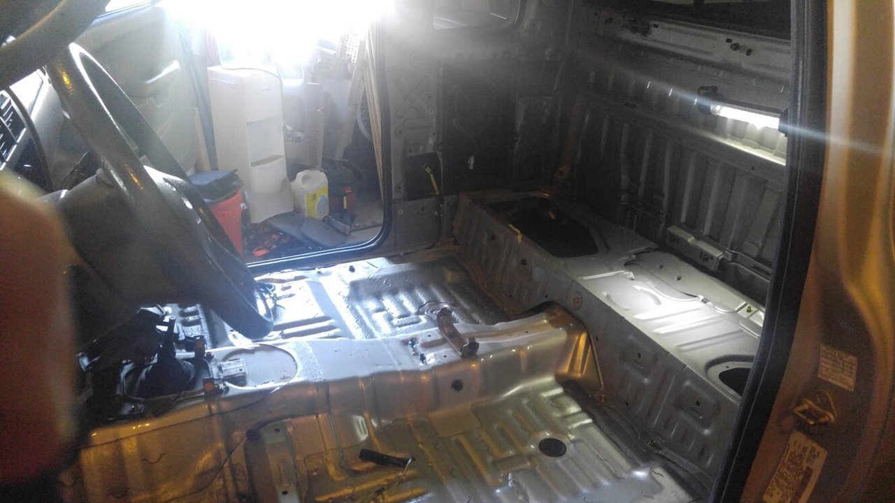

    First though, I removed the interior and wiped everything down with rubbing alcohol to degrease and clean. I then installed 4 rolls of sound skins sound deadener. Awesome stuff and quiets the cabin a TON. I did the doors, side panels, back panel, and floor. I didn't do above the headliner. I also wrapped every wire in Tesa tape and or foam and silenced every plastic clip that was touching metal.
    I used press and seal from the kitchen for a template to do the cut outs and it worked really well and cheaply.

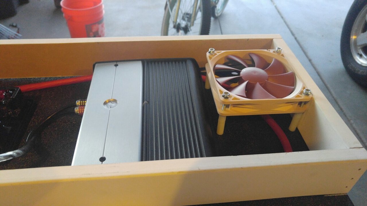

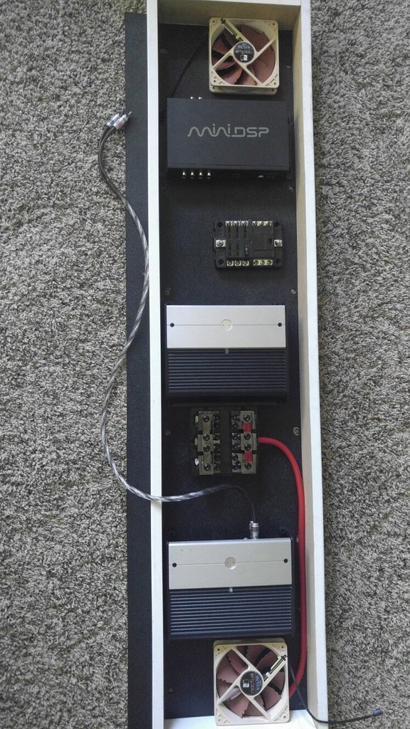

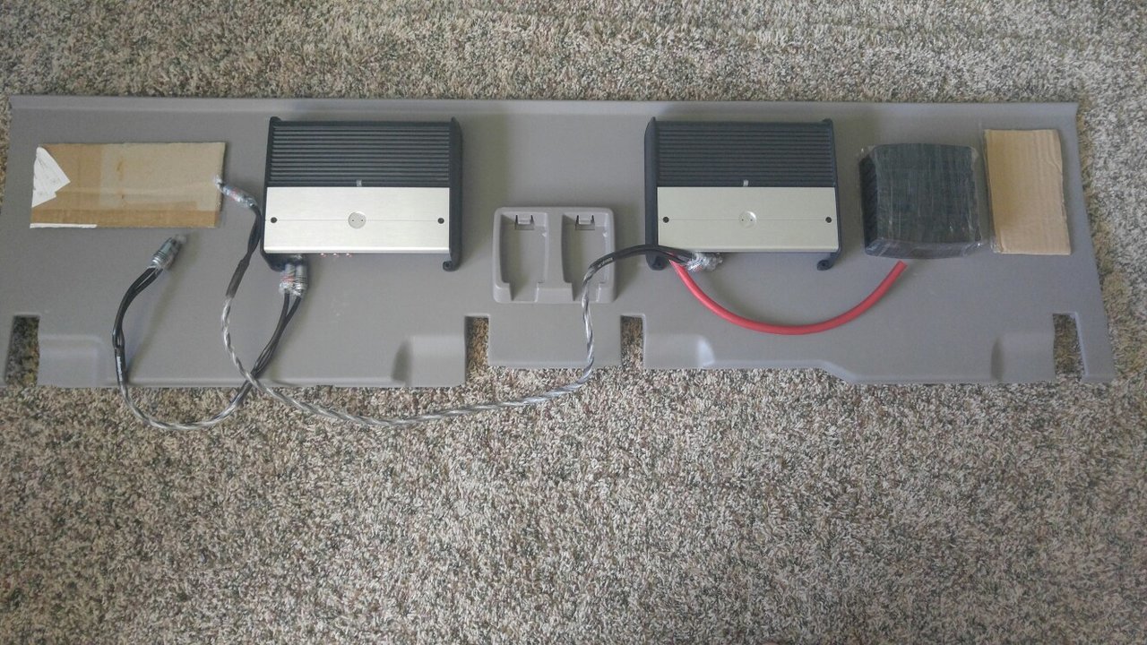

    I did a 1/8" ABS plastic backing board with some wood around the edges. In the wood are neodymium magnets to eventually hold a cover made of wood and wrapped in vinyl.

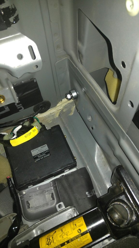

    Because there is very little clearance behind the amp rack and the rear, I had to make sure that all nuts and bolts were the exact right length. Tacoma screw was amazing on that.
    I created fan mounts with nylon spacers and some nylocks and bolts. These are Noctua 120mm fans. They are extremely quiet. Part of the three months was spent trying to engineer a solution to have a thermal probe and PWM modulation for full computer-like fan control. I gave up and just went straight full power on the fan, but with the resistor for lowering the voltage and thus fan speed. Turns out I wasted all that time because these fans are silent and move a ton of air. They are in a push/pull config.

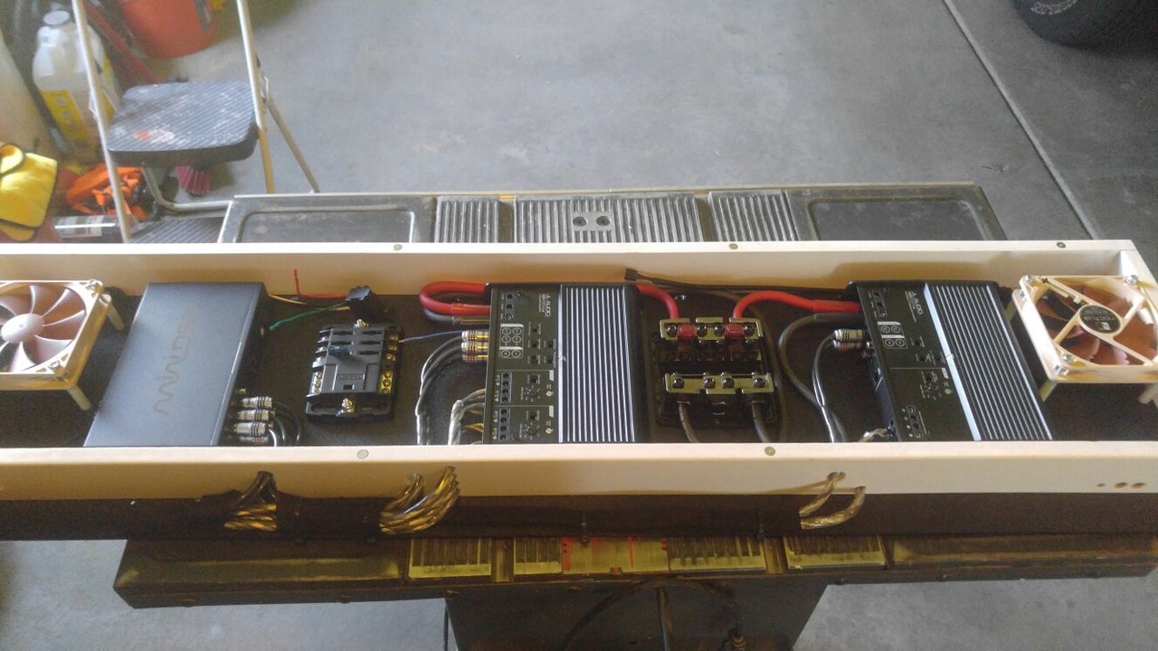

    This is the amp rack mostly complete. I'll get a new pic eventually as it's all done. All the wires are terminated and heat shrunk and silenced. I hooked it all up temporarily to test the remote turn on and relay. There is a blue sea systems fuse block in there. Basically, the remote turn on from the head unit turns on the dsp. After a two second delay, the dsp turns on the relay which powers the fuse block. The amps, LEDs, and fans are all powered off the fuse block.
    All the speaker wires come out on the lower left and are soldered to XT-60 Molex connectors.
    I used wire ferrules on all the amplifier connections.

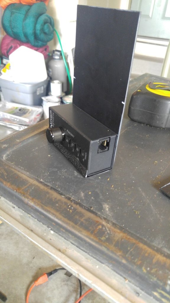

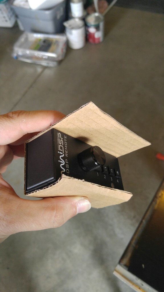

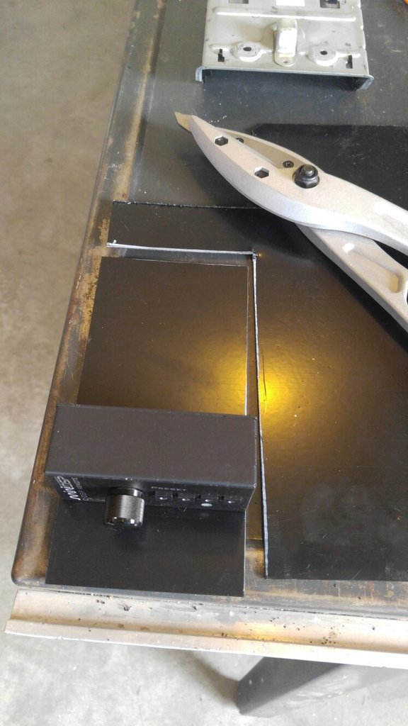

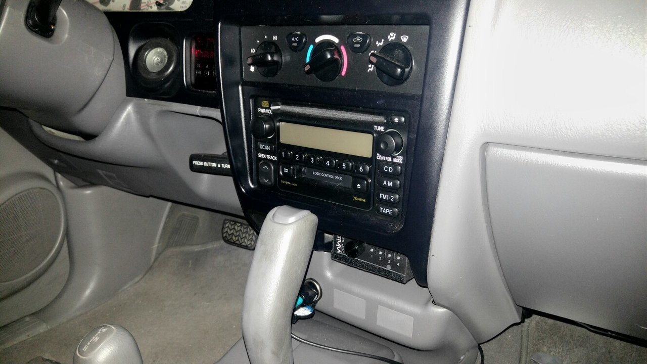

    This is a little mount that I made for the DSP remote.
    0806171622-747x1328.jpg 0806171622a-747x1328.jpg 0806171648-747x1328.jpg 0806171650-747x1328.jpg 0806172137-1328x747.jpg
    I replaced the ashtray with this.
    Marine 8541 likes this.

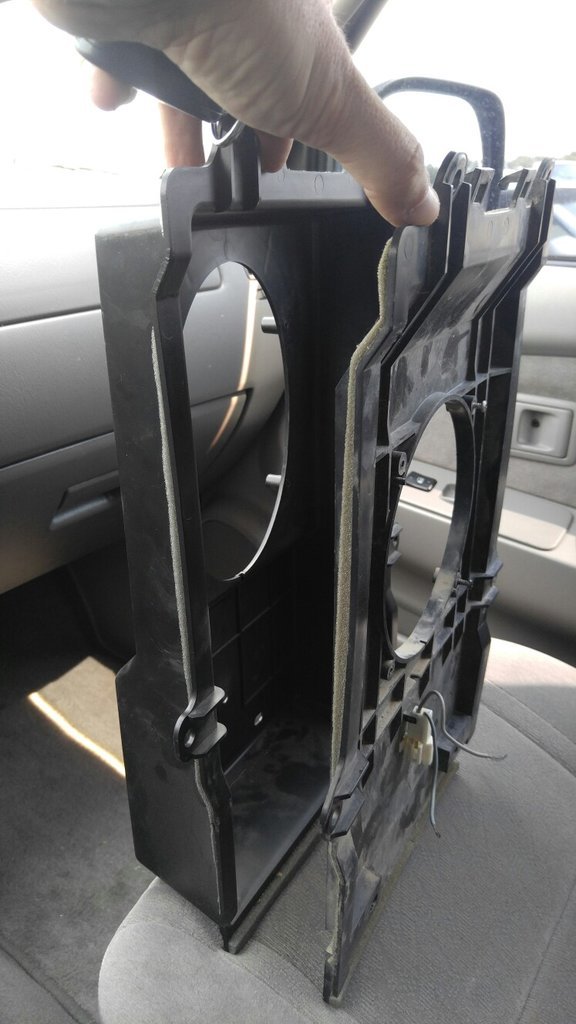

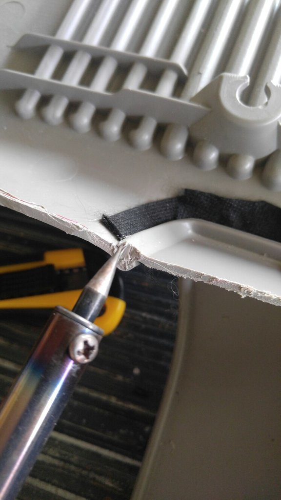

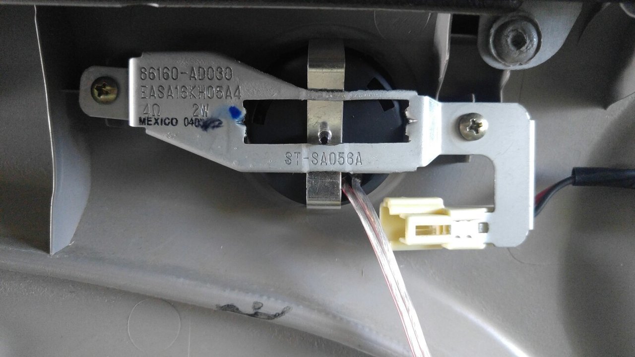

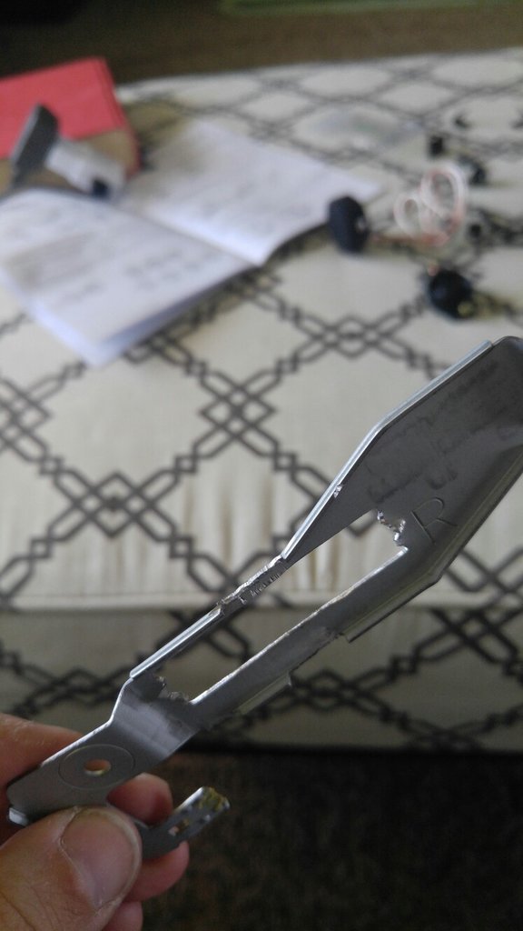

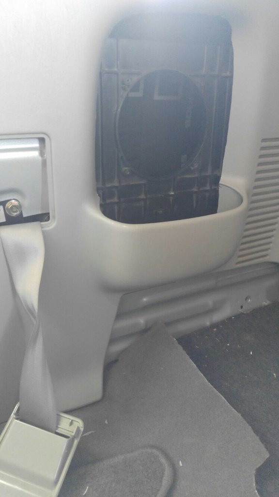

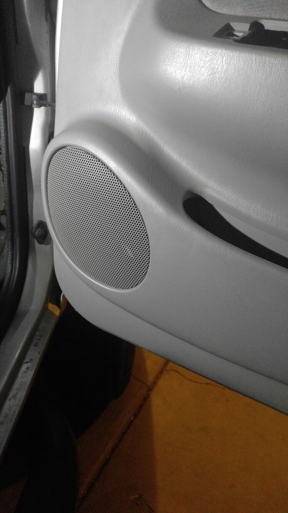

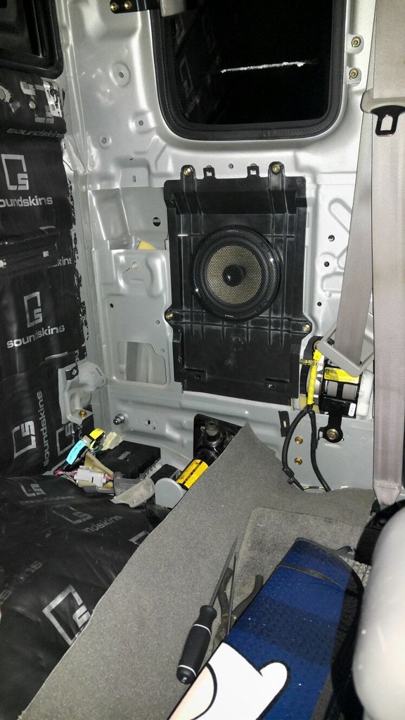

    Both the rear and front speakers are an inch deeper than the OEM speakers. This meant fabricating and cutting and generally, a metric butt ton of fun.
    Luckily, I went to the junkyard and a different model of SR5 has flat panel instead of inset ones. The speaker baffles are also 6.5". What do you know, they fit exactly the same. I did cut out the side panel to make them fit and will be doing a little vinyl wrapped panel to make it look nice.
    0809171509-747x1328.jpg 0813171621-747x1328.jpg 0813171419a-747x1328.jpg 0815172124-747x1328.jpg

    Behind the speakers are Focal thick sound tiles to stop back wave interference.

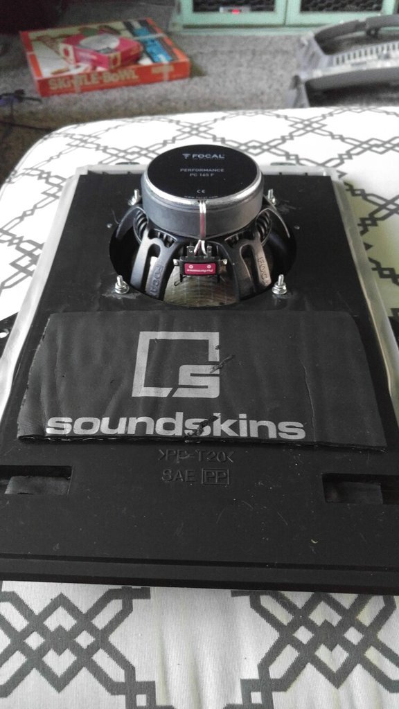

    Speakers mounted with better hardware and some excess sound skins for more mass on the plastic baffle.

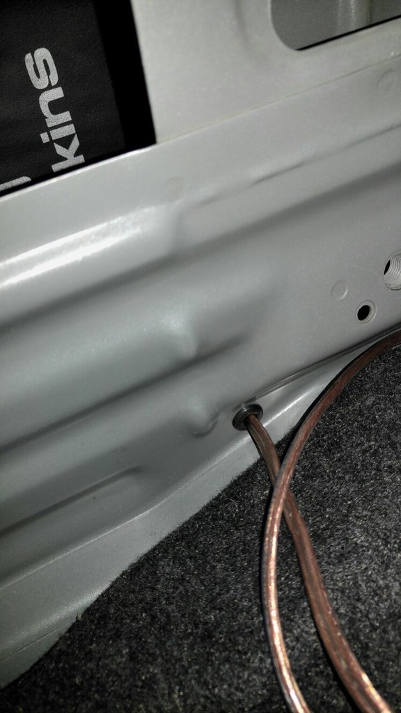

    Ran speaker wire through sheet metal with a grommet.

    Rear speaker mounted. The panel isn't going back on until I get new hardware for the Windows and wiring done.

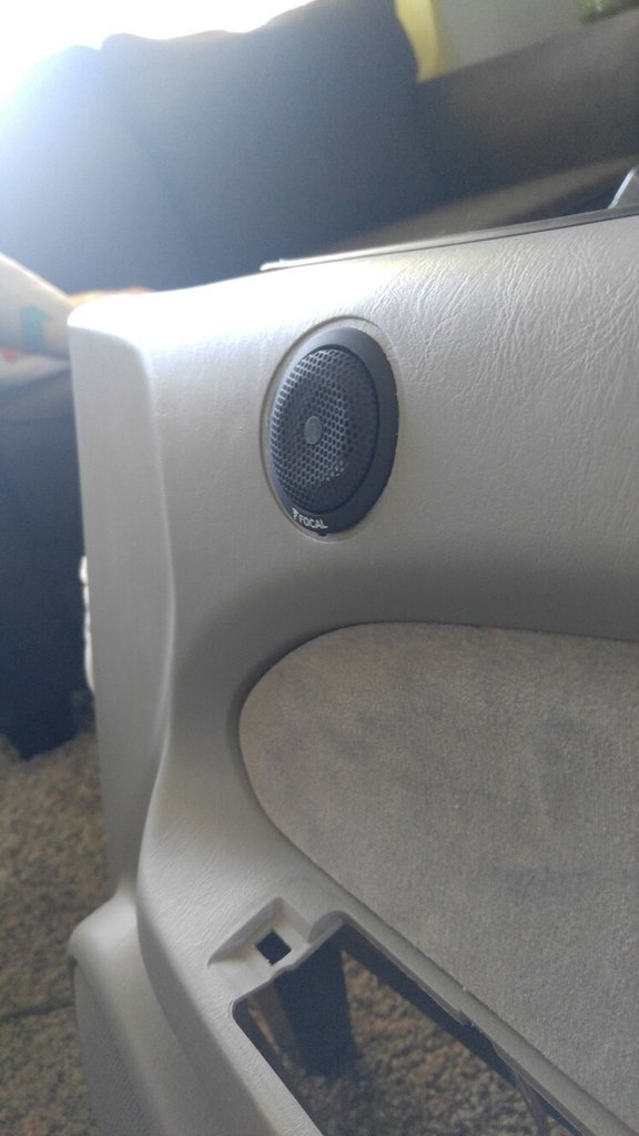

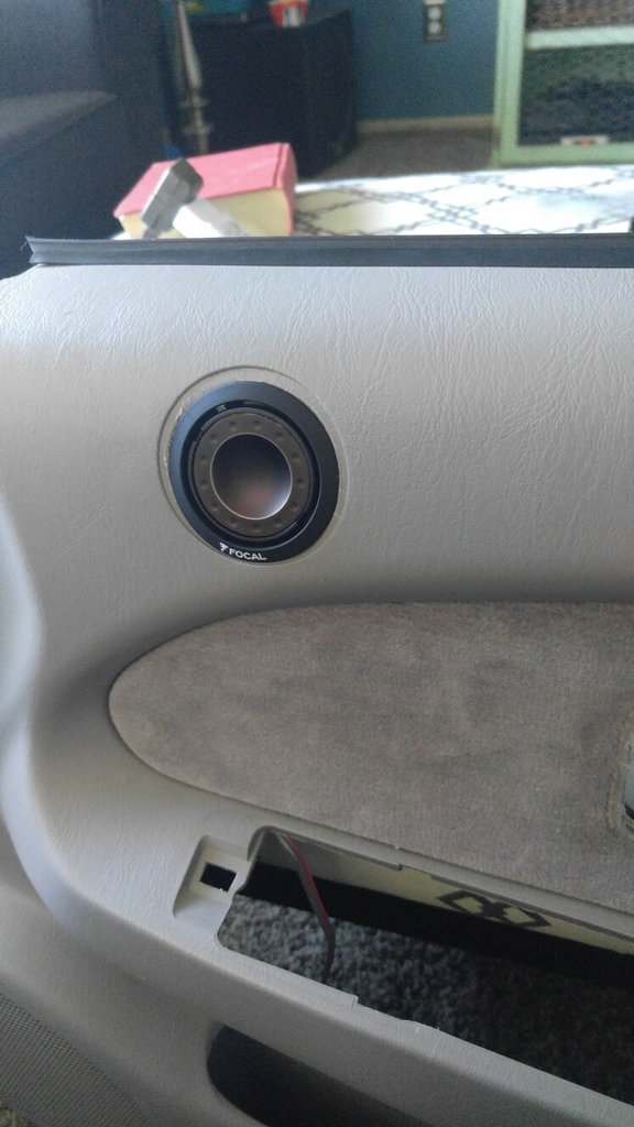

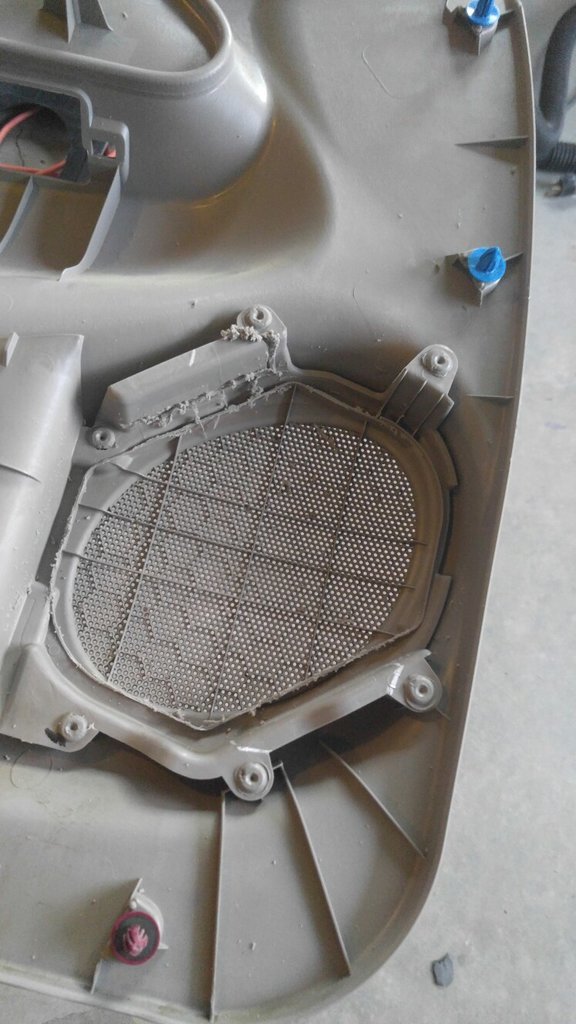

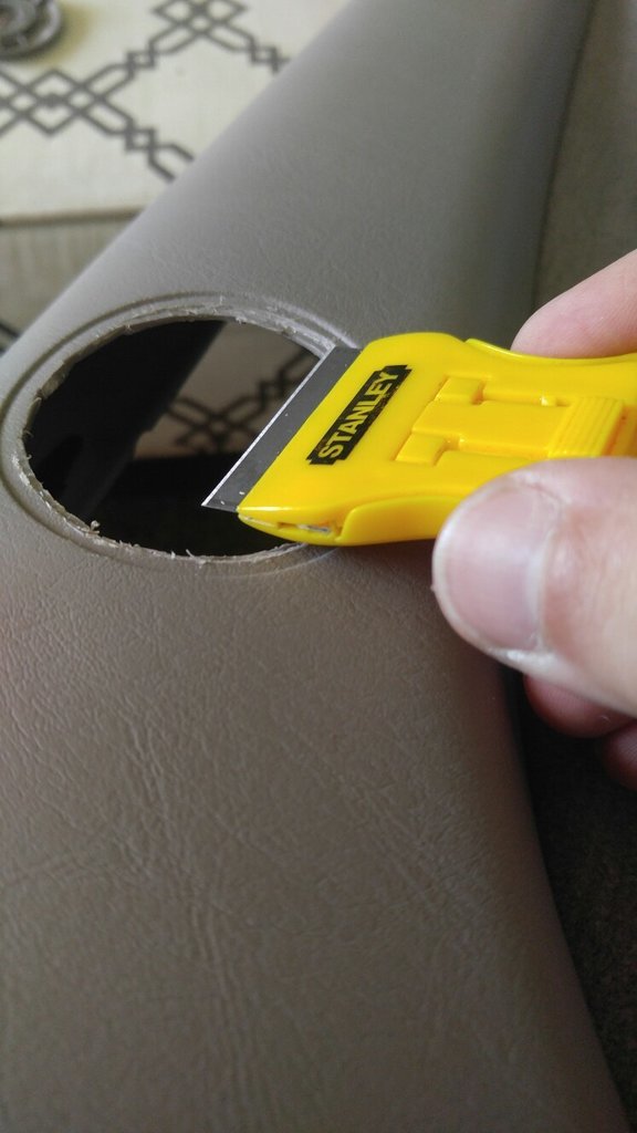

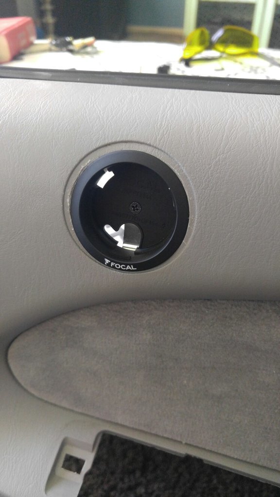

    Tweeters in door panels. I went with replacing the grill with the focal. There was quite a bit of dremeling but it all turned out superb. As you may know, the tweeter location is curved. I took the time to shave the plastic down with a razor so that it would lay flat and slightly pointed up. Turned out really well.
    0821171455-747x1328.jpg 0821171448-747x1328.jpg 0821171456-1328x747.jpg 0821171527-747x1328.jpg 0821171552-747x1328.jpg 0821171609-747x1328.jpg 0821171608-1328x747.jpg

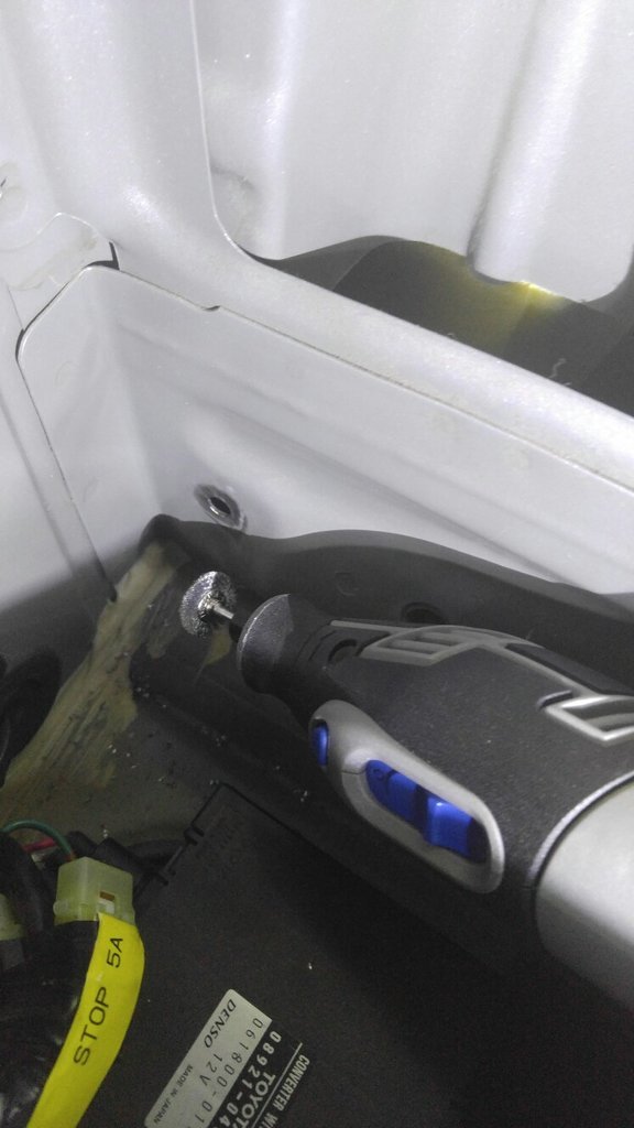

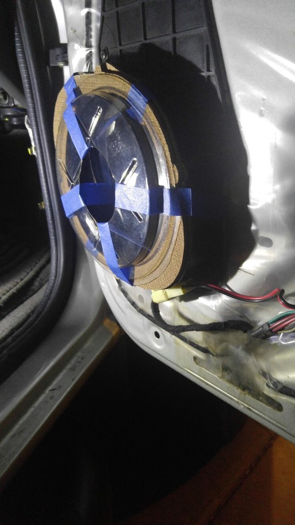

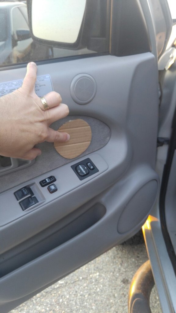

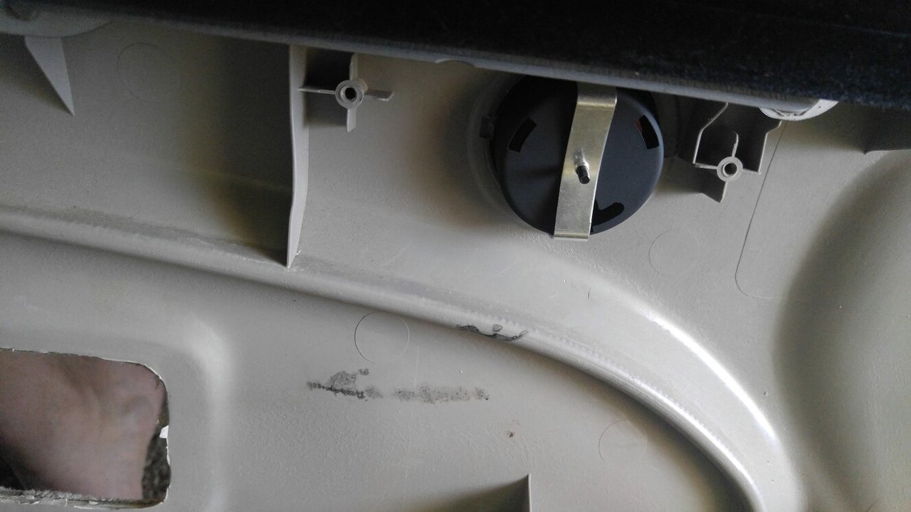

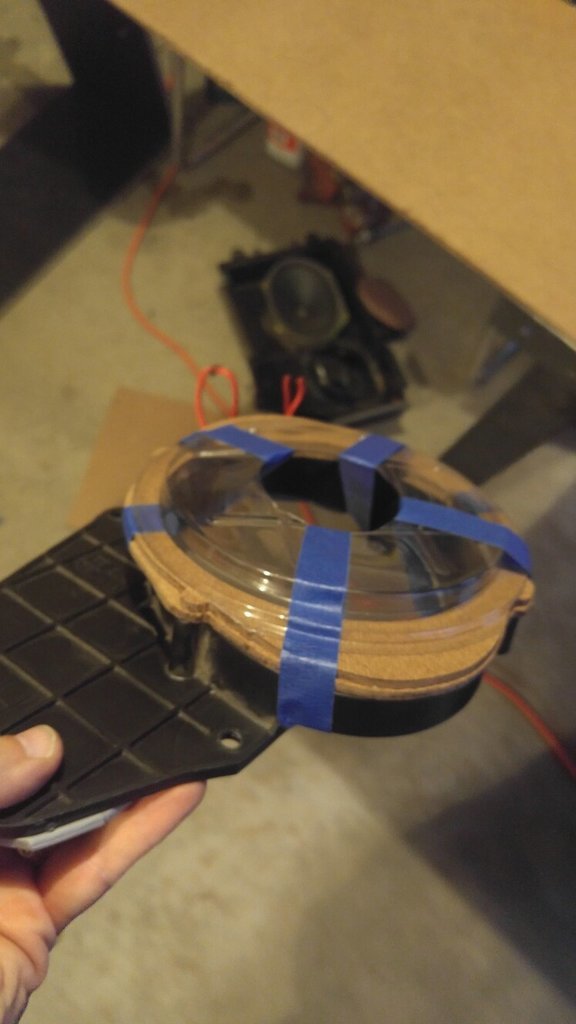

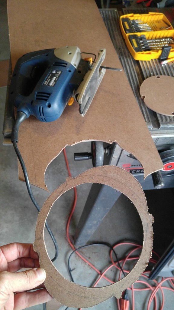

    The woofers in the door had me sweating bullets. The focals were too deep to mount using my junkyard mounting bracket, but by moving them to the center of the 6x9 mounting hole, I got just a bit more clearance. I quick cut a mounting adapter, and then another and at that point the speaker stopped hitting the window track.
    Then I had to cut out all the extra plastic behind the grill. I taped the speaker packaging plastic to the adaptor and then reassembled the door to check that it would hit the speaker. (these speakers are $$)
    It all seems to work great. I will be putting scorpion fast rings on these too.
    0819171922-747x1328.jpg 0820171954-747x1328.jpg 0820172040-747x1328.jpg 0820172044a-747x1328.jpg 0820172048-747x1328.jpg
