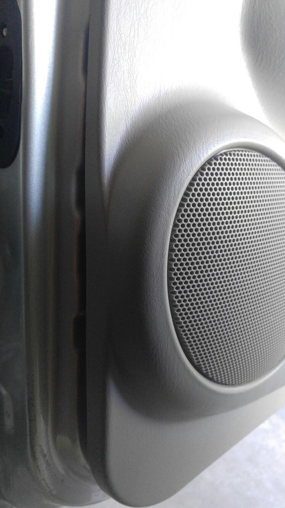

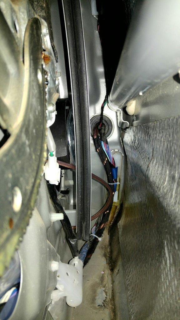

    Thanks man. The thing with everything on this vehicle is that it is so well made, that there isn't a lot of clearance anywhere. Every single thing I've been doing seems like i barely make it fit.
    My picture on the inside grill is prior to all the shaving I did. I got every millimeter that I could. From the back of the magnet to the window rail is about 2mm of clearance. I spent a whole day getting that to fit in mockup.
    Oh yeah, and I did have to cut out just a bit of sheet metal. Nothing too serious. Dremel made it super simple. Just make sure to round off the edges and don't have anything sharp leftover. I sealed it with clear coat.

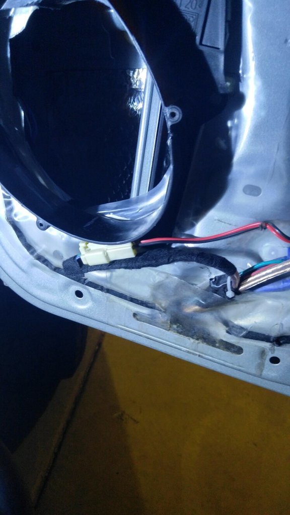

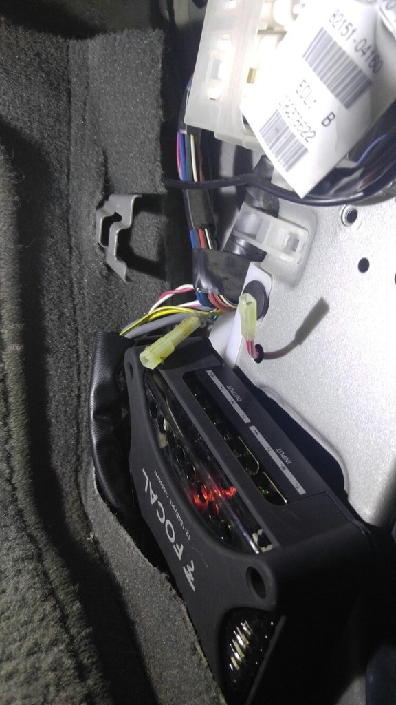

    Got a little bit done tonight.

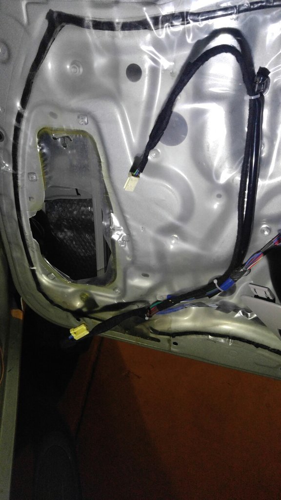

    Here's the final picture of the back of the door grill.

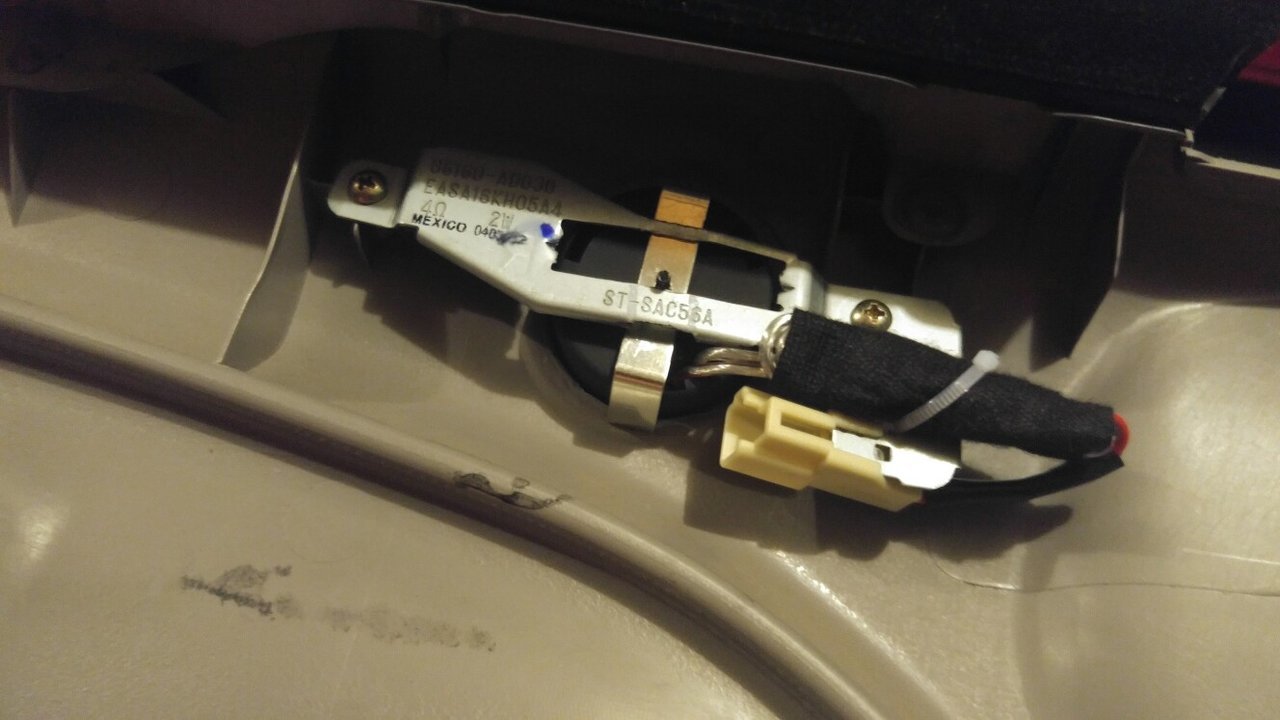

    Back of the tweeter wired and whatnot.

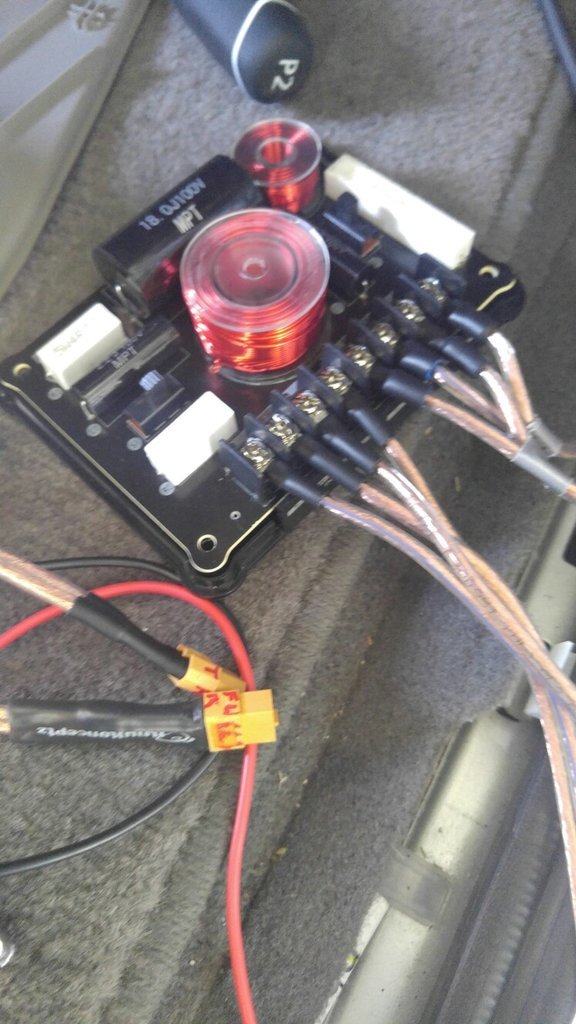

    The Focal crossover is friggen huge. I moved the door dome light switch from the big hole to just a little hole and added a grommet. A small cut to the carpet and I can fit the crossover right in. I'll mount it with industrial Velcro (auto) tomorrow.

    Any reason you are installing passives along with the DSP?
  4. Aug 24, 2017 at 1:01 PM
    #24
    bcole23
    bcole23 [OP] Well-Known Member
    Aug 20, 2017
    #227469
    113
    2004 tacoma TRD
    3.5" lift Stereo
    I was originally going to have a 6 channel amp but didn't have room for it. Then I would have ditched the passive crossover. Then I was just going to do only front speakers, but I got a screaming good deal on the rears, so I decided to go with the passive crossover on the fronts.
    Crossovers only really set high/low pass and slope, built for the particular speaker. The DSP does the same thing, but also allows you (with a good dsp) to set time alignment and custom biquads to really dial everything in. I spoke at length with our towns resident installer and illuminated for him what I'll be missing.
    1. DSP control over front crossover points.
    - Focal makes really good crossovers and I would be setting them the same as they have.
    2. Distinct time alignment
    - yep, I lose this, but time aligninging the fronts as a whole is okay with me. I will bias the TA for higher frequencies.
    3. Bi-amping
    - I'll be sending signal that will be cut off for both speakers at the crossover. Big whoop, I'm not going for SPL but strictly sound quality.
    I definitely know that I could have done better in this bit, but I'm not building a competition system. The extra time and money spent redoing all that would have been a lot for only an incremental increase in SQ.
    With the miniDSP 6x8, I will be able to get a flat frequency response. I did so on the home Bluetooth system I built using it and it sounds friggen amazing. Some more expensive DSPs look nice but don't give you the low level control.

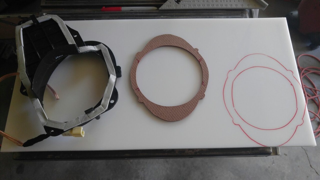

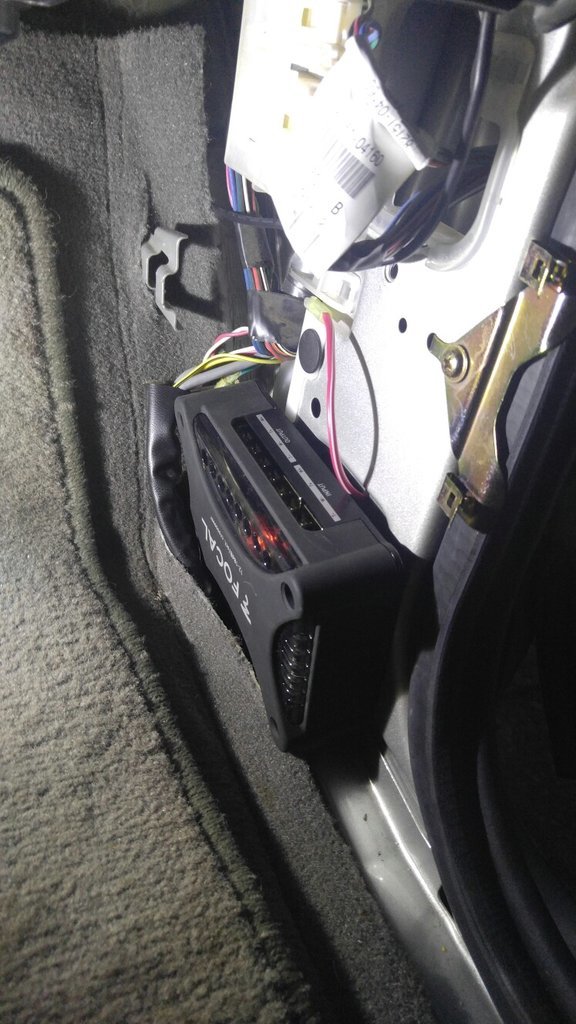

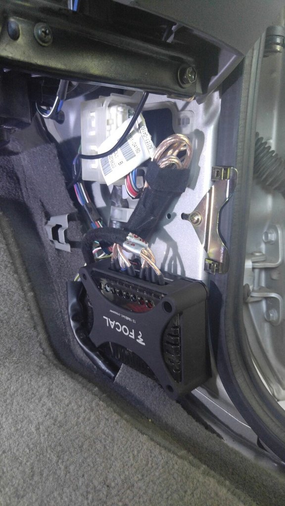

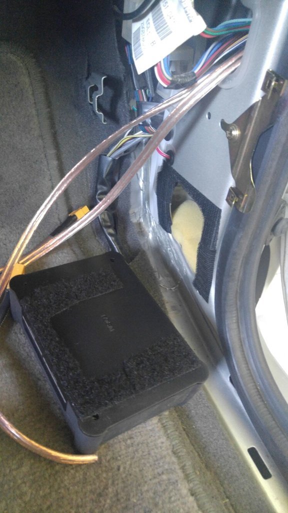

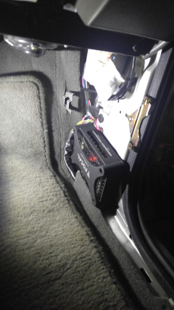

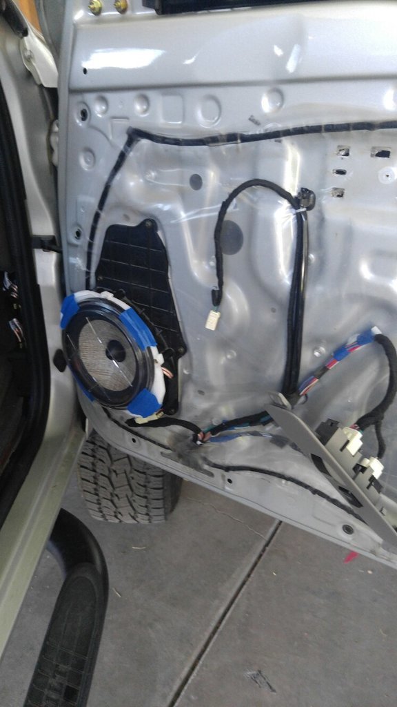

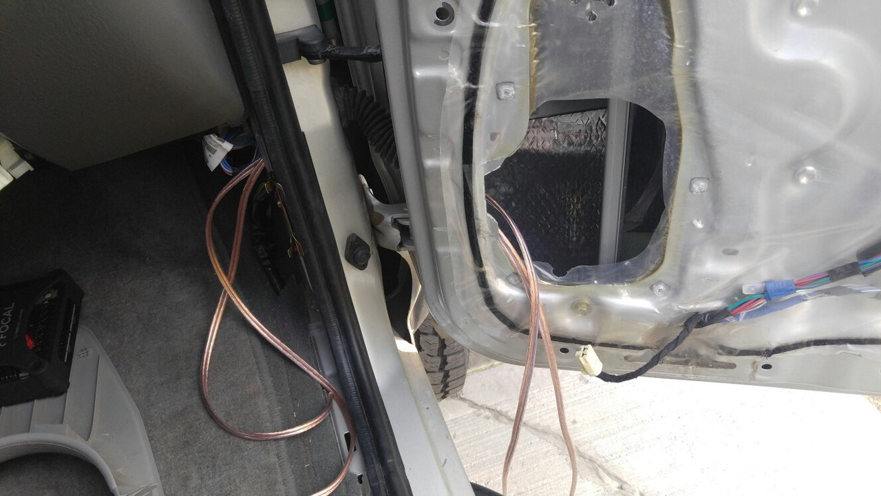

    Back with an update. Right door wired and crossover mounted.

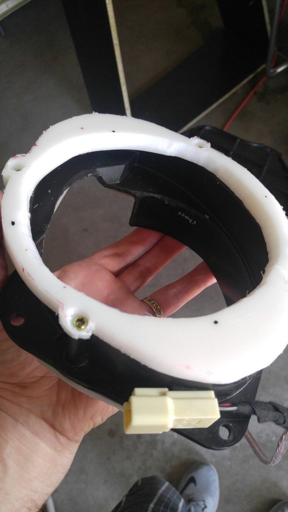

    I spent so many hours doing the spacer/adapter... If I had a router table and flush trim bit it would have taken 15 minutes... Oh well.

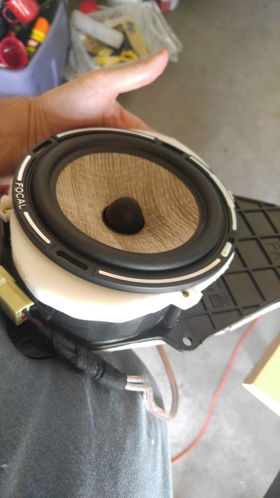

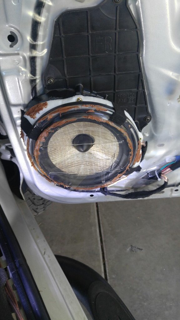

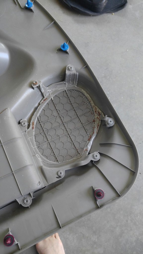

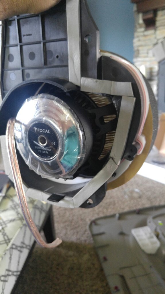

    Well, been working all day on this speaker in the door. I have 3.75 mm clearance from back of speaker to window track. So that's pretty good. However, it's still hitting the grill. I'm using the plastic speaker cover to gauge clearance as I could probably get it installed, but then it would hit the grill with too much excursion. I used nutella to identify where it's hitting on the back of the grill. I have some more that I can take off but not much.

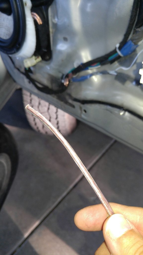

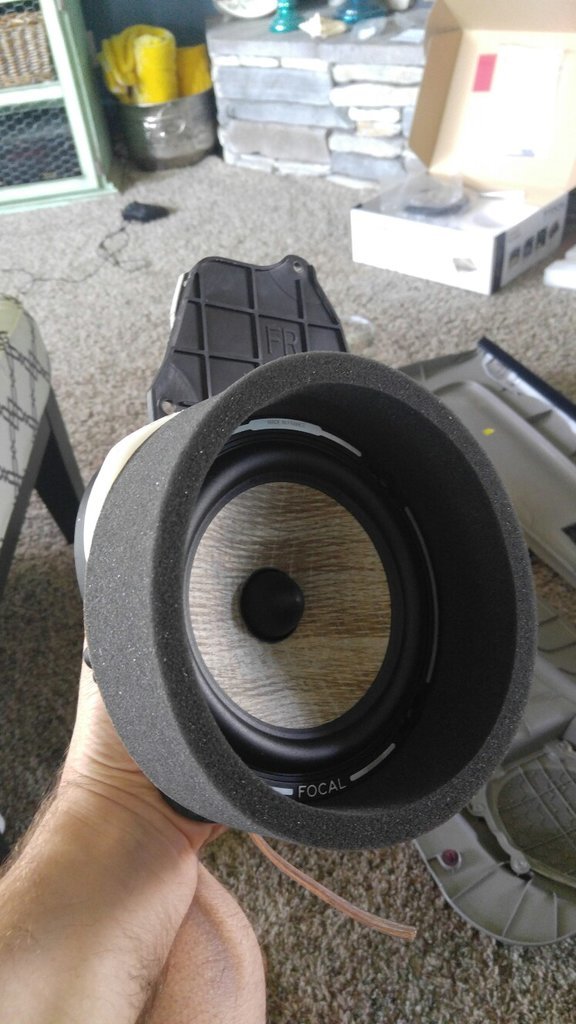

    I reached back with a bit of spare speaker wire and ran it behind the speaker btw, that's how I got the 3.75mm clearance value.

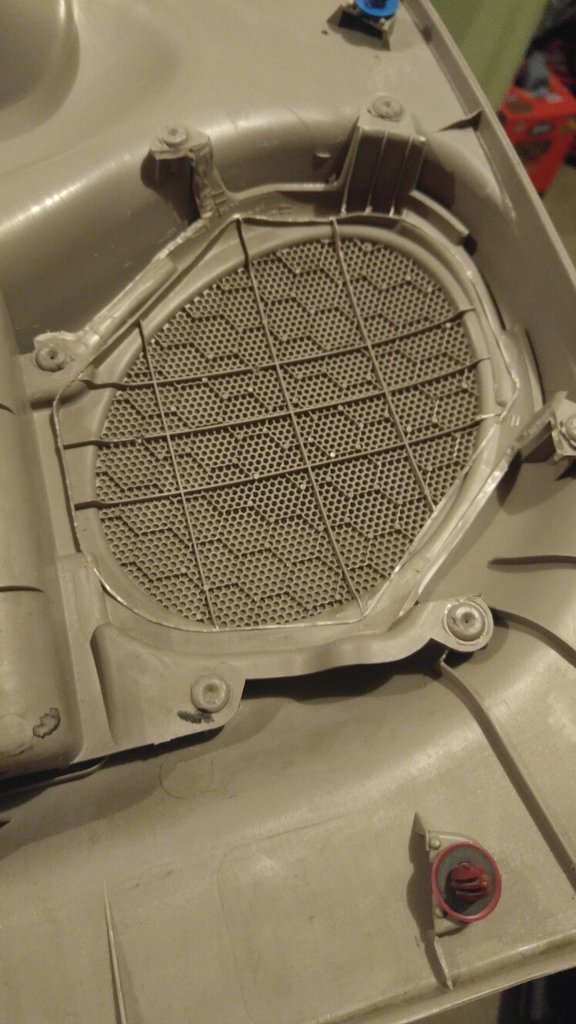

    Here's where I'm at with the grill back. I've been shaving away...
    I didn't put nutella on the speaker btw, just the plastic cover. ;)

    After two days of trimming, this thing is finally mounted, well, at least fit. I know that it won't hit on excursion and it doesn't hit the window rail. I have 2mm from back of magnet to window rail, and about 2-3mm from max excursion to grill. Talk about a tight fit, holy carp.
