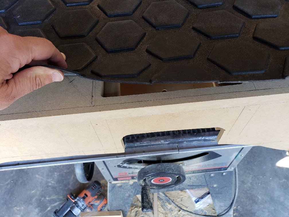

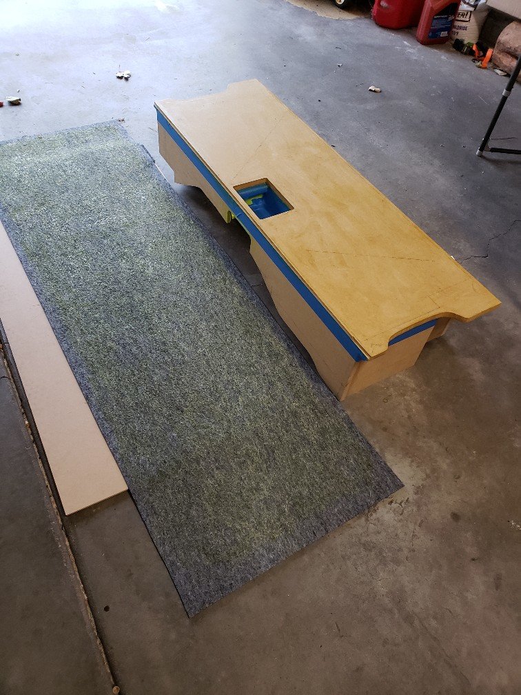

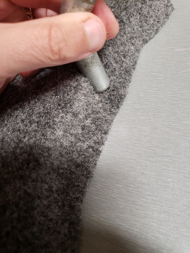

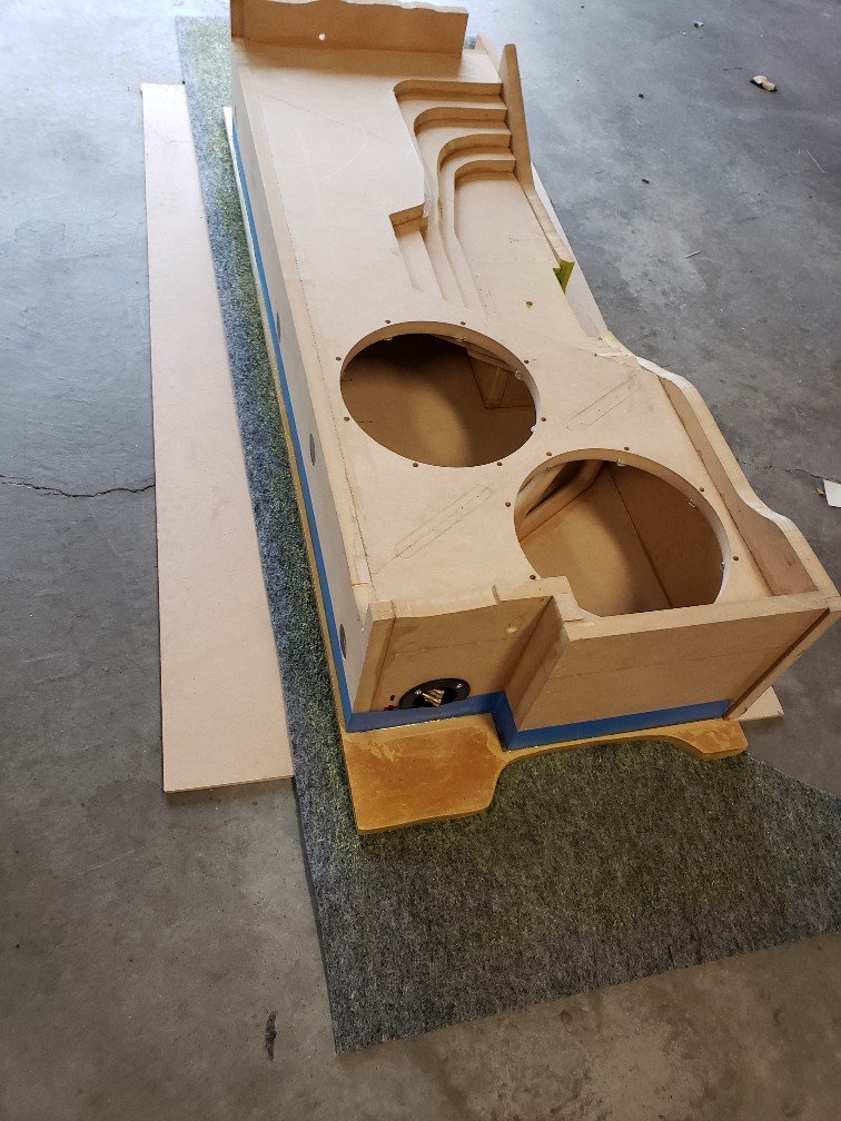

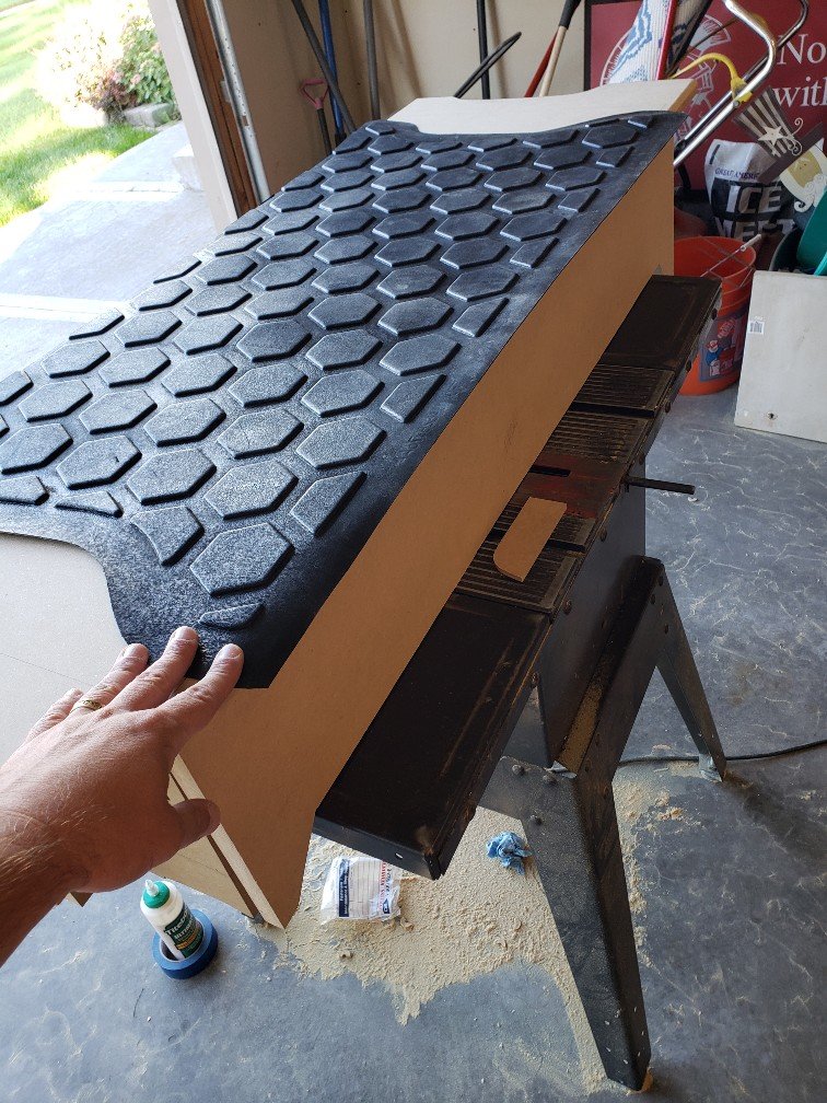

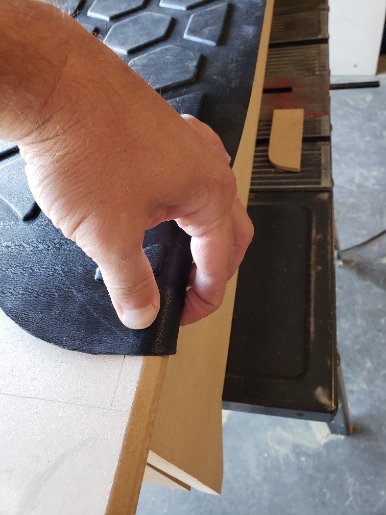

    I tried the thing with the mat. I dont think it will work. A different pattern may have been better. I think that I will just carpet the top. I could technically just staple this down on top of the carpet and that may work...

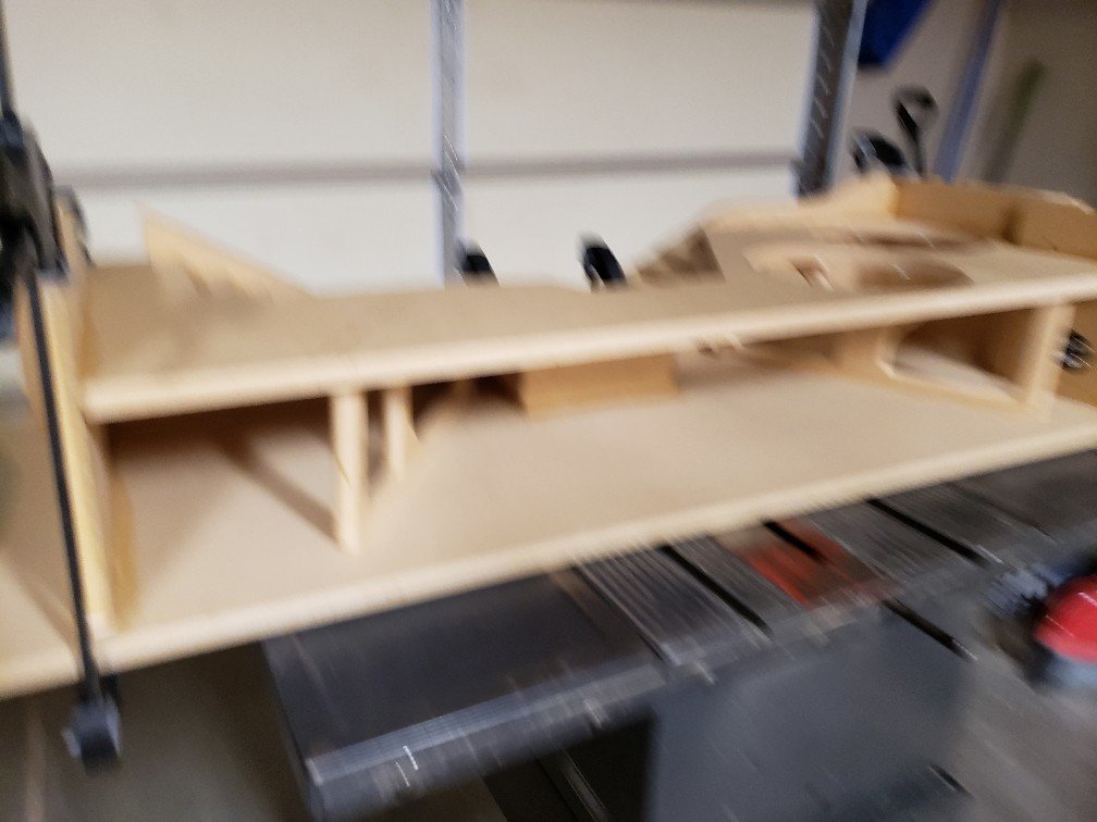

    I did finally get the top put on. Now I just need to prep the front for magnets. I'm just going to get some metal strips and do some dados to mount them flush. Then I will have a much easier time getting the front panel right.

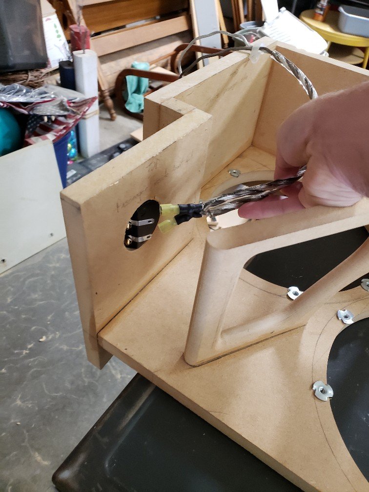

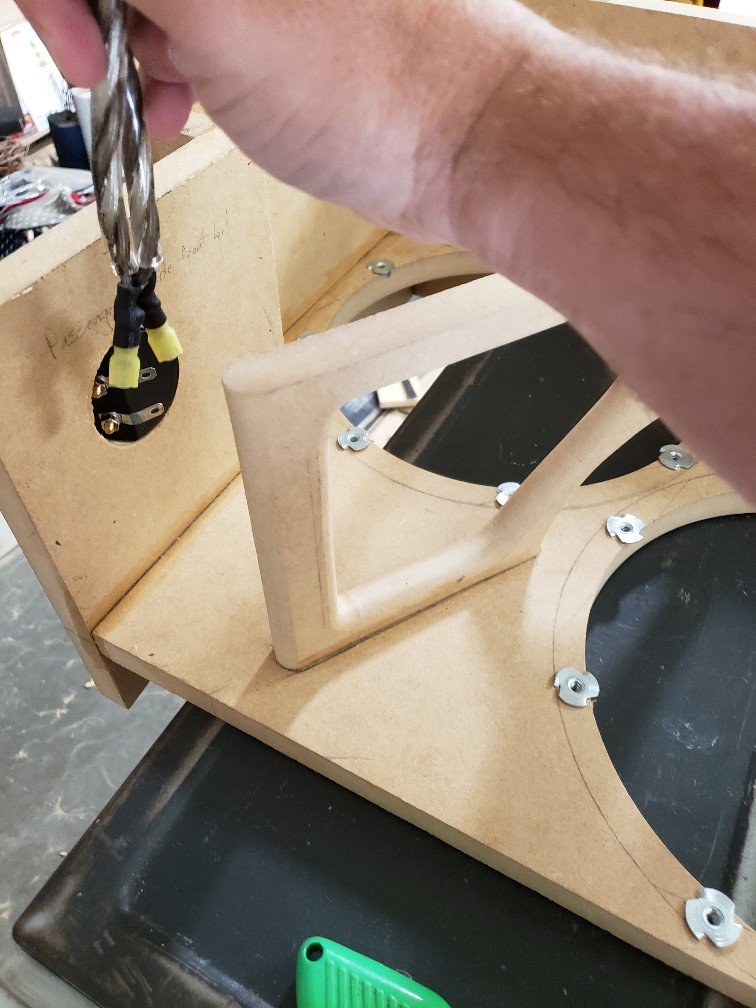

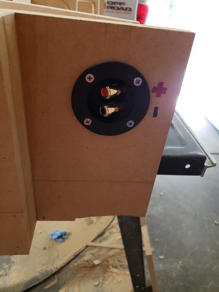

    I rotated the terminal cup 90 deg so the wires wouldn't be hitting the top of the box and potentially make noise. I got the wires cut to length and prepped.
    Note that because of the rotation when the box is in there, you cant see which one is + and -, so I put them on there in marker.
    Boy do I realize that I'm super slow at all this. I'm basically a newbie trying to do an advanced install so it takes a while. I could never work in an audio shop.

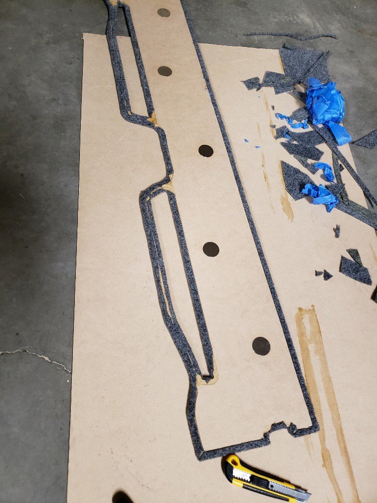

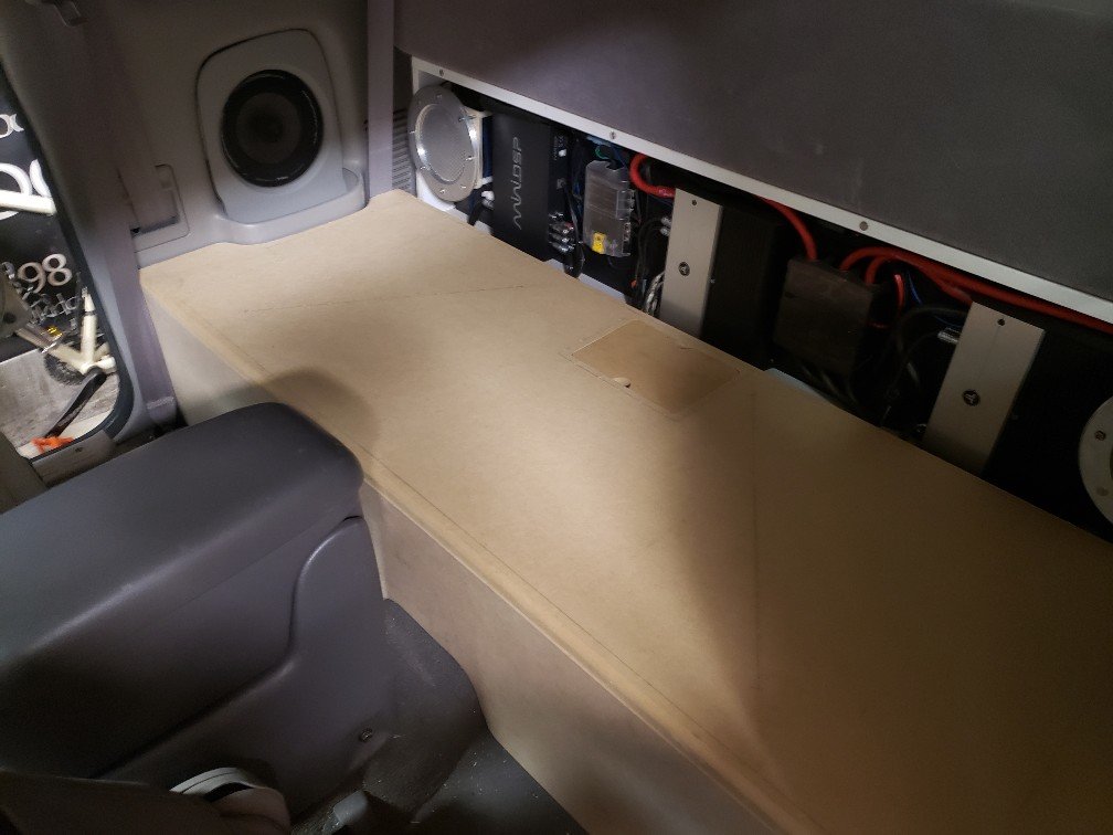

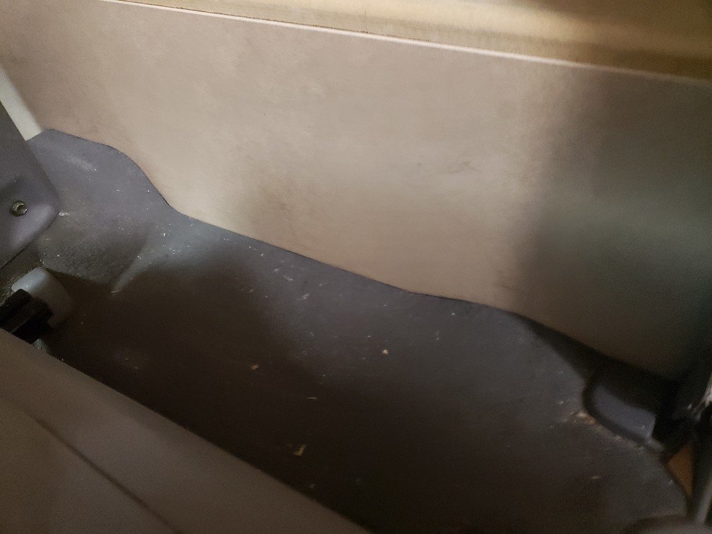

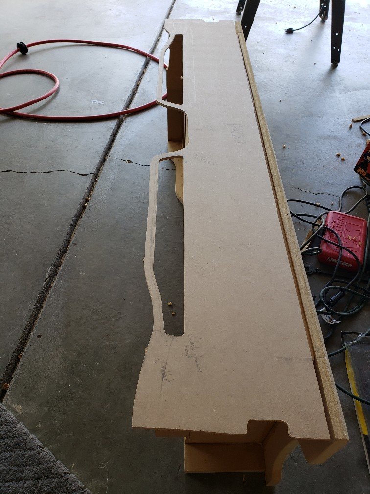

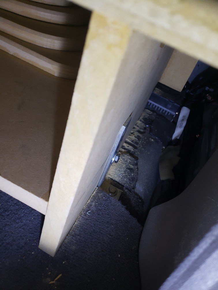

    Put almost finished box back in truck cuz I needed to get the measurements for the front panel. It takes some work to get it in the and I will have to be super careful with the subs for the install. All three mounting bolt locations were perfect though so it will be in there tight even in case of a rollover. SAFETY FIRST!
    I got the front beauty panel contour almost exactly perfect on the first try. A little adjusting and another 3/16" off for wrapping, some holes and rabbeting and it's ready for carpet! The end is nigh!
    20190923_194401-756x1008.jpg 20190923_194354-1008x756.jpg 20190923_194343-756x1008.jpg 20190923_211755-1008x756.jpg 20190923_211750-1008x756.jpg

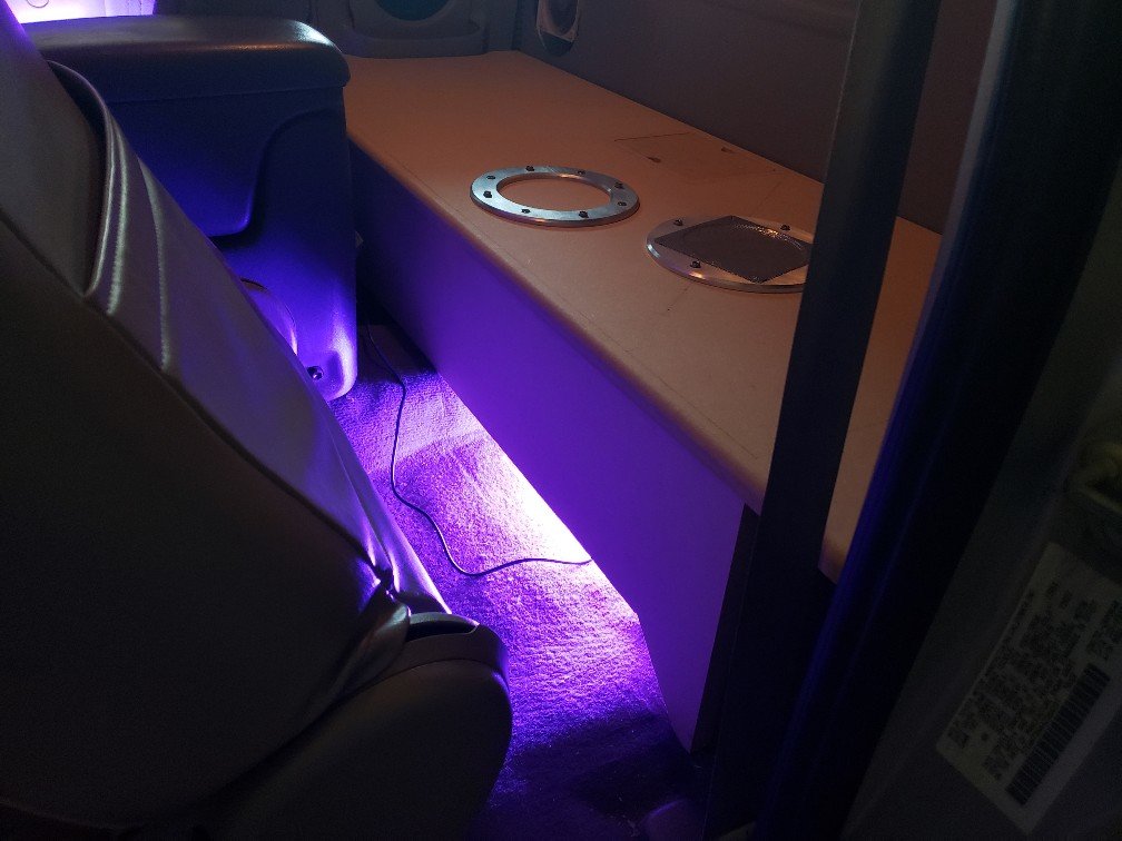

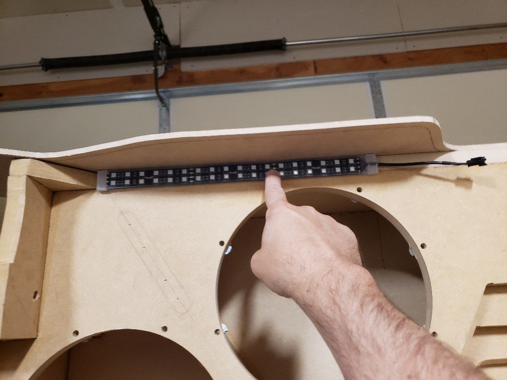

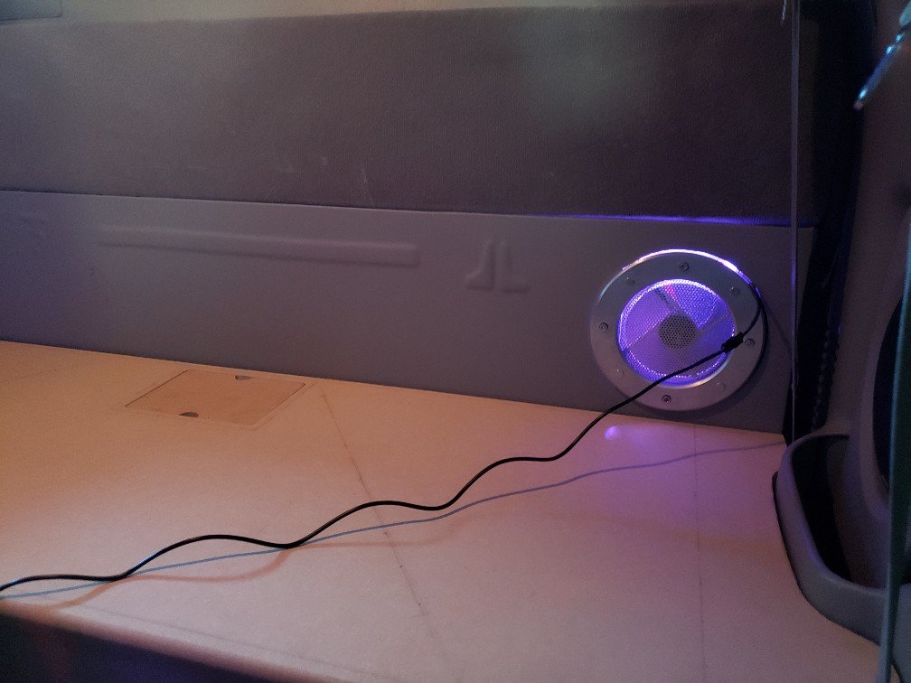

    LEDs acquired. Definitely behind fans and under box is way to go. Under dash would be annoying.

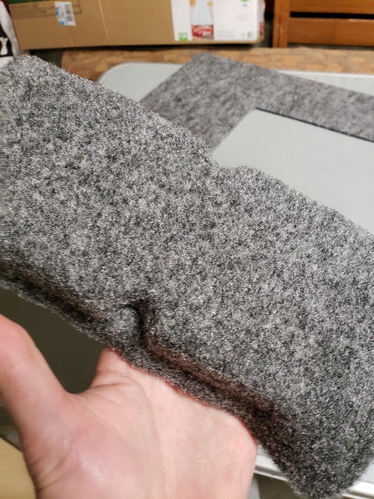

    Also chose the carpet from local car upholstery shop. Its thicker than the stuff you get at local audio shop and will be good. Going with the Ash one
    This kit also has ability to hook into door light which turns them on white when you open the door. I should probably take the time to wire that up.

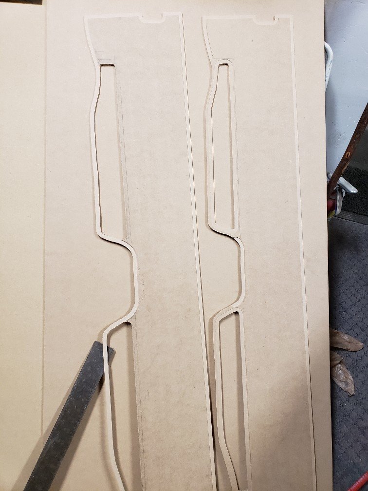

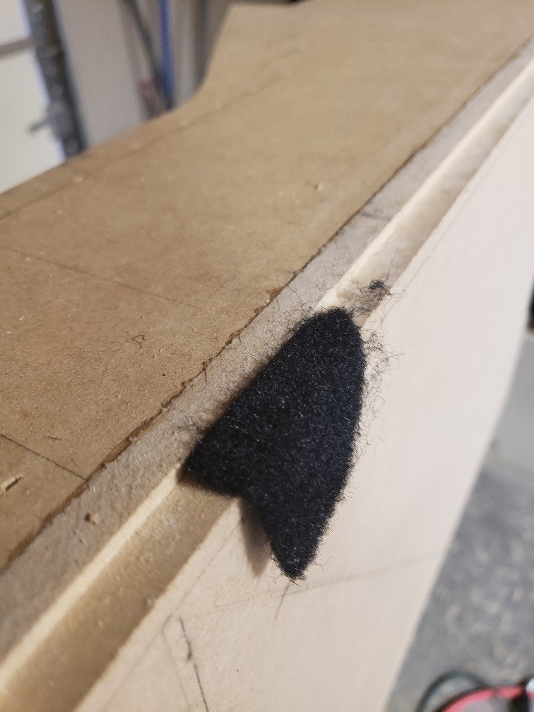

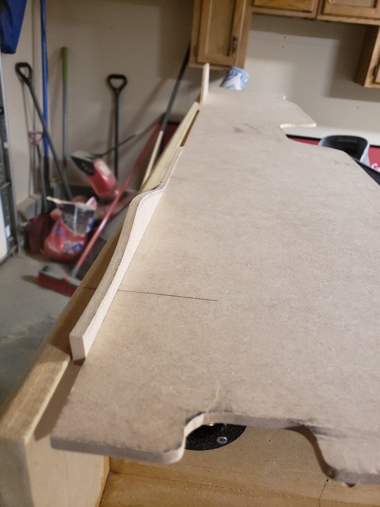

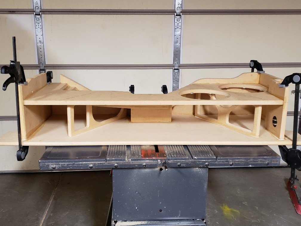

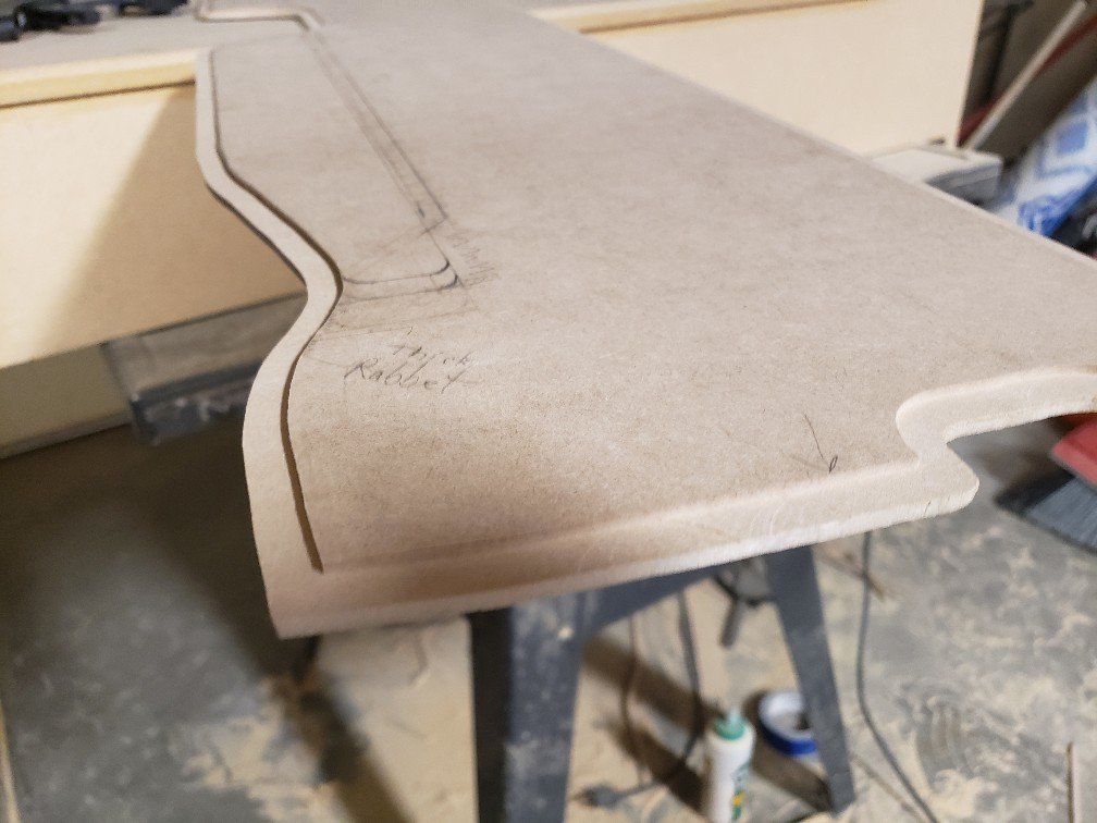

    Just some prep work for carpeting by doing a rabbet on the back of the top piece. Also some work on the beauty panel. I took off the angles off the front of the box by the bottom to get as much air flow from the bottom as possible.
    20190925_214624-756x1008.jpg 20190925_214612-756x1008.jpg 20190925_215559-756x1008.jpg 20190925_231929-1008x756.jpg
    I also cleaned up the bottom using the flush trim bit cuz that's where I'm mounting the LEDs.

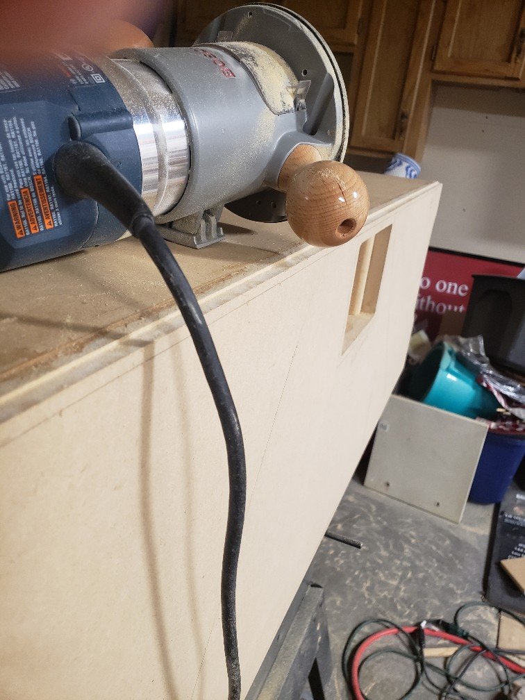

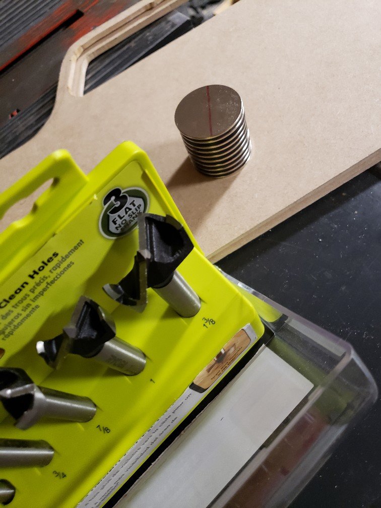

    Got my 1.5" x 1/16" magnets today.
    https://www.amazon.com/gp/aw/d/B000W8O7P4?psc=1&ref=ppx_pop_mob_b_asin_image
    And then realized that my forstner bits only go up to 1-3/8".

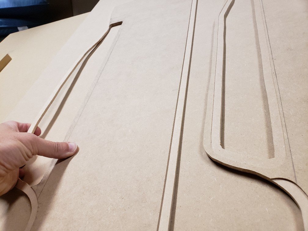

    I did a rabbet around my entire outer edge of the beauty panel. Once I cut out the hole, it was obvious that I screwed up. The bottom bit was really not strong enough.
    So I had thought originally that I was gonna screw up the edge, so I had another piece all ready to go and just transferred the pattern over and redid it.
    I next was going to tackle how to mark out exactly where on the front of the box and the beauty panel to mount the magnets. Then it hit me. I have an exact replica of the final beauty panel that I can drill through! So I can just stick it to the box, and drill through it slightly into the main box and then just transfer the hole locations to the final beauty panel. Easy peasy.

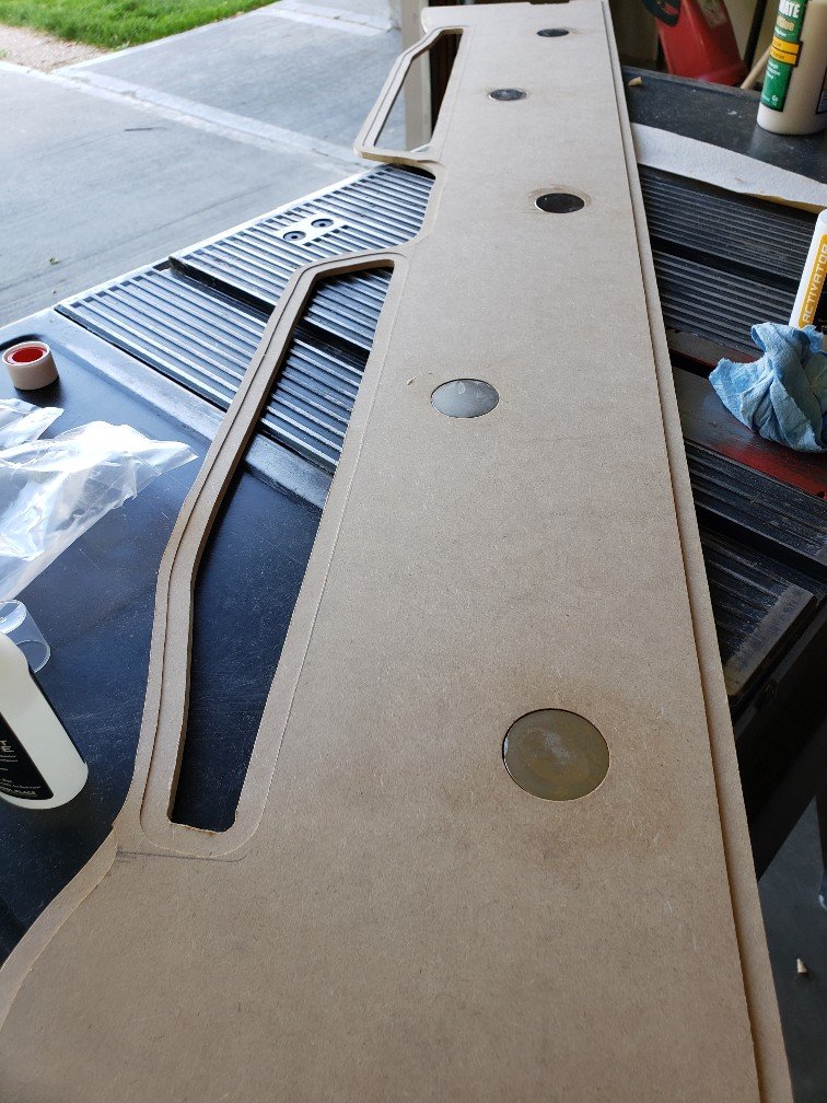

    Magnets mounted and drying. Almost mounted the wrong way of course.. but caught myself.
    20190927_140346-756x1008.jpg 20190927_142829-756x1008.jpg 20190927_142831-756x1008.jpg

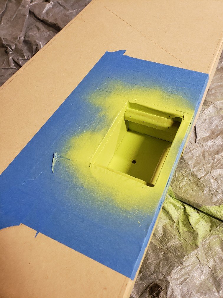

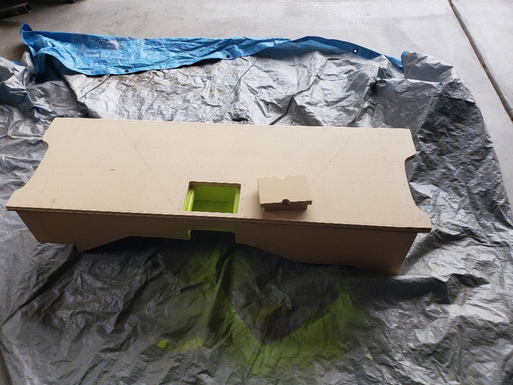

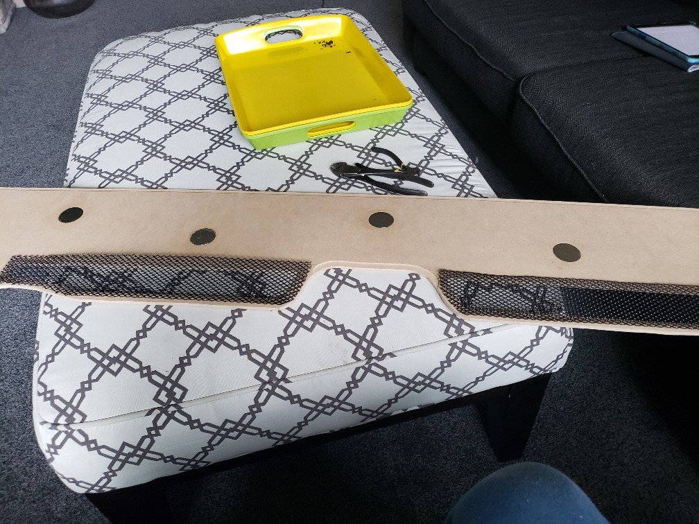

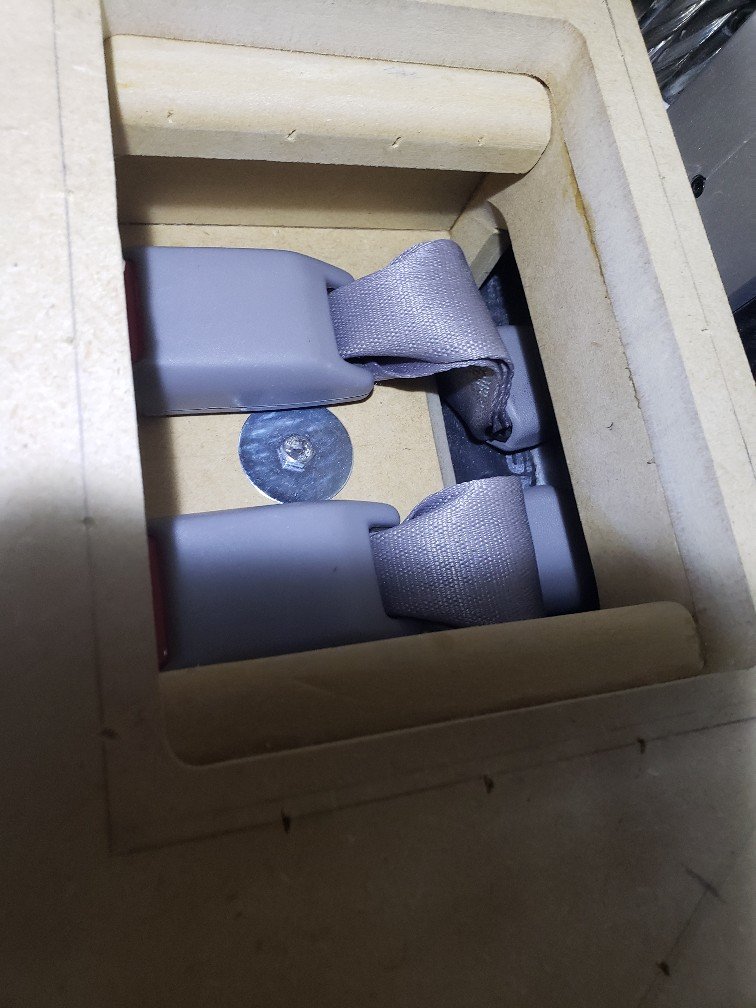

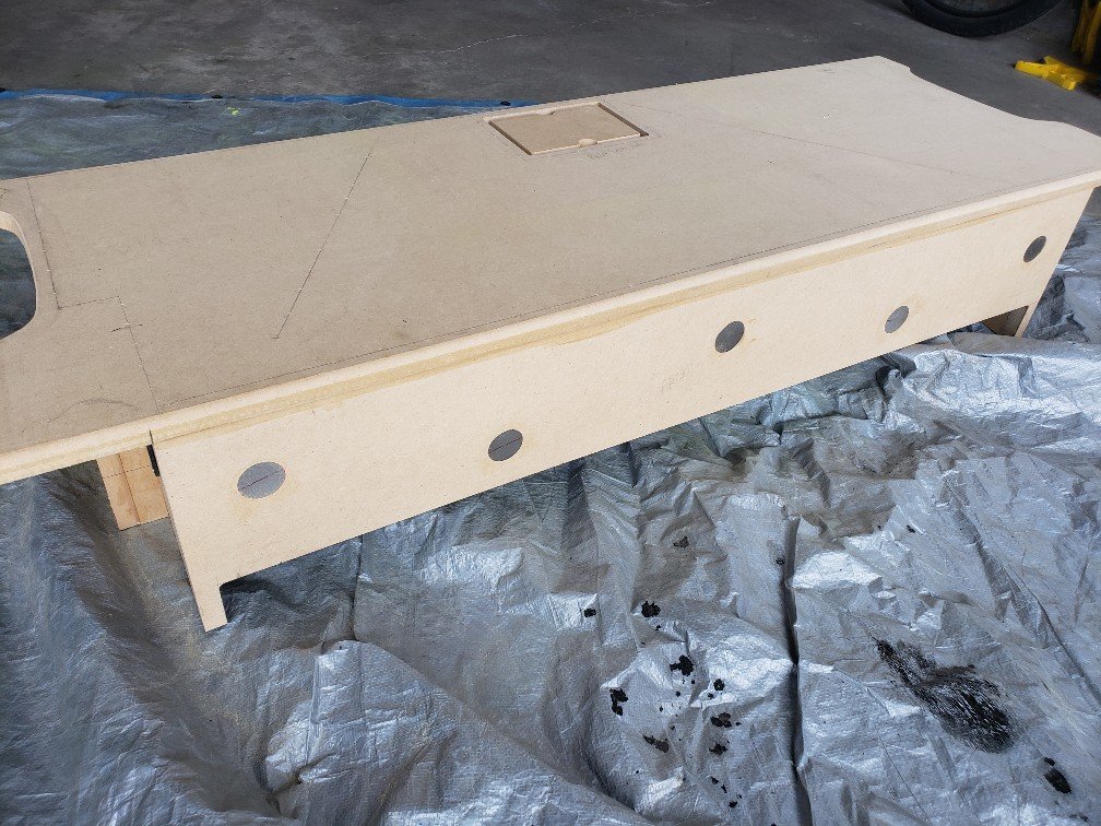

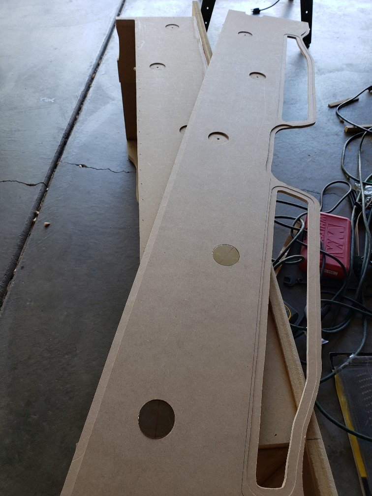

    Holy crap, I'm almost completely done fabricating stuff. It's hard to believe. All the wood working is completely done. I remade the seatbelt cover as it was too perfect. It needed more clearance for carpet.
    I was going to paint the inside of the seatbelt area orange, but didnt have that color, so I went with green.
    Tomorrow, I'll do some more coats and cut out the grills. I wont put them on til after the carpet is done which is a week out.
    I can wire up the LEDs this weekend too. Soooooo close I can taste it.

    Grills cut out. Cant attach em until carpet is done. Painting is done. Now to wait for carpet.

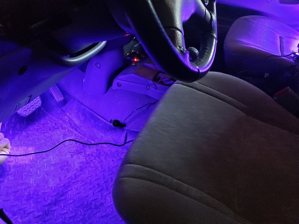

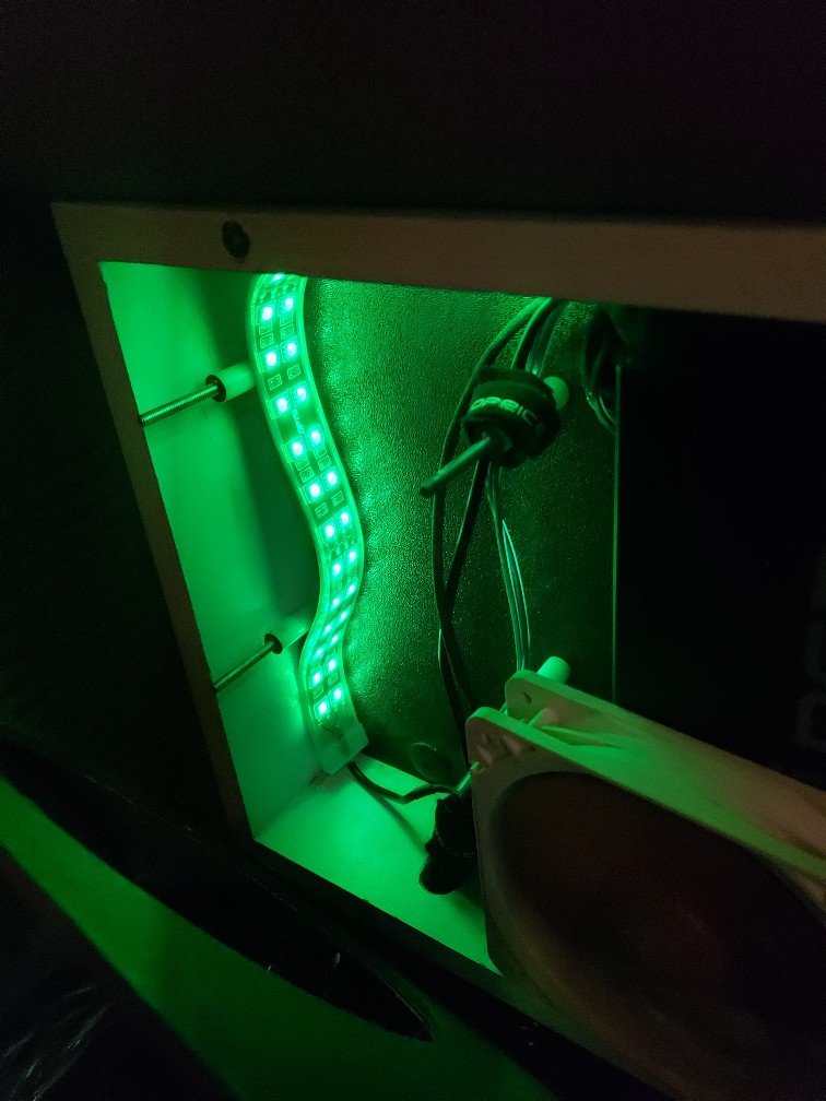

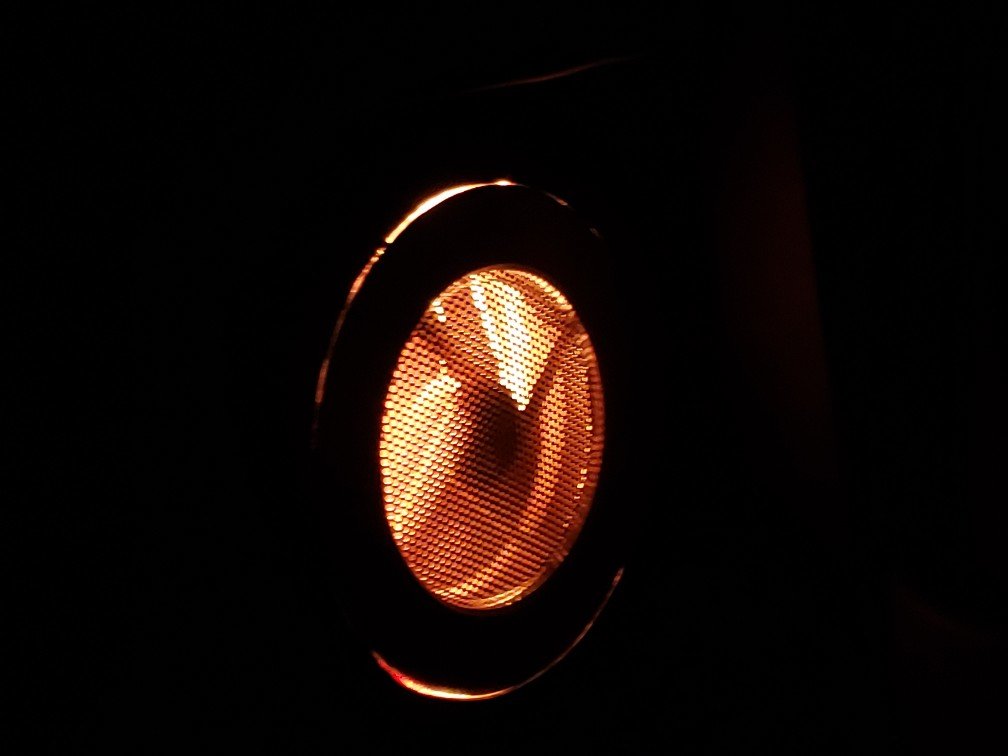

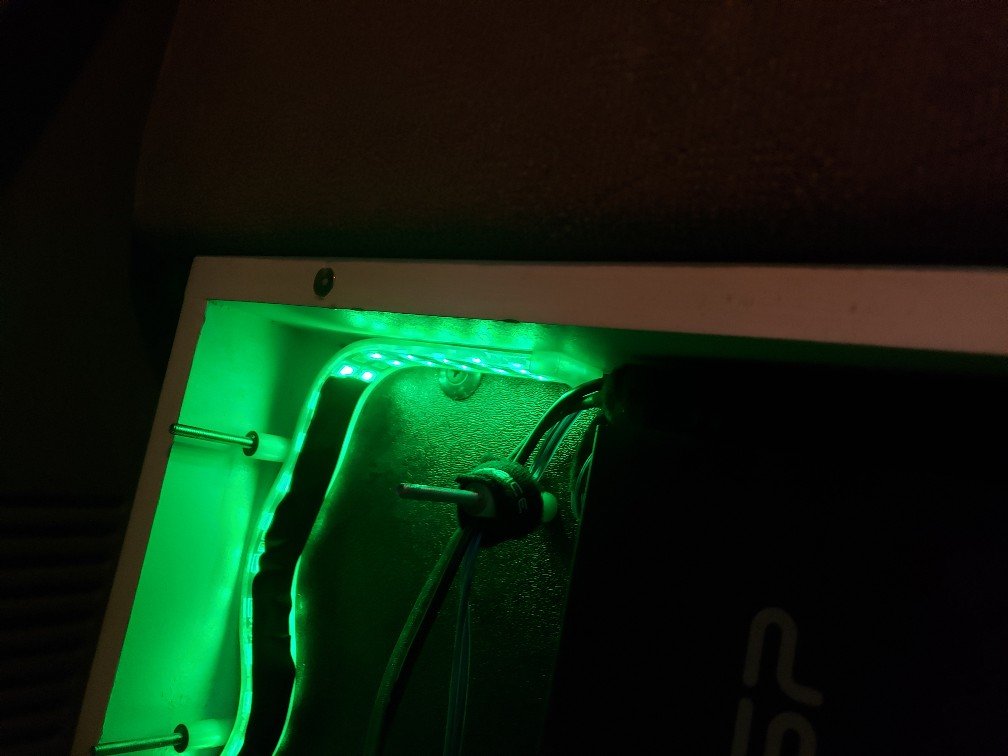

    Got LEDs installed in amp rack. You could see the blaring light of them through it rather than diffuse ambient light, so I ran some electrical tape down the middle of them to attenuate the effect. Looks pretty good.

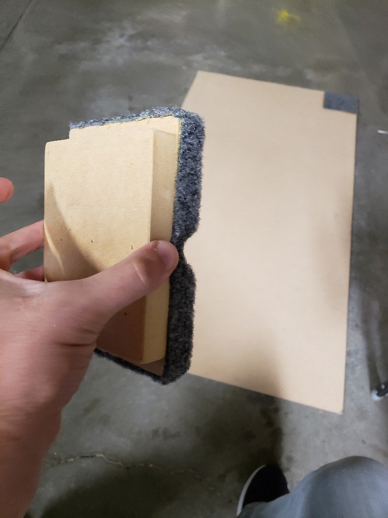

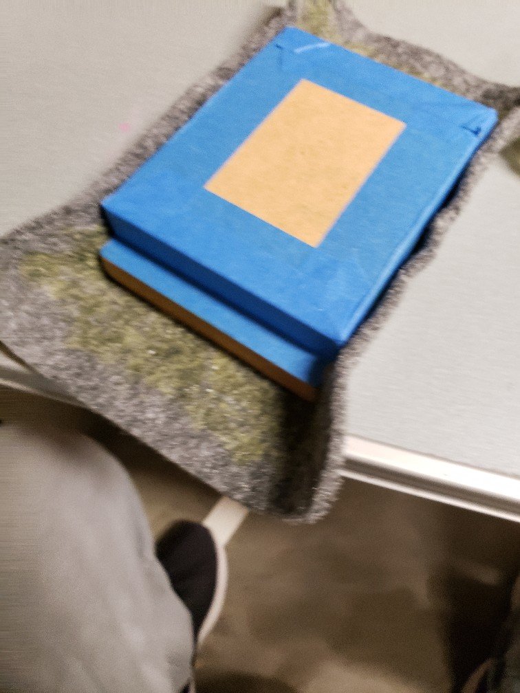

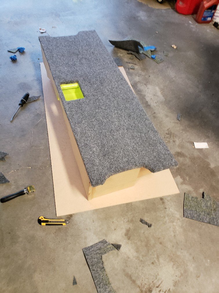

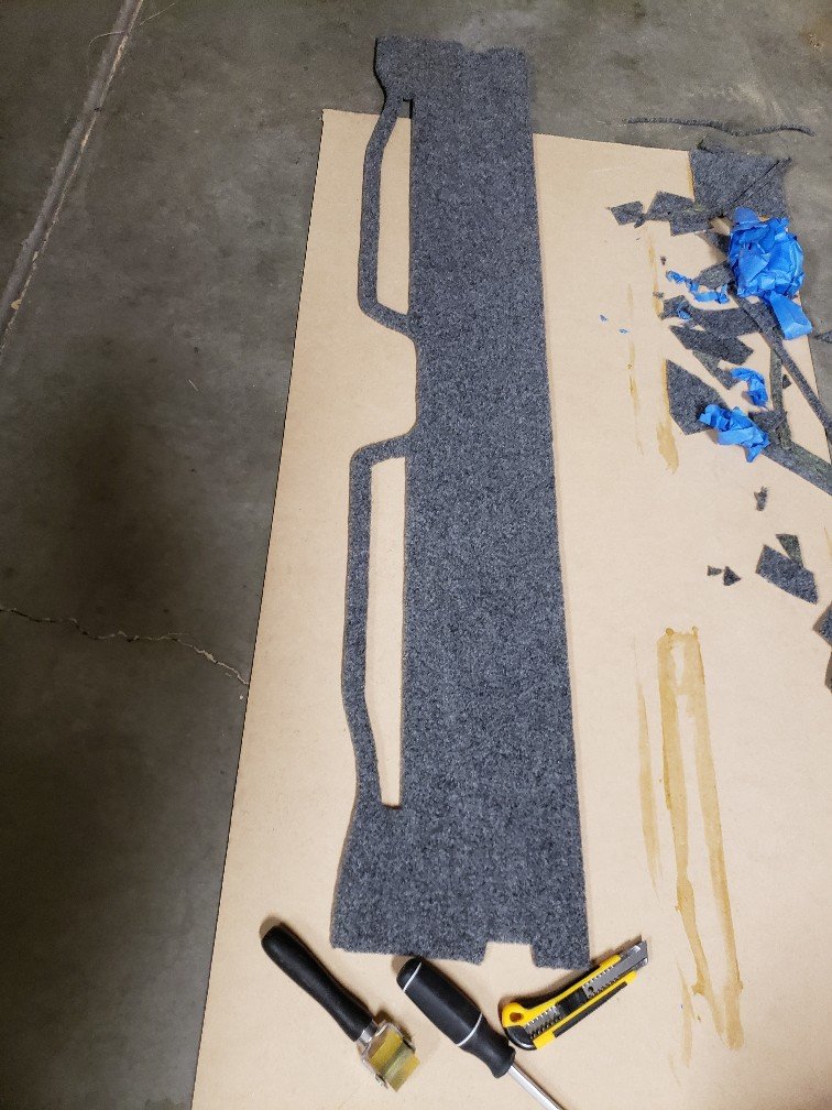

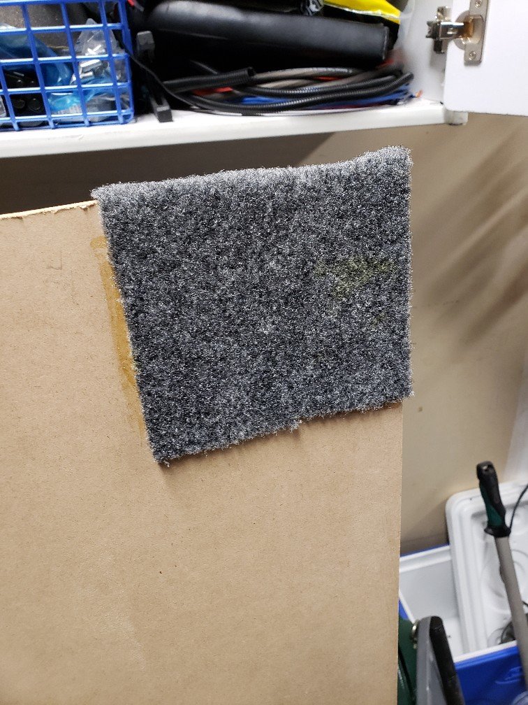

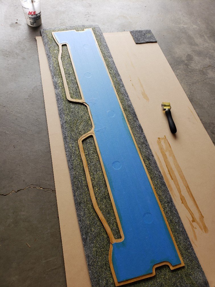

    Getting the carpeting done. Was gonna just have the upholstery shop do it, but they wanted $130 in labor and really, it's not that hard.
    This is real automotive carpet and not the stuff you normally see on boxes. It is super nice.
    This was my test. I'm also going to use this as figuring out mounting the grills.
    20191004_145438-756x1008.jpg 20191004_145434-756x1008.jpg 20191004_145447-756x1008.jpg 20191004_150653-756x1008.jpg 20191004_153758-756x1008.jpg

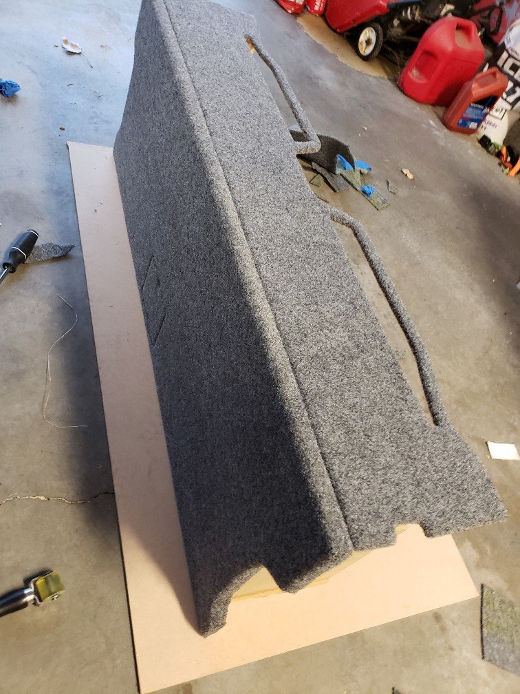

    Booyah!
    20191004_161919-756x1008.jpg 20191004_161931-756x1008.jpg 20191004_171357-756x1008.jpg 20191004_172649-756x1008.jpg 20191004_181406-756x1008.jpg 20191004_181512-756x1008.jpg

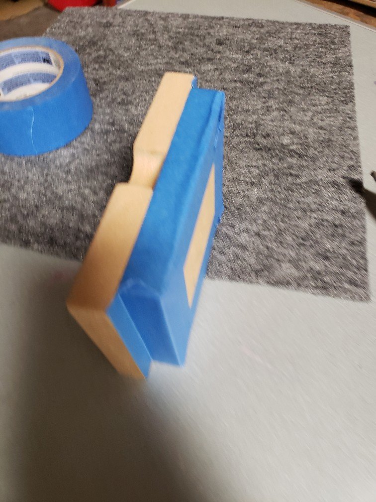

    What's with the blue tape??
  20. Oct 4, 2019 at 6:12 PM
    #120
    bcole23
    bcole23 [OP] Well-Known Member
    Aug 20, 2017
    #227469
    113
    2004 tacoma TRD
    3.5" lift Stereo
    That was just to keep the glue from going where I didnt want it. Made it easy to carpet. I removed it after.
