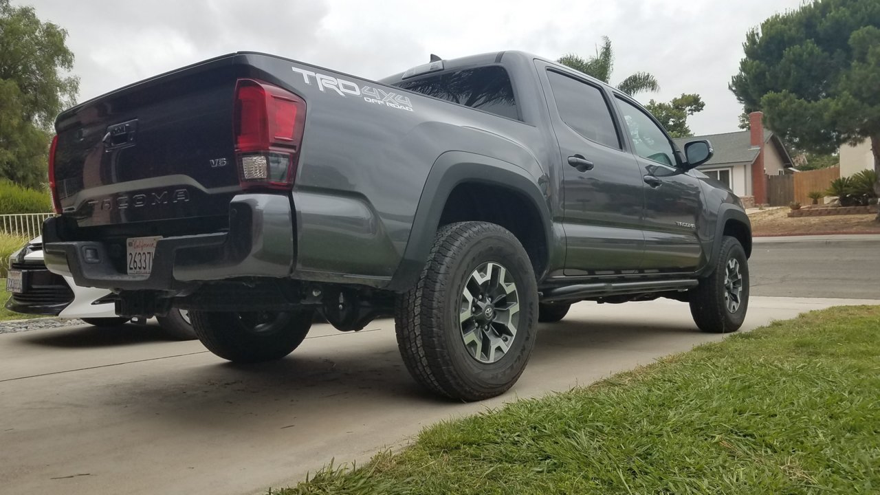

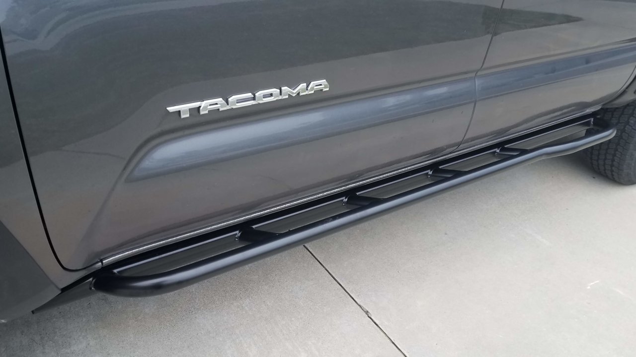

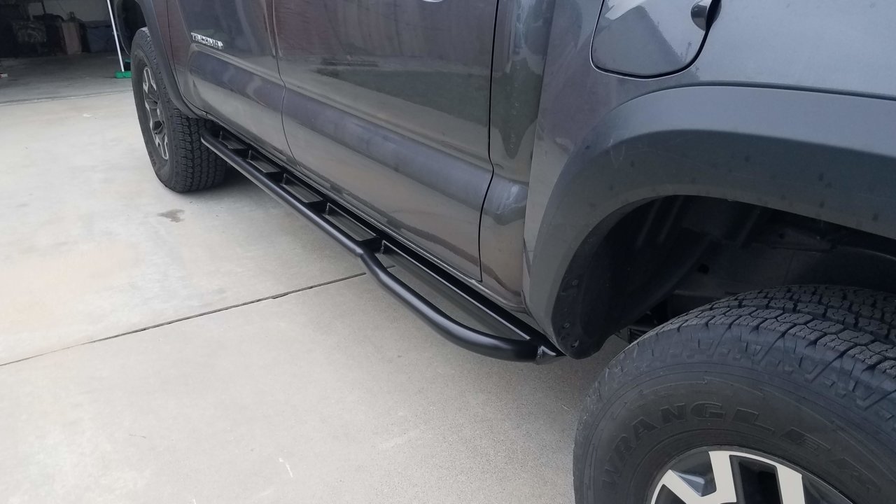

    First thing I did was order some white Knuckle off road sliders. 20200126_155356.jpg 20200126_155407.jpg 20200126_155346.jpg

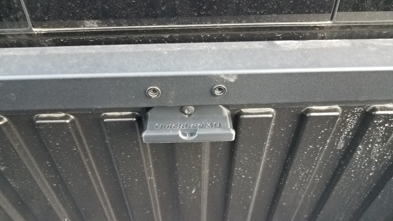

    Bakflip MX4

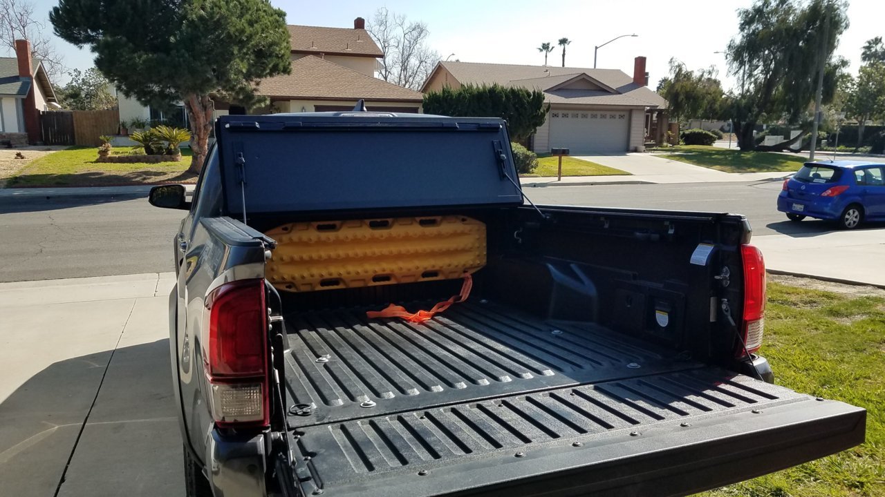

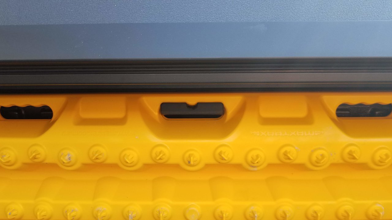

    Maxtrax mount
    20200204_170846.jpg 20200204_171028.jpg 20200208_124000.jpg20200208_130016.jpg

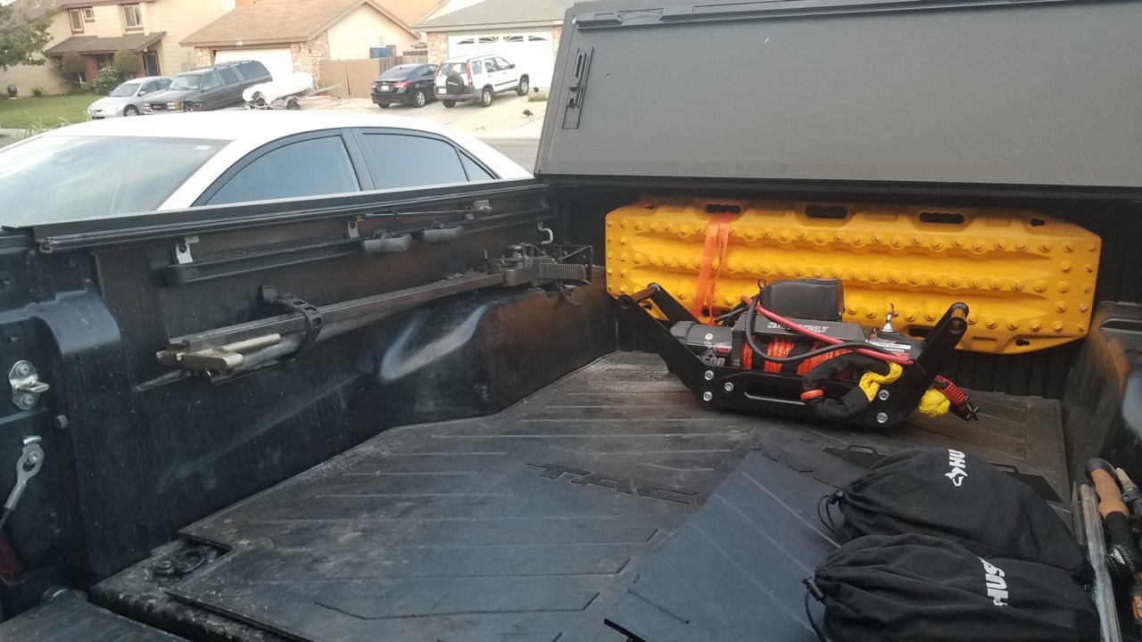

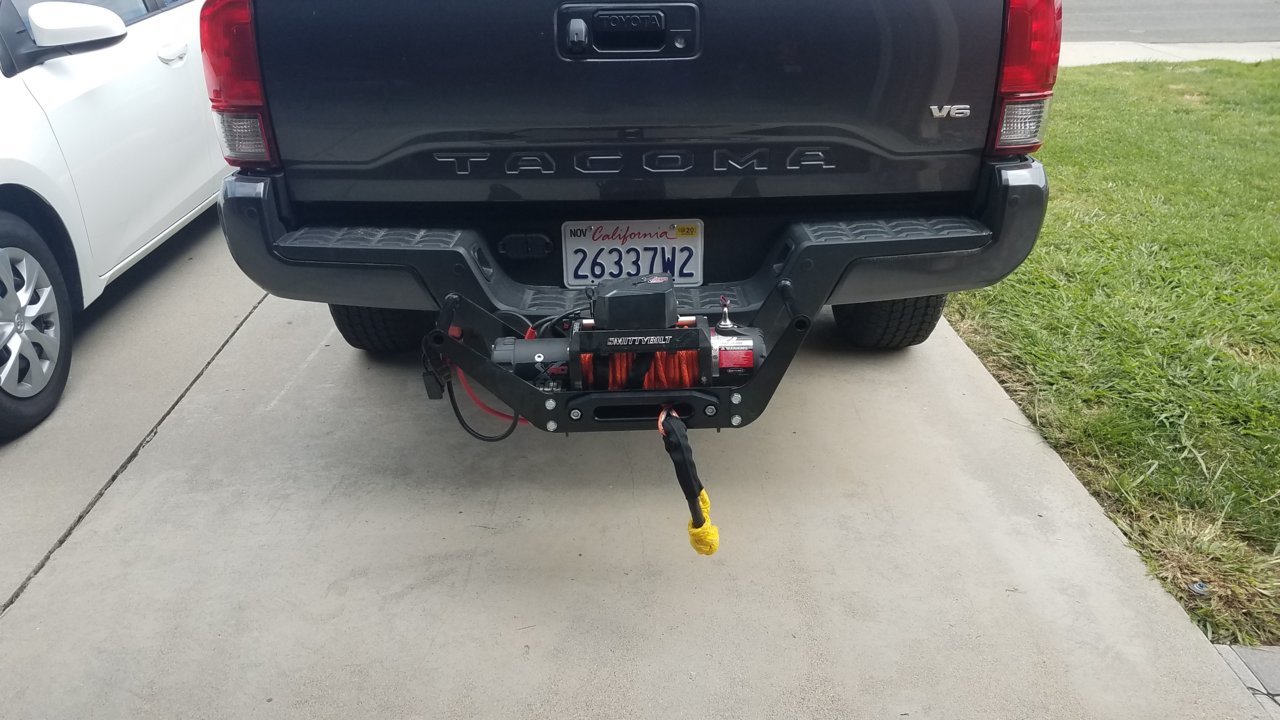

    Winch cradle and rear quick disconnect.
    20200418_144244.jpg .

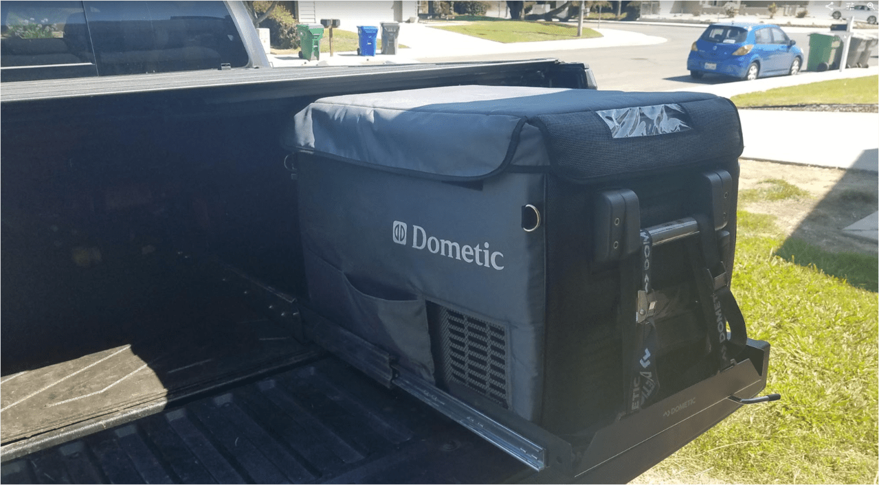

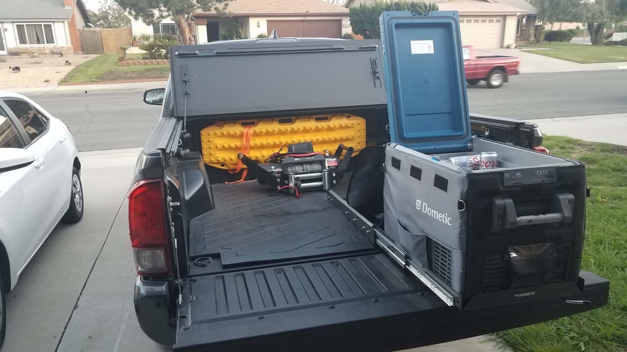

    My old Dometic CFX 35 with a new Dometic fridge slide. Fits snug under the Baklflip MX4. I bolted A hitch receiver to the inside of the bed so I can store the winch when not in use.

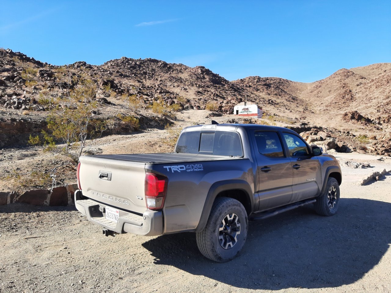

    Here's a few mods I forgot to post.

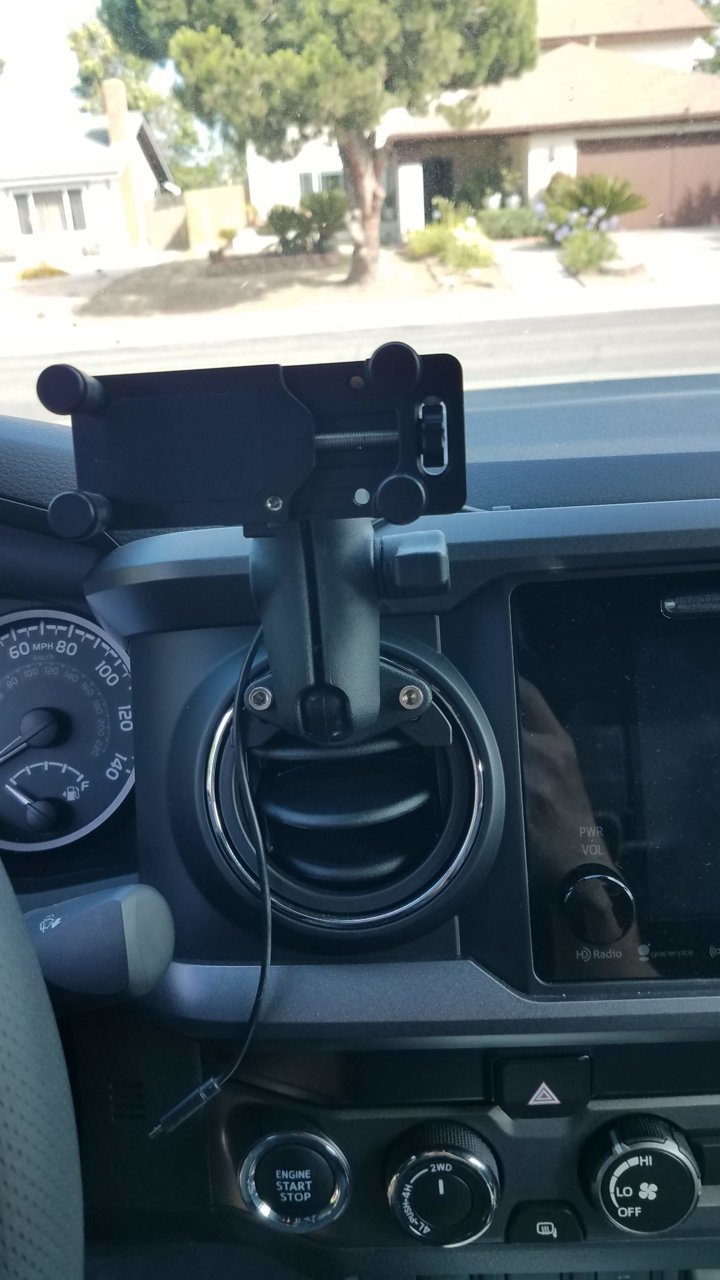

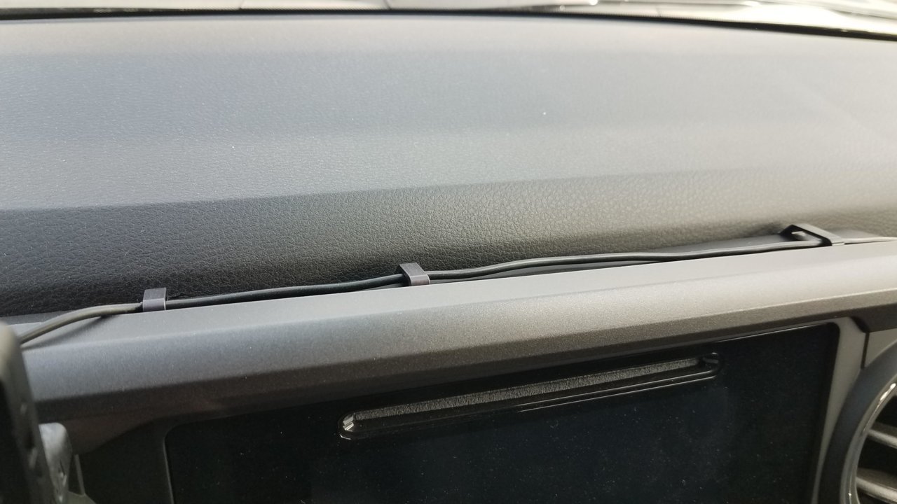

    Hondo Garage phone mount and cord clips
    It's expensive but I'm really happy with it. It's really well made. In my jeep I ended up going through many cheap mounts and I can tell this mount will last longer than the truck so probably worth it.
    I also amputated the exhaust tip and removed the mud flaps. I've done enough offroading to know that I would eventually tear them off anyway.
    The exhaust dumps down right behind the axle now. Up out of harm's way and In my opinion I think the truck looks better without mud flaps or the exhaust tip.
    Last. I added a front tow hitch and quick disconnect so I can mount my winch to the front when needed.

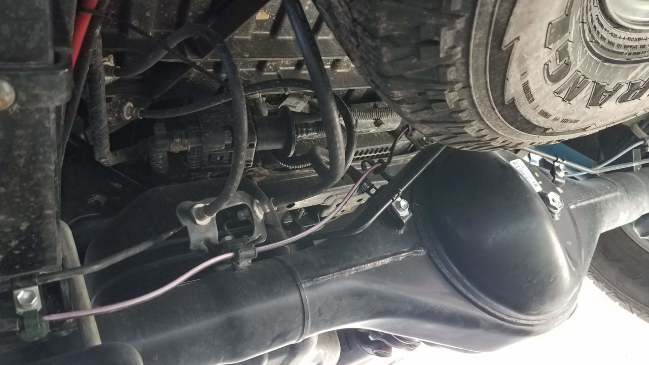

    Almost forgot. I did the rear axle diff breather mod. Ran the hose behind the rear tailight.

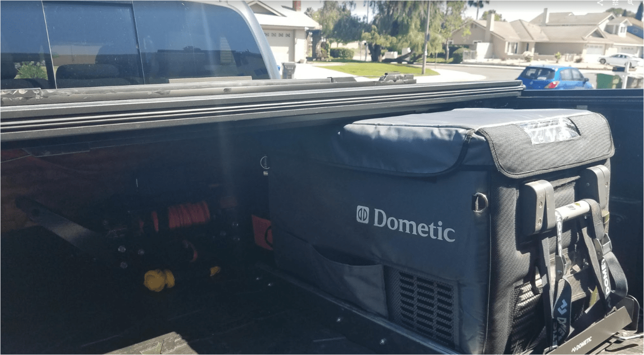

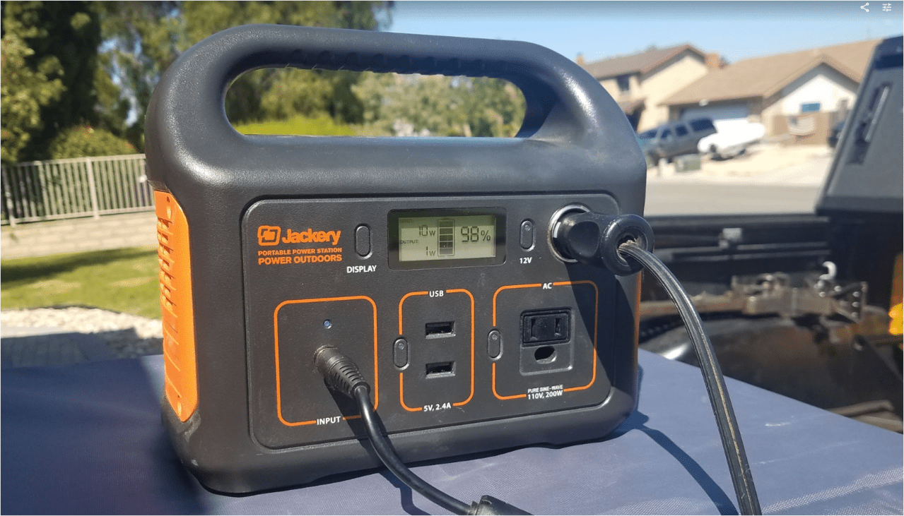

    I took some detailed pics of how I run my fridge for another thread and I figured I'd post them here also.
    I use a Jackery Explorer 240 Portable Power Station. I plug the Jackery into the ac bed outlet. I plug My Dometic CFX 35 to the 12v DC outlet on the Jackery. When the truck is running the Jackery charges while also powering the fridge. When I turn of the truck the fridge keeps running. The only downside is that I have to remember to turn on the bed outlet every time I turn on the truck so that the Jackery continues to charge while driving. It charges at the same rate on the 100w or 400w settings. I use a small battery tray I found on Amazon to hold the Jackery down. I'm still messing with this setup to make sure it works they way I want but so far so good.
    I like that it shows you how many watts are coming in and how many watts are going out.
    The fridge fits really tight under the Bakflip Mx4 but it closes all the way and I can still slide out the fridge.

  12. Jul 7, 2020 at 8:41 PM
    denver osborne
    denver osborne Octoyota
    May 7, 2015
    #154828
    233
    Deej
    California coast
    toyotatruckonly
    oh man I hope my fridge can fit that slide... will have to look into it... mine is 18 wide and 28 deep, 20 tall.
  13. Jul 12, 2020 at 11:04 PM
    kevinlambchops
    kevinlambchops Well-Known Member
    Jul 3, 2016
    #191103
    542
    I dig the setup! I wish I went for the cfx35 instead of the cfx40. The 40 does not fit under the tonneau so I have it placed behind the driver seat...
  14. Jul 13, 2020 at 8:13 AM
    JVL1985
    JVL1985 [OP] Well-Known Member
    Nov 25, 2019
    #311669
    300
    2019 Tacoma Double Cab, short bed,4x4, v6, TRD Off-road
    I had the fridge in my previous Jeep so I just got lucky that it fit so well in the truck. But it is small. It can be a challenge organizing our food even for a weekend trip. And it does take a lot of bed space.

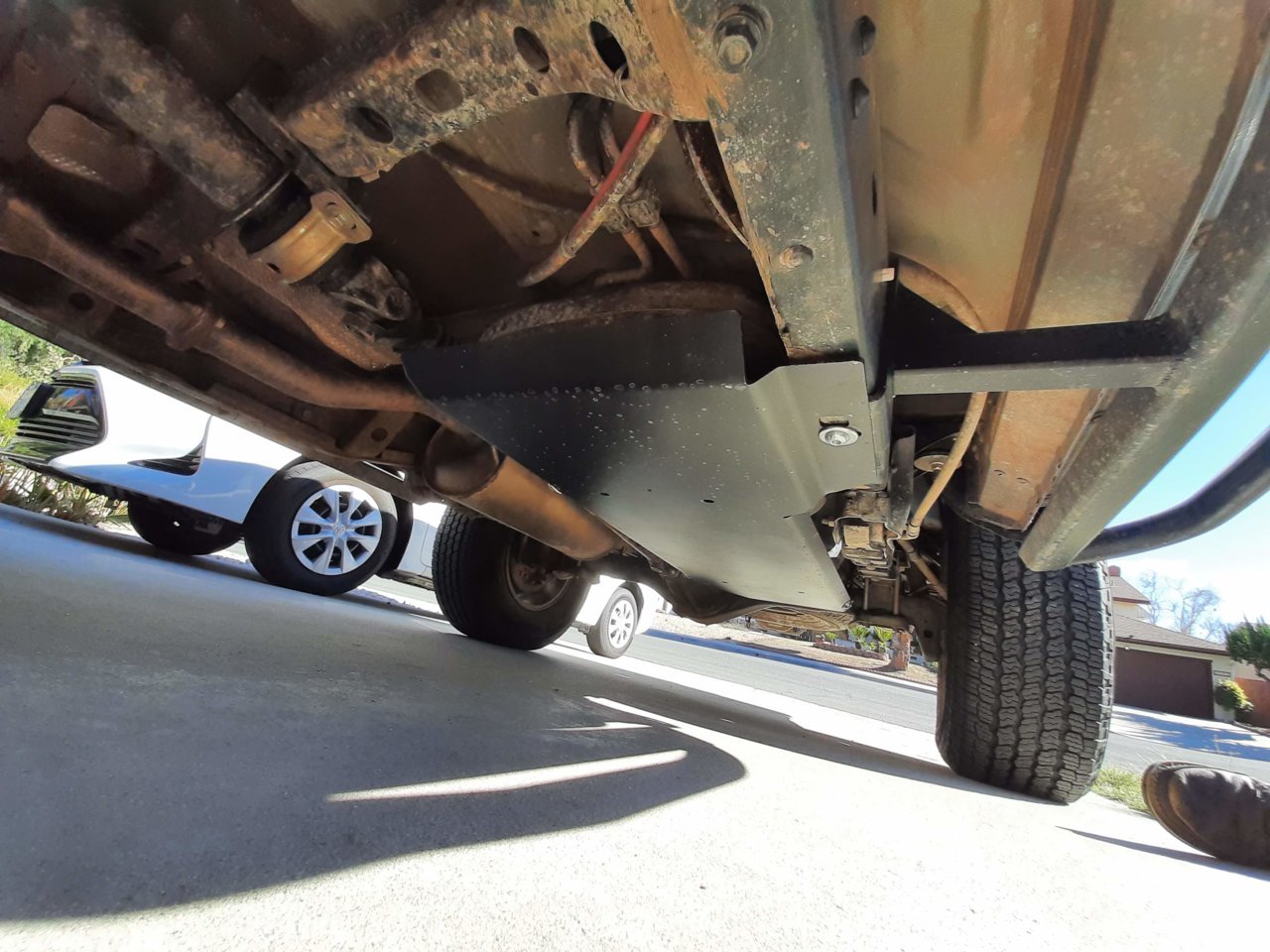

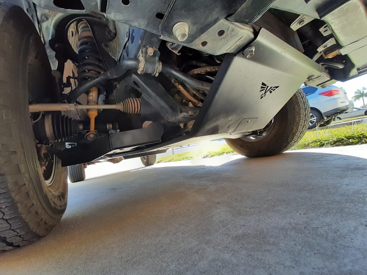

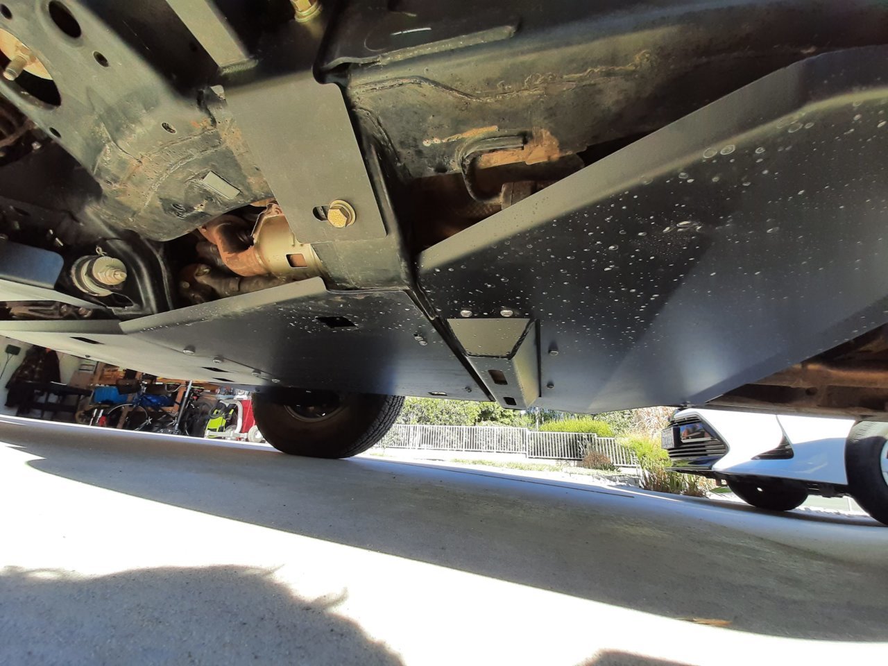

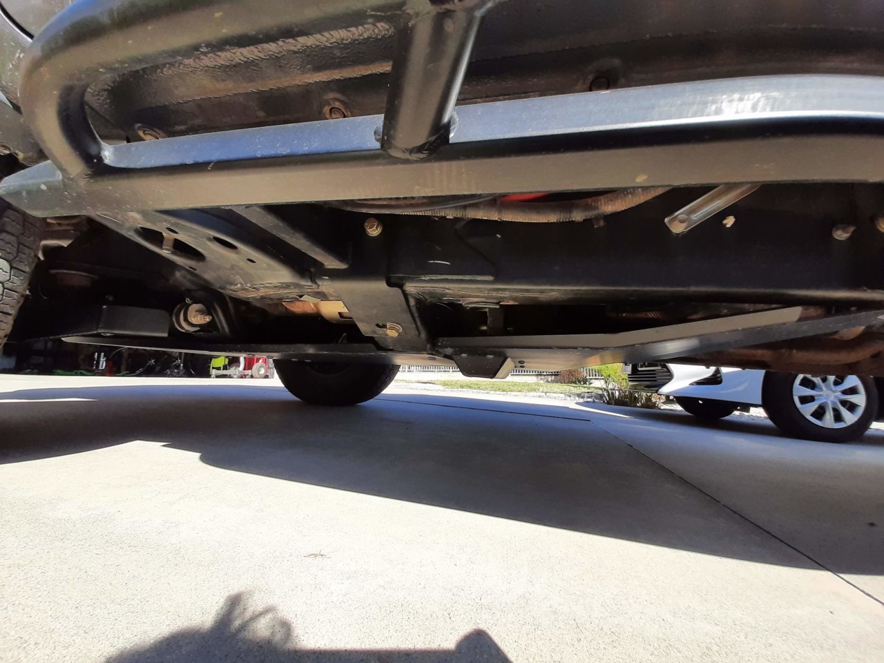

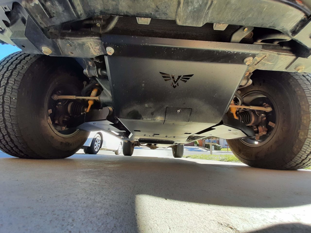

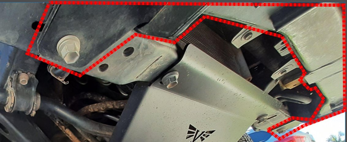

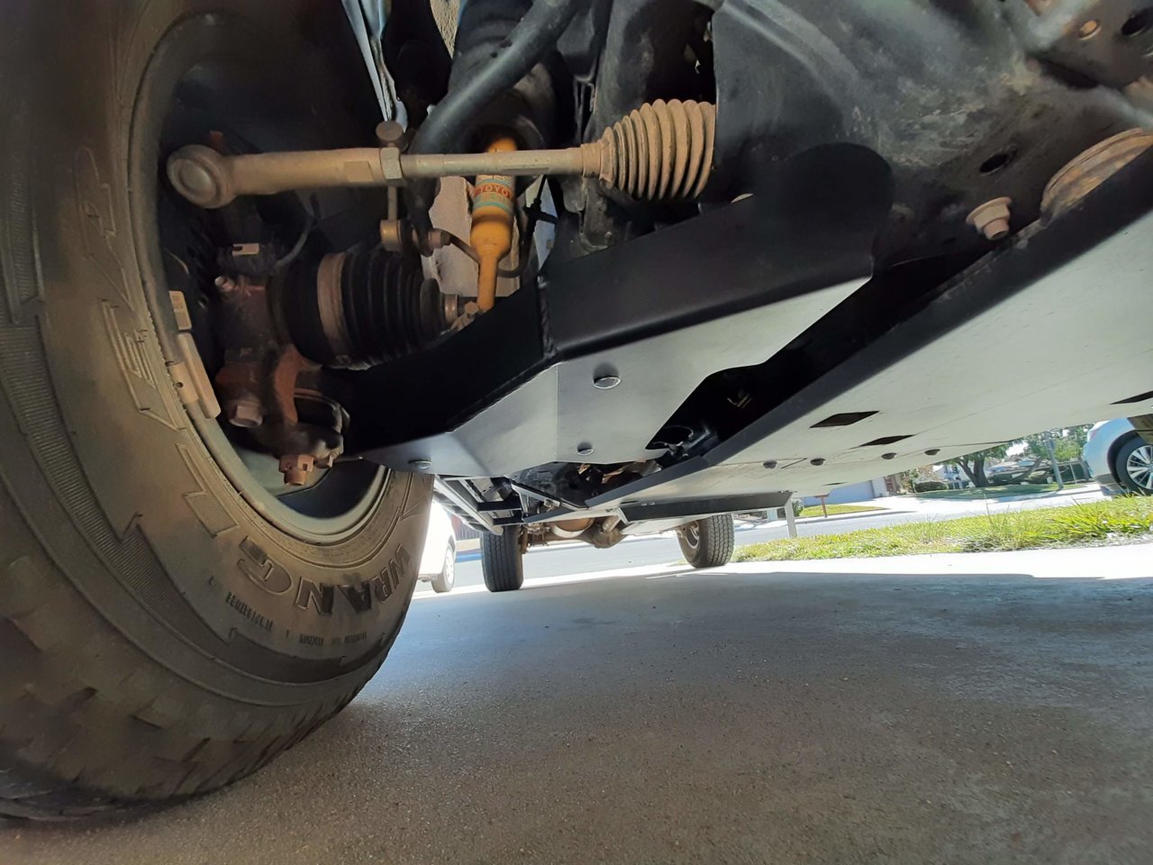

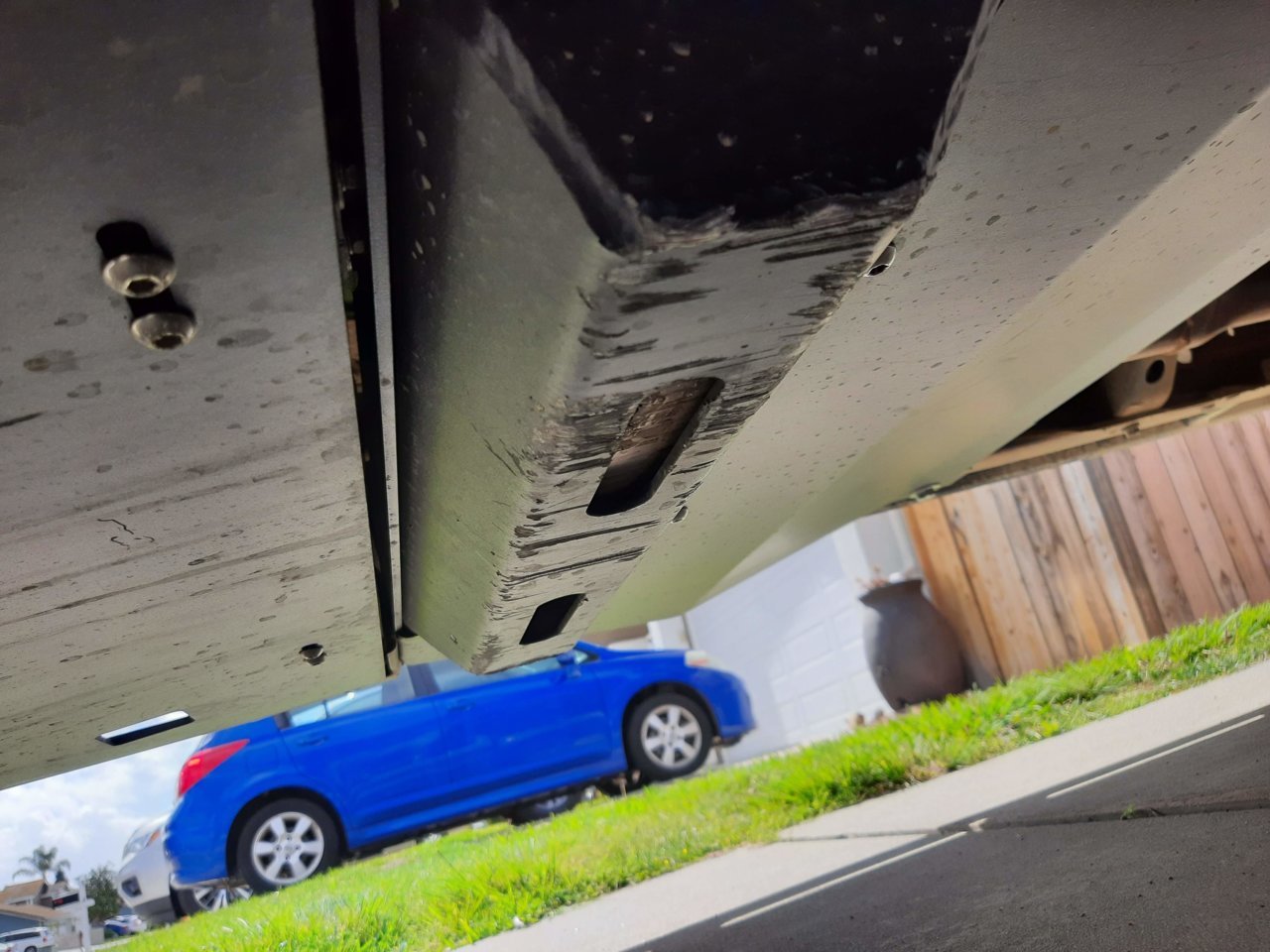

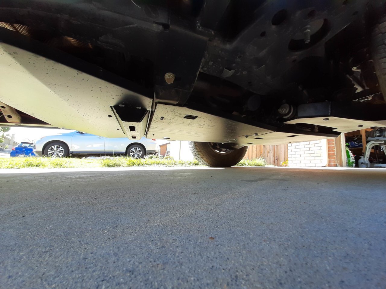

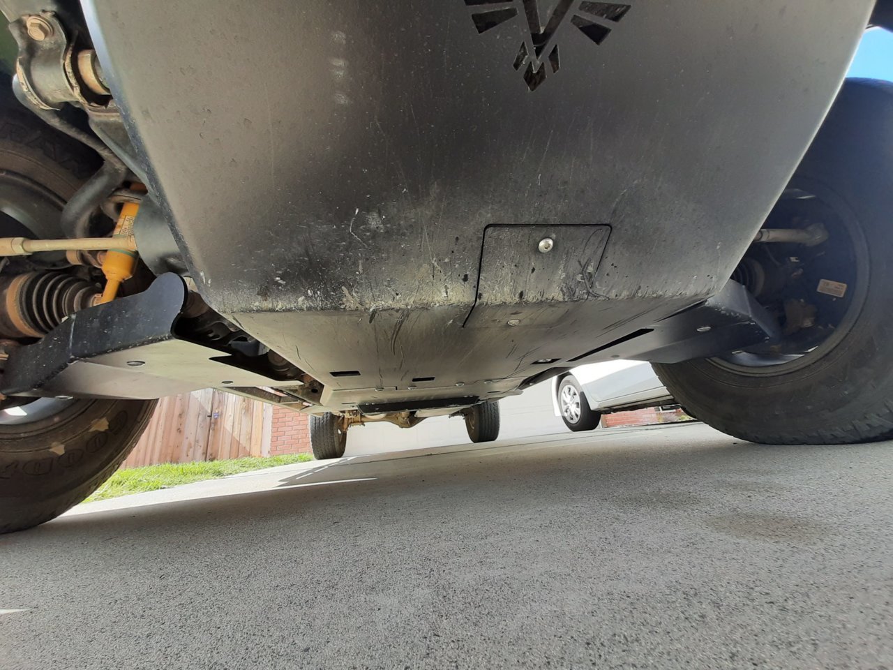

    Installed a full set of steel skid plates. All of them by Victory 4x4. Haven't got to bash them on the rocks yet but I'm pretty happy with them so far.
    Front, mid, transferase, gas tank, & lower control arm skid plates. 100% bolt on with minor drilling.
    20210116_124814.jpg 20210116_124822.jpg 20210116_125035.jpg 20210116_124853_001.jpg 20210116_124907.jpg 20210116_124933.jpg 20210116_125001.jpg 20210116_125012.jpg 20210116_125020.jpg 20210116_125035.jpg

  17. Jan 17, 2021 at 5:35 PM
    #17
    T-yoda
    T-yoda Well-Known Member
    Sep 16, 2020
    #341021
    3,437
    Dave
    Eastern pa
    17 TRDORDCLB mgm
    265-75-16 BFG AT, firestone riderites
    No more front winch hitch set up?
  18. Jan 17, 2021 at 6:14 PM
    #18
    JVL1985
    Nov 25, 2019
    #311669
    300
    It's still there, just hard to see in the pictures. The front skid attaches further back so it doesn't interfere with the front hitch at all. You can see the front hitch tubing and bolts in the first pic. I just didn't take the pic far enough back to catch the hitch itself.

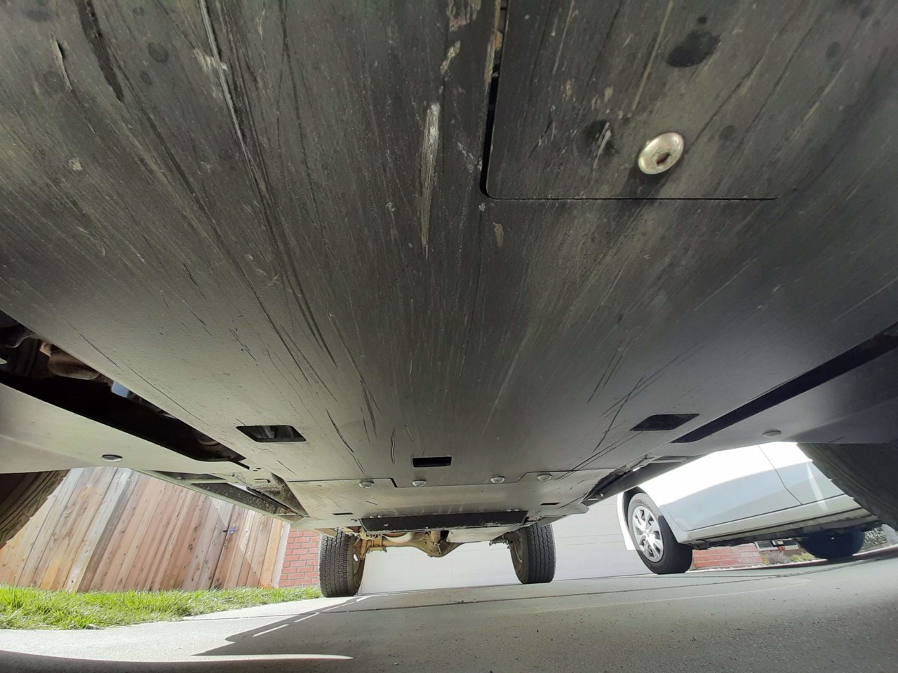

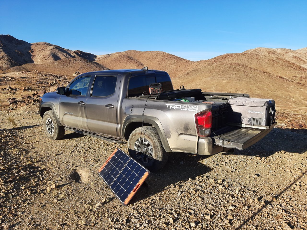

    The steel skid plates paid off this trip. You can see the exhaust was previously scratched up which prompted the skid plate purchase. I would have really damaged the exhaust this trip without them. Also, the solar panel addition really helped out with the Jackery 240. I thought I would have to upgrade to the Jackery 500 but the solar panel and 240 did fine on this 3 day trip so I'm going to keep this setup until I see a need to upgrade.
    20210309_132914.jpg 20210309_133000.jpg 20210309_133008.jpg 20210306_094016.jpg 20210306_075524.jpg 20210305_163023.jpg 20210305_144947.jpg 20210305_144419.jpg 20210306_144436.jpg 20210306_144328.jpg 20210307_082642.jpg
  20. Mar 24, 2021 at 9:58 AM
    #20
    imjustabill1970
    imjustabill1970 Twitter: imjustabill1970
    Feb 5, 2014
    #122336
    1,547
    bill
    clarksville, tn
    2017 TRD Off Road DCSB
    SUSPENSION: Icon Stage 4 with tubular UCAs WHEELS: Black ProComp 69 TIRES: BFG KO2s at 265/75/16 Partially debadged Diaz Fabrication Model T up front
    Where did you have to do the minor drilling?
