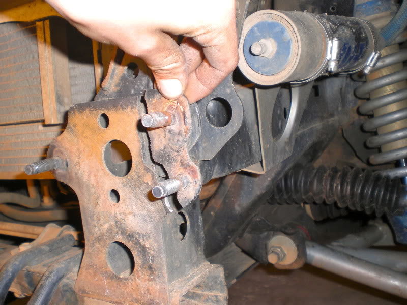

    The consequences of doing prerunner stuff on a truck with a plate bumper / winch.
    Easily enough repaired and improved.

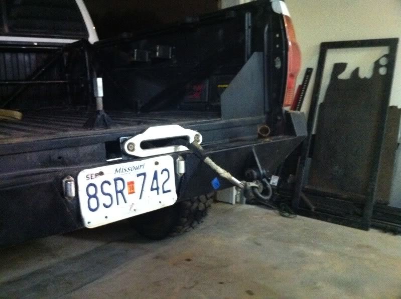

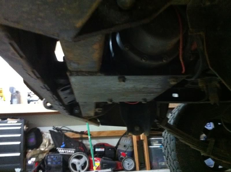

    After ditching the plate bumper, I moved the winch to the rear of the truck by fabricating a custom mount on the front side (side towards center of the truck) of the hitch receiver. This was a great location in that the weight was not over the front end and the winch did not take up any space. I remotely mounted the solenoid box in one of the bed pockets. Was quite the project, as things were a very tight fit.
    You can see the aluminum hawse under the spare tire in this picture:
    101942A1-3832-4850-BB70-EEBA24189AF1-107_98f5c17cebbb3e62148edb1e84733961de016940.jpg
    016B2446-33D5-4659-B233-6F40B92241A4-553_2e00fce1ac8a025adfff4c7eb566b485855c398c.jpg
    http://[ATTACH=full]1699621[/ATTACH]Ran this set up for a few years. Used the winch a dozen times during this time period, and experienced difficulty with the winch (due to dirty connections) about 30% of the time. Sometimes catastrophically (total winch failure). The amount of water, snow, and mud the winch was exposed to in this position was just too much of a liability against reliable operation.
