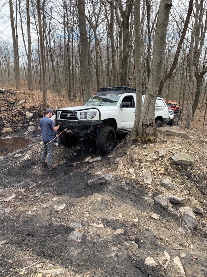

    Man, it's a sad feeling when your winch doesn't work. Last wheeling trip I high centered, pulled winch, and nothing. Winch didn't work. Had someone else pull me free, and I took the winch out when I got home. Turns out one of the pins in the remote socket got corroded and snapped off, leaving me with 4 pins instead of 5. Luckily it was a cheap and easy fix to get a new plug. Used the opportunity to wire in cab winch controls so that specific scenario can't happen again.

    I have never had it happen to me ( knock on wood) but I have seen it happen to others. The most memorable time happened to the first truck in line so he was blocking the trial and needed to go forward. We had to use a couple snatch blocks from my truck to pull him forward.
    The guy tested his winch the day before the trip.
    EatSleepTacos[QUOTED] likes this.

    Same, I think I broke the pin off when plugging in the remote to get unstuck. Oh well, shit happens and now dilectric grease is my friend to try and prevent it from happening again. And man I love me some snatch blocks. Easily one of the most used pieces of recovery gear on my truck.
