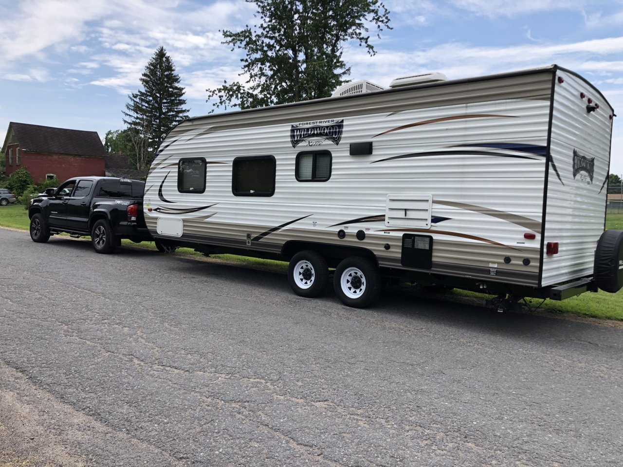

    I tow this with no problems. It looks bigger in the pic but it’s 4130lbs dry. Probably wouldn’t do 75mph, wouldn’t want to hear from all the winers who are scared to pu a bag of sand in the back of their truck. I have a good wdh and a good brake controller. I tow it maybe 5 or 6 times a summer. If I wanted to go cross county I would have kept my tundra.8163BB34-97EF-467F-8377-771242F33958.jpg
