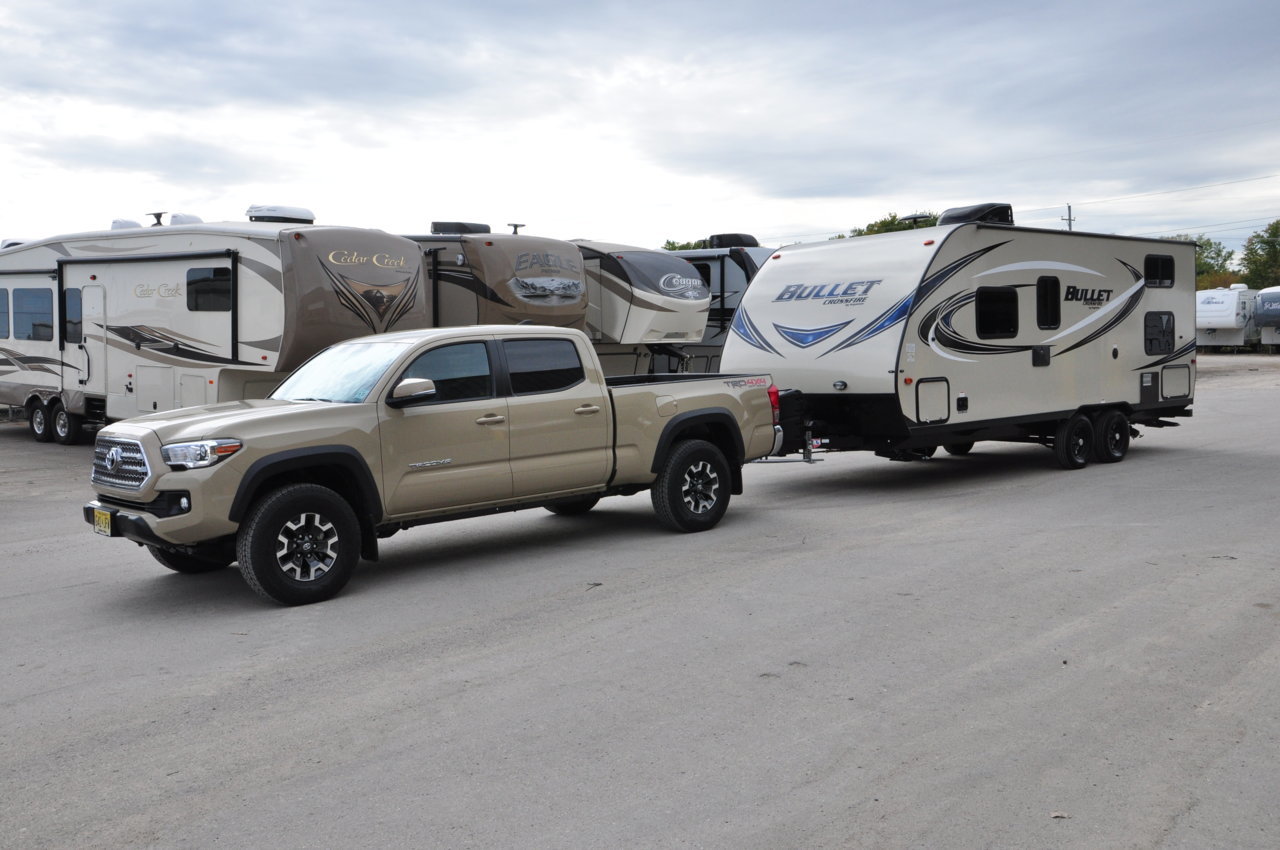

    My travel trailer is 3750 unloaded and max it’s about 5500 pounds. Always leave room to max towable weight. The Tacoma does decent towing that trailer. Have towed 10+ hours twice now and it’s been decent. You aren’t breaking any land speed records but even with a 3/4 ton truck you shouldn’t be going that fast either.
    Make sure you have a good WDH and trailer brake controller.
    Lt. Dangle likes this.

    here is our set up.. 3750 empty and 5500 max loaded..
    have done 2 10 hour trips.. one was grand rapids to nj, the other was nj to maine and back.. truck tows it well.. up in the rpm range for sure especially on hills but it hasn't lacked power to get up those hills yet. gets 8-10 mpg towing just like my buddies chevy 2500 towing real close tot he same weight. next truck will be a full size only becaus the tacoma gets tight inside with three dogs and my daughter in the back seat.. a bigger gas tank will be nice too..
