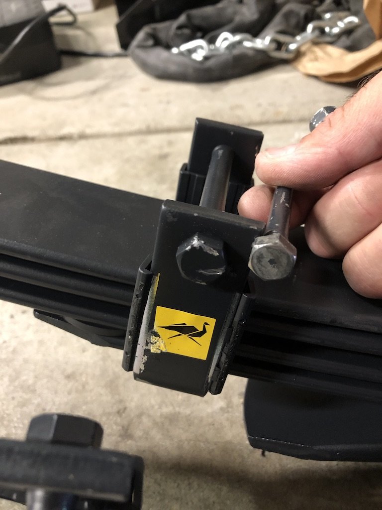

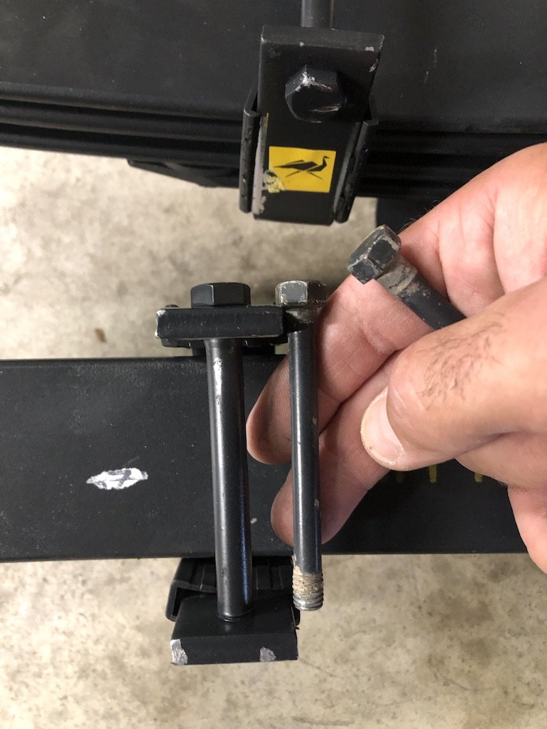

    So I decided to go look at the newer model leaf from OME for my Gen3 application and you know when you get a chinese knock-off and the finish is shinier and the metal thinner with terrible fit and finish? Thats the difference between my EL095R and the newer model, they "look the same" from 15ft away but the newer one is waaaayy better.
    FreshPots likes this.

  19. Jul 25, 2021 at 10:39 PM
    #39
    o313
    o313 Well-Known Member
    Jul 18, 2018
    #259750
    512
    N
    2018 DCLB AT SC
    So I finally got around to installing the new EL111R's and I think this first picture summarizes my impression on the difference between these and the older EL095R, even the bolts are bigger on the newer leaf's.
