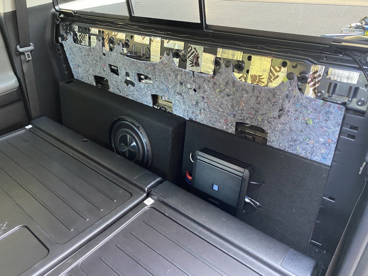

    I have 2 10” JLW3v3s in a sealed box wired down to 2ohms powered by a 600 JL amp.
    it was a tight fit and had to use spacers because the speakers were thicker than the box was deep.
    Ive had these subs for 9 years and love them. I dont really bump anymore but cant live without the range

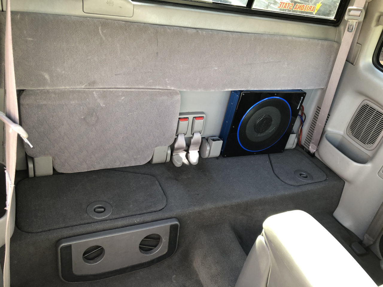

    How does this setup sound? Coming from a 2nd gen double cab with two 10s and finding out 1st gens have a hard time fitting subs behind the rear seats was a little sad. If any other 1st gen guys have any suggestions feel free to drop a link. Tried searching the forum but didn't come up with much

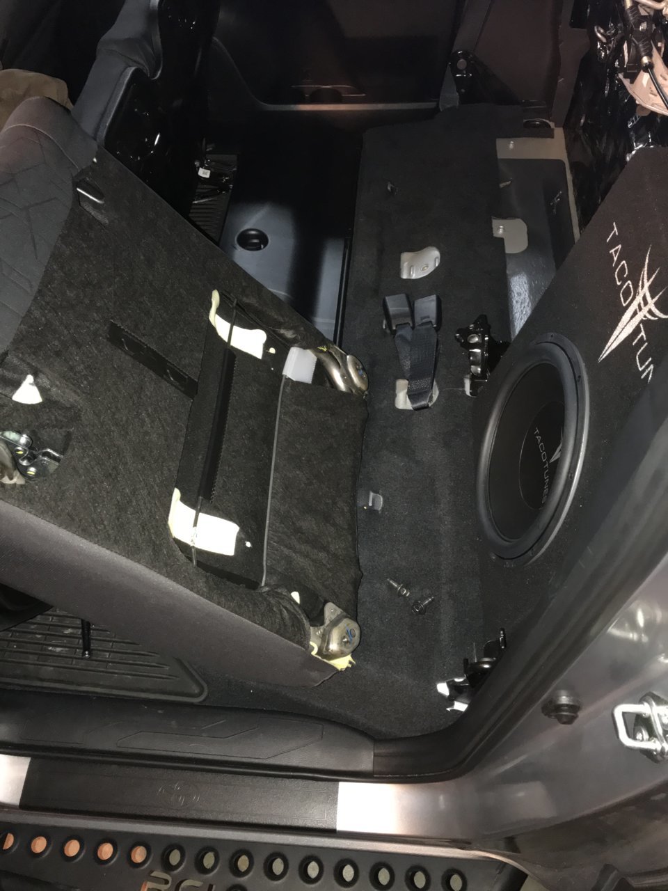

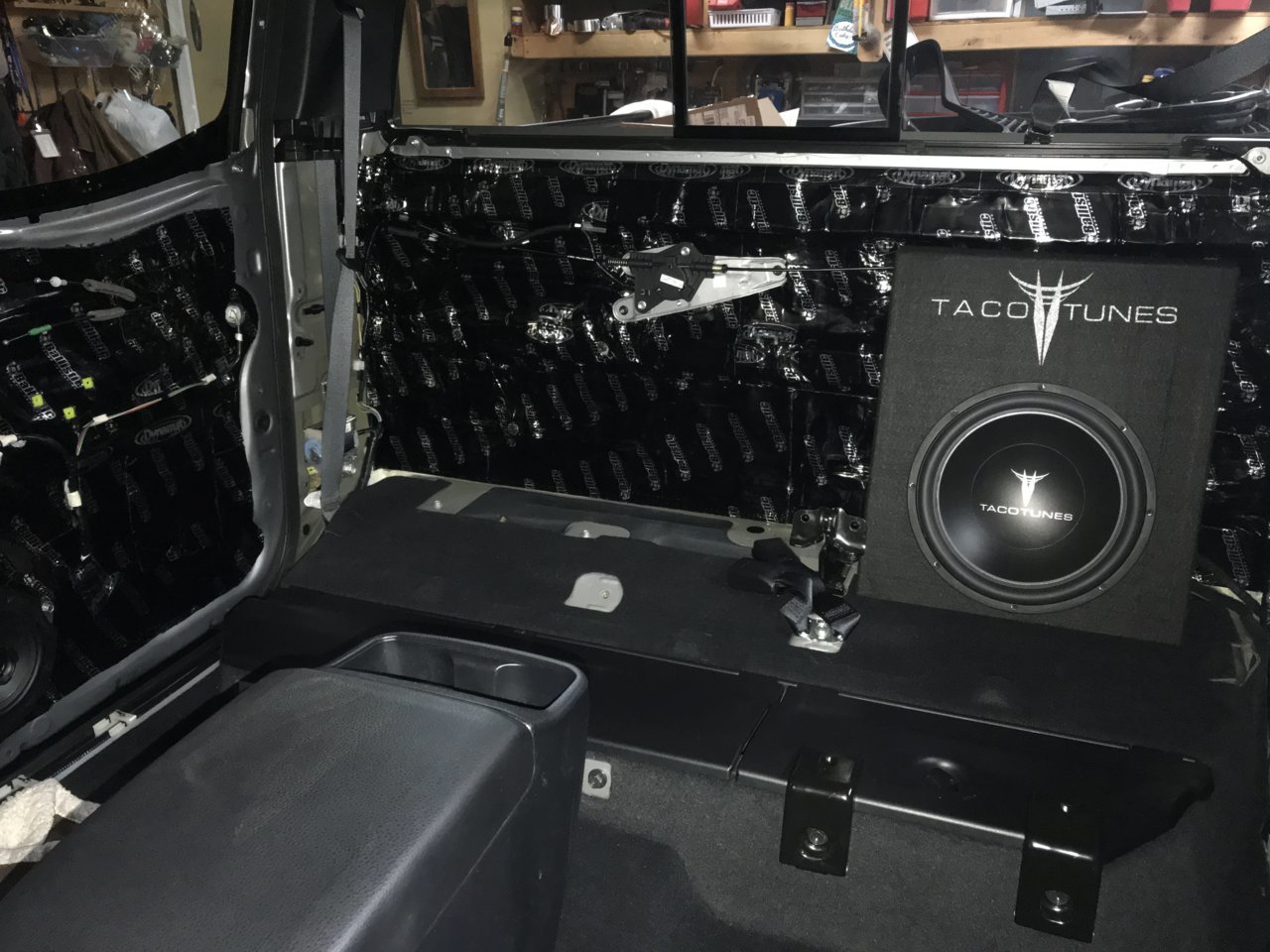

    I looked at various single sub boxes and went with this since it will hold a 12 inch sub. I had to modify the seatback a bit and pound down the metal tie rods but it was easy and worked out just fine. A double sub would be nice but this gives me plenty of bump and I still have the OEM storage bin on the other side that I reinstalled. 79482BB9-1EB7-4BE2-BA39-832EDCF41D55.jpgA5D49D8D-8885-441F-90F6-D2AC7CF1477D.jpg

    Replaced chrome badges with Sockmonkey black badges, painted billet grill black, K&N cold air intake, my corner light turn signal circuit, Speedfreek traction bars, RAAMaudio BXT/Ensolite, Stereo: Kenwood KIV-701 USB/Bluetooth deck, 10" Pioneer shallow sub behind the rear seat, Infinity 6822cf 6x8 front and rear doors, Fosgate P400-2 (sub), US Acoustics USX-4065 (four main speakers)
    It sounds pretty good. That caraudiofactory box (it doesn't look like they sell it any more) is just at the minimum box volume for the 10" shallow Pioneer I used so you don't get the super low thumping bass without doing a little EQing. I add quite a bit of gain about 40Hz and it really brings it to life yet the Pioneer seems to handle the extra excursion of the boost fine. Looks like the supercrew sound box is still around https://www.supercrewsound.com/04tacomadbldual.html I had both and like the caraudiofactory box a bit more since it let me wedge a 10" in there (with a little internal trimming on the box) and leaves some room behind the seat for tie-down straps general storage.
